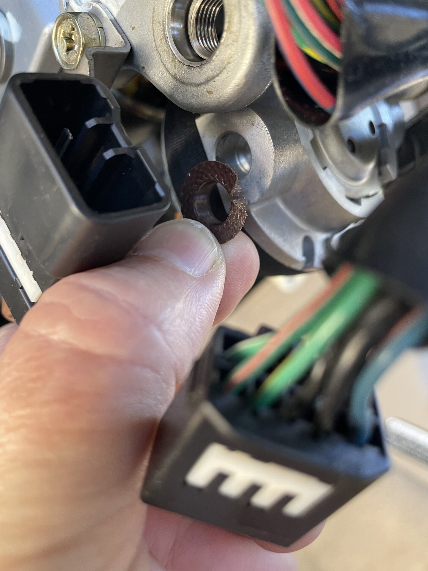

Tilt motor replacement
Africaster
SILVER Star
Aug 4, 2021
18
250
Bergen County, NJ

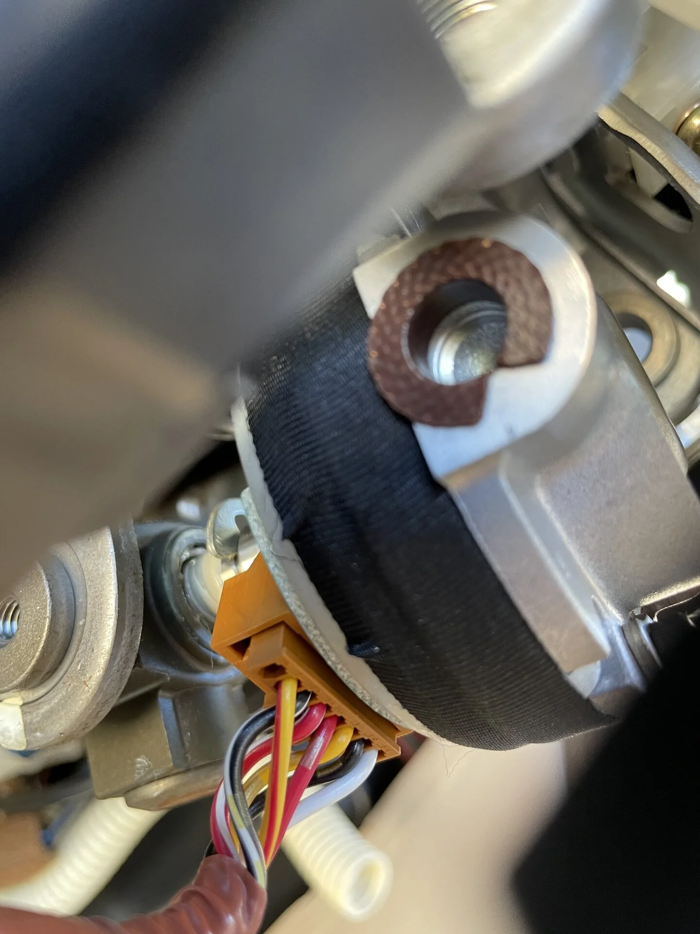

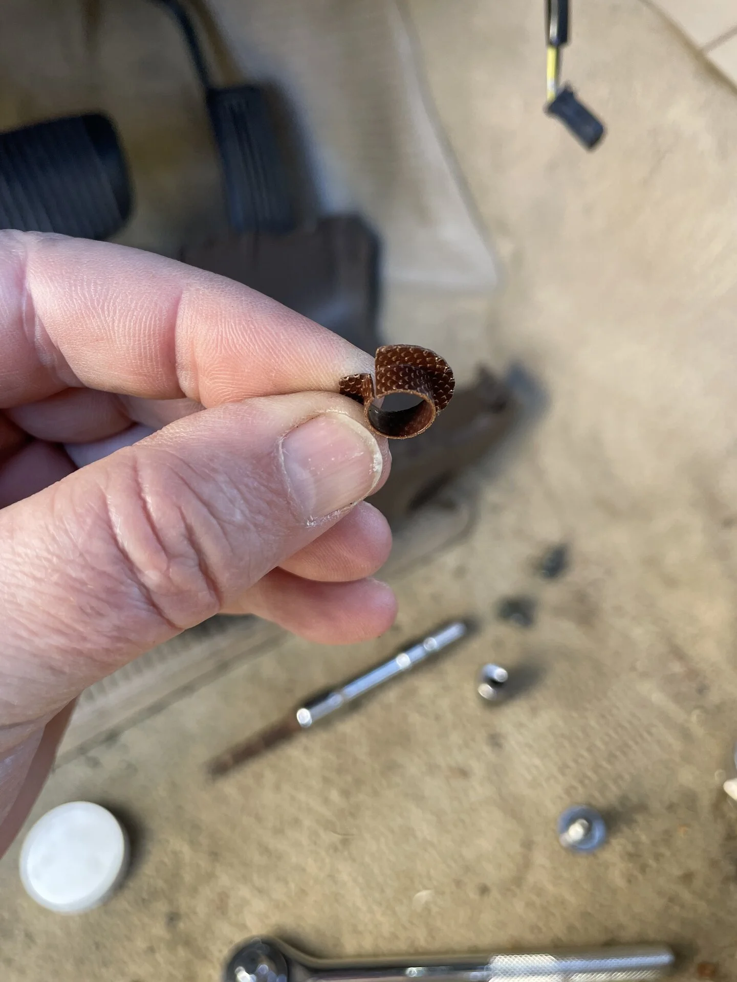

Heads up … new OEM motor did not come with the below spacers … steering wheel moves an alarming 1/2” or so up/down if not there
