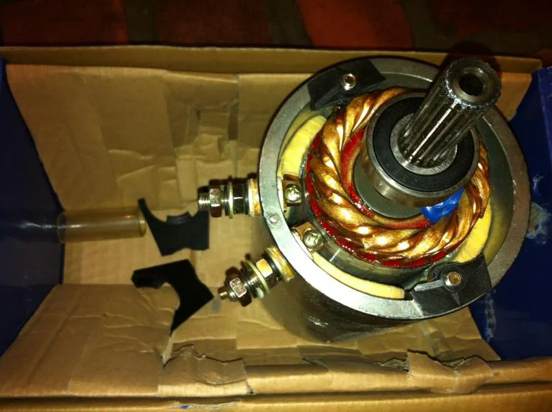

Shipping was free and fast! Unfortunately the packaging was crap so one of the posts for connecting the 3 wires to the solenoids is banged up and the nut won't come off. I'm sure I could deal with it with a file, but I don't consider it a new motor anymore. We'll see what their customer service is like...
Well they are shipping out a replacement immediately.

The replacement motor showed up quickly and in perfect shape.
The install took a little trial and error on my part. The motor is shipped with a housing bearing and a spacer behind it. I eventually realized that I needed to removed both and utilized the Warn bearing already in the upper housing.
