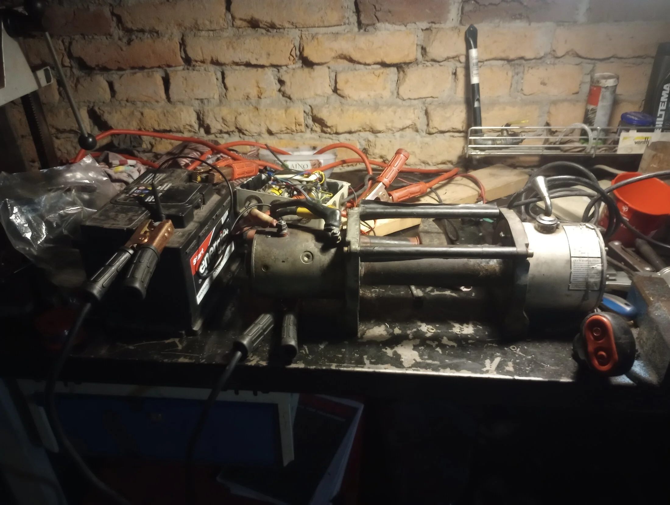

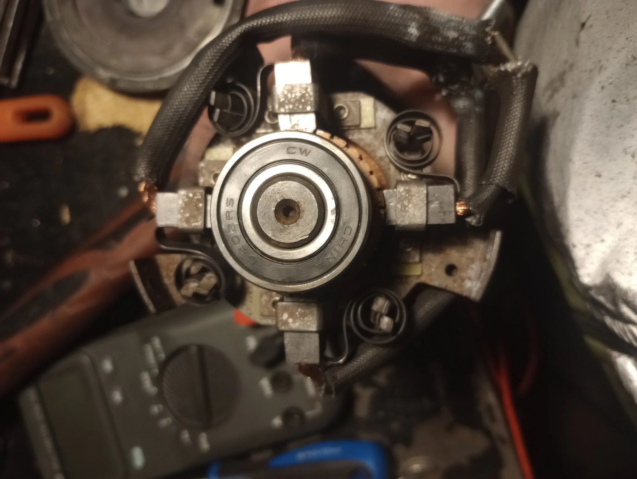

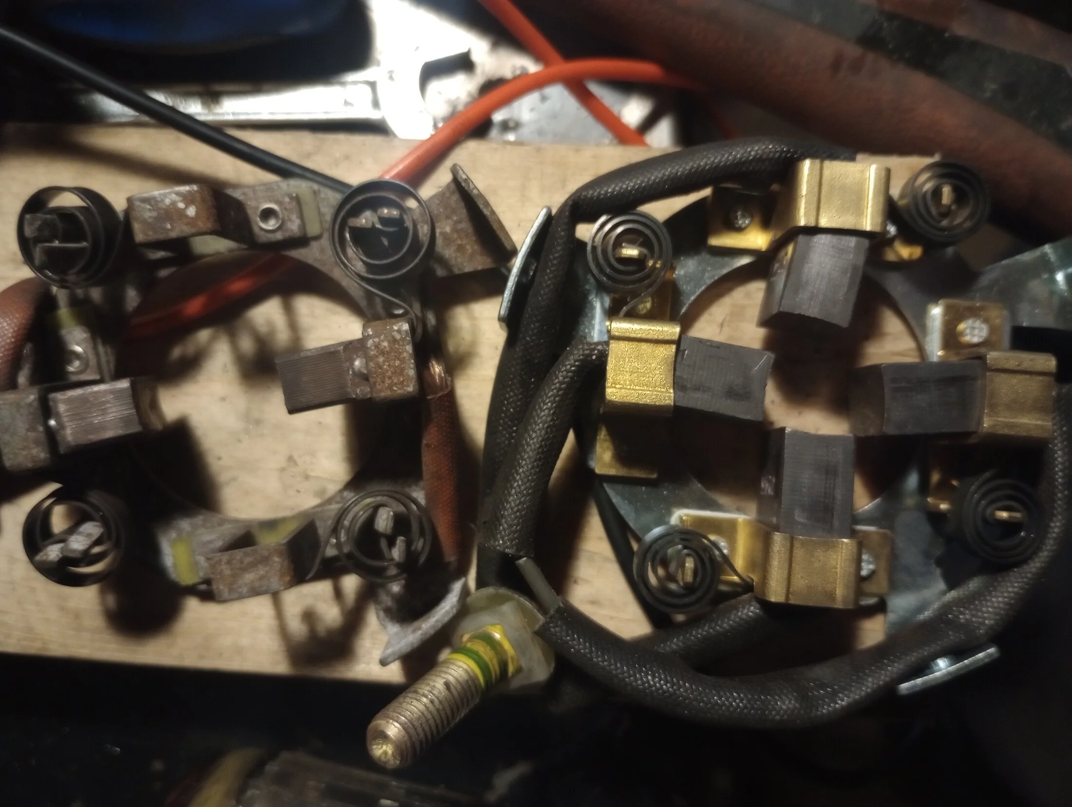

I've got an old chinesium winch that used to work fine when it was on my dad's Range Rover 10 years ago, but after I replaced the brushes a while ago it doesn't work. Solenoids works as they should.
There's between 2.4 and 33 ohms resistance between the black and yellow terminal, the multimeter didn't want to settle. About 10 ohms between red terminal and ground. No continuity between red/ground and black/yellow.
I don't know much about how an electric motor works, so I don't know how to troubleshoot from here. Any suggestions are appreciated.

The motor is grounded, the ground terminal is on the backside. There's no continuity between the yellow or black terminal and the case, and about 10 ohms between the red terminal and the case (ground). All continuity is measured with the motor disconnected from everything.
The motor shaft didn't spin as easily as it used to, so I figured it wasn't in the correct position and whacked it with a sledgehammer a few times. That somehow fixed it, it now works perfectly.
It seems like it wasn't the repositioning of the shaft that fixed it, but rather the hammer strike. It now again didn't work after just a couple minutes of laying on the workbench, but hitting it with the sledgehammer fixed it. Hopefully it's just the brushes that doesn't have good contact yet.
