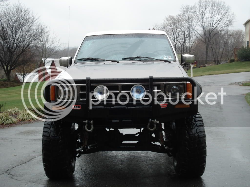

Well here is a pic of the front. Its what he has on the for sale ad. Let me know if you think it is possible.
I hope to get it.
Oh and actually on the rough country website it lists it at 4-5 inch lift. On the lift instructions it looks like it retains the factory brackets.

I bet it could be brought back to original. Whatever parts are missing, I'd probably just go to a junkyard and get.
Or wait a while. I'm planning on SAS'ing my '91 this summer, and I'm sure I'm not the only one who has IFS parts lying around.
Looks good. The lift and fender flares look silly IMHO, but looks to be in great shape otherwise.

If you want a stock IFS truck go buy one of those. That looks like a nice truck, I wouldn't want to waste the time and effort to take the lift off and bring it back to stock.
Add some ball joint spacers and lower the ride height by loosening the torsion bars and you can reduce your lift height and increase your travel.
I don't mean for this to sound like I'm jumping on you guys. For the amount of lift that thing has. Any tire that would look proportionate under it, would still be too big for the IFS diff and shafts to safely handle IMO.
NWO, does that thing have a body lift on it?
Based on how the ARB fits the body, it doesn't look like it has a body lift (or someone did a damn good cut and weld job on the ARB).
