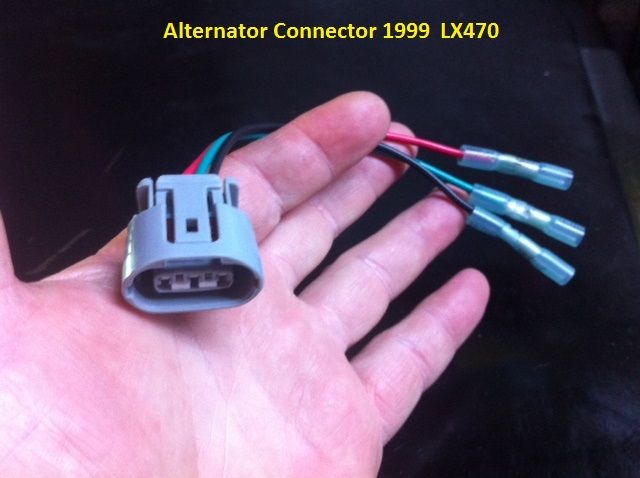

It's a tight squeeze...no denying that, but very doable. It might be a good thing for you to have a replacement harness connector on hand. Mine (and many others) have found the connector on the back of the alternator to be very brittle. Mine pretty much disintegrated in my hand when I removed it.

Unbolt the PS pump. I removed the reservoir tank and yanked it from the top. Came right out without much effort. Buy a replacement housing for the exciter wire because mine exploded.

It's a tight squeeze...no denying that, but very doable. I might be a good thing for you to have a replacement harness connector on hand. Mine (and many others) have found the connector on the back of the alternator to be very brittle. Mine pretty much disintegrated in my hand when I removed it.

Where did you get that replacement plug?
Picked mine up on Ebay...but most auto parts stores should be able to get you one. The wire colors likely will not match...but its a simple to just note their locations.

Getting the wiring harness off is the hardest thing and IF your connector is brittle might well break (regardless the removal technique) that is why I suggested having a new one on hand (see previous post) before you start.
Cool I will try to remove it without removing the radiator first if no luck there then I will try it with removing the radiator. I am having trouble finding the wiring harness for the alternator as I expect that mine is original and will break. Might have to get it from the Toyota dealer :(
