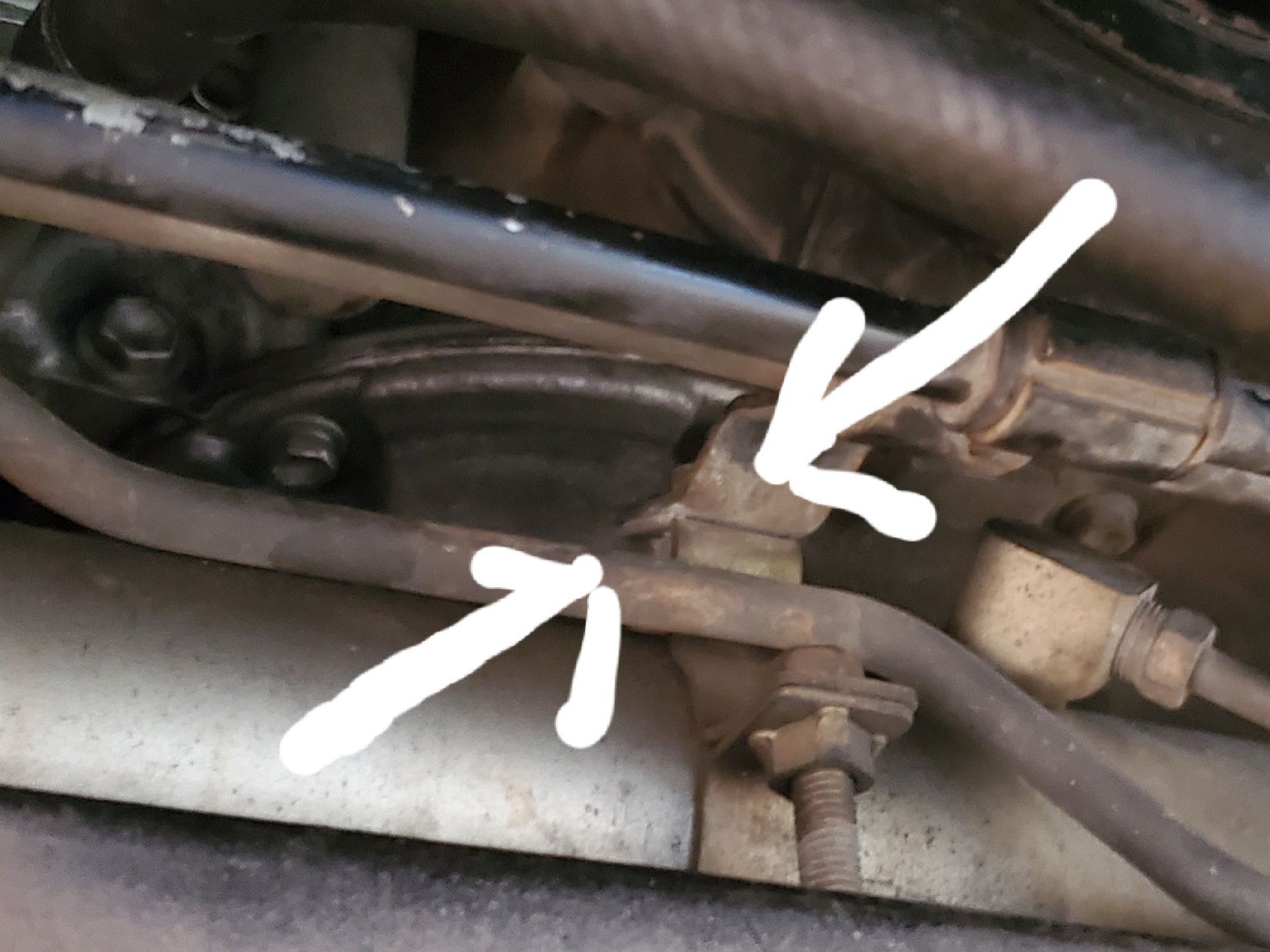

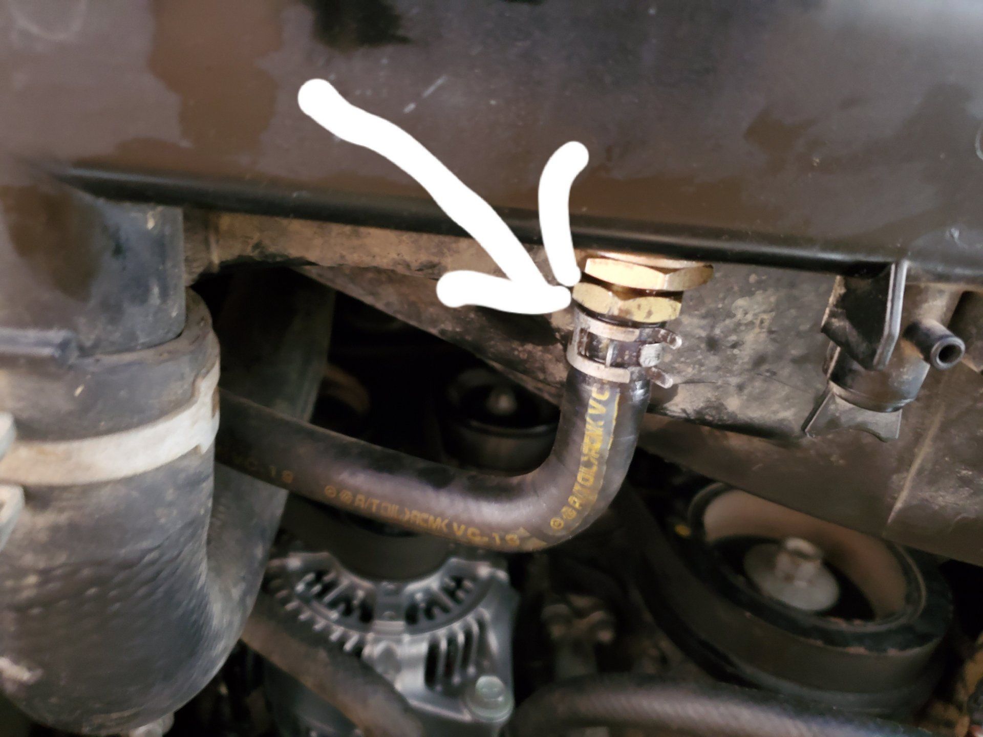

I removed the alternator from the bottom and took a couple of pictures of what I found I needed to disconnect, should it be helpful to someone else.:
1. bolt holding a bracket for two hoses.
2. Transmission line from bottom of radiator.
