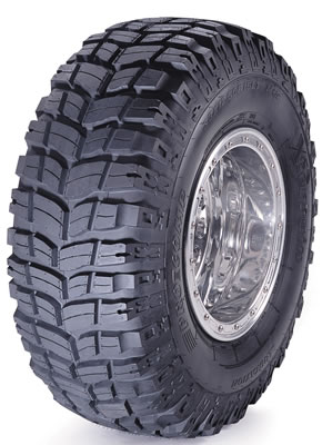

Woops that was the size of the Mickey Thompson's I was originally looking at but was talked out of. The ones I'm looking at now are 31x12.5" Pro Comp Xterrains. I still have more shopping around to do, but so far these are looking pretty good to me. Good aggresive traction but it also appears go be good for dry pavement as well, and they're radials.
My main concern with wanting wider wheels is the width of the wheelbase once it's SOA'd. I don't want to feel like I'm going to tip just by goind around a corner...
