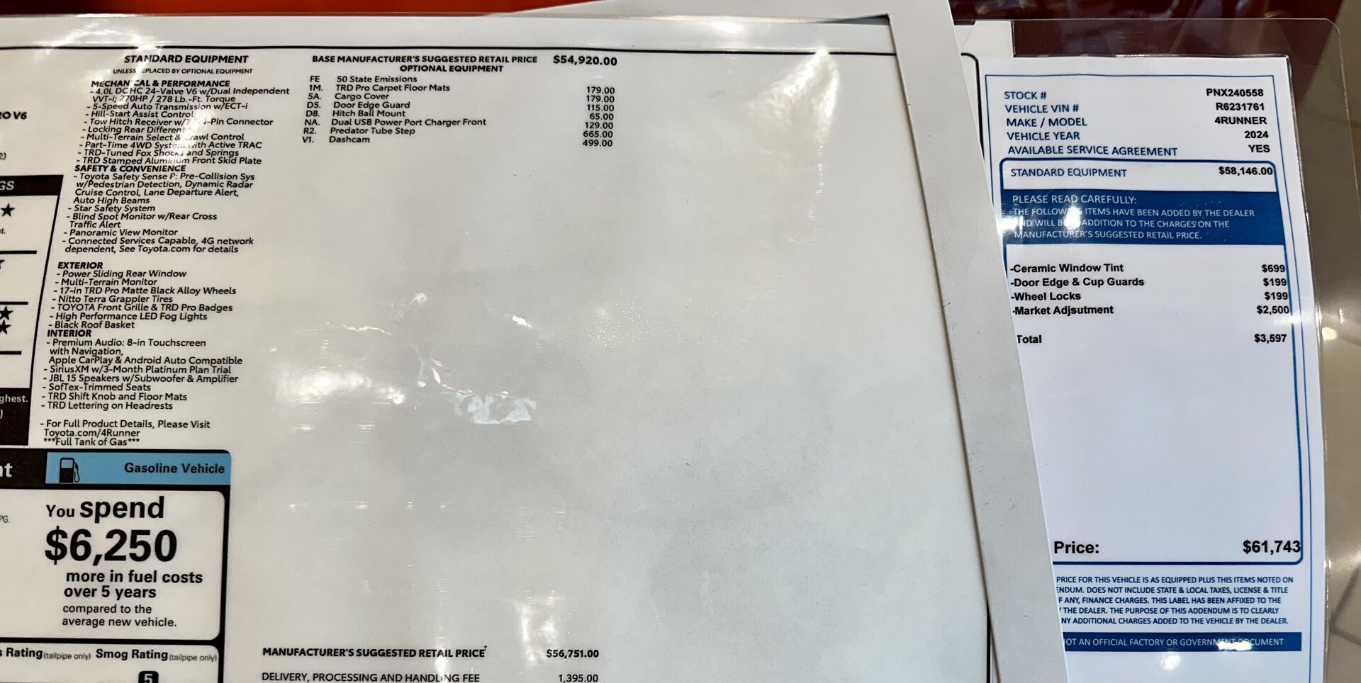

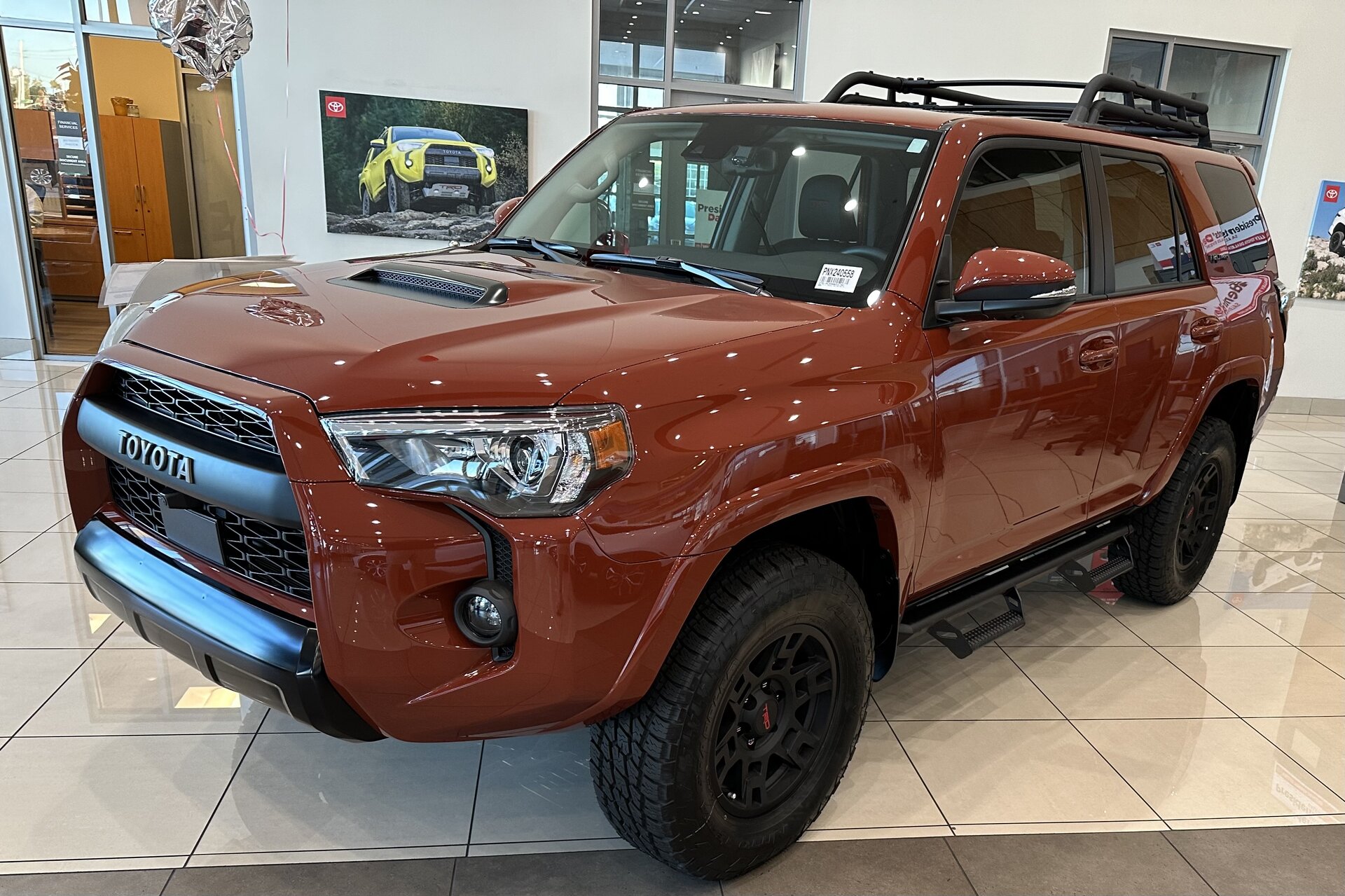

I was at a Toyota dealer yesterday. They told me there were recalls on Tacoma and Tundra. The 250 is delayed by 3 months. The new Gen 6 4Runner is delayed as well, by as much as 3 months.
That was fine with me because I went in looking for a Gen 5 4Runner, but they are not giving them away yet.
