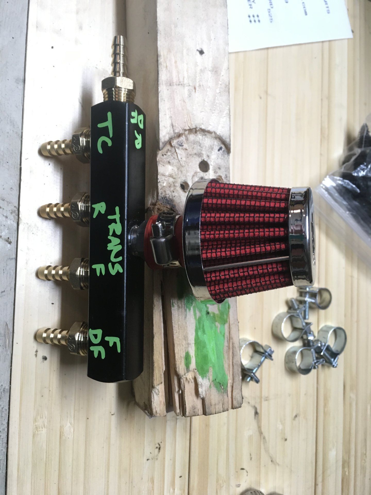

The differentials, transfercase and gearbox have breather hose with a check valve mechanism. This allows for fluid expansion when things heat up. With time these breather hoses and check valves are a weakness when combined with lengthy water crossings. The case you refer to was a second owner and per his analysis was the logical reason for water in the transfer case oil and subsequent issues. It is known feature and weakness of the design. There are relocation kits routing these breather lines up high into the engine bay. A recommended mod for those considering serious overland and cross water/river use.
Further info on the breather hose setup and relocation of the same can be found here on MUD or by general search on the internet.
Or this video at 30min showing the breather hose location on top of the transfer case.

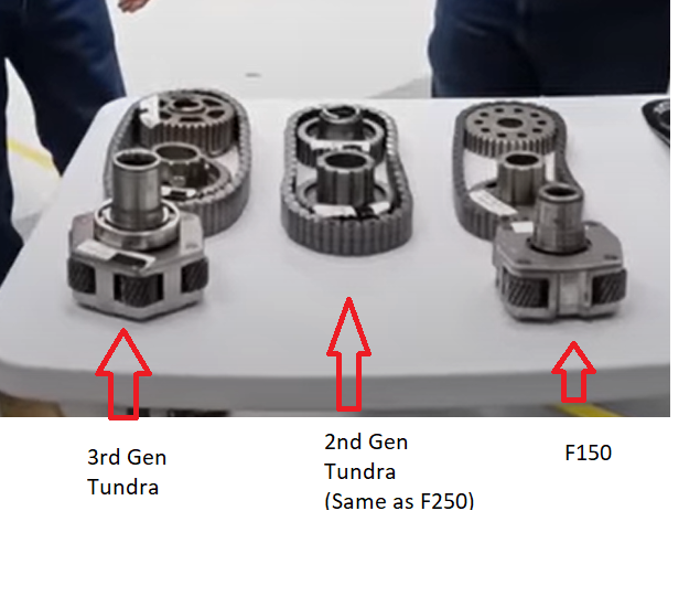

The only place there's a big difference is in the tundra and Sequoia that have significantly heavier duty cases than the land cruiser models. But they're also built for heavier use.
Would you mind sharing the information which spells out the Tundra and Sequia have heavier duty transfer cases? Interesting statement and like to see some further info on that.
Tundra went a category up in size for the third Gen. The second Gen tundra swapped over mid cycle to the Borg Warner from the aisin. Not sure why, but the aisin was subject to a tsb that I think was due to chain noise. It was an iteration of the same case used in the 100, 200, and 300.
This gen is significantly sized up internally from the outgoing Borg Warner that was an upgrade (?) from the aisin comparable to what's in the 300. I'm not an expert on the JF2 cases, but I think they still use the same chain as the older ones. Probably comparable to the middle one on this table. Chain is bigger and the drive gears are way bigger. It's just a category size up.
Thanks much for this. For some reason I thought the 200 transfer case had no chain, but it does per the repair manual (see snapshot below).
Looks like changing the oil on the same has added relevance/value and checking the breather hose is in place and in good shape over time to prevent water ingress. Good to know!
Me brain small. Are you saying the 3rd gen tundra has the strongest transfer case in the full size pick up market?
