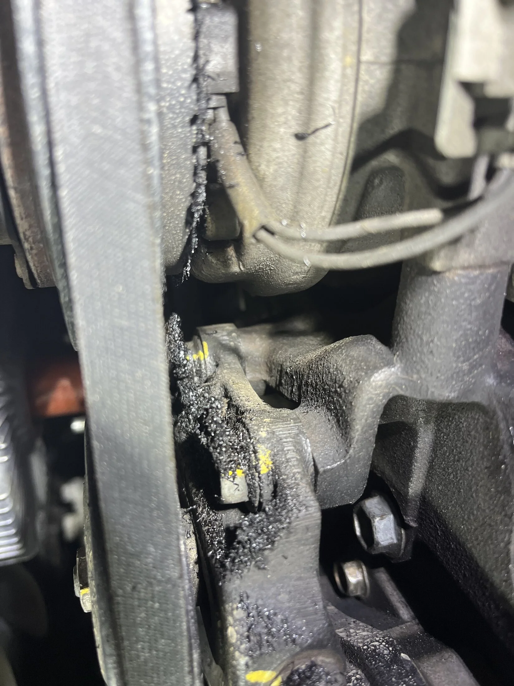

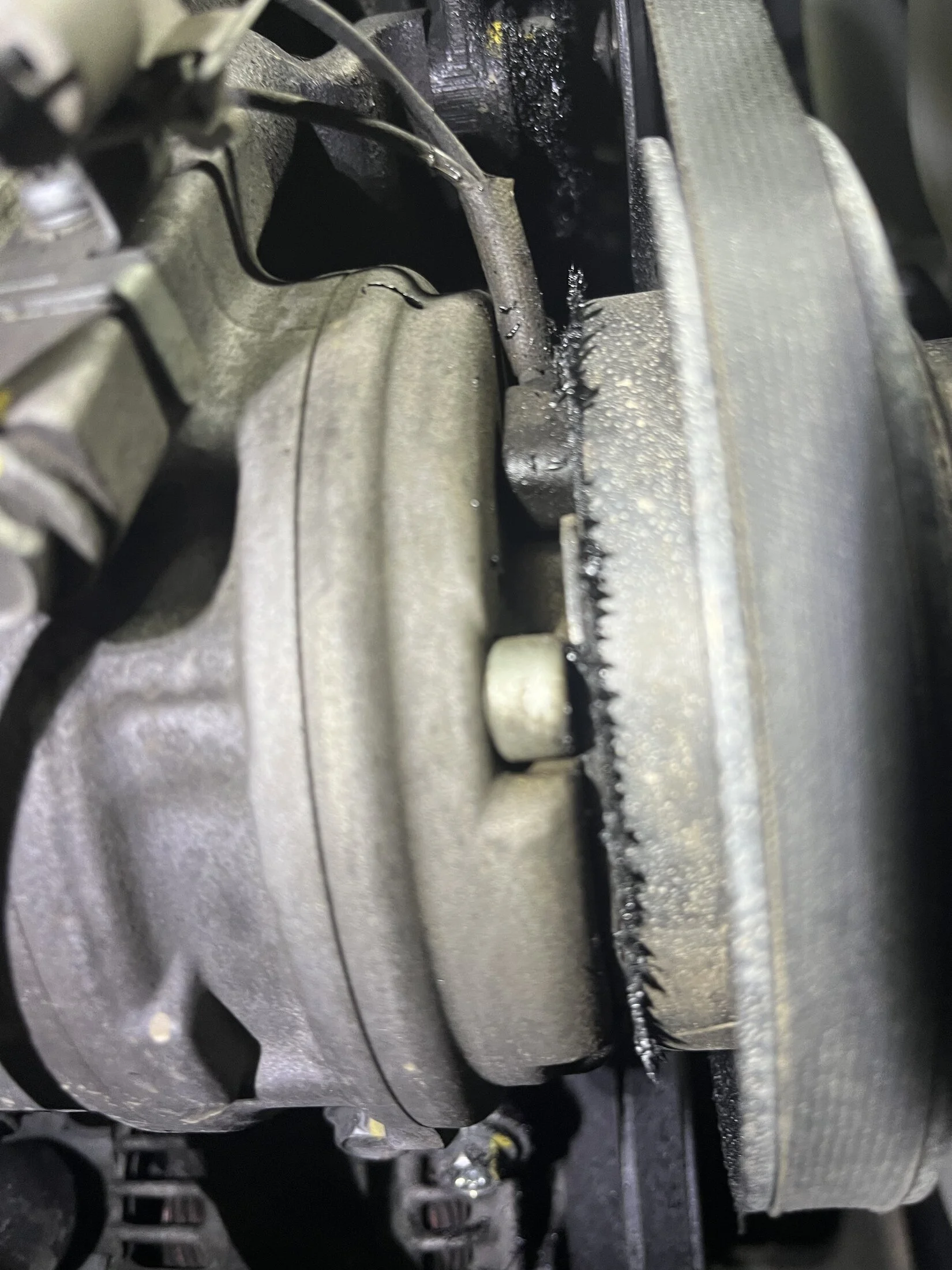

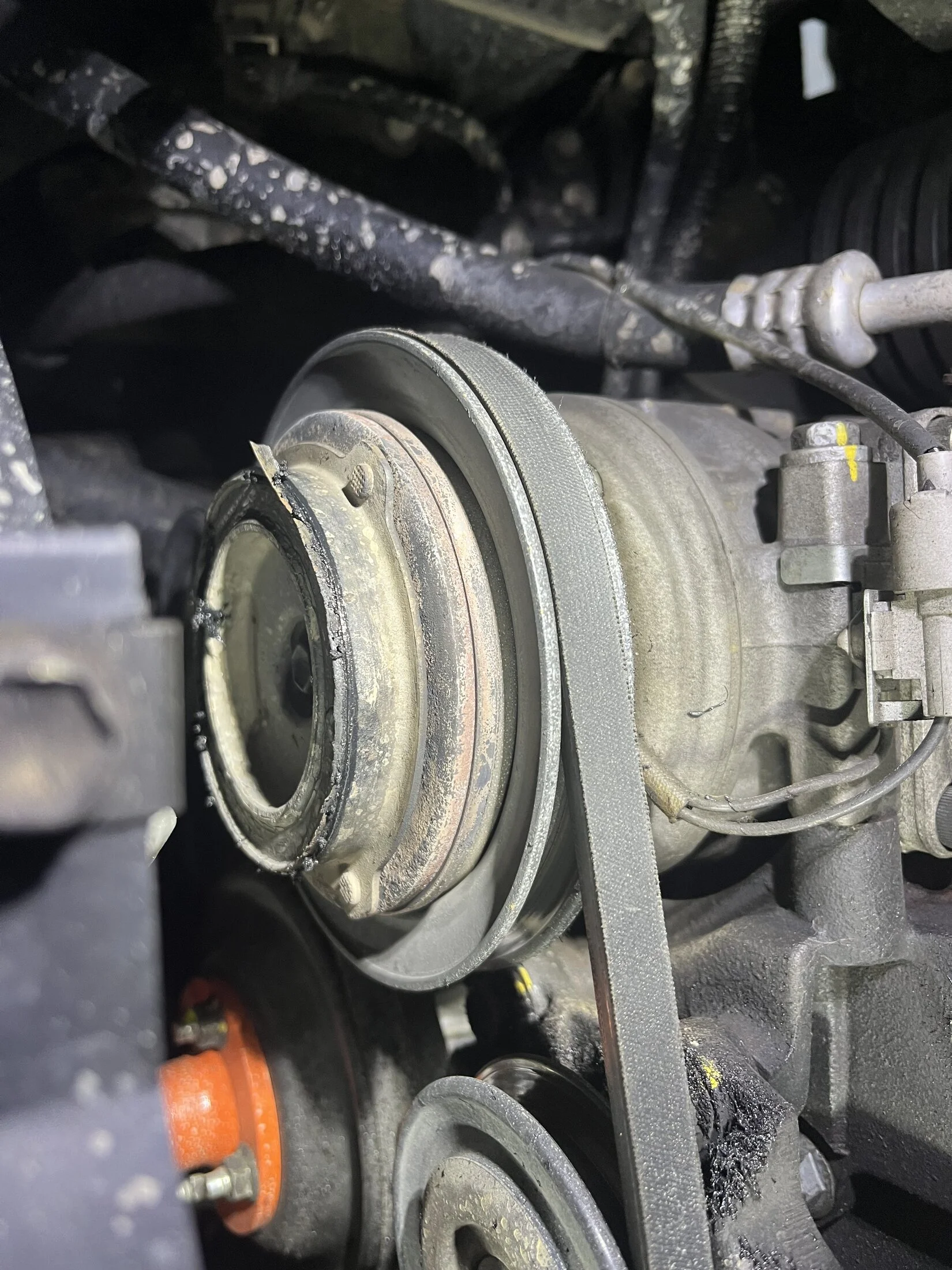

After clearing some space in the garage, i grabbed some light, popped the hood and here is what i found……
Clearly the AC compressor may have a bearing or seal issue. There is black lube as indicated in the pictures.

Looks like the ac clutch is slipping.
It’s likely what looks like “lube” all over the engine bay is clutch material due to a seized compressor.

If you have low volts to the compressor the clutch it will slip. That explains the smell. Heat=resistance..The 10A fuse is blown from the gauges it could have been caused by the slipping clutch.
Unplug the compressor clutch and change the fuse.
Ok, yes, it’s definitely not lube, it feels like melted plastic as it is solid to the touch despite its liquid appearance. Might have been liquid for a short time.
Alright, I just took the belt off and disconnected the electrical to the compressor. I replaced the 10A fuse in the “gauge” slot. Some quick research through google brought me to Mud and to this thread….
Either the compressor is seized or the magnetic clutch failed. I turned the compressor pulley by hand with the belt off and it spins but with a grinding feeling. Would it be worth pursuing a mag clutch rebuild or not bother and go with a whole new compressor? Obviously, a new compressor install would involve depressurizing the AC system of R12. Then the rabbit hole continues…..do replace the whole system to have R134a? Yes, one direction is much cheaper (new mag clutch) but if the compressor itself is seized, a new mag clutch is pointless. I have the FSM open and disassembly and reassembly of the mag clutch looks fairly straight forward. To test the compressor, I would have to get some gauges and follow the FSM. Sigh. Maybe just take it to an AC shop and see what they think? Also, is it safe to fire it up now that the compressor has been removed from action? Thank you for all of the help and advise.
