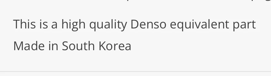

No thanks.
And CruiserParts: I wouldn’t buy a used toaster from them. Caveat Emptor.

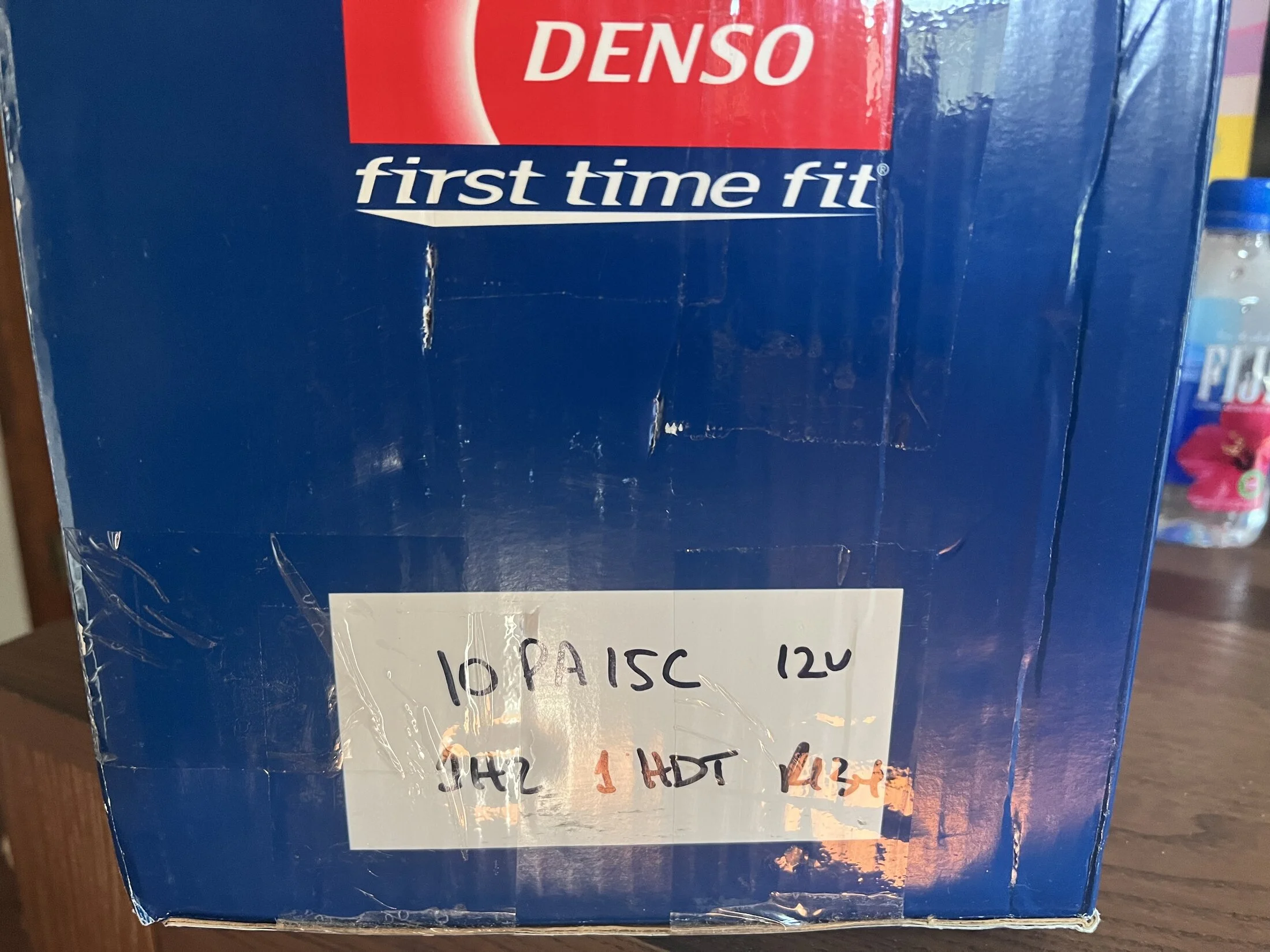

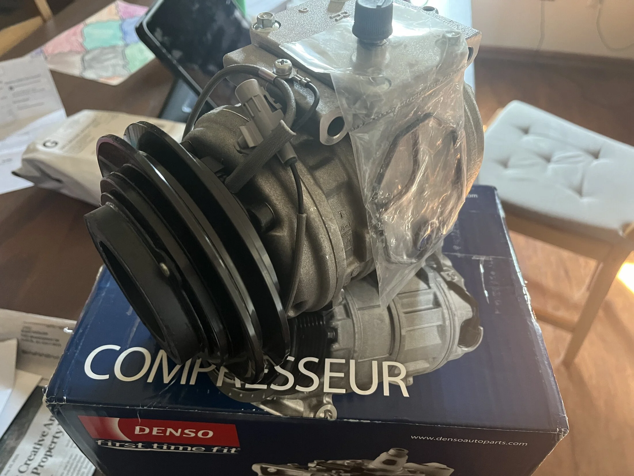

Ok great, thanks Tyler. Once this is all set, I will be in touch for completion of this project (vacuum, R134a fill, leak test etc….) the Radd cruisers compressor looks viable and is $450 USD plus shipping from Canada.
Update……
This arrived. I just need to make sure there is PAG oil already installed and then bolt it in, final check of all connections, final torque and fill system with R134a. Hoping to have some AC while there is some summer still left.

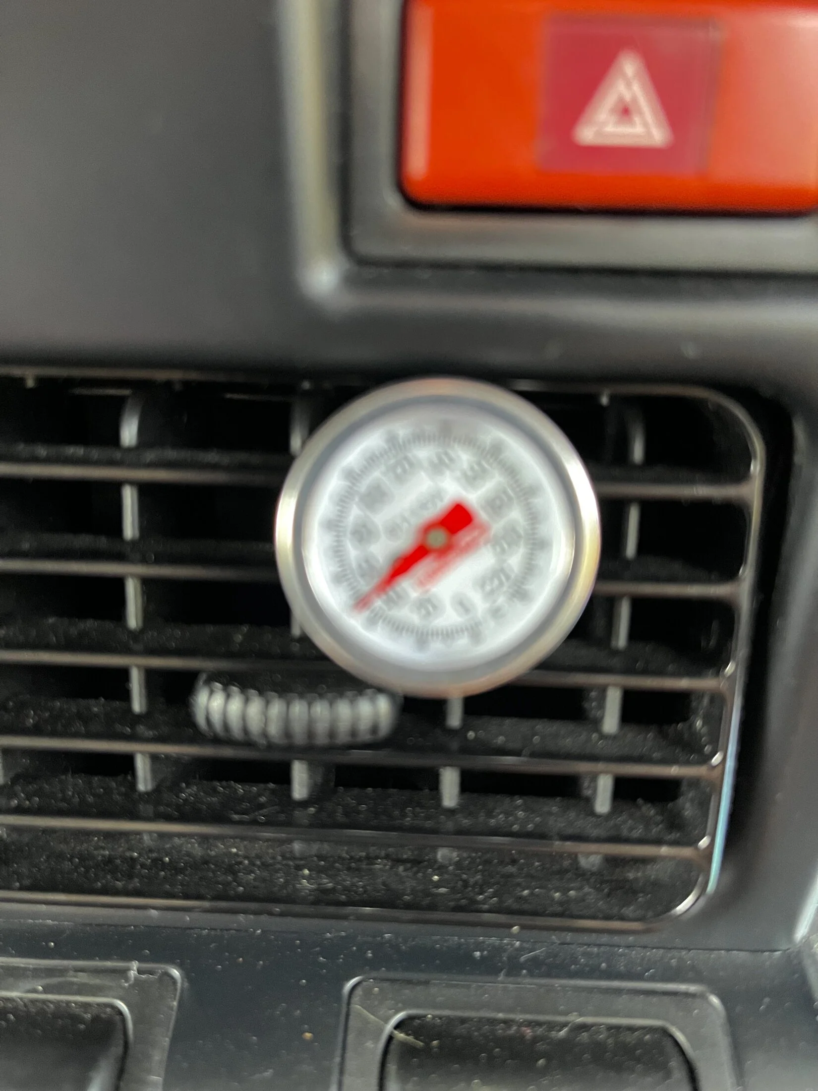

With the help from @TheBussman, R134a was pumped in only to find out it wasn’t taking the refrigerant charge (very slow) and high side pressure wasn’t increasing above around a 100 psi. @TheBussman kept the truck and found out that the expansion valve wasn’t working (seized). Tyler replaced the expansion valve, replaced some (or all) of the old foam surrounding the evaporator casing box, added refrigerant and voila! Nice cold air exiting the vents. I have a blurry picture of the thermometer that shows just under 50F coming out of the vents which suits me just fine. Just in time for fall weather! 😁
