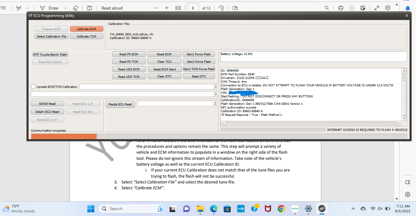

Since the exhaust and injector issues are (fingers cross) sorted for my GX, I finally upload the 87 octane Active Duty YotaWerx tune this morning. Initial impressions are that the midrange torque/throttle responsiveness are improved, full-throttle seems about the same. The difference is there but not dramatic, although I'll need to put some more miles on it to finish the ECU learning process. I was worried about how the transmission tune would play with my Nomad valve body, but they seem to work fairly well together. It definitely holds gears even longer than before (in a good way).
I bought the OBDII to USB adapter and a VF Tuner license allowing me to DIY change tunes and experiment. The actual tune process was really easy and took maybe 15 minutes. We have a camping trip planned later this month so I'll see how much towing is improved. I'll also try the 91 octane tune sometime in the future.

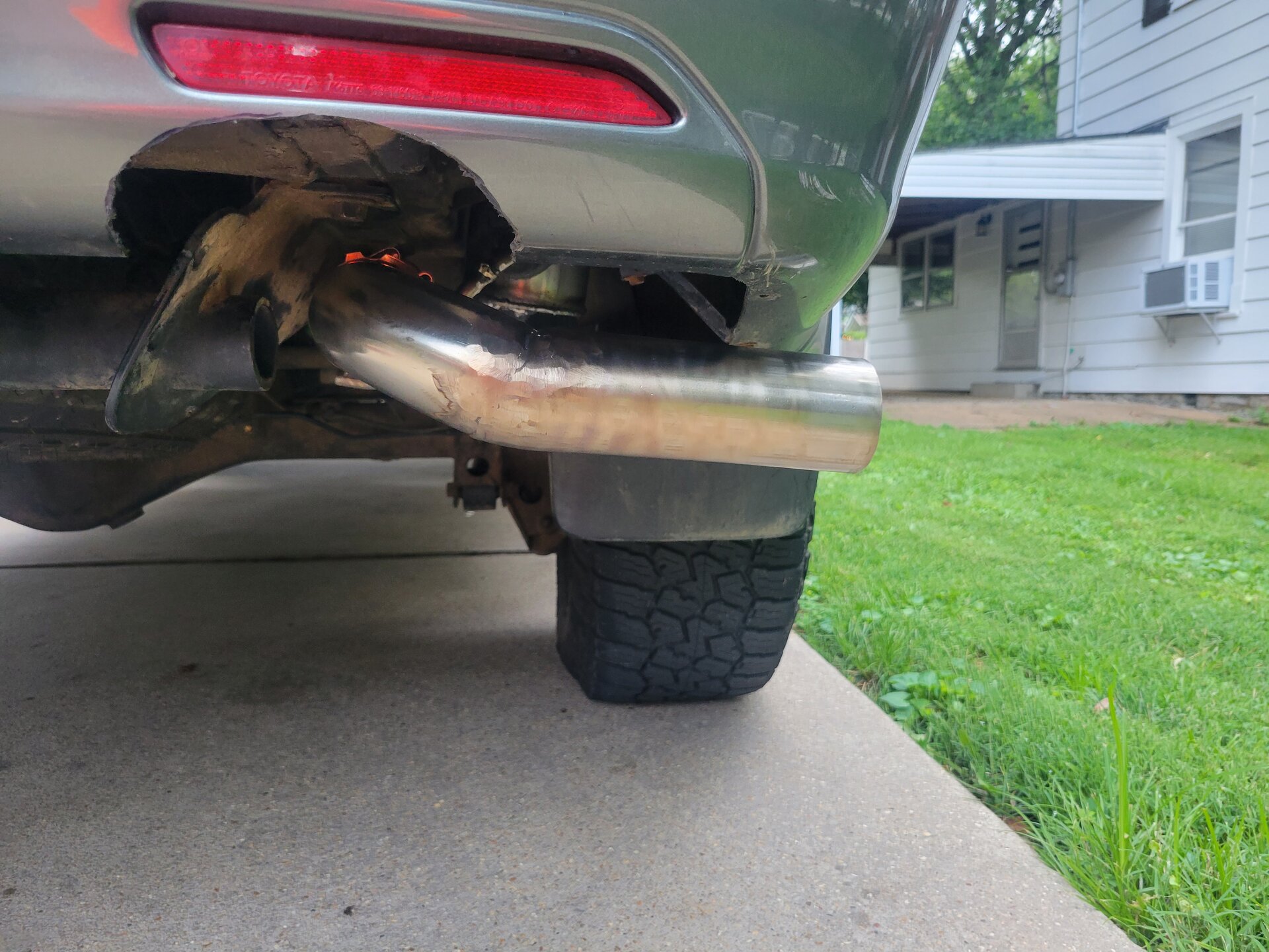

I set up the tailpipe with a slipjoint to allow the Borla tip to come off and a turndown to easily go in and direct exhaust off to the side (similar to the Magnaflow Overland). I ran it with the old Borla a time of two off-roading and it was actually a bit louder, but didn't tow with it. Will try it both ways with the camper and see how it works!

I also built a rear 90-degree piece to shoot the exhaust straight out the side of the GX for use when towing to reduce the sound bounding off the front of our camper. I sliced up a 90 degree and 45 degree 304 SS elbow to make this - fabrication skills are not great but improving. Having the much nicer Hobart welder helps too.
And I still have my turndown for improving clearance when off-roading.

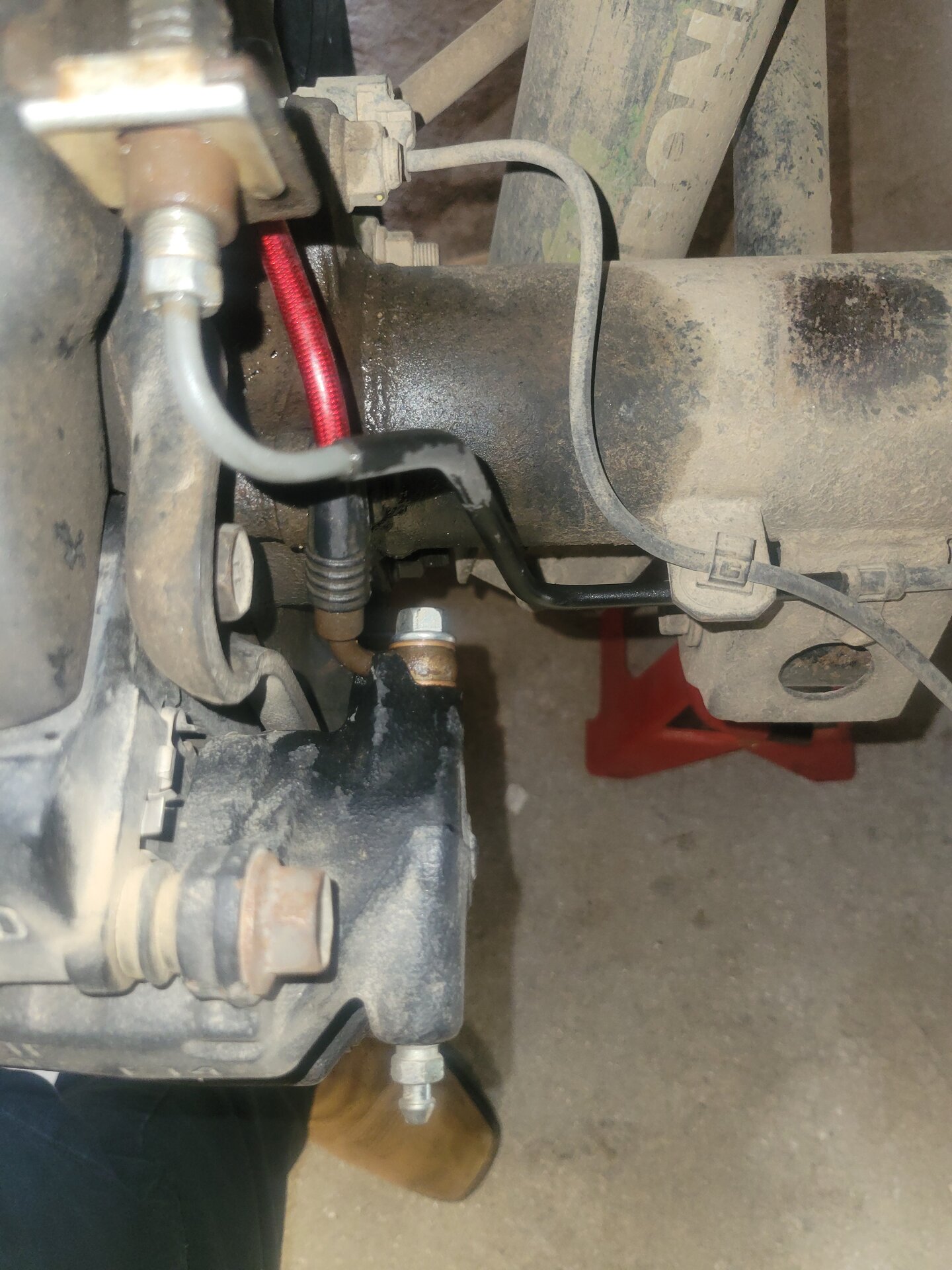

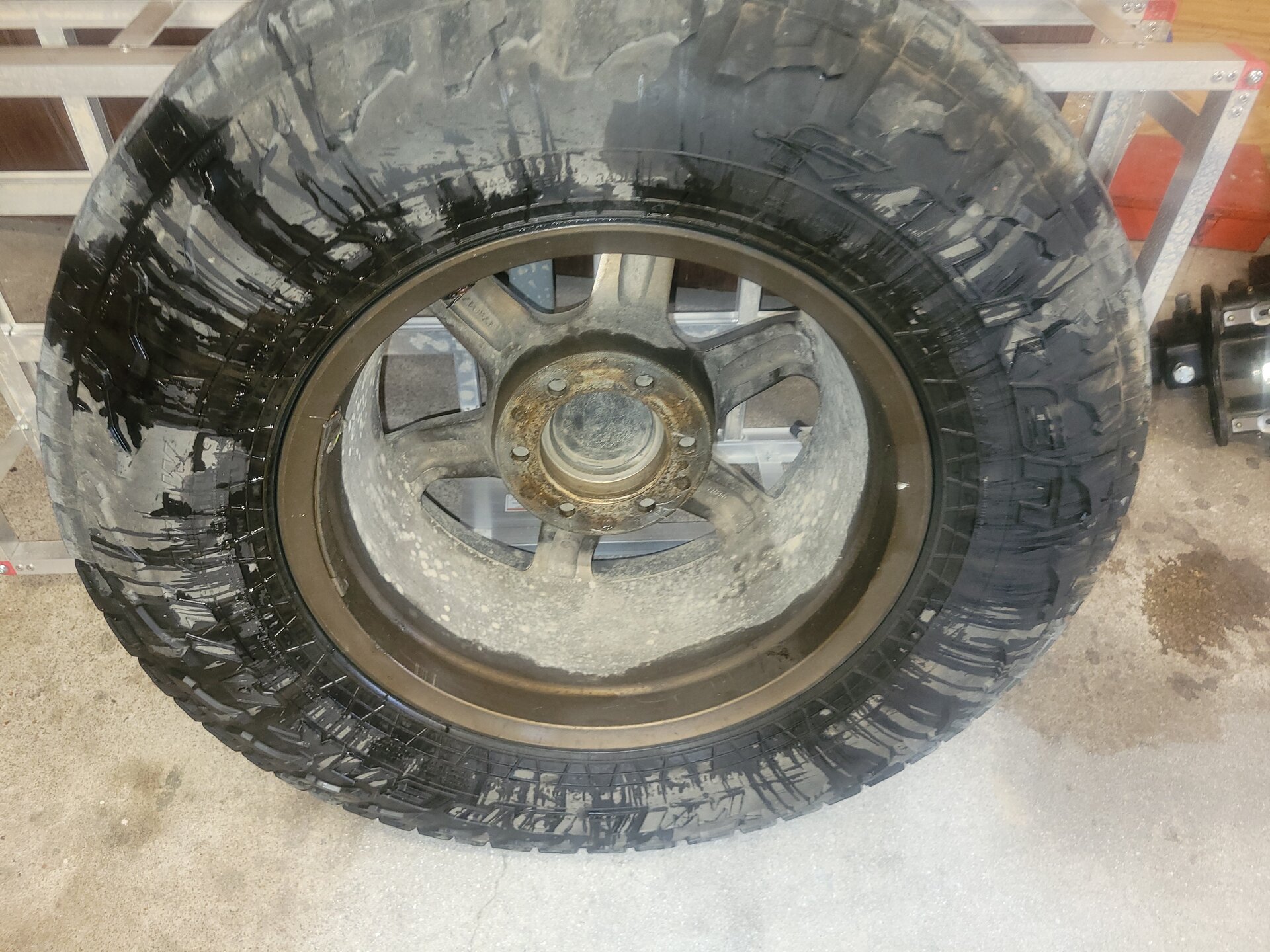

I'd been having some issues with rear brake noise recently, which I finally isolated to the parking brakes. I pulled the rotors and cleaned the brakes, only to have the issue re-appear. So tonight I pulled them off and found they needed some more adjustment, and that one of the retaining springs/clips had failed. Pretty easy fix, and now the parking brakes work perfectly.
But....when I pulled off the DS rear tire, the entire inside of the wheel and outside of the backing plate were soaked in brake fluid. I had pulled our camper around 135 miles yesterday and noticed an odd smell (almost like burning rubber) that I couldn't isolate. This must have been it. The leak was coming from one of the PowerStop SS lines, at the fitting between the SS line and hard line going into the caliper. I had pulled the calipers when I initially pulled the rotors and cleaned the parking brakes, so that must have caused a failure in the line (which should not have happen as I worked not to kink it). I called PowerStop and filed a warranty return.
Super glad I mis-adjusted the parking brake the first time and had to pull the wheel off tonight, or I might not have noticed this until the brake light turned on. Also very glad I didn't lose brakes while towing yesterday. Hopefully PowerStop comes though and overnights me a new line under warranty, since the GX is now an ornament in my driveway.

Keep us posted if the warranty claim works in your favor.
I replaced all my brake hardlines and softlines with Toyota oem….just because they were 20 years old. Kept the old ones as spares.

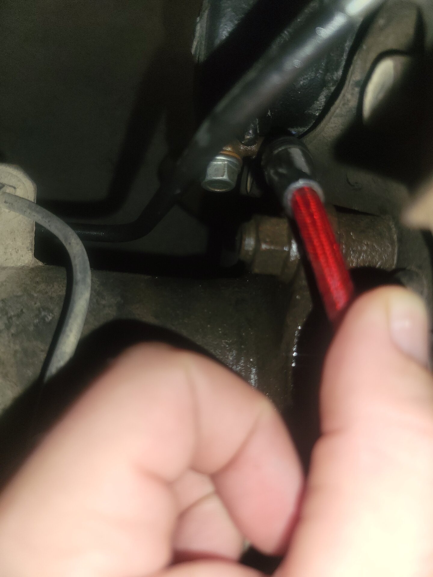

The hose is O.O.S. with PowerStop until 9/20. I can get a new rubber one from NAPA for $28 tomorrow as a temporary stop-gap. I requested that PowerStop reimburse me for the stop-gap hose; we'll see if they do (if not I'm scratching their brake rotor/pad upgrade from my list and will get it from someone else).
Regarding the hoses, I originally had a OEM hose go bad in the front after swapping a caliper (must have gotten pinched), so I replaced everything with the PowerStop kit on the presumption that they'd be tougher and longer lasting than the 14-year old OEM-style rubber hoses, and that the braking performance would be improved. Plus the kit was only $90 from RockAuto, and I got it overnighted to get my rig back on the road. In hindsight, I would have just ordered all OEM hoses (as @HomersCanyonero did), but from Partsouq to save on the cost. The SS lines didn't make an appreciable difference in brake pedal feel/power. Unfortunately I had pitched the old ones too - should have thrown them in the old parts pile in the shed.
EDIT: PowerStop is not wanting to play ball on the nominal $28 credit, plus a replacement SS line, based on me needing to buy a the stop-gap temporary hose due to it being OOS for a few more weeks. Maybe they'll come around, but if not I'm not going to spend a bunch of time arguing back and forth with them over $28. Instead, when I do get around to a GX460 brake upgrade, I'll try a set of Aussie DBA kangaroo pad rotors and EBC green pads instead.
I hope the do you good at least with the warranty. you can always carry the Napa one as a trail spare.
I did get my brake hoses from partsouq…it’s a benefit when you can replace them at your own timeline as preventive maintenance rather on emergency.
