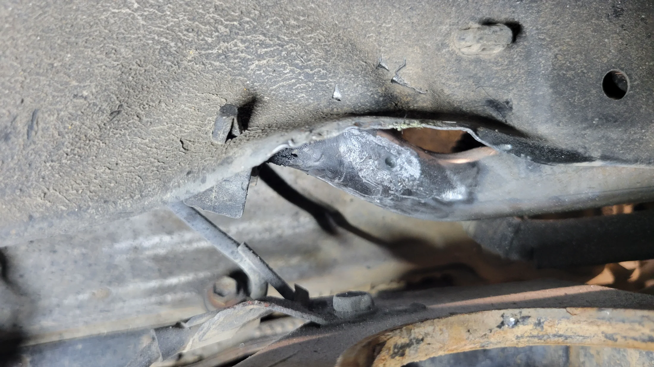

^So here is the skeleton in the AC closet. In 2021 when I was installing the lift, I cut off the top of the OEM strut with a sawzall due to the bolts being rusty/rounded off. I had no idea there was an AC line behind the strut....until the tip of the sawzall blade pierced it and I lost all of my Freon. This is a single hard line that runs from the AC condenser all the way back to the rear AC. I don't think it's removable without cutting it up. So in 2021 I used some ALUM-BOND epoxy for the repair, which worked just fine until last week when the repair finally failed (note this photo was taken after I had bent up the inner fender for better access).

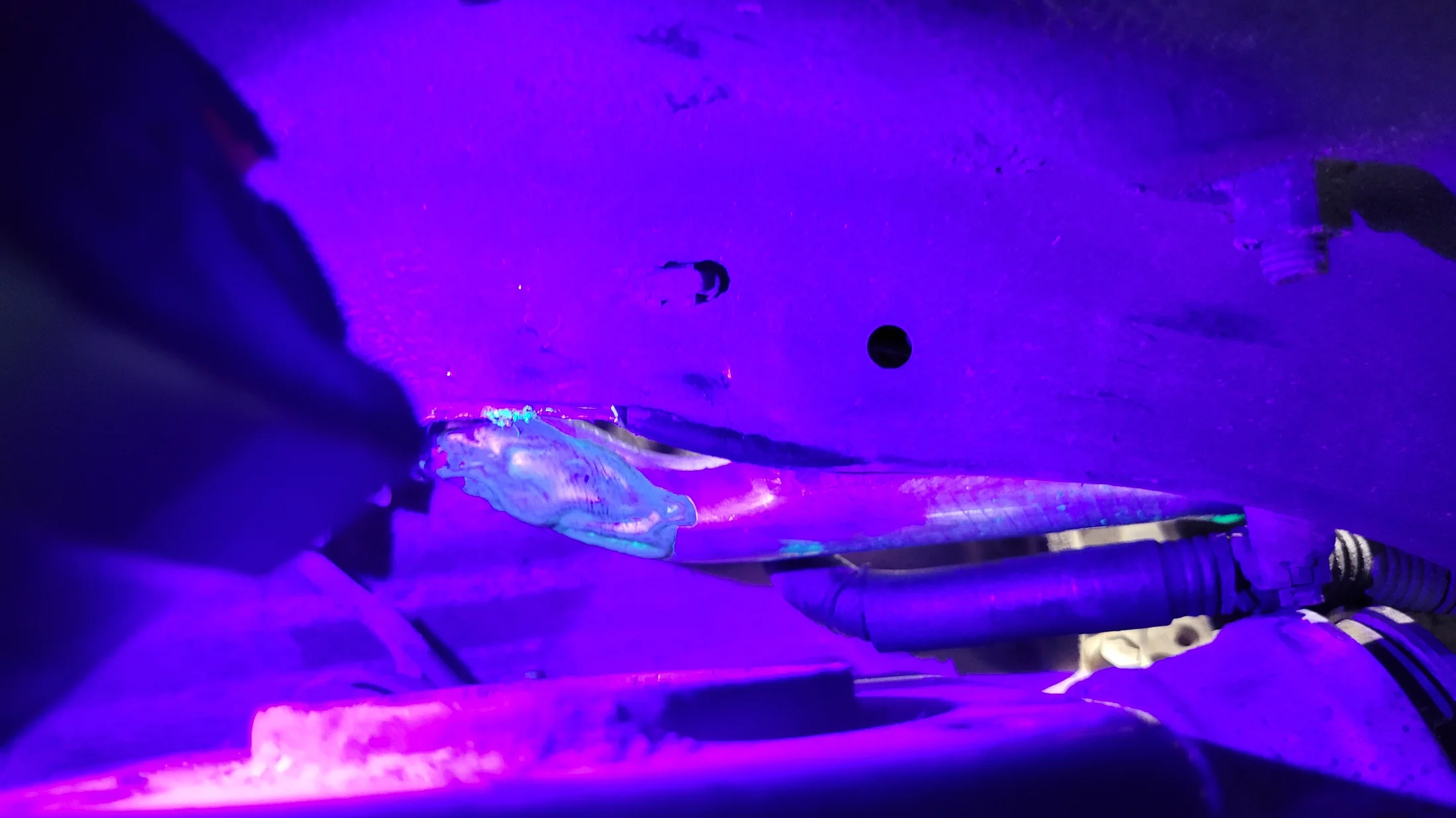

^With the UV light on. The corrugated plastic sheathing was full of UV dye and PAG oil (not showing here). It's apparent that the Freon/dye had soaked into the epoxy repair.
^About half the epoxy came off with a pick. The rest came off with various Dremel attachments. It's pretty thin at the original pinhole location. I have a nice MAP brazing torch and aluminum brazing rod with flux coming in later this week, and I'll attempt a permanent repair. Haven't done a lot of brazing, so hopefully this holds. If not I'm back to ALUM-BOND or trying to find a mobile TIG welder.

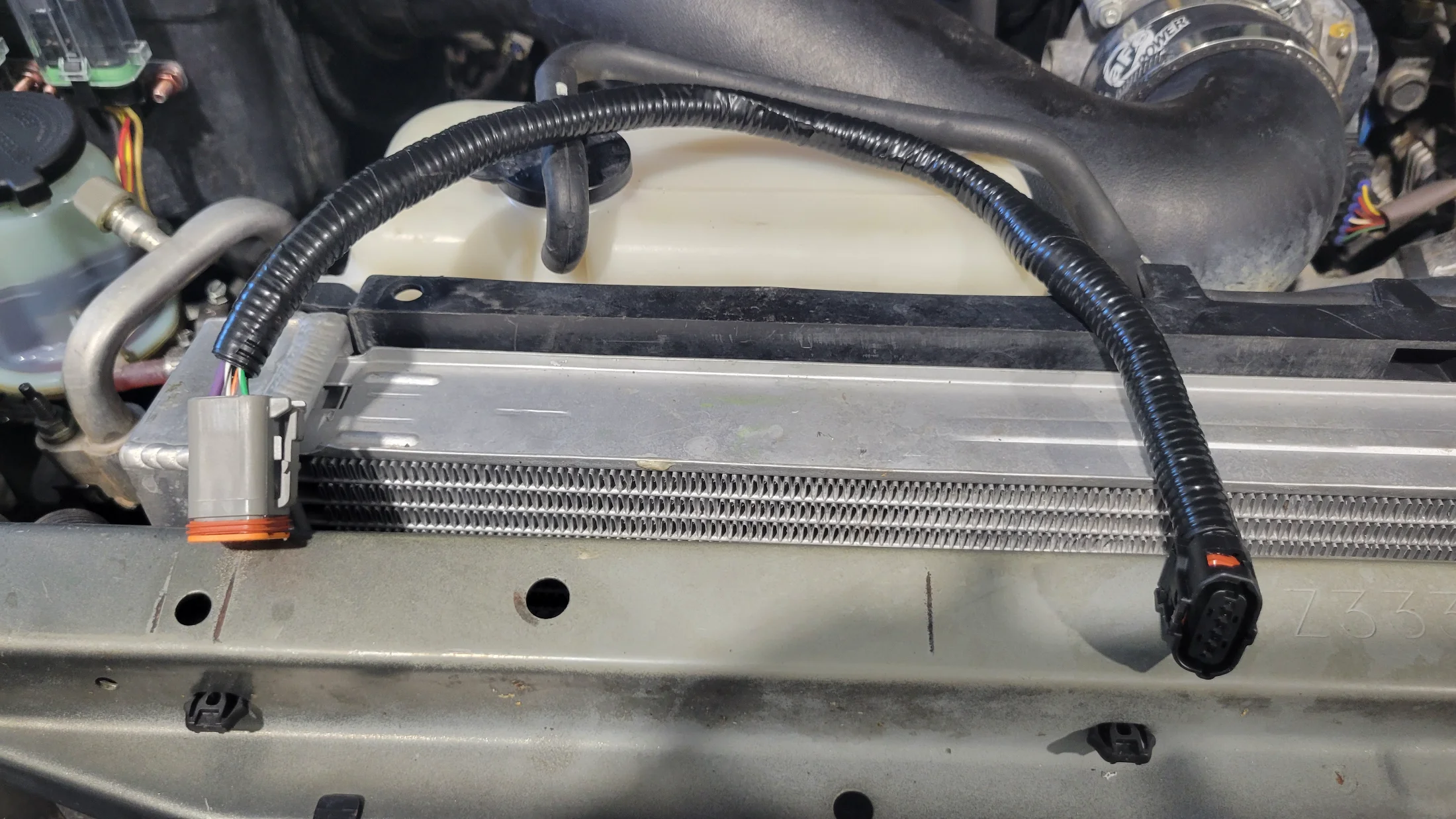

^So, I made a new MAF pigtail. This included a new Amazon MAF connector, with a 6-pin male Deutsch connector on the other end, that goes into another 6-pin female connector that I spliced onto the OEM MAF harness branch of the main engine harness. I've had great luck with Deutsch connectors in other sensor applications as the connection is robust, they have nominal resistance, and they are watertight. And, if I ever have another MAF connector issue, I can just replace the pigtail without having to cut off more of the OEM harness.

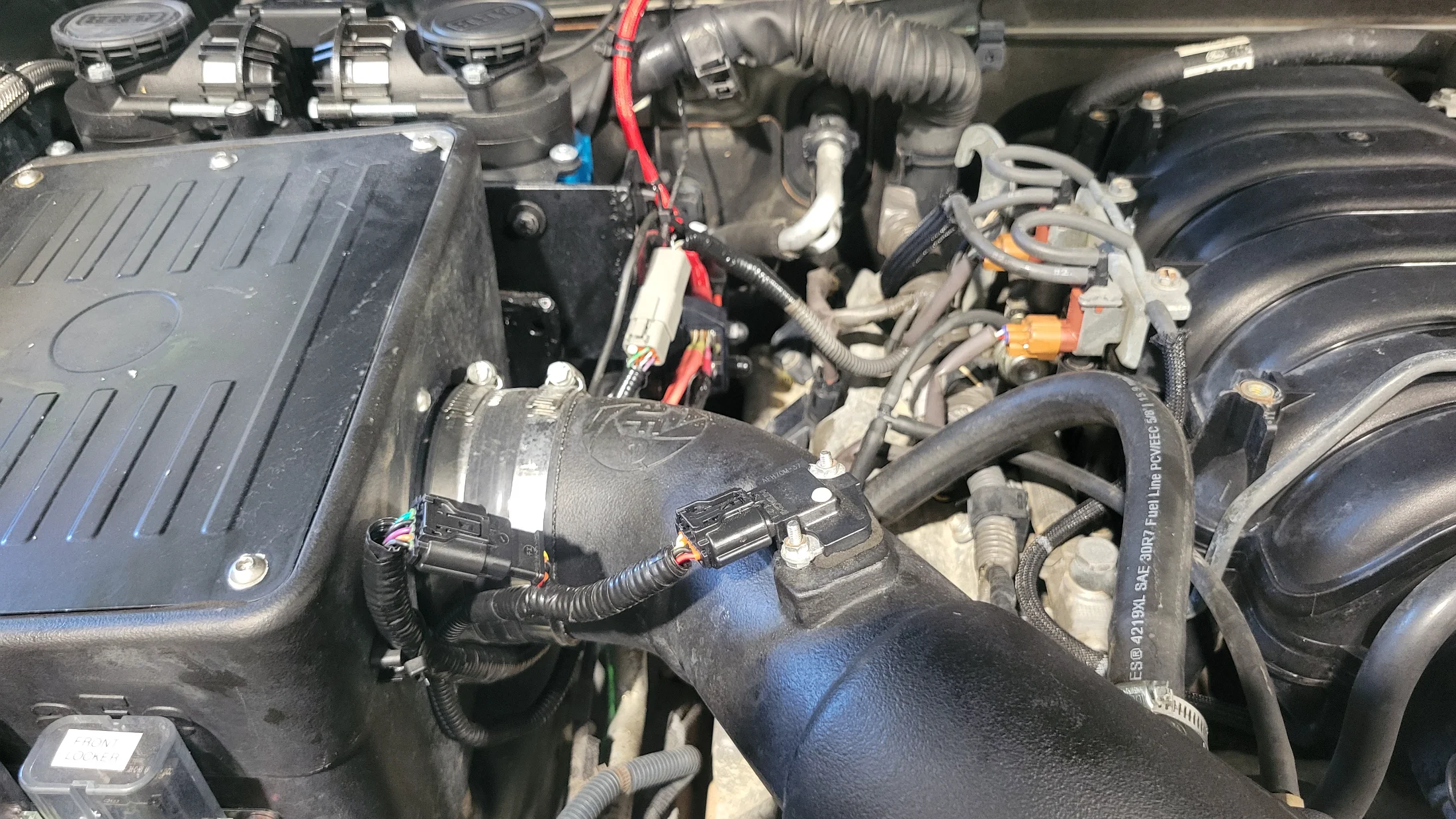

^Here is it installed (the female Deutsch connector is on my ARB twin bracket - also note that the rig has a Hewitt Tech SAIS bypass which plugs into the MAF too). I went ahead and built a spare MAF pigtail and threw it in the spare parts stash in the back of the rig. Upon startup, STFTs were way lower, indicating that I indeed had a problem in the MAF wiring before, where the MAF was under-reporting the amount of air getting to the motor. It it continues to have issues I'll try running with the SAIS bypass removed from the MAF wiring.

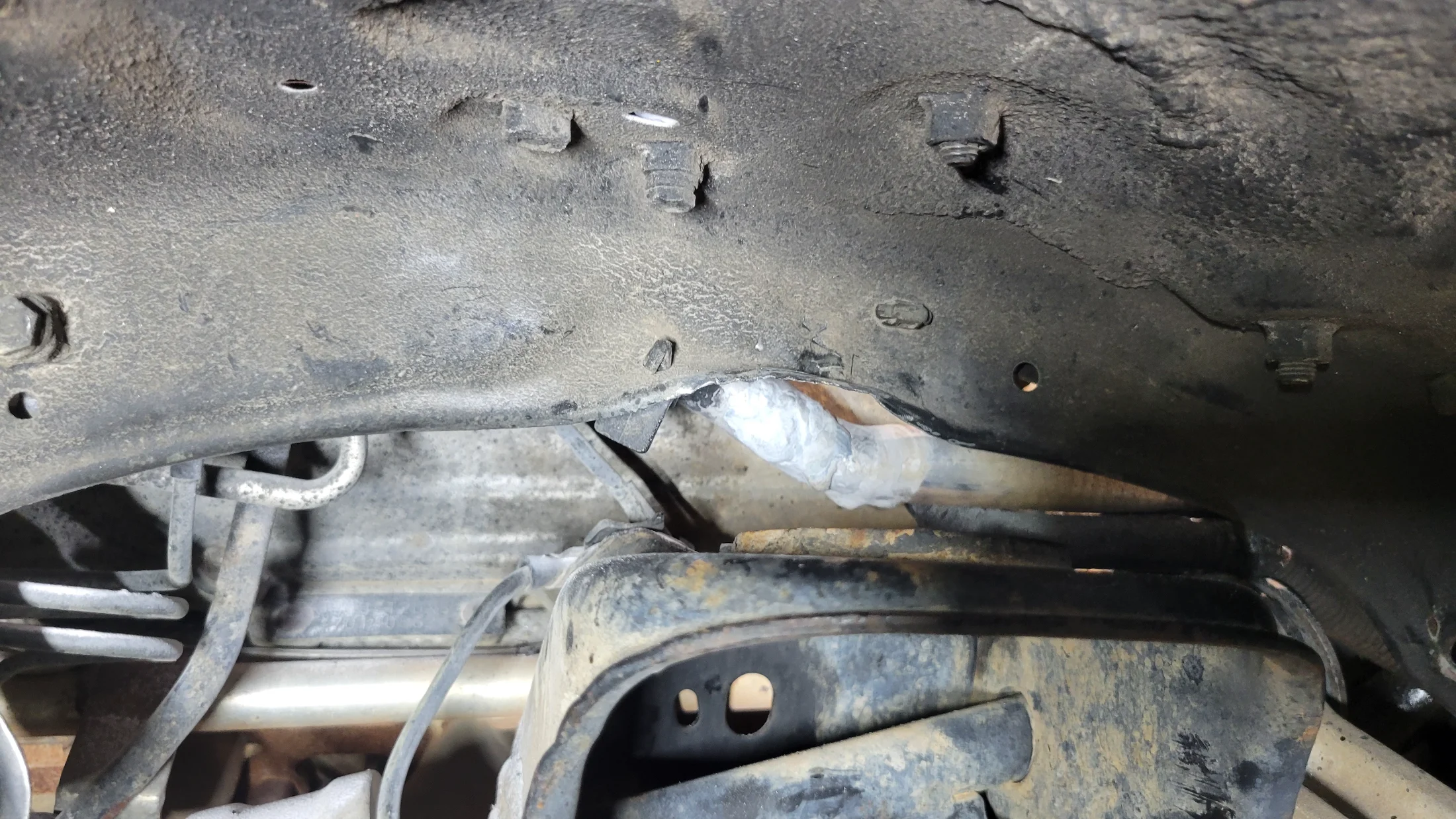

^Brazing completed. My first job...and it shows! I had a hard time due to the pipe being angled...it kept running to the bottom. So I started brazing higher up and put several layers over the damaged part of the line. But, realized the plastic AC line brackets are quite flammable! Ultimately, this did work though. The AC held vacuum all night (no loss) and is recharged and blowing super-cold. Some of the pressures are a bit wonky - low side is a bit too low and high side is a bit too high, so I'm crossing my fingers that it doesn't also have a expansion valve problem (as I don't want to rip the dash off again).

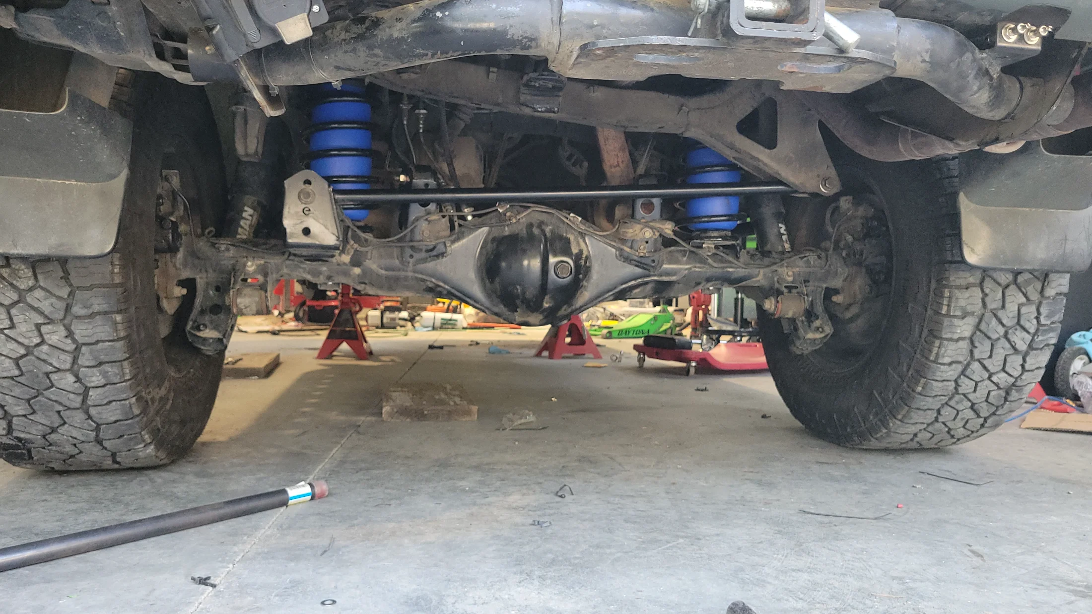

^Dobinsons C59-677V rear variable rate coils vs. Ironman stock load coils. Huge difference in robustness and build quality. The Dobinsons were a bear to get in. I had to (as they recommended) unhook both rear UCAs, the panhard bar, the rear shocks, and sway bar links. Then, with a jack under one side of the axle (to lift it), I could muscle the other side in with some help from Mrs. Rednexus.
^Rear all buttoned up, including a new set of Firestone bags as I was running the old bags at 50 psi to compensate for the crappy Ironman springs (they are only rated for 30 psi - and that's a legit rating as they definitely deformed at 50 psi). The PS bag has a minor leak I need to find as well.

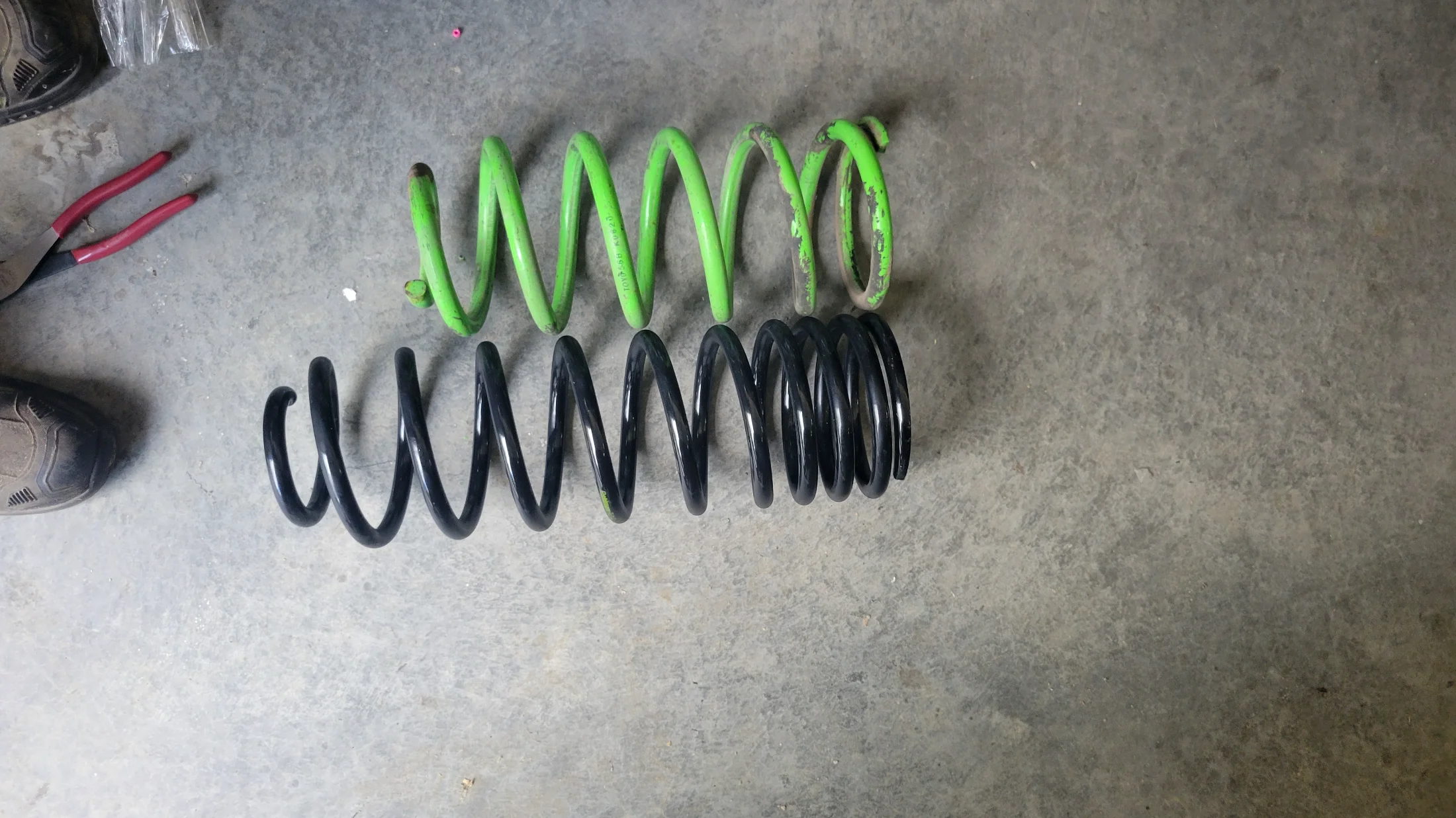

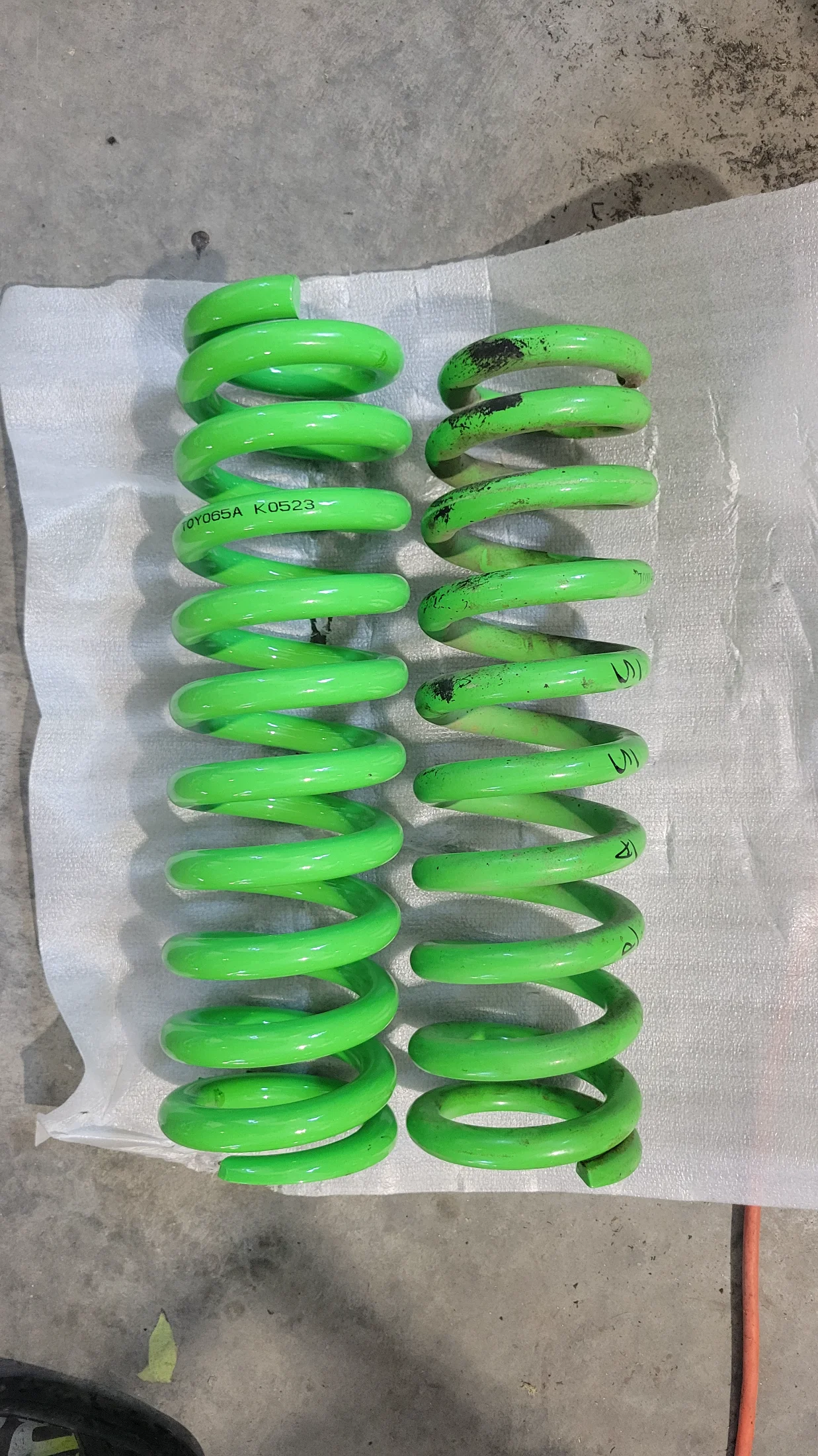

^Ironman does seem to have upped their coil game. My old coils (2022 warranty replacements are on the right), new are on the left. The old ones are 2.5", the news ones are 3". Both have the same spring rating, yet the new coils have a much larger wire diameter. They should have only been 0.25" different in length, yet the old ones are like 0.5-0.75" shorter. So...yeah they really sagged.

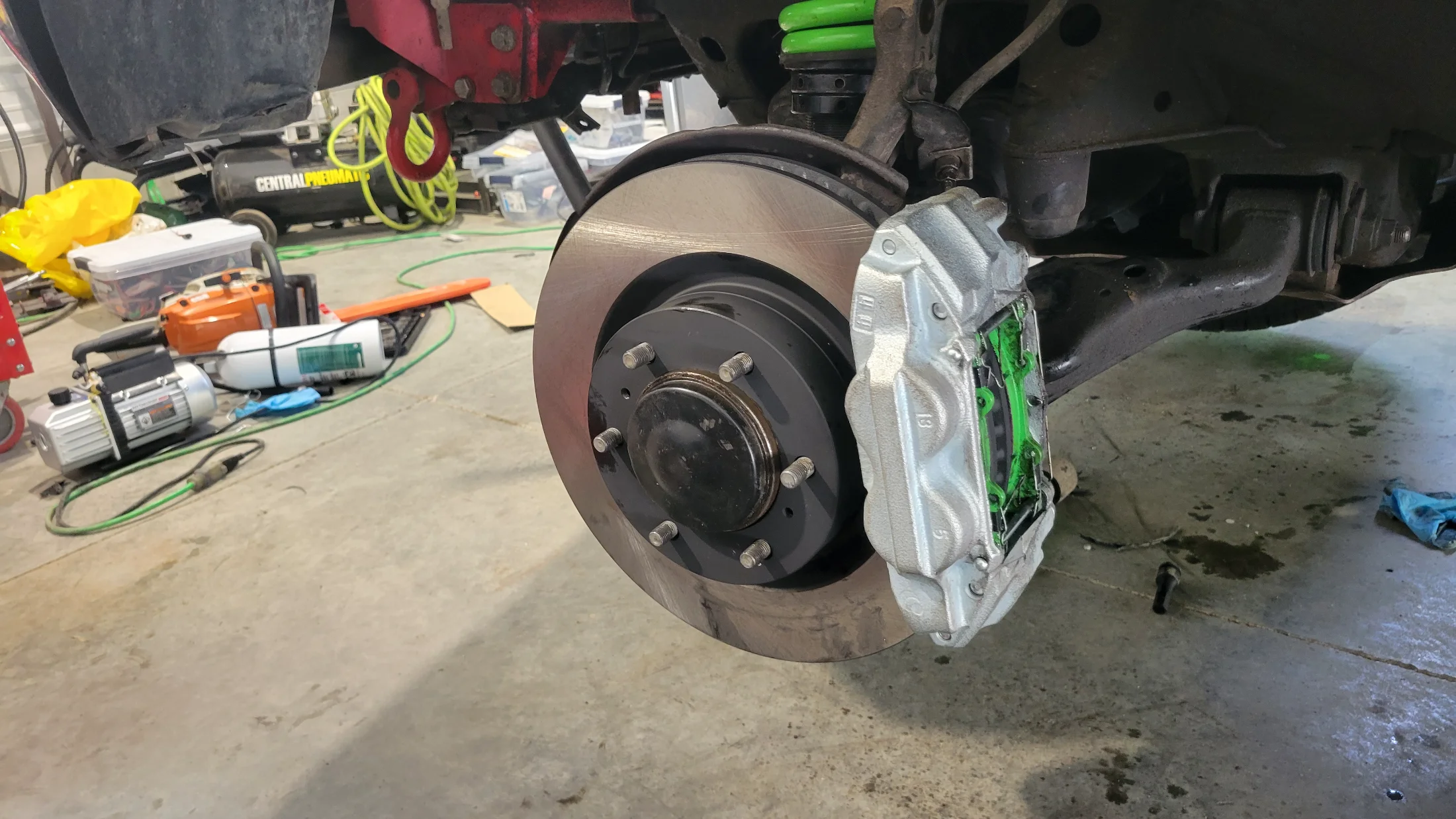

^New OEM GX460 rotors, calipers, and new EBC green pads. The 460 rotors are quite a bit bigger than the 470 rotors! It took my 470 rotors about 60,000 miles to warp (and they were Bosch rotors, not OEM), so I'm hoping to get 70,000-80,000 miles out of these OEM 460 rotors. I also put new OEM 470 rotors and EBC greens on the back (and re-used my old calipers as they were ~2 year old NAPA remans), but didn't get any pics.

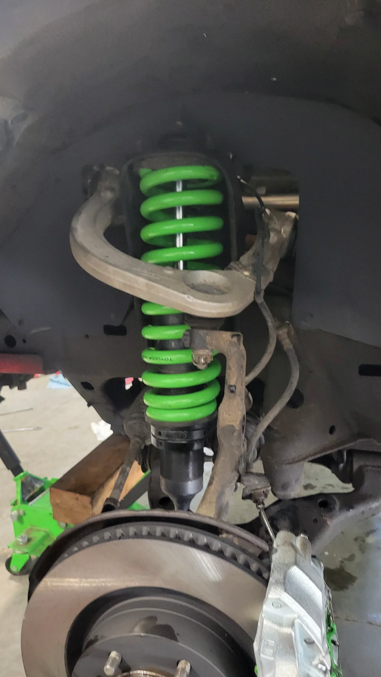

^New Ironman front springs installed. I used the on-the-rig compressor method as my threaded spring compressors were too big for the Ironman coils. I augmented it by dropping the lower spring height on the shocks to the near-bottom. Honestly, it worked great and was much less sketch than using threaded spring compressors. But, it was kind of a pain to spin up the lower spring perches using the Ironman spanner tool. On the PS side I had to push the tool forward about 1/3 of a turn at a time with my feet. On the DS side, I was able to pull it towards me, which was easier. Soaking everything in Kroil also helped quite a bit.

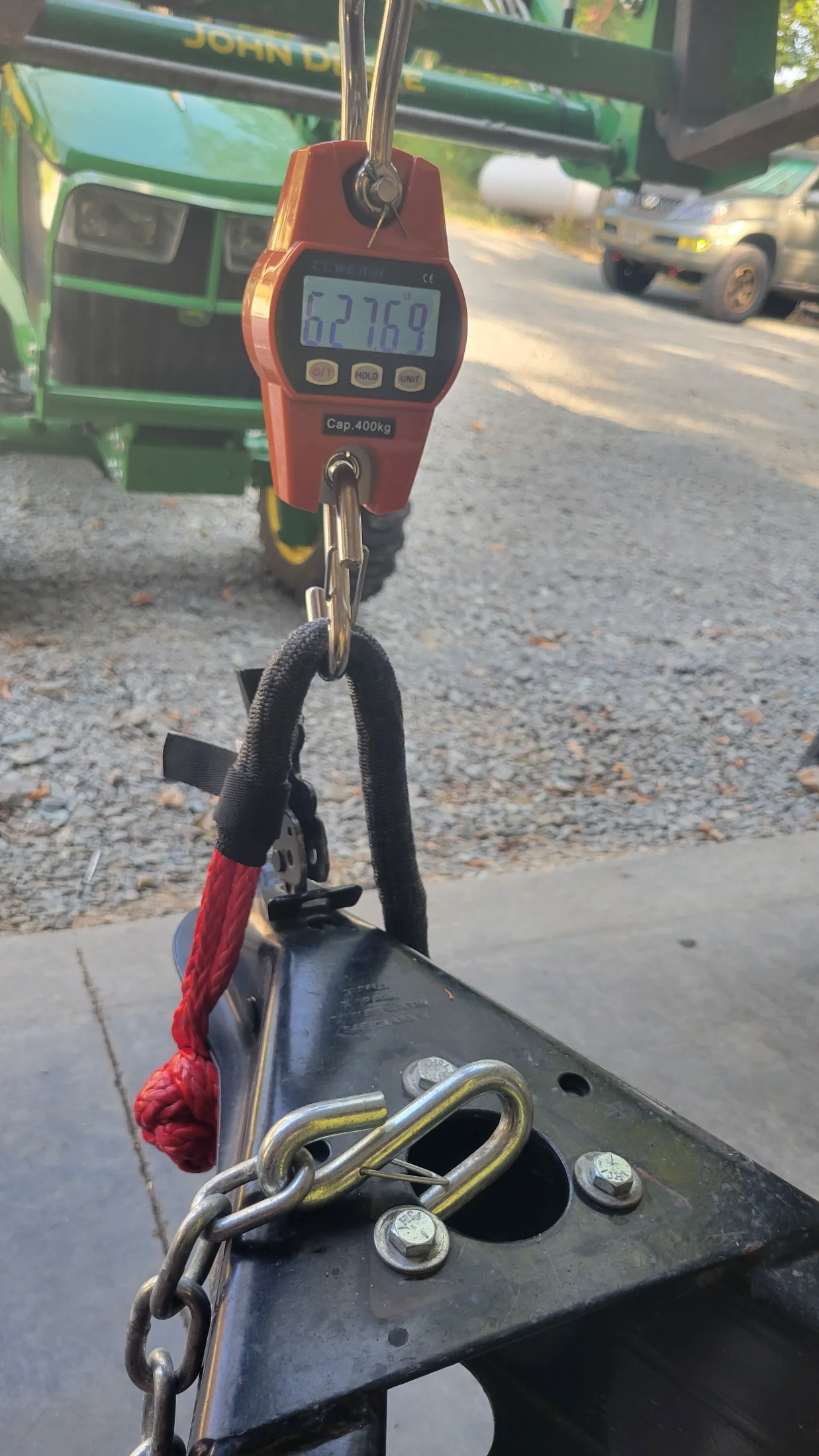

After my spring woes, I had a suspicions that the tongue weight on the camper was quite high. A Chineseium scale from Amazon confirmed my thoughts. It was darn near 630#! On a trailer that's only 3,200# empty! I'm sure this contributed to the premature demise of my Ironman rear coils. The thing is that the rig towed so nice and stable initially that I didn't even bother to check the tongue weight! Lesson learned.
I'm going to relocate the battery to the rear of the camper and go down to 1 propane tank. I can probably get it in the mid/low 500s, but it's doubtful it can go below that. For future trips, I'll likely use @rav8's method of running bags-only on short trips and just deal with running the WDH on anything that's more than a 3-hour drive away. Having the SpeedTurtle trailer jack will make WDH use a lot easier than it was with a hand crank.

This was mine before relocating the batteries. 3100lbs with full propane tanks but otherwise dry. I was about 390lbs after the switch to a Battleborn 100AH under one of the dinette benches and right next to the inverter. Single axle tongues tend to be heavier than the 1/10 rule.
A TrailManor is also (intentionally) a very tongue heavy trailer. I think 14% is their target spec. It supposedly to reduce sway, which is true as I pulled the camper through some 40-50 mph cross winds in MT and it didn't sway a bit. But, we still run a sway bar anyway, so I'd be happier with a bit less tongue weight :).
