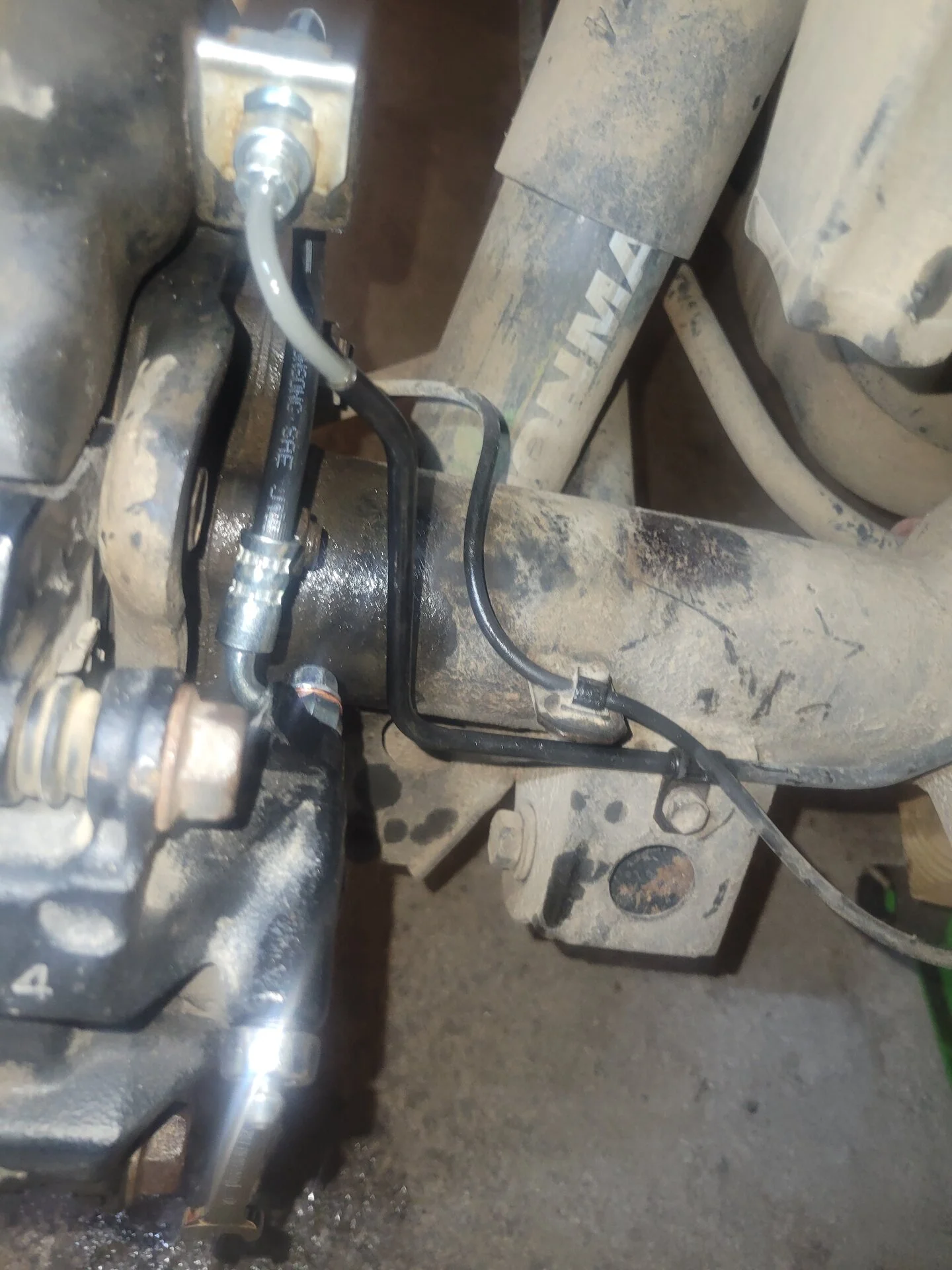

New NAPA hose is in. 15 minute job including bleeding - gotta love how quick the electric-based brakes on these bleed.

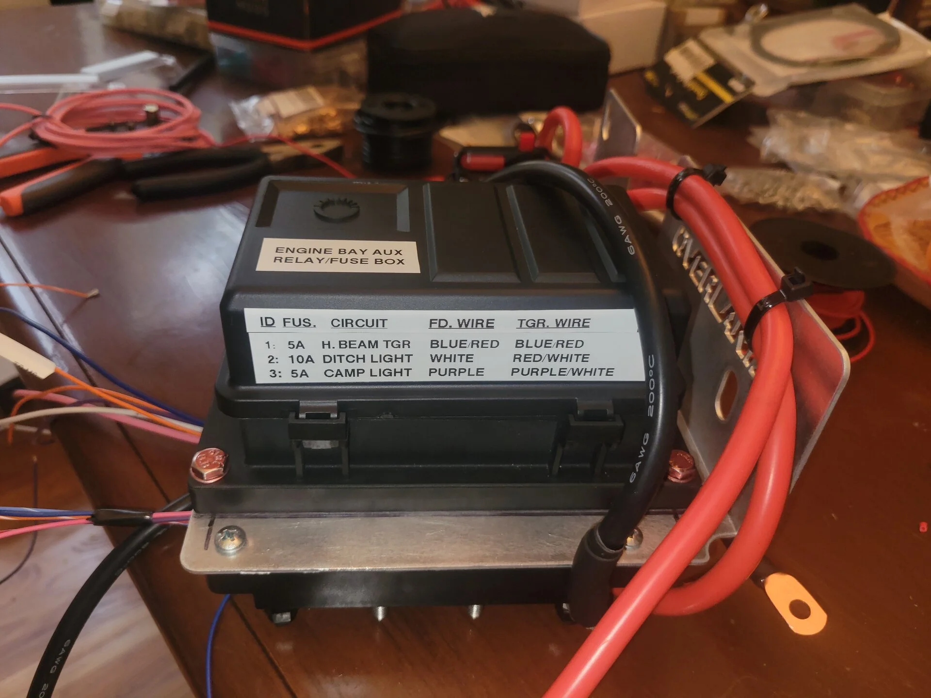

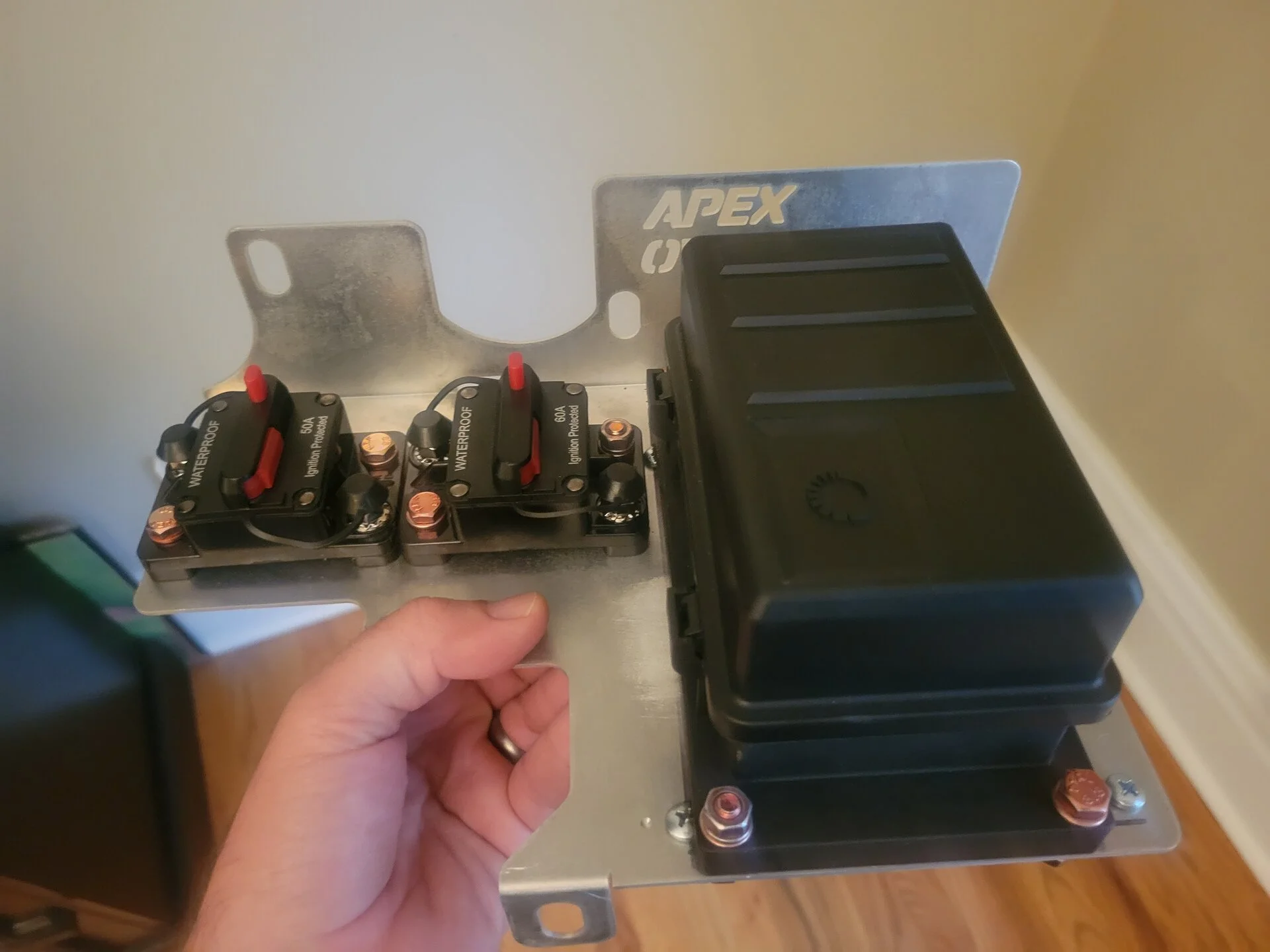

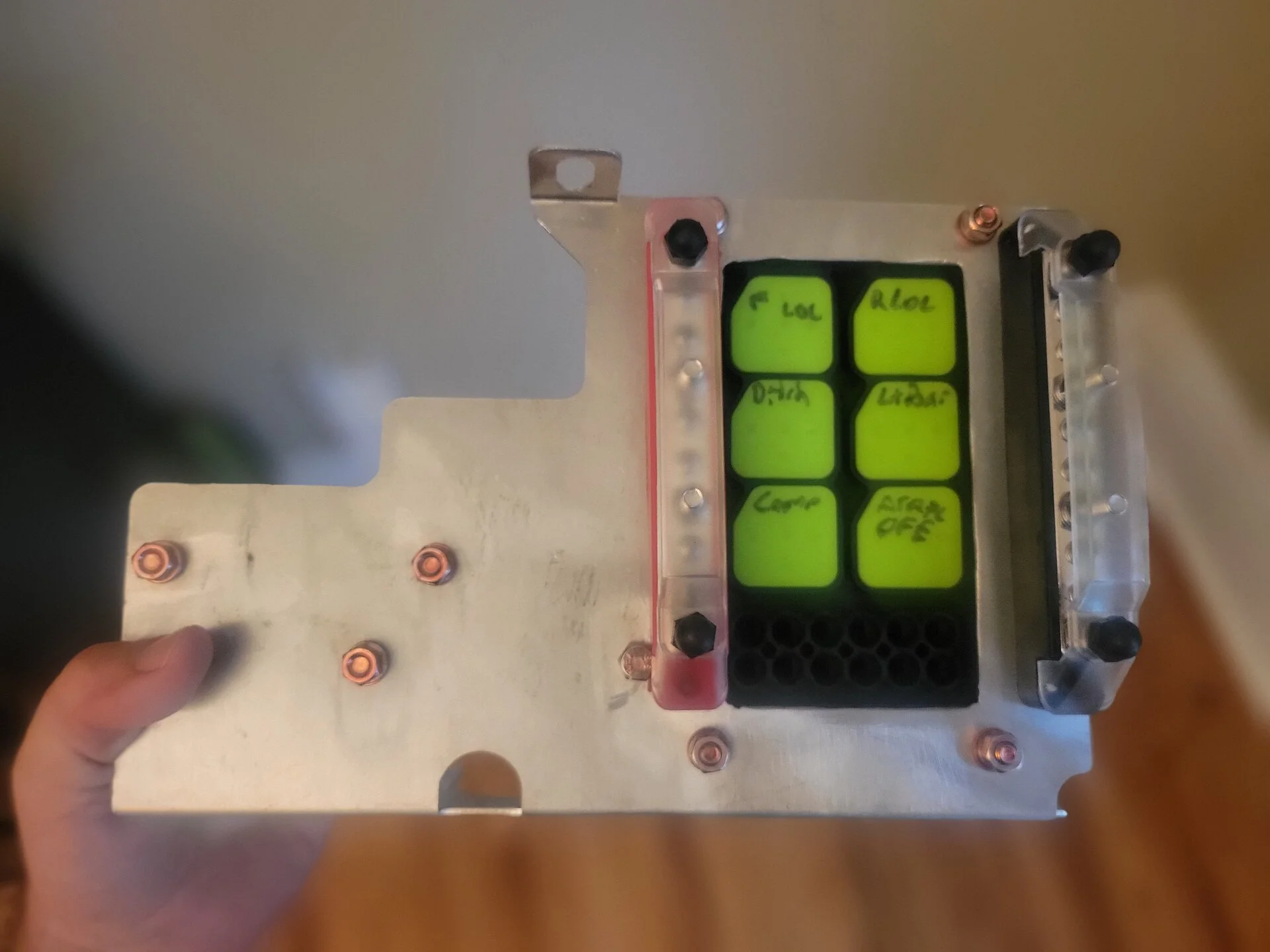

Started some "light wrenching" where I didn't even get dirty this weekend. This included starting the buildout of my DIY accessory/relay fuse box on the Apex Overland mount. This does fit, but required relocating the fuel pump resistor down lower (I'll post pics of that later). It also will require some trimming to provide more clearance for the harness coming out of the master cylinder. However, I'm pretty happy with it for $30; I would have spent more than that DIY'ing one.

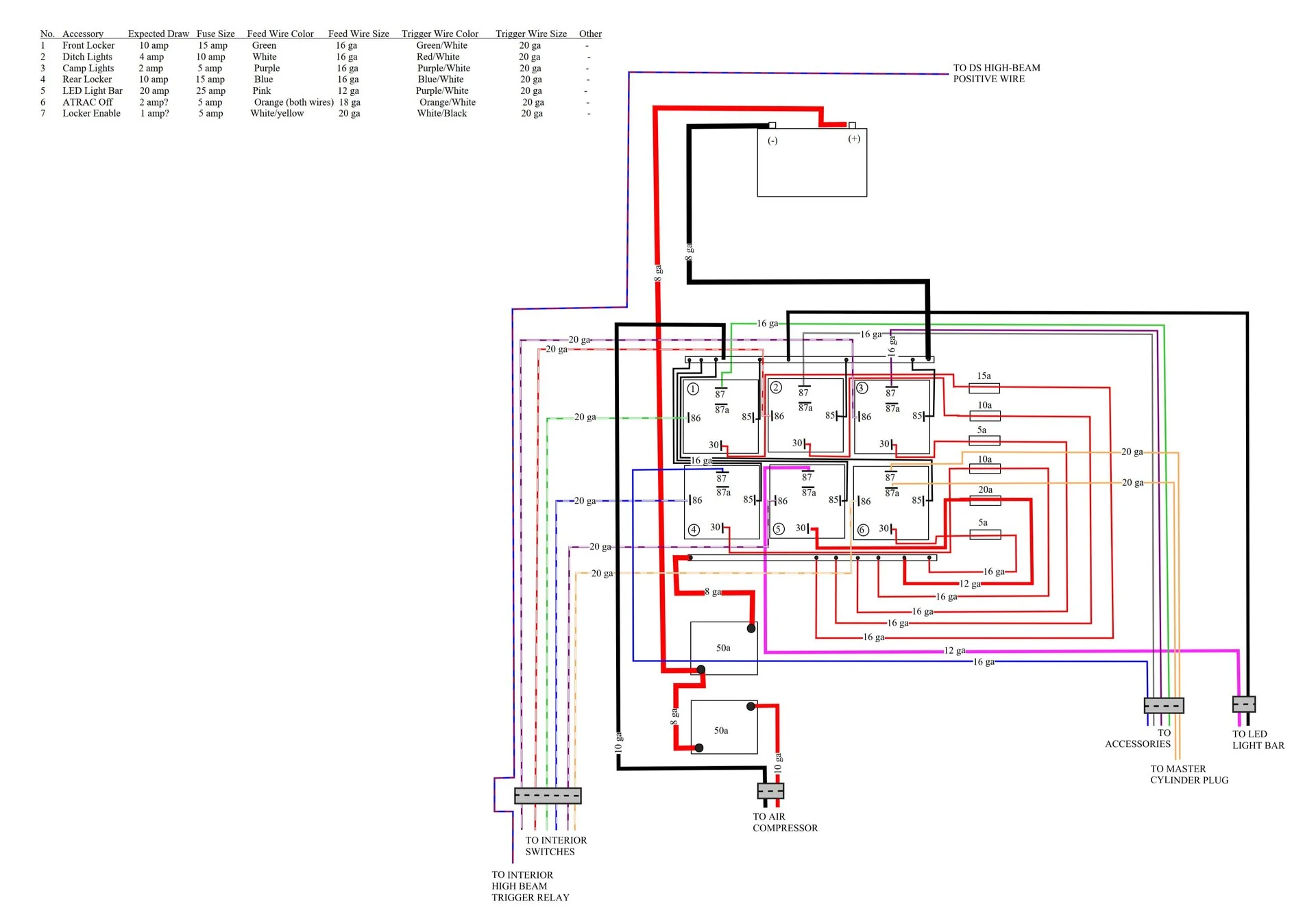

Also worked up a diagram for the under-hood components of this setup (still need to do one for the inside). I'm an engineer, but a civil and not an electrical (EE). My EE friends would surely laugh at this since I'm using non-standard symbols. But it will work for me. I'll have relays under the hood for front and rear lockers, side camp lights, ditch lights, and LED light bar, and a ABS/ATRAC/VSC off button. Inside the rig there will be 2 relays for a secondary "Lockers Enable" switch and relay and that will trigger the LED light bar and ditch lights based on the high-beams being turned on. I've purchased most of the custom switches from CH4X4 and custom switch panels from Blue Dog Design Works to make all of this happen. I'm way over the cost/complexity of something like an Auxbeam switch panel, but probably cheaper than a SwitchPros. This is the "hard" way to do things, but I like DIY'ing the stuff and getting it set up exactly the way like it.
Now to start the cumbersome process of actually wiring all of this up. I've bought lots of deutsch connectors from Amazon and different-colored wire from MilSpecWiring.com get that process going.

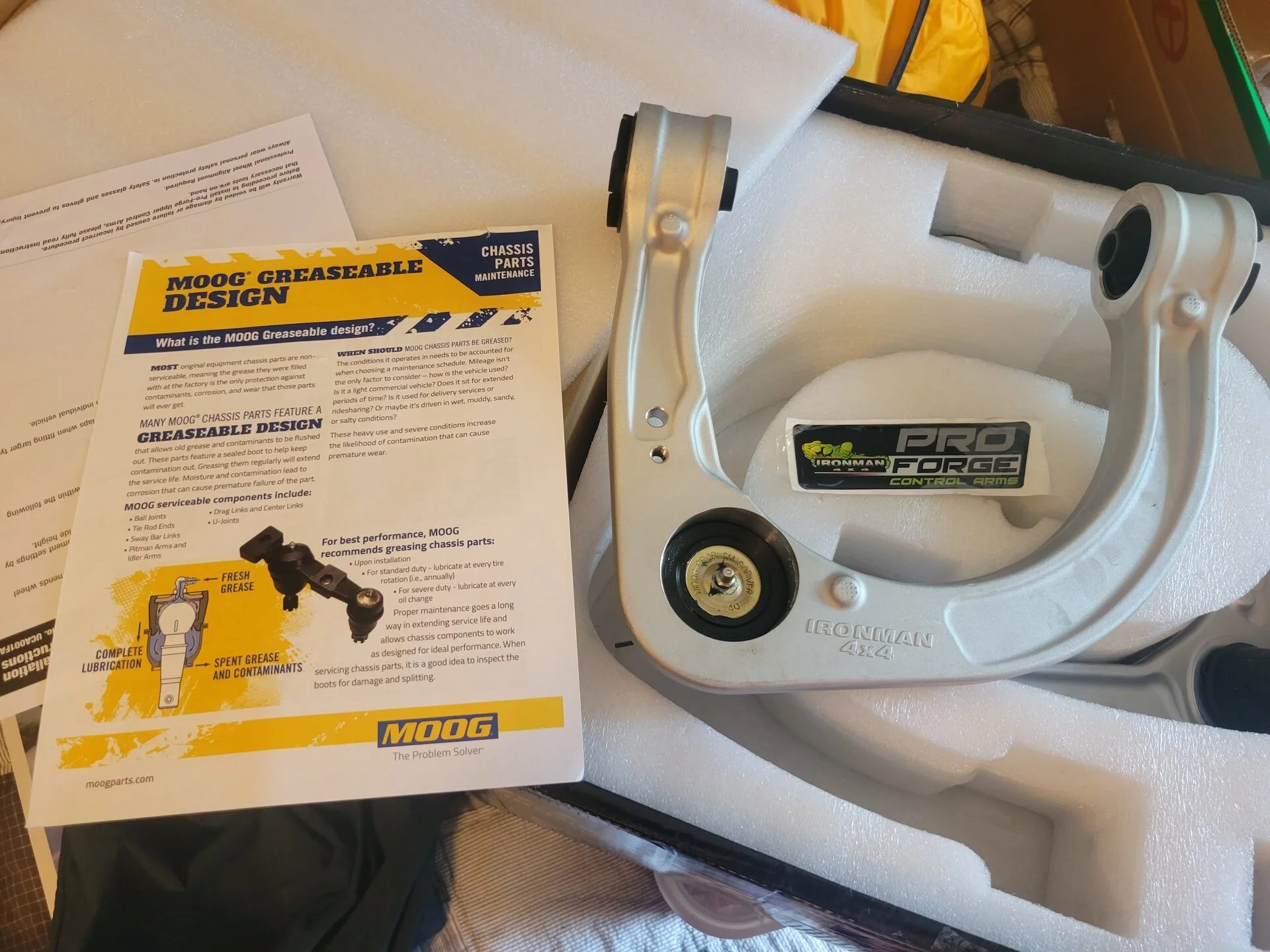

Recall replacement Ironman UCAs are in. Interesting that they went with a Moog greaseable UBJ....my old ones have a no-name non-greaseable. I have Moog LBJ's anyway so it's not a big deal to grease these as I'm hitting up all the other grease zerks on my rig. Would have preferred 555's, but my Moog LBJs have been fine, so whatever.

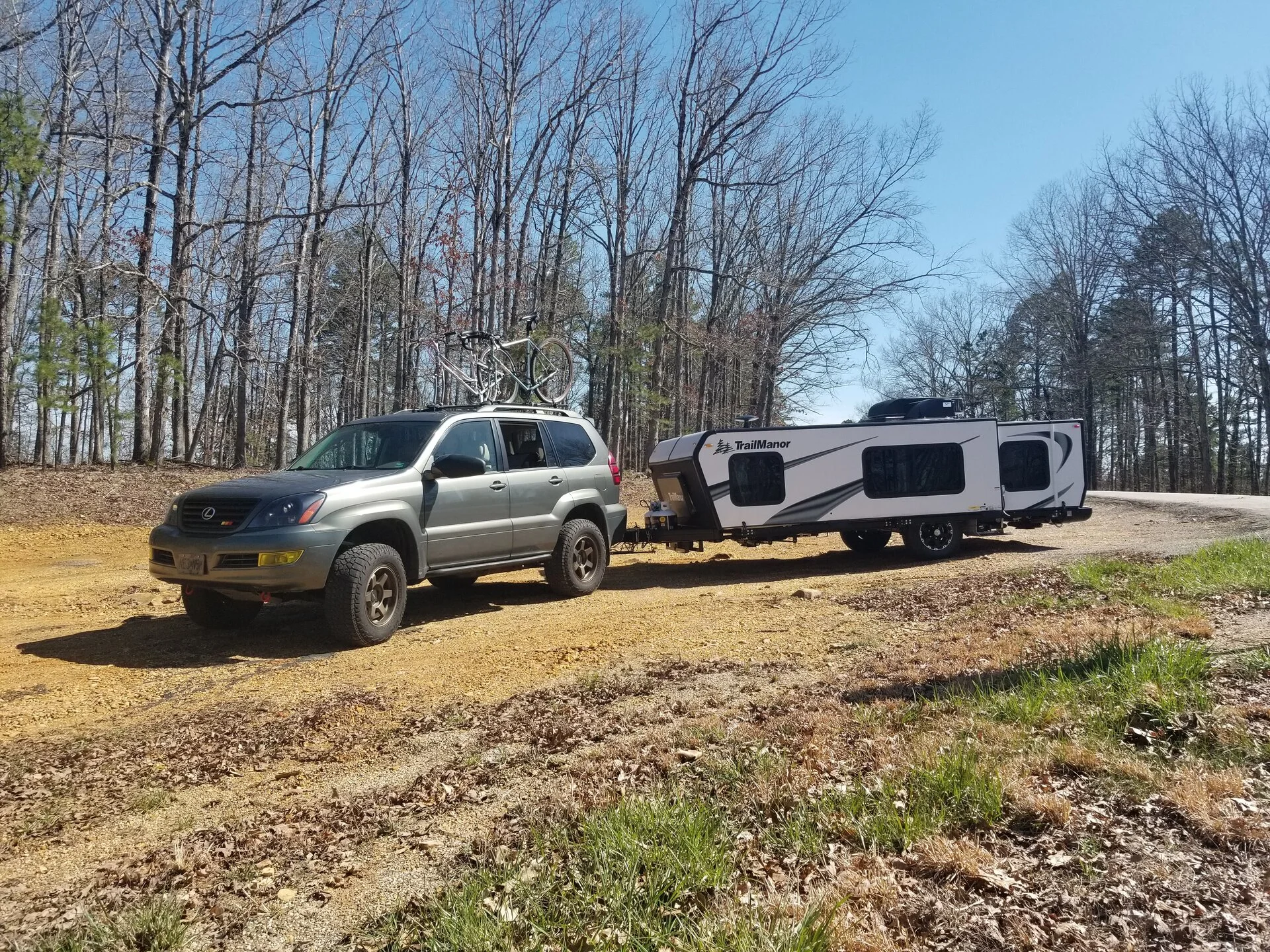

Last TrailManor trip of the year, made better with some exploring of the lower Current River Country.
The rear and front sections swing down to the middle on a set of torsion bars. It's around 3-4' shorter in height and 7' shorter in length collapsed. Tows great with a GX - we got 13.4 mpg (uncorrected) on our 100-mile drive home yesterday on 2-lane backroads. I would have only gotten 17-18 mpg unloaded.

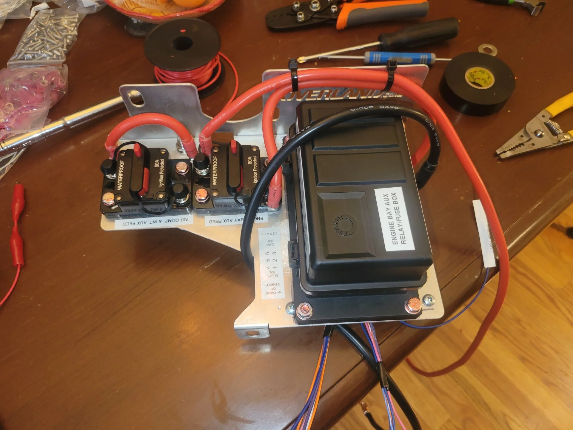

Dining room table wrenching on a rainy day.
Not a EE either (ME with some exposure to that EE sorcery) but the jumper between the breakers looks wrong to me. If your compressor breaker fails closed, you're going to cook both wires. Also, the rings on the jumper look close to the mounting screw which will short, so might want to insulate that screw.
The compressor actually has 2 breakers, one built into it and the aux so I'm not sure it needs to also be behind the 60a breaker that feeds the main panel. I currently run the compressor off of just a 10 ga wire.
However I may switch to a plastic screw or cap for the breaker mounting as I agree that they are kinda close.
