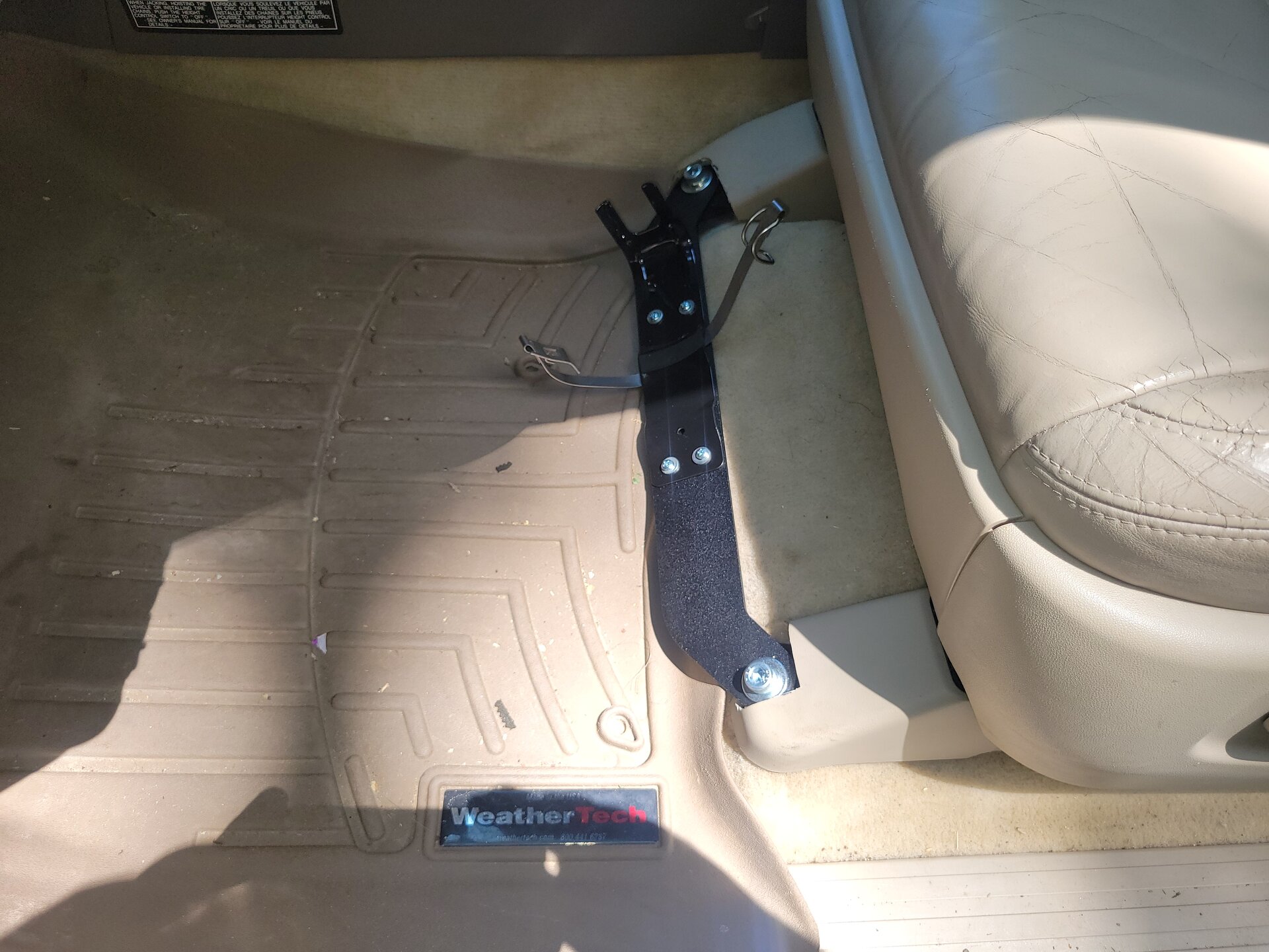

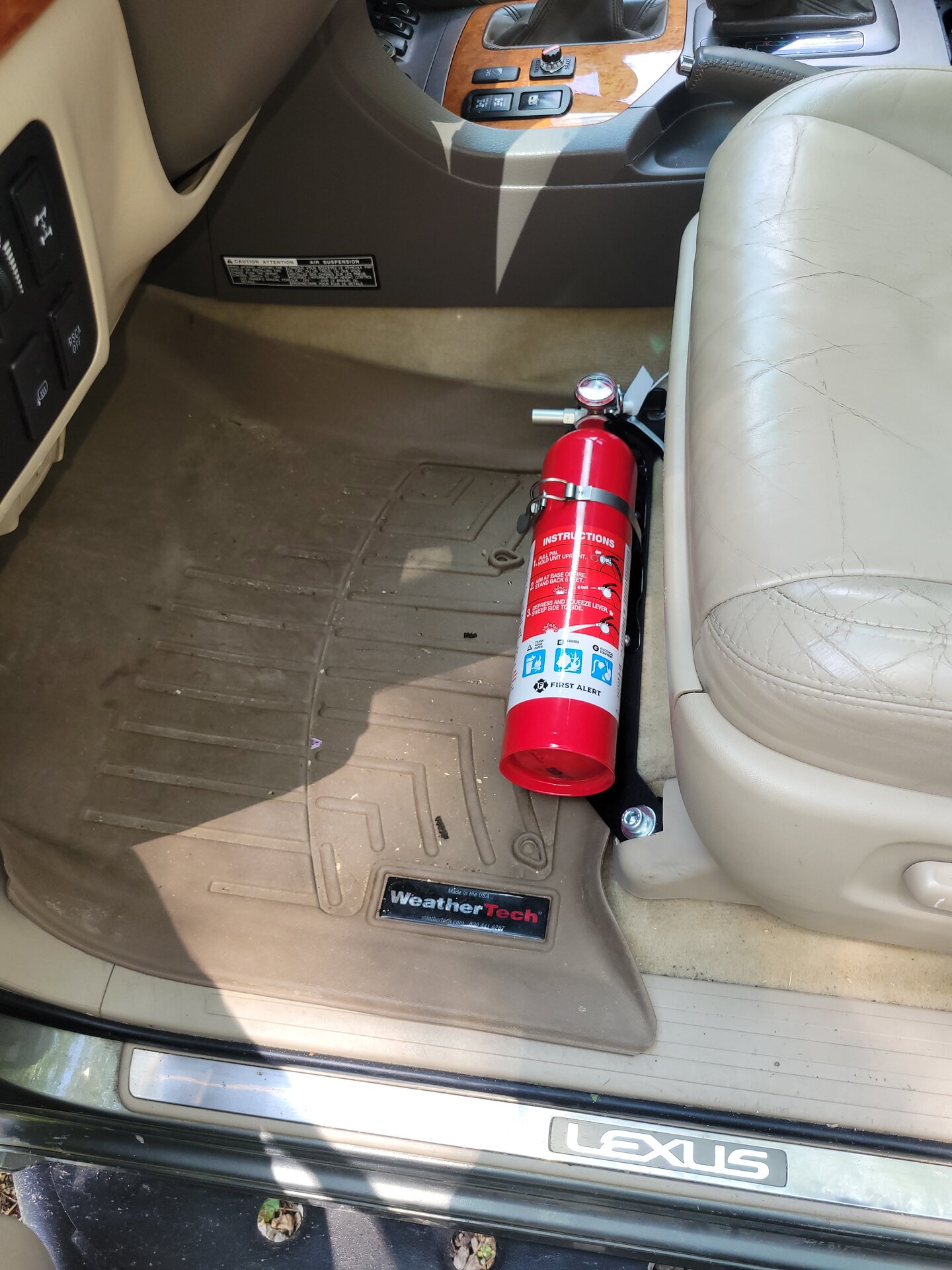

Also mounted up the Refined Cycle & Off-road front fire extinguisher mount and a 2.5-lb extinguisher. This is a pretty simple, $50 mount (CNC-cut and powder coated steel), and it fit perfectly (but does require cutting the interior trim - which I used a Dremel for and could have done a cleaner job on).
I got the Refined mount as it was a bit cheaper than other mounts and made here in Missouri. In taking a few short trips, the extinguisher isn't really noticeabe, but I'll probably need to remove it when I sleep inside the GX and move the seat all of the way forward. It definitely seems easy to get to for emergency use (my rig or someone else's).

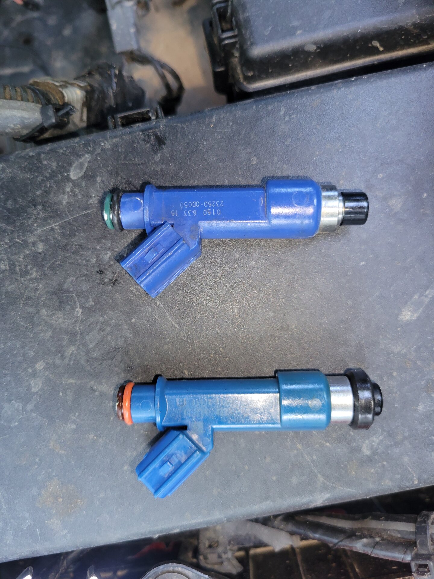

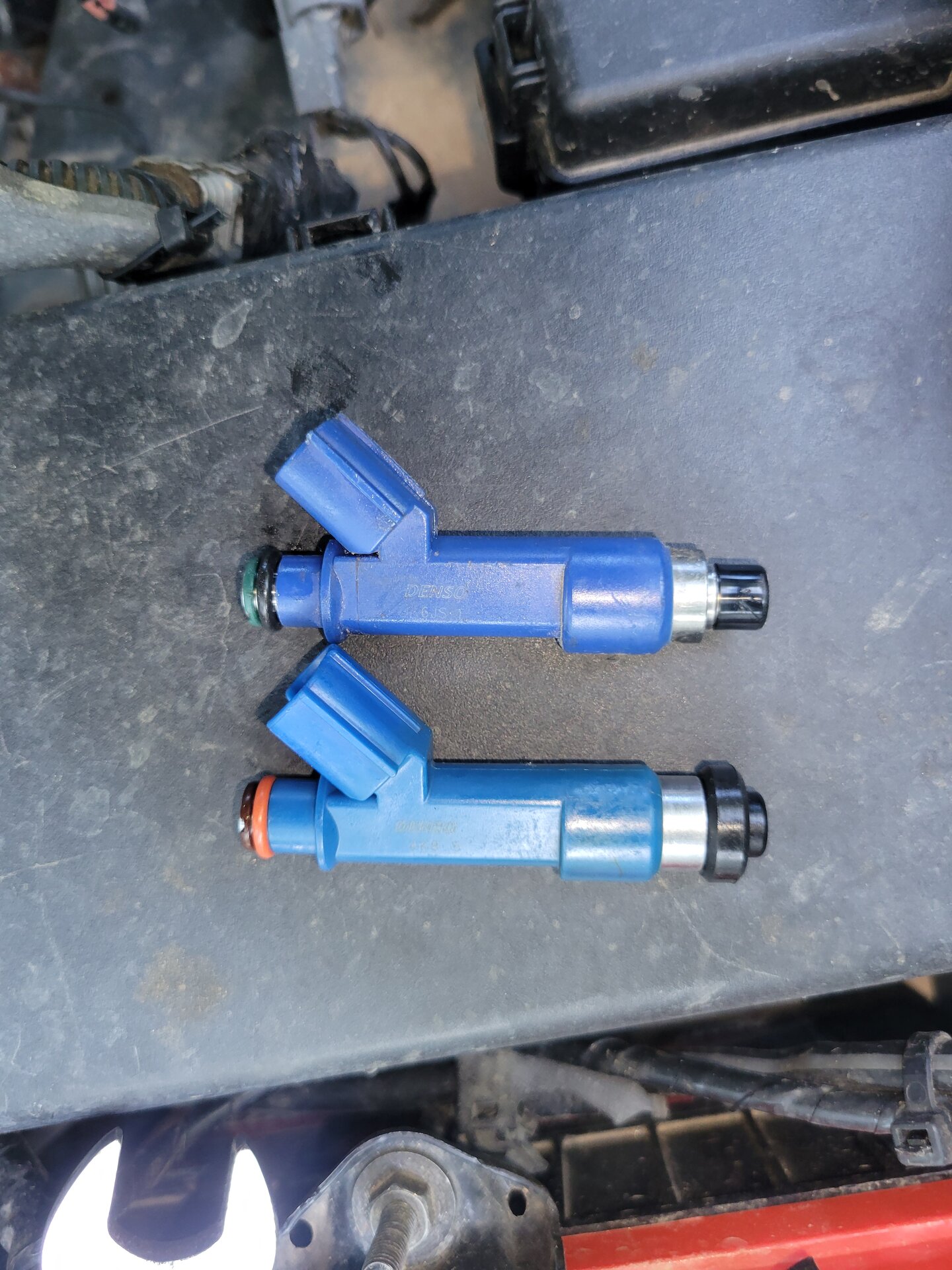

So I replaced the "flow matched, reman Denso 12-hole injectors" from eBay with a set of reman 12-hole injectors from Dirty Deeds. I was on the 2nd set of eBay injectors (from a reputable seller per Toyota forums) and was still getting a rough warm start for the GX, indicating some fuel leakage into the intake after shutting down the GX.
Upon pulling out the old injectors and comparing them to the Dirty Deeds injectors, a few things became apparent, including 1) the eBay injectors were all exactly the same color plastic (looked brand new), relative to the Dirty Deeds injectors which had obviously been in a running vehicle and were various shades of blue, 2) the numbers/lettering on the eBay injectors didn't exactly match the Dirty Deeds injectors, and 3) there were some minor differences in the plastic injector body. One of the plastic end caps on the eBay injectors also came out when I pulled it, resulting in me having to fish it out of the intake port (surprisingly easy with a 4-prong grabber...).
So....it seeming like I may have gotten a set of new knockoff injectors instead of reman Denso injectors. The GX does run a bit better with the Dirty Deeds injectors in it, but I haven't tried a warm start yet. The eBay seller offered me a refund minus the flow match fee....I'm tempted to demand a full refund including shipping but have some reservations about flat-out accusing them of selling counterfeit parts. Thoughts?

I'm sorry to hear about this Red, your a stand up nice guy. Were me, Id call em out on it and demand a full refund or else you'll report them from here to the outside edge of the solar system on every online forum there is including ebay. That's just me though. I think you guys have seen me talk good and bad about these folks selling stuff. I don't know the money angle and what you can afford to lose, you start calling them out and a whole new avenue opens up for them to tell you to get lost, so that's a consideration and a higher chance of outcome at that point.
Yeah, you're right. Looks like you can also report it as counterfit directly on eBay and bypass the seller. Assuming they are counterfit (90% sure they are), I really don't want anyone else to have to go through swapping out injectors multiple times like I have. I'll see how it runs tomorrow and if the warm start issue is solved. If it is solved, even if they aren't counterfit, the rebuild must have been poor quality.
Green O-ring = eBay injector, Orange O-ring = Dirty Deeds injector

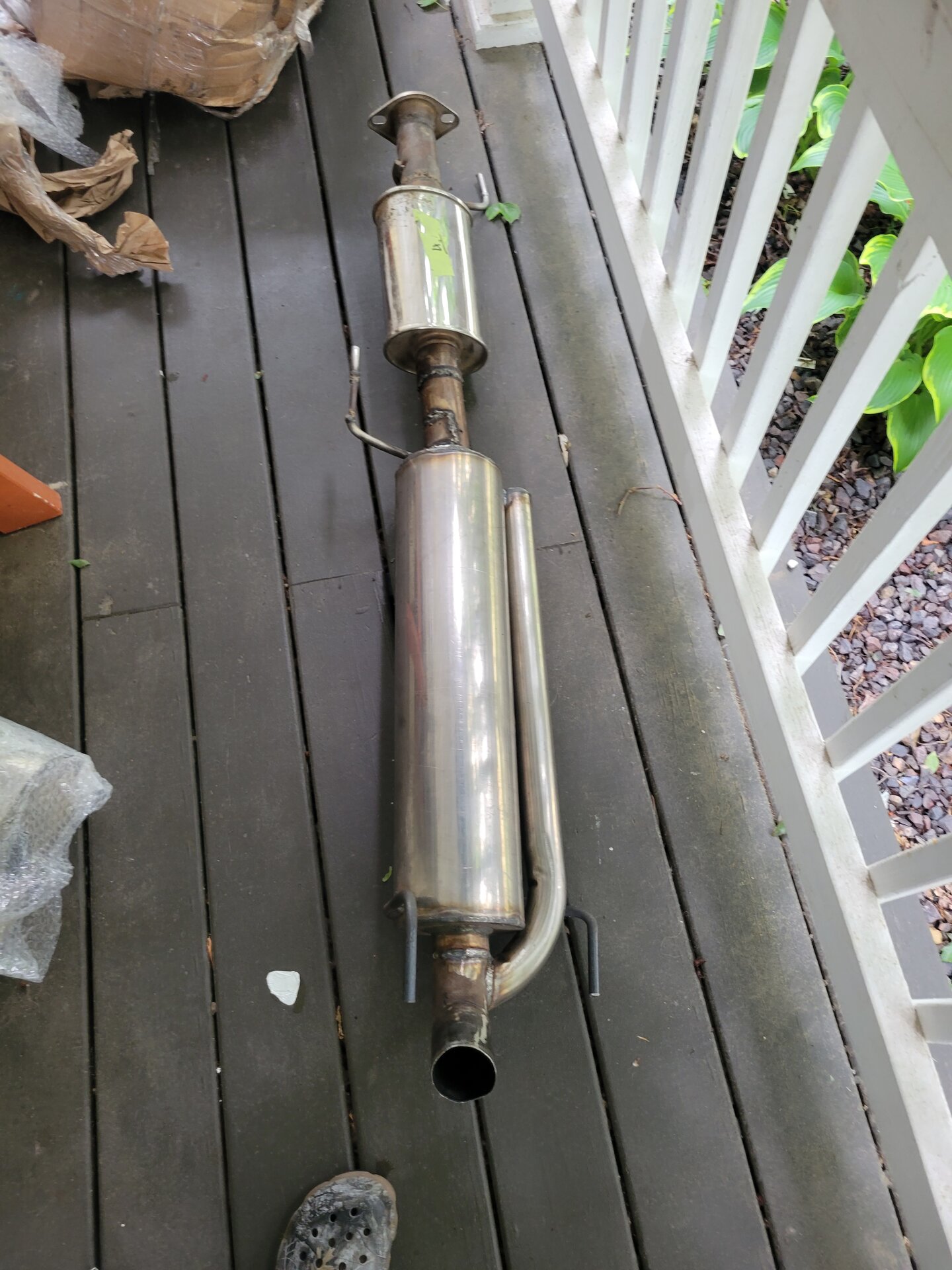

I finally threw in the towel on my exhaust woes. I spent another weekend back in July trying to get rid of the 3,000-rpm plus whistle and the 1,500-2,100 rpm drone, to no avail. I ended up calling up Dirty Deeds and chatting with Keith. I explained the situation, he suggested that I ship my Borla system to him, and that he'd weld in one of his mufflers, quarter-wave resonators, and he had a way to fix the whistle. The system ended up being gone for about 2 weeks, including shipping.
Just installed it this afternoon. Impressions are:
1. The DD muffler weighs about 2X as much as the Borla and 3X as much as stock. I think it's a 5" SS cylinder packed with a ton of something (maybe stainless steel wool?).
1. Sounds WAY better than the Borla....the Borla had a super deep tone, but droned badly and didn't have much of that V8 rowdiness. The Dirty Deeds has a bit more rasp and just sounds better overall.
2. The whistle I had from 3,000 rpm on is GONE. I saw how he fixed it - won't share here as he was kind of coy about it - but it was super easy and I wish I would have thought of it myself.
3. It's quiet at 2,000 rpm and up - like 57 db. Zero drone at cruising speeds. Should be great for towing.
4. Still some loudness from 1,500-2,000 rpm (around 60 db) but better than before. I left one of my Helmholtz resonators on there and may make it a bit larger to address those lower frequencies, but it's much more livable than before.
5. Power is about the same as the Borla and more than stock.
Overall - happy with the outcome, but it shows just how difficult it is to get an exhaust totally dialed on one of these. I'd throw an exhaust firmly in the DO NOT RECOMMEND bucket, unless 1) you don't mind screwing with it for months and spending 2X as much money as you thought to get it dialed or 2) you're younger and don't mind the sound (I did not mine drone in my teens and twenties....different at 39).

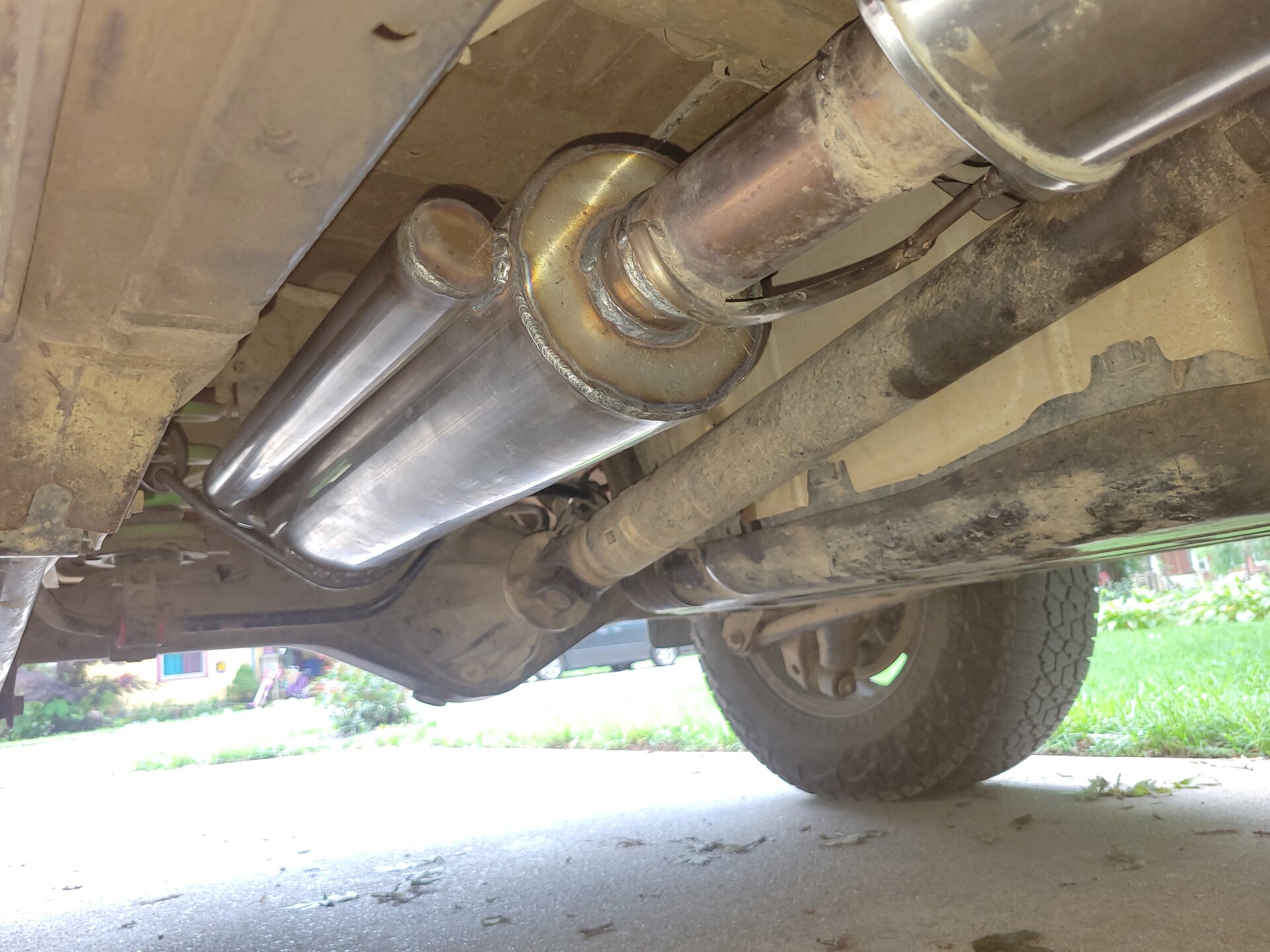

Thanks for the advice! Although the rocks are starting to pound on my tailpipe.
That's the one I put in. I'm happy with it. Now, my hearing is kind of jacked up over listening to turbine engines most of my life. But, I honestly don't hear too much of a drone with it. I noticed they now sell an axle back as well.
For rock protection, you could have a muffler shop remove the rear resonator and add in a turndown in the similar location as the Magnaflow. That should be a $50-100 job and would provide more clearance.
Reviews on the Magnaflow are all over the place....some say zero drone, others say it's unbearable.
