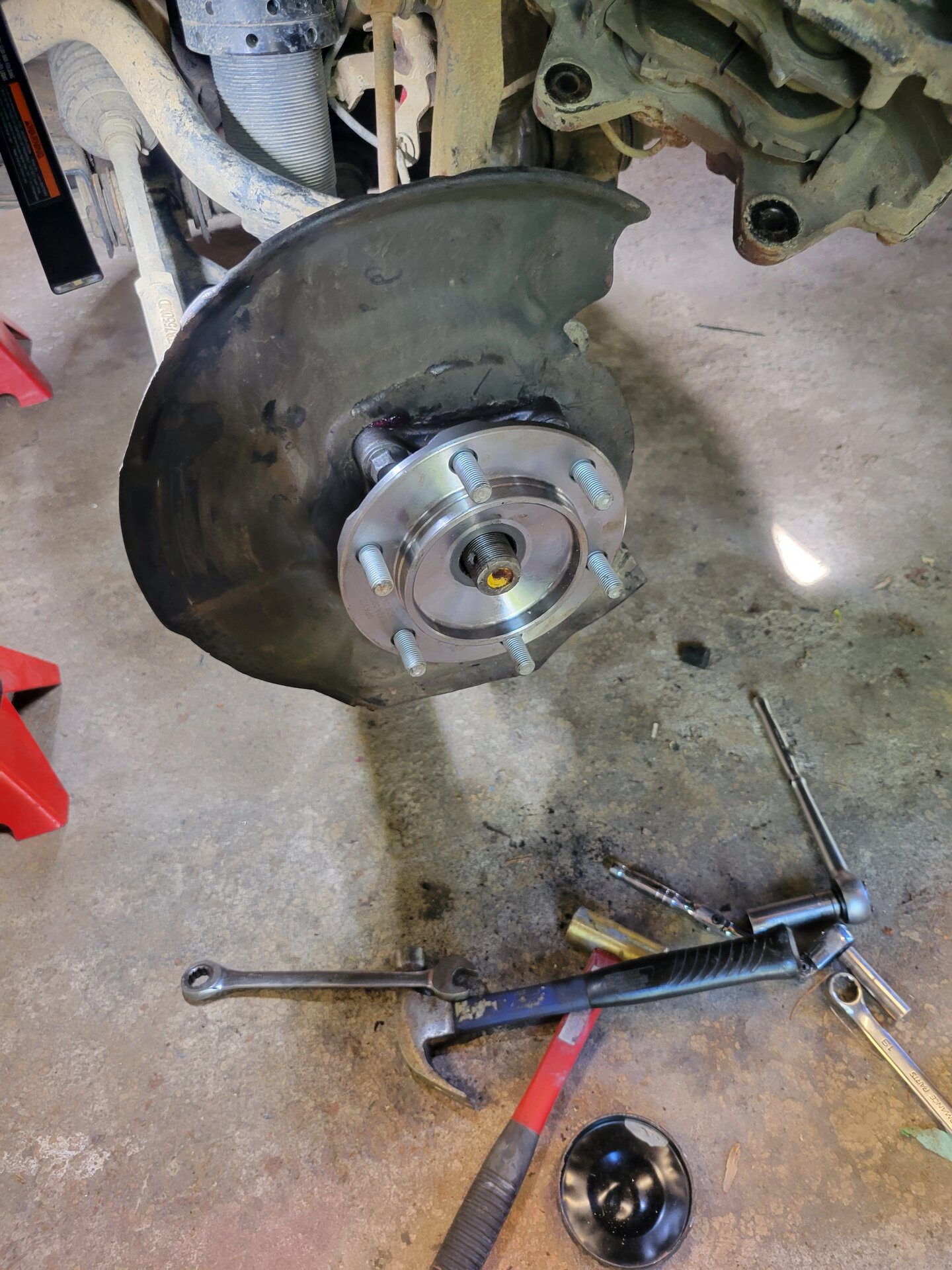

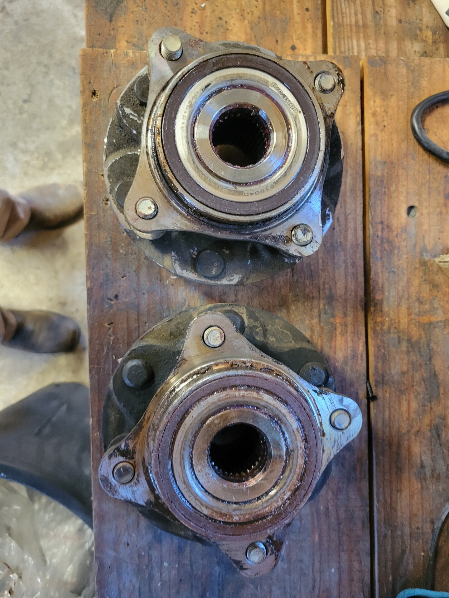

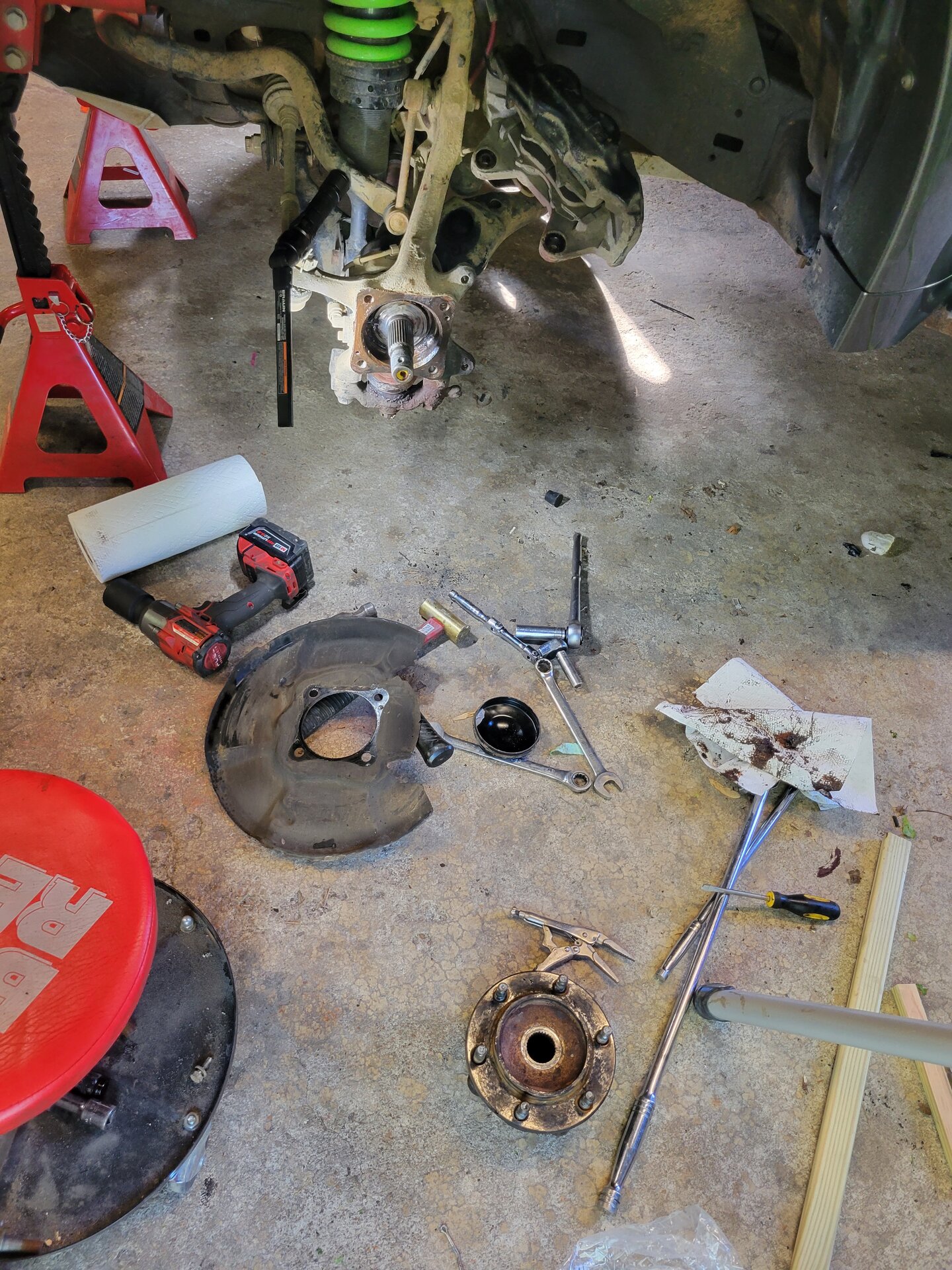

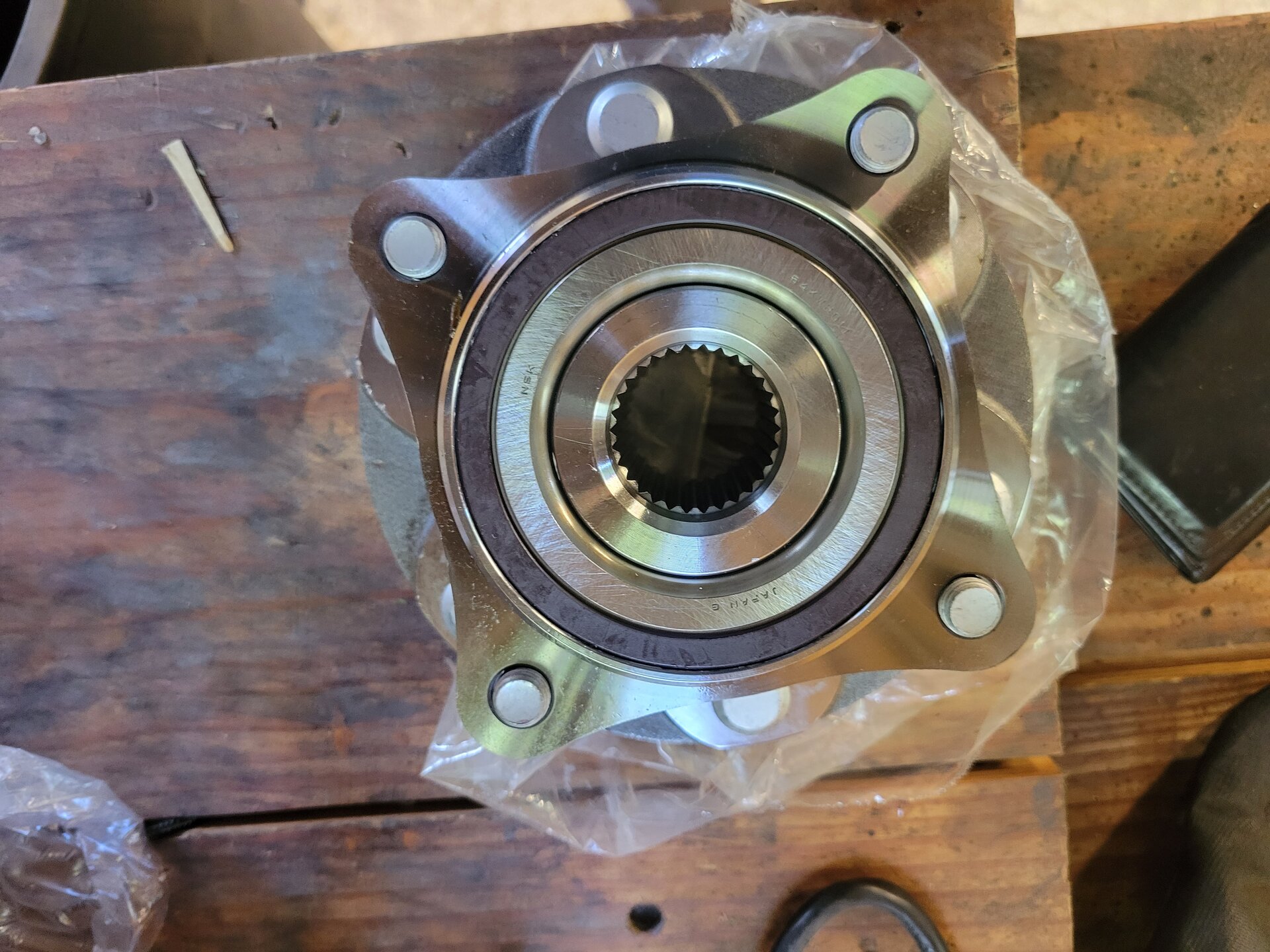

My GX had become quite noisy while driving, which I attributed to my Wildpeaks getting a bit worn. Until I started to feel some feedback through the steering wheel....and it kept getting louder. Yup, it was front wheel bearing replacement time. Got a pair of new assembled bearings and hubs from Yota Bearings and Hubs, with NSK bearings and a Doorman hub, for $150/shipped per side.
Removing the old hubs was super easy, maybe 20 minutes per side. Nothing was seized on either side.
Both the DS and PS hubs were non-OEM replacements. The DS (which looked new when I bought the GX) was a complete no-name hub. It had a lot of play and grinding, and was missing the O-ring. The PS hub has a "Precision" marked bearing. It didn't have much play but was pretty noisy.
I put things back together, for a total replacement time of around 45 min per side. The GX drives much quieter now with only minimal AT tire noise.
Lesson learned - cheap wheel bearing suck. The DS bearing couldn't have had more than 40K on it and it was already shot. These are easy enough to replace but should last more like 100K. We'll see how the NSK bearings/Doorman hubs last.

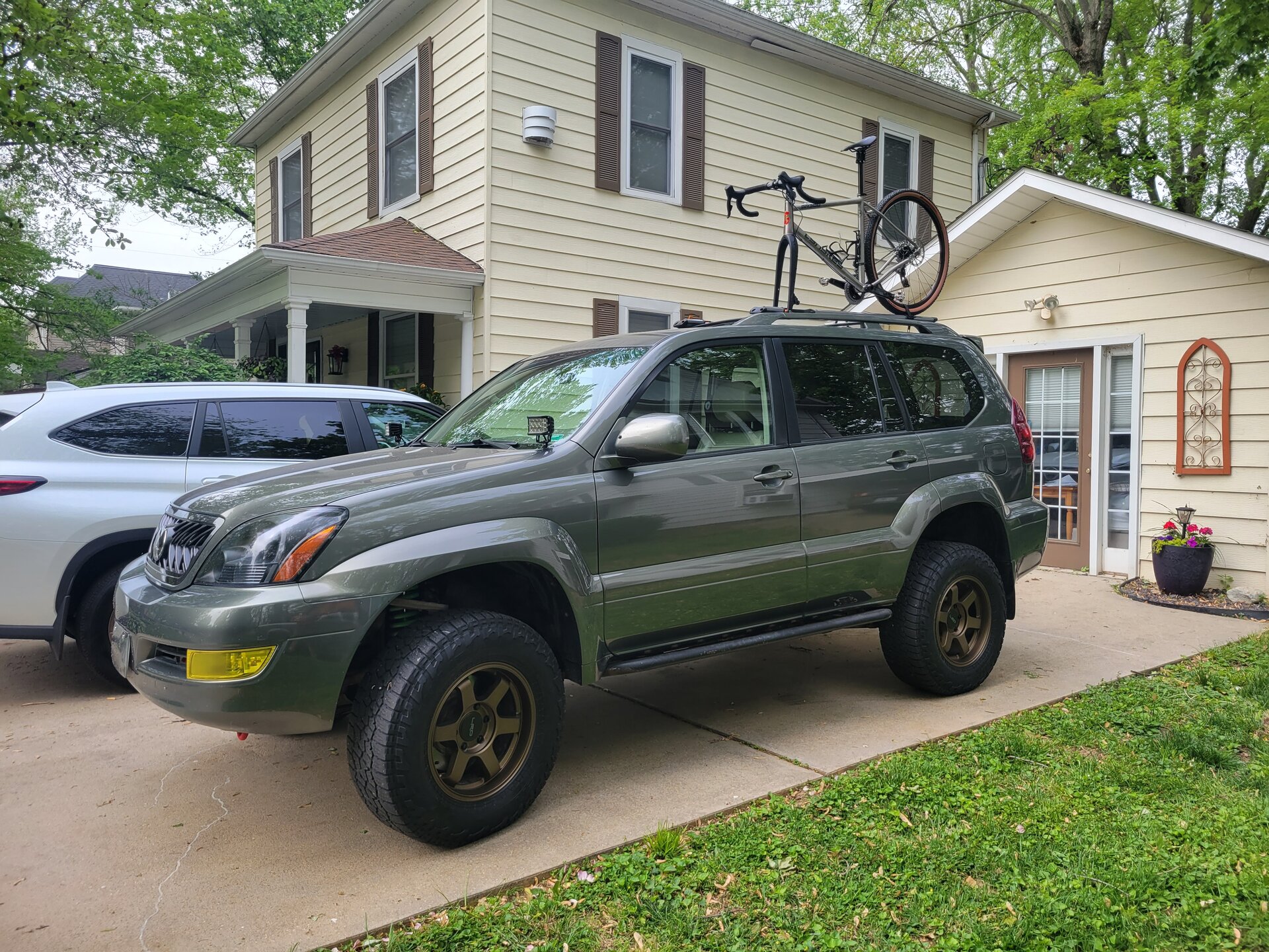

Felt an odd bit of self-awareness as I loaded the new titanium gravel bike on top of a lifted Lexus....
I've thought this for a while, but now I'll say it. That's the best looking GX I've ever seen. The cypress pearl...the bronze wheels...the amber fogs...the tight sliders...mmmmmmmm

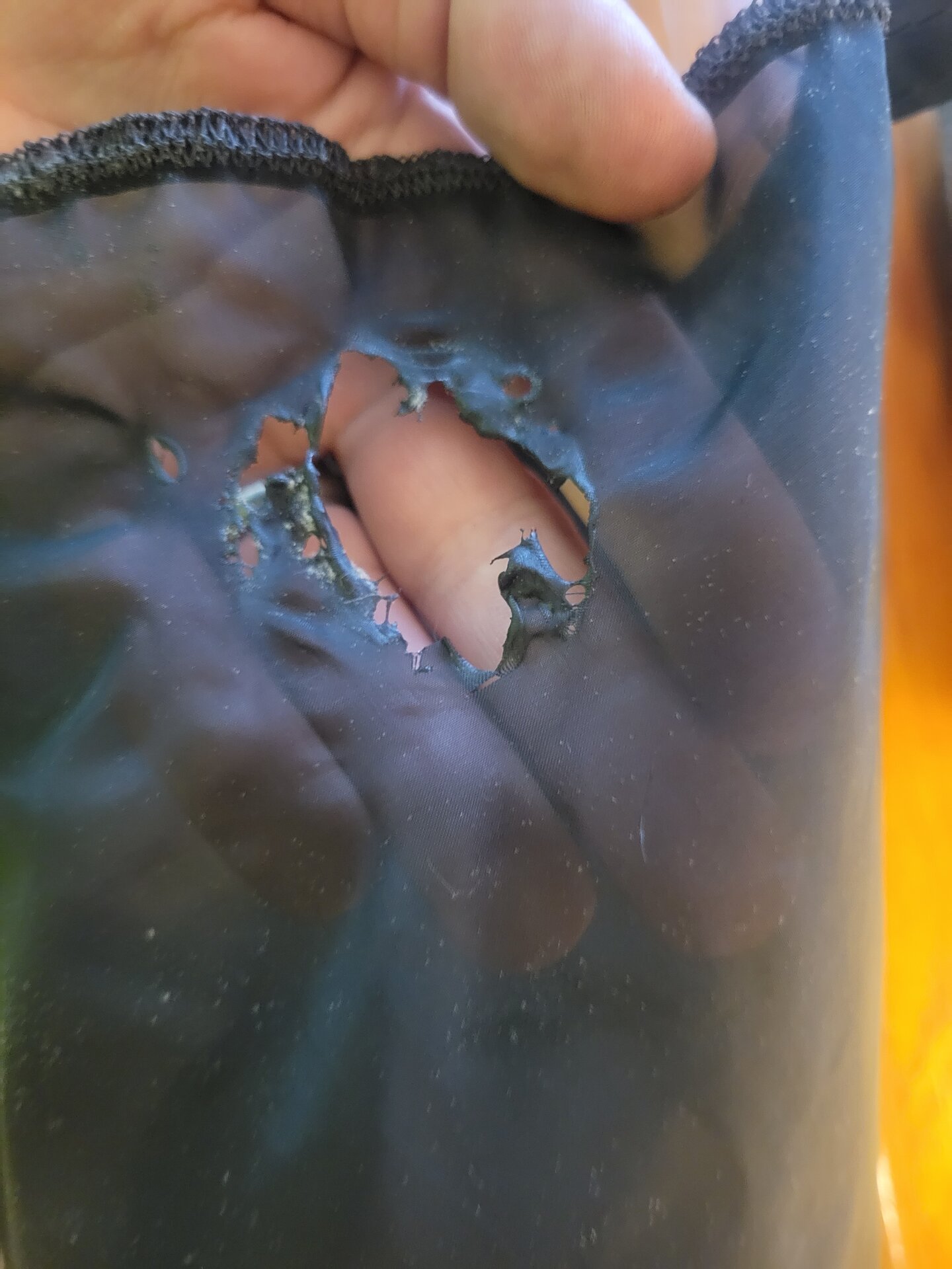

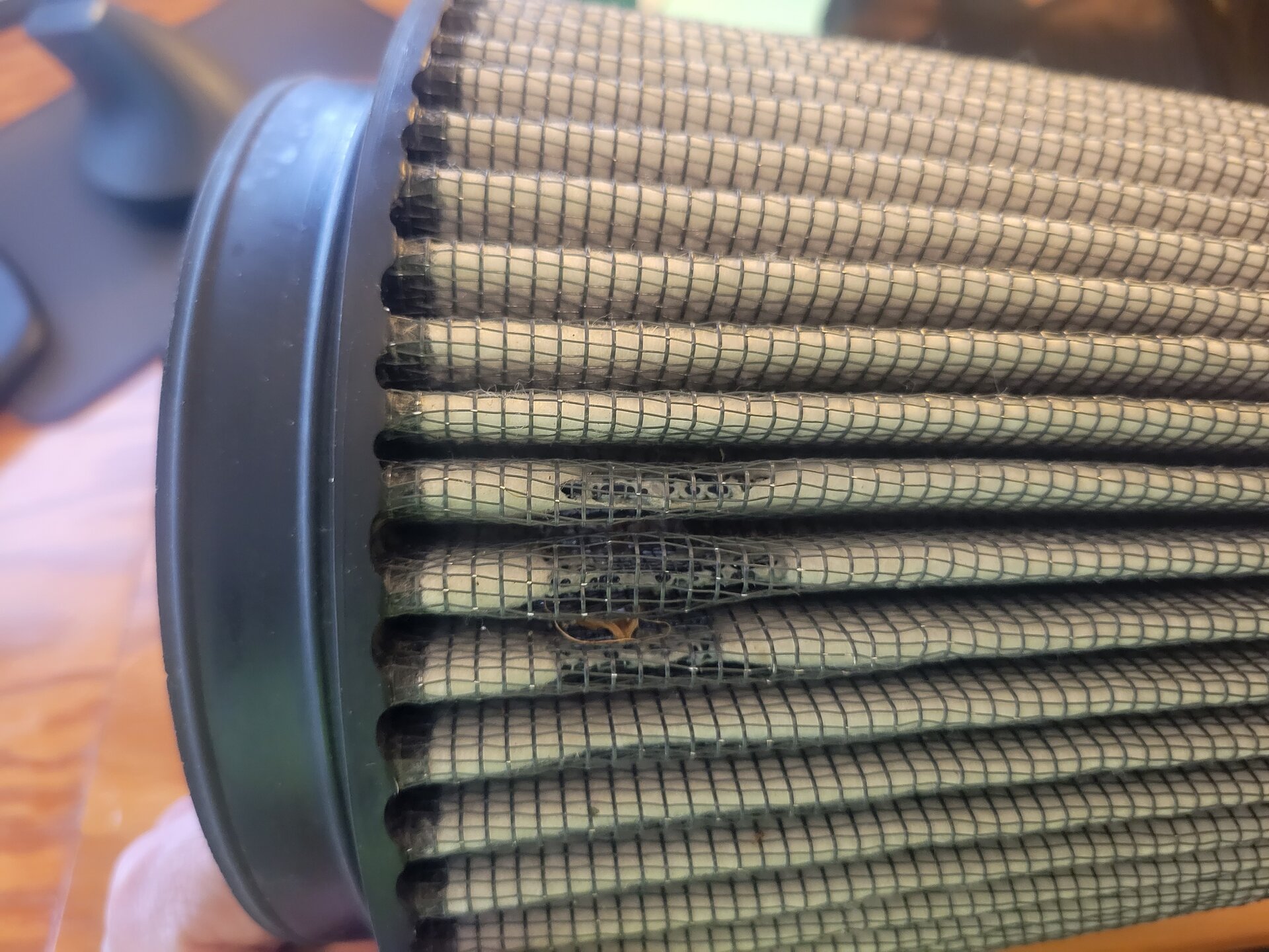

Here's an odd one. Opened up my CAI to notice what appears to be a small hole burned in the pre-filter sock and some more melted/burn damage to the actual filter. Nothing else in the airbox showed any evidence of being burned. The only thing I can think is that I somehow pulled an ember/lit cigarette butt into the air box which came close to torching the filter? The damage was on the underside of the filter. Kind of sucks as a new filter and sock were $130. The burned area is covered with tape until the new filters arrived.
But......the silver lining is that my rig is not burnt to the ground. Think I'm gonna follow @BigNick and mount a real extinguisher near the front seat instead of a tiny one in the rear drawers where it is harder to get at.
Thank goodness the damn thing didn't go up in flames..

That’s crazy. Im glad nothing really bad happened to you, but this got me thinking if this only happens to modified air intake filters or also with factory stock air intakes.
It’s so unlikely for this to happen in general and it happened to you. Buy a lottery ticket!
The CAI pulls from the same place as the OEM intake, so it seems it could be a one-in-a-million chance that it just happen to somehow suck in an ember. Lots of smokers here in MO (one of the highest smoking rates in the nation) and lots of people carelessly throw them out on the highway. Maybe a snorkel would reduce the chance of it happening :). Perhaps the whoosh of air "blew out" the ember or the filter media wasn't that flammable.

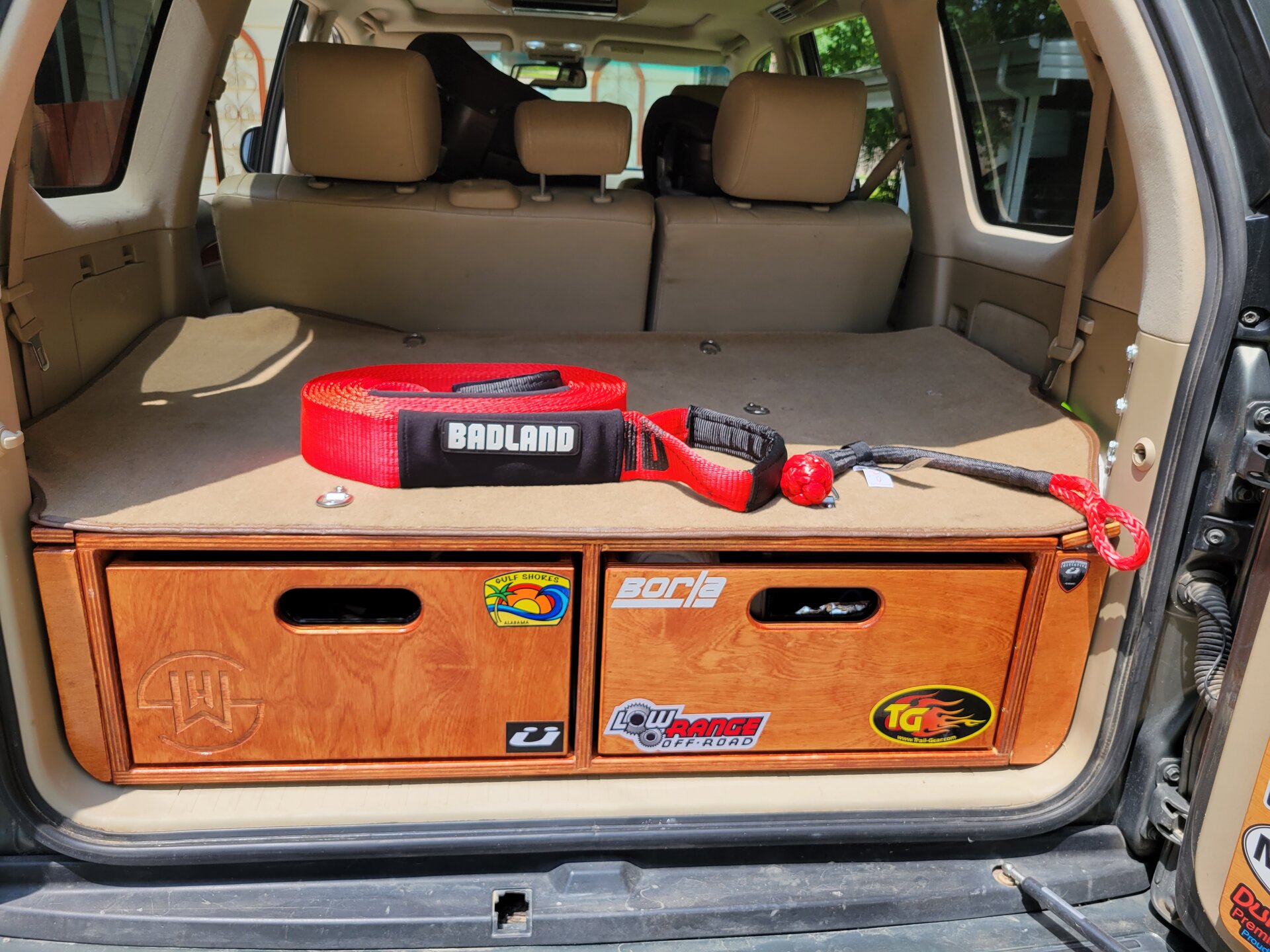

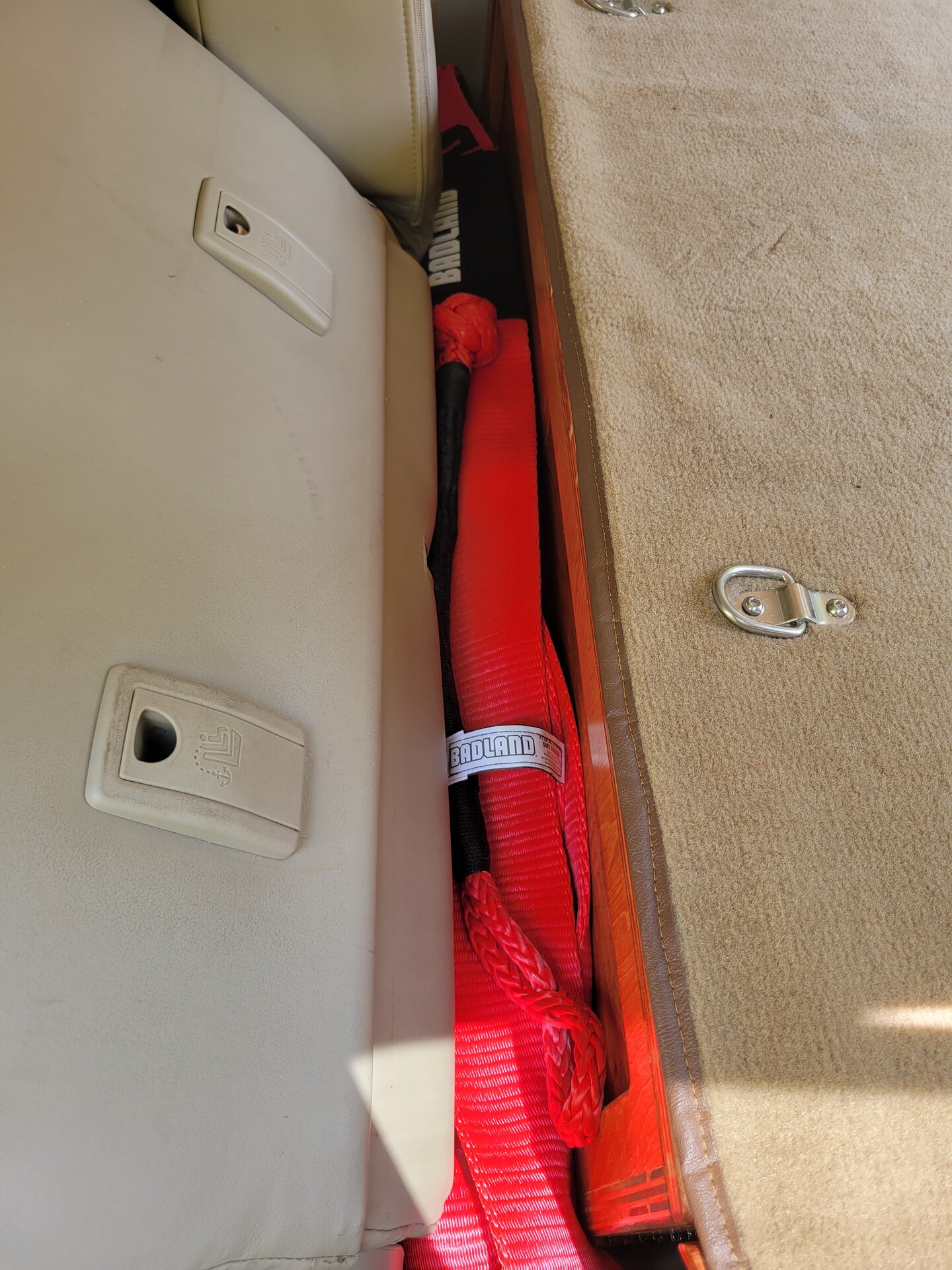

Used the HF 25% off coupons and a couple of different trips to get a Badland 3"×30' recovery strap (20% stretch so almost a kinetic rope) and a couple of soft shackles. Before I had just cheapie yellow nylon 2×20 straps. Both are super-beefy. The strap is pretty bulky, but i had room for it between the seats and drawers. The total cost was around $120 with tax for everything.
Yeah those coupons come in handy. I used the 25% to buy the badlands offroad jack and another to buy some Icon 1/2” impact driver joint and extensions.
What recovery points you have? And do those beefy soft shackles fit the front recovery points?
I have SRQ Fabrication front recovery points and a rear aluminum receiver-mounted D-ring in the 6,500# OEM trailer hitch. If I happen to get stuck, the soft shackles are probably a bit too big for the SRQ fab points, but I keep a set of D rings in them at all time and would hook them up that way. I mainly got the soft shackles for hooking up to other rigs, but do want to get one of these for the rear to replace my existing receiver mount and allow the D-rings to be skipped.
