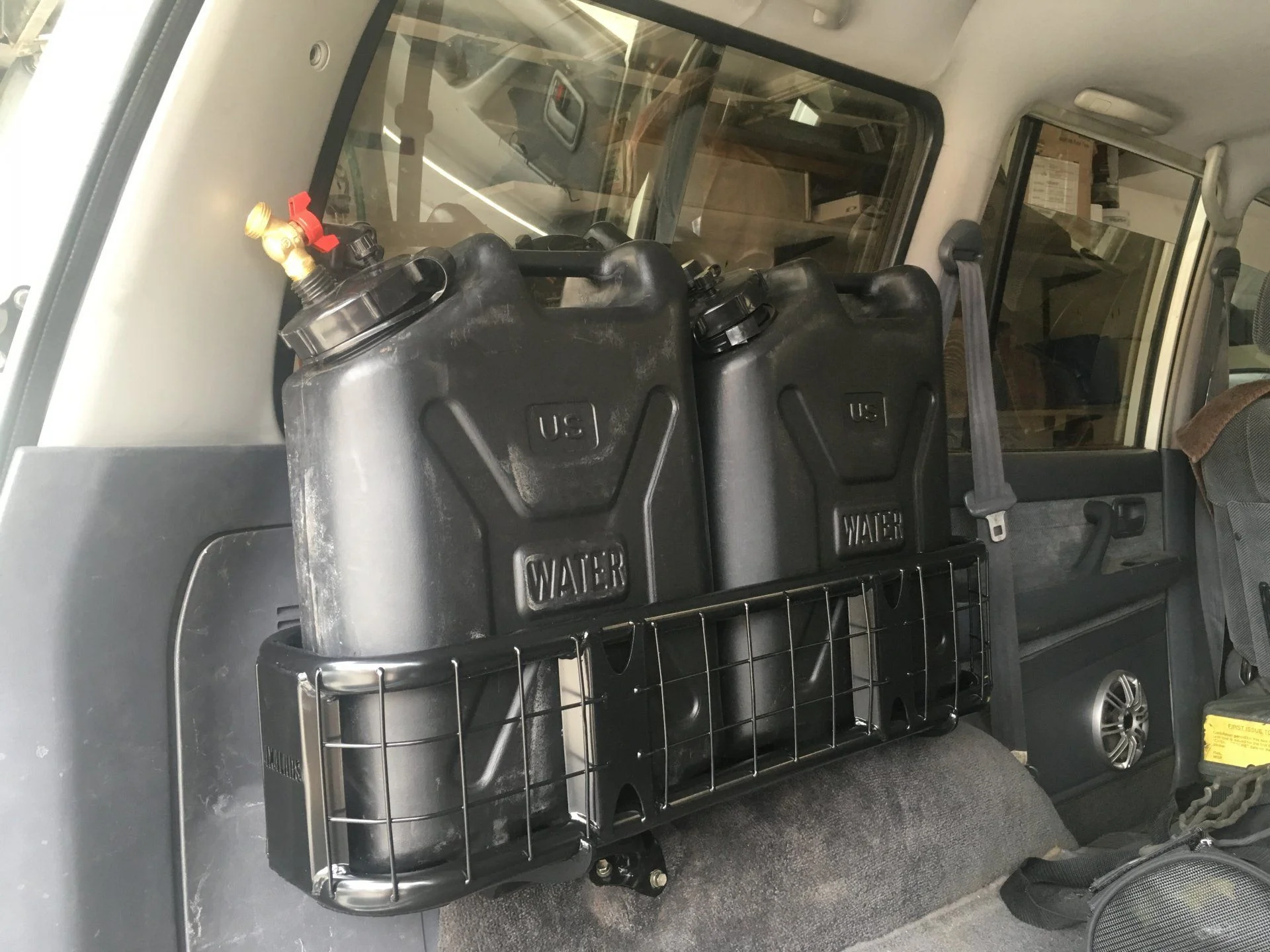

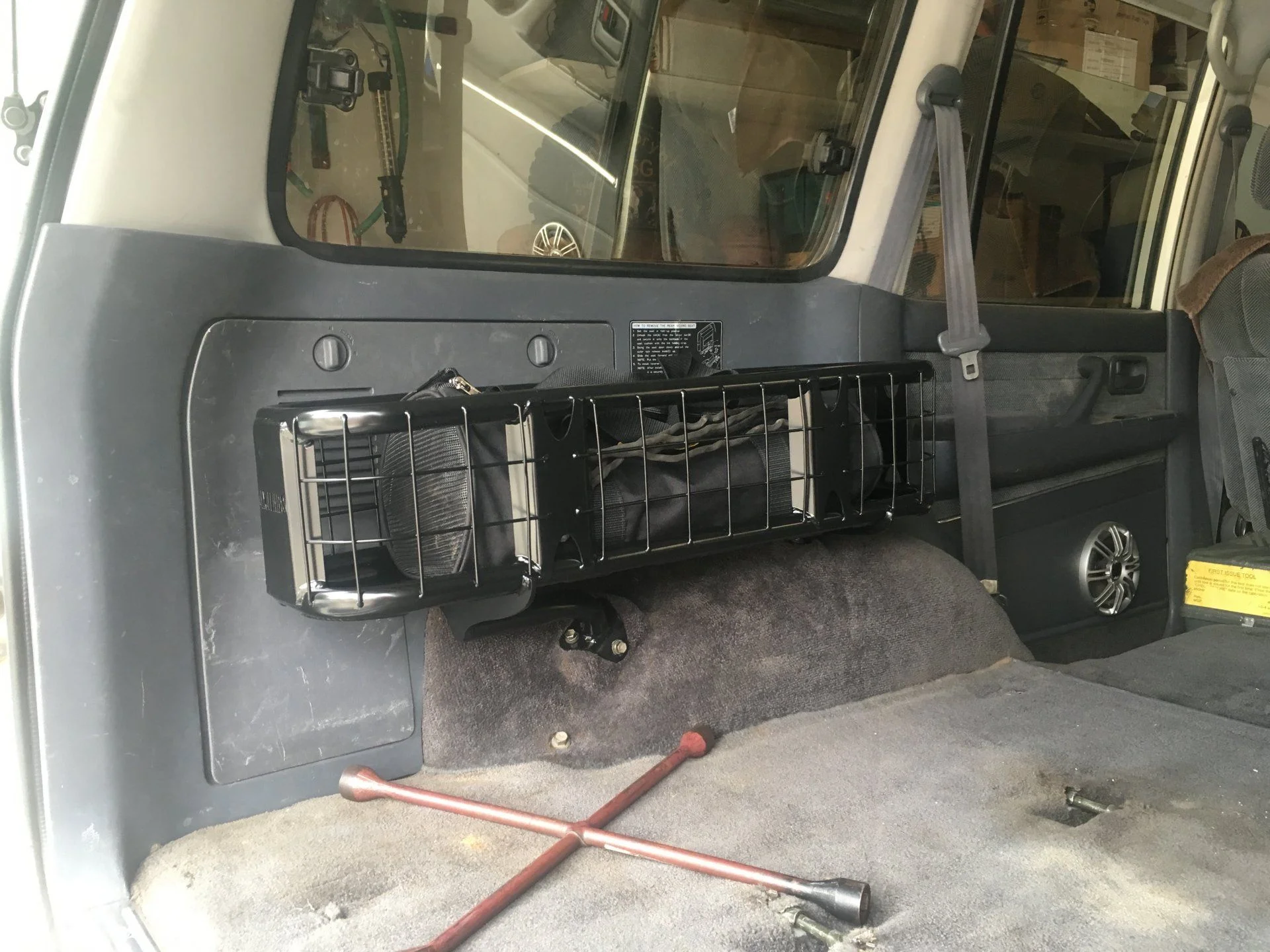

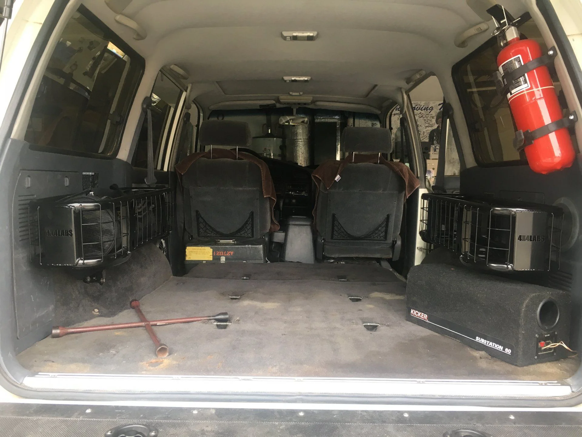

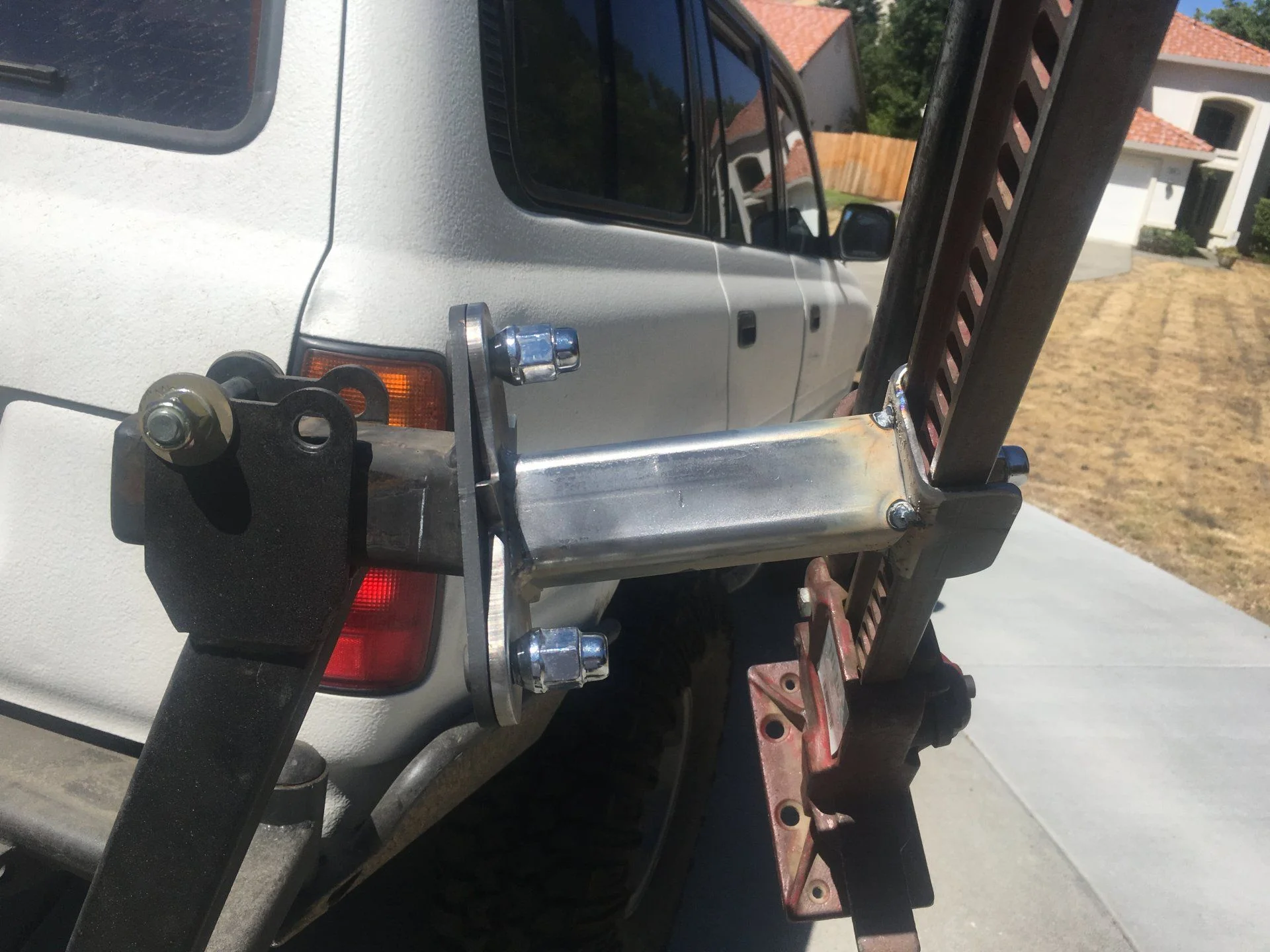

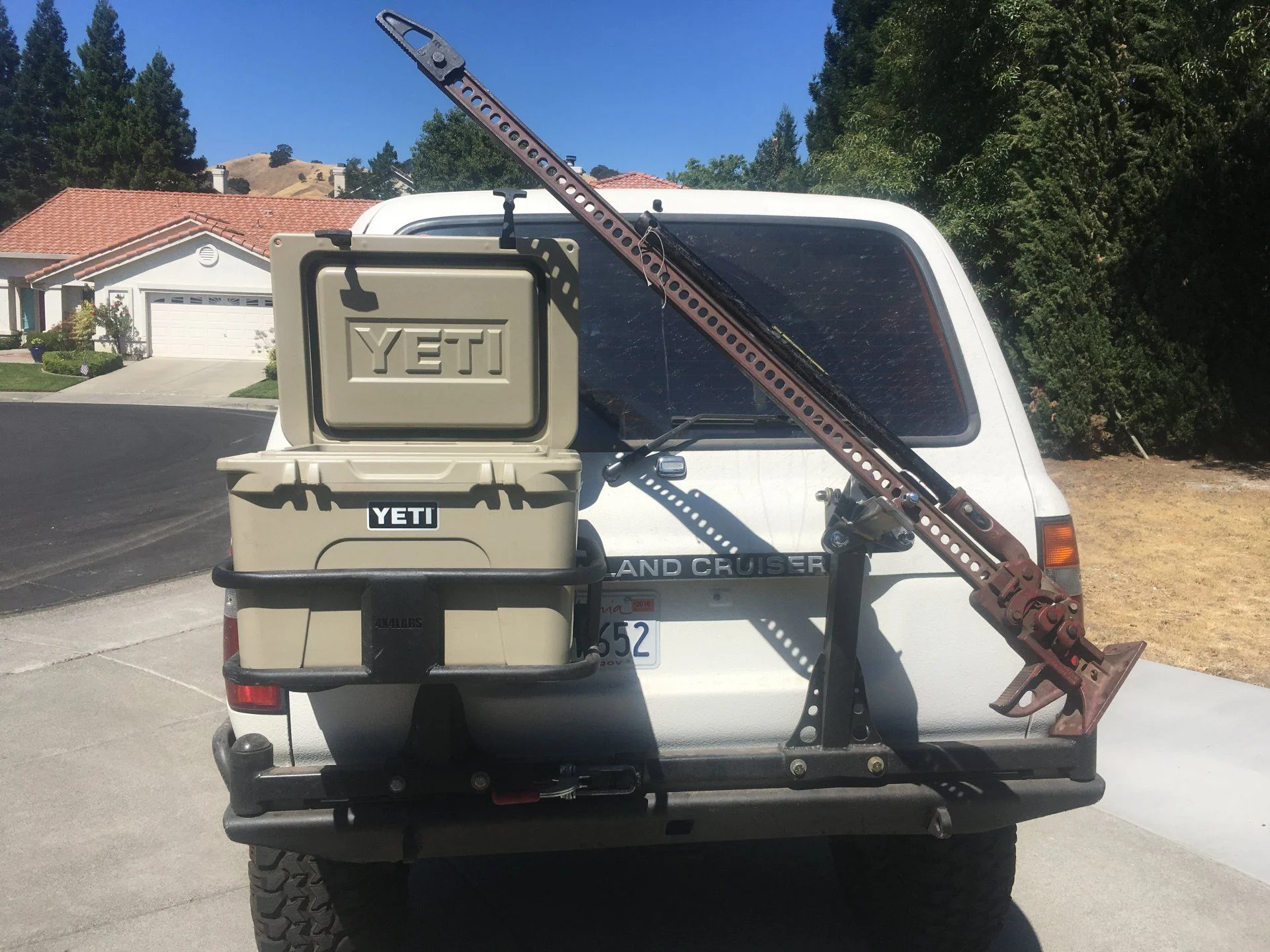

Needed to get the hi-lift outside the cab because I will be needing all cargo space inside for an upcoming 3 week road trip here in the west. I won't be running a roof rack because I can fit stuff for my wife and I inside with all seats removed so this is what I came up with.
I straightened out bent 4x4labs tire carrier and put it face to face with the one that carries the tire. Is not welded on and can be removed when ever. There is no photo with the tire installed but you get the idea.

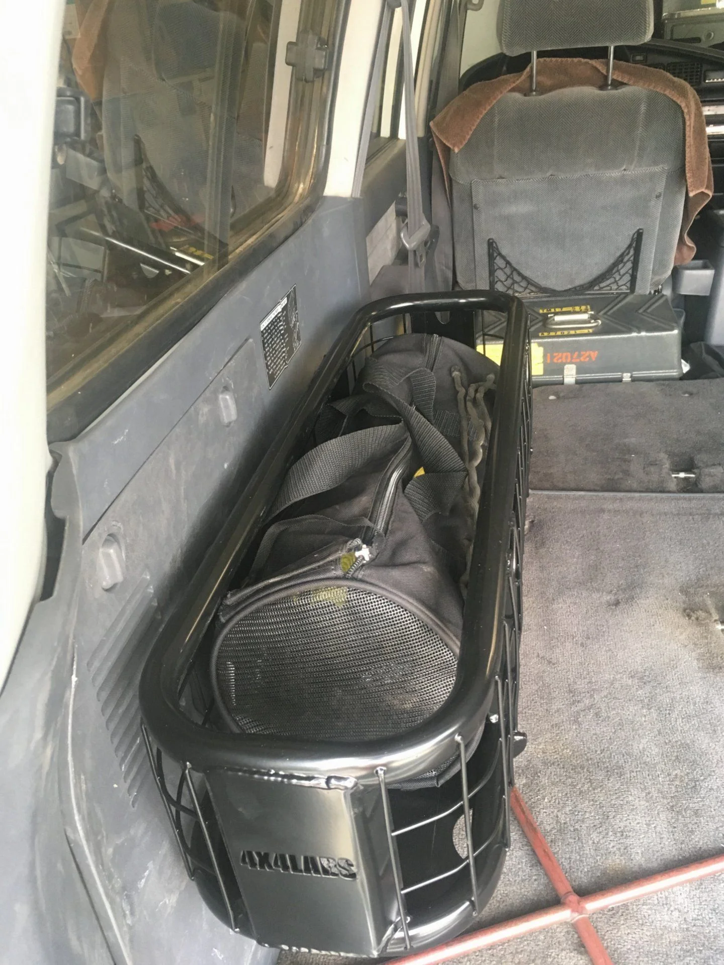

Thank you to Luke Porter and the crew at 4x4Labs for doing an excellent build on these cargo baskets. The the mounting rackets are spot on and quality is top notch.
This is the first product from 4x4Labs that I ordered already built and powder coated. I did this due to time constraints regarding our upcoming road trip. I'm happy I did. The order was shipped when promised and I could not have welded these baskets
Together as nicely.

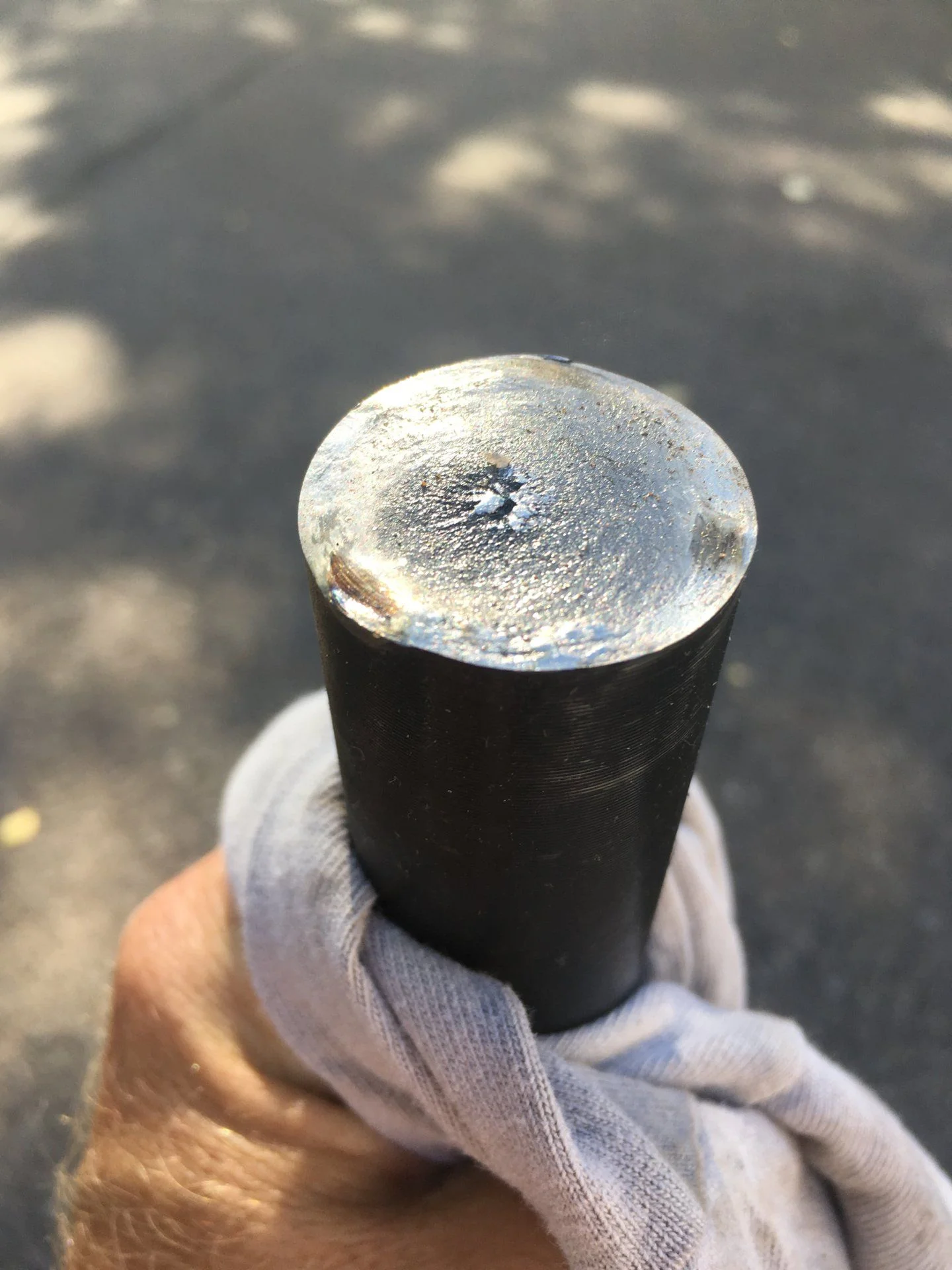

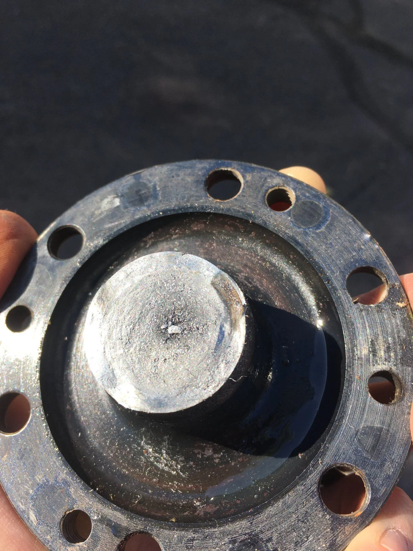

Our travels lead us south from the Teton's to Moab where we spent one week. I managed to break the RR axle shaft on Golden Spike trail which sidelined us for two days.

The Hoodoo’s at Bryce Canyon NP Utah. My pictures are a bit mixed up. Also here is a pic of the right rear axle I broke on that butt scratcher ledge on the Golden Spike trail. You can see the rusty looking defective areas inside the axle shaft material.

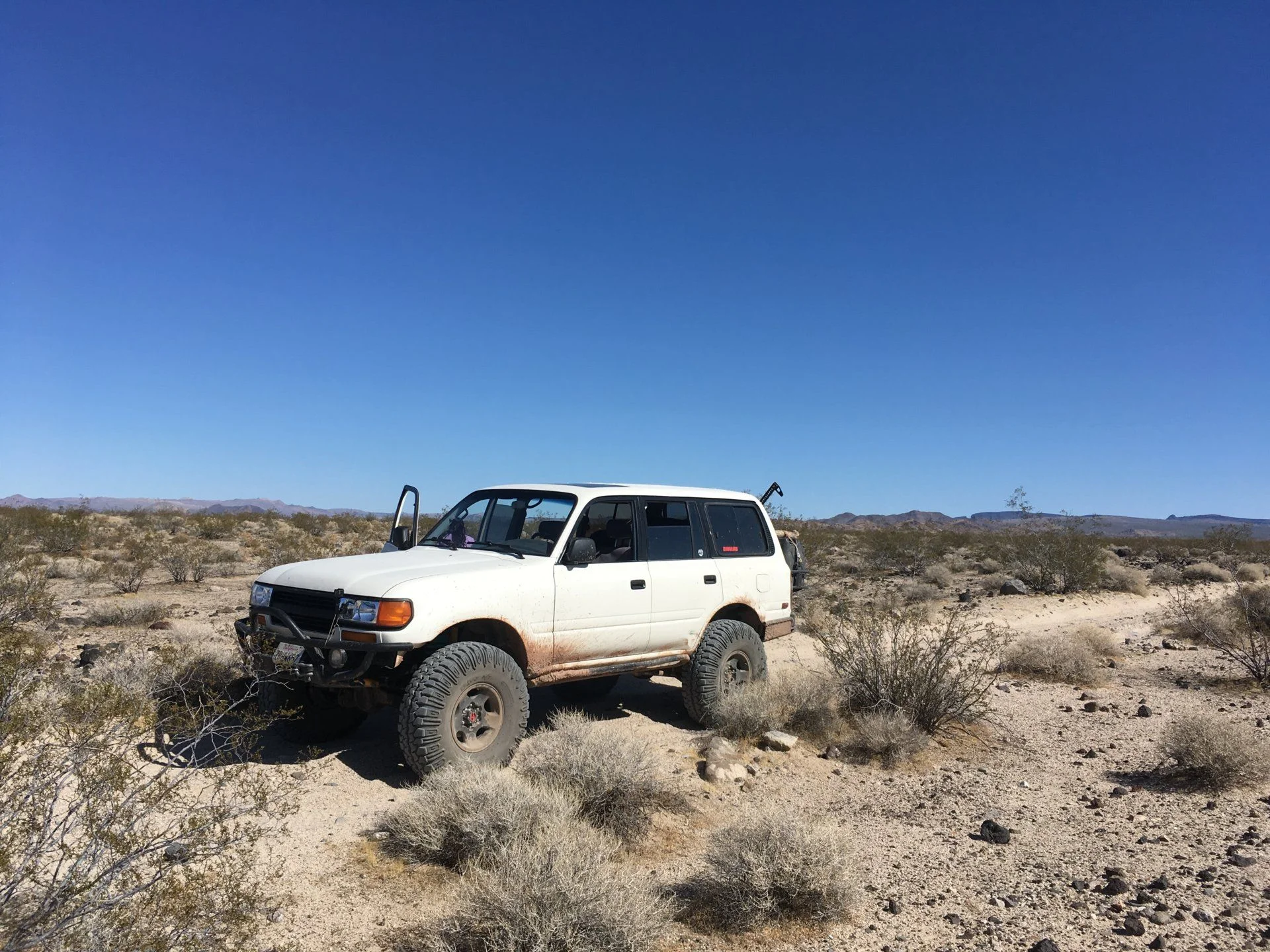

Out in the Mojave Desert on the Mojave Road which we traversed 100 miles of completely alone much to my pleasure. :)

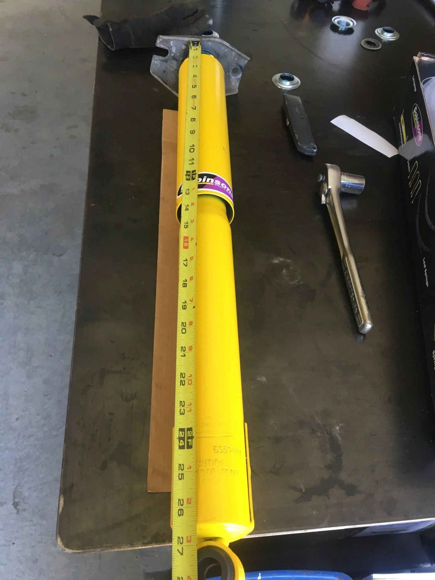

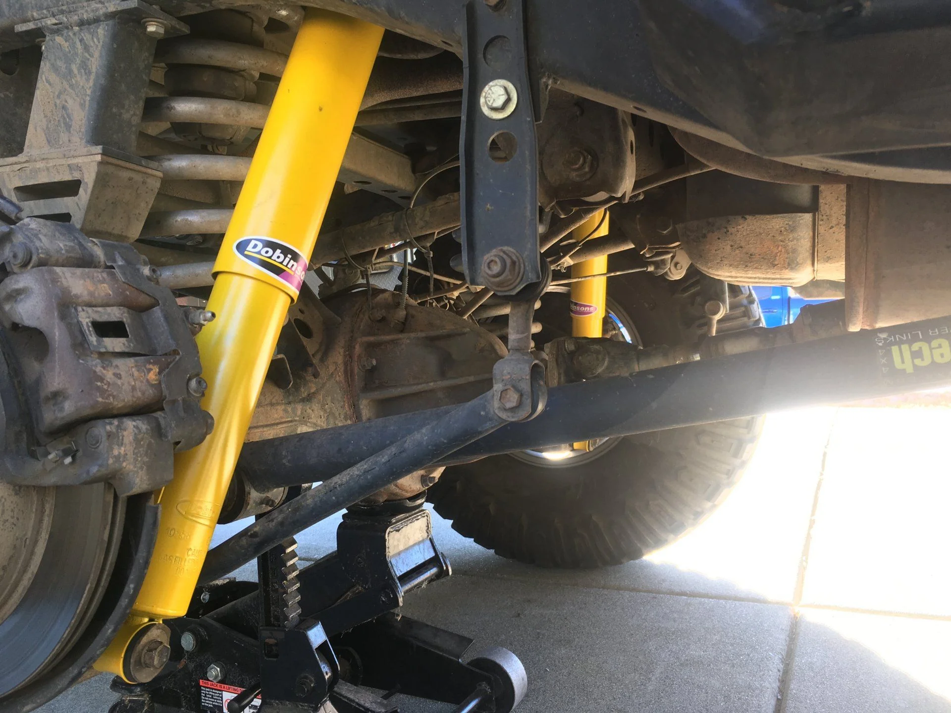

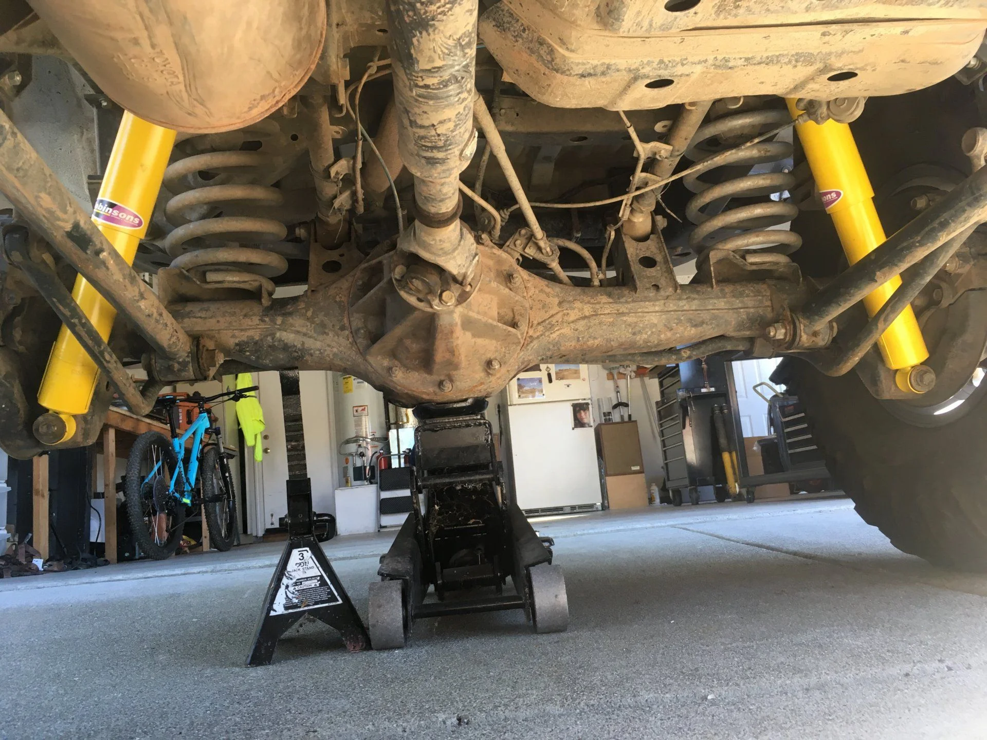

It’s been about one month since I ditched the OME shocks and installed these Dobinson’s yellow shocks. They cost $125 each, are about 1” longer than OME “L” shocks and they are considerable less damped on compression, which I find produces a more desirable ride under all circumstances. Rebound damping is very comparable to the OME Sport shocks. You can see that the body of the Dobinson shock has a larger diameter. I assume this means it contains more oil and possible a larger piston. The bottom line is, I like them better than the OME shocks.
This part number pictured the shock for a 4”-5” lift.

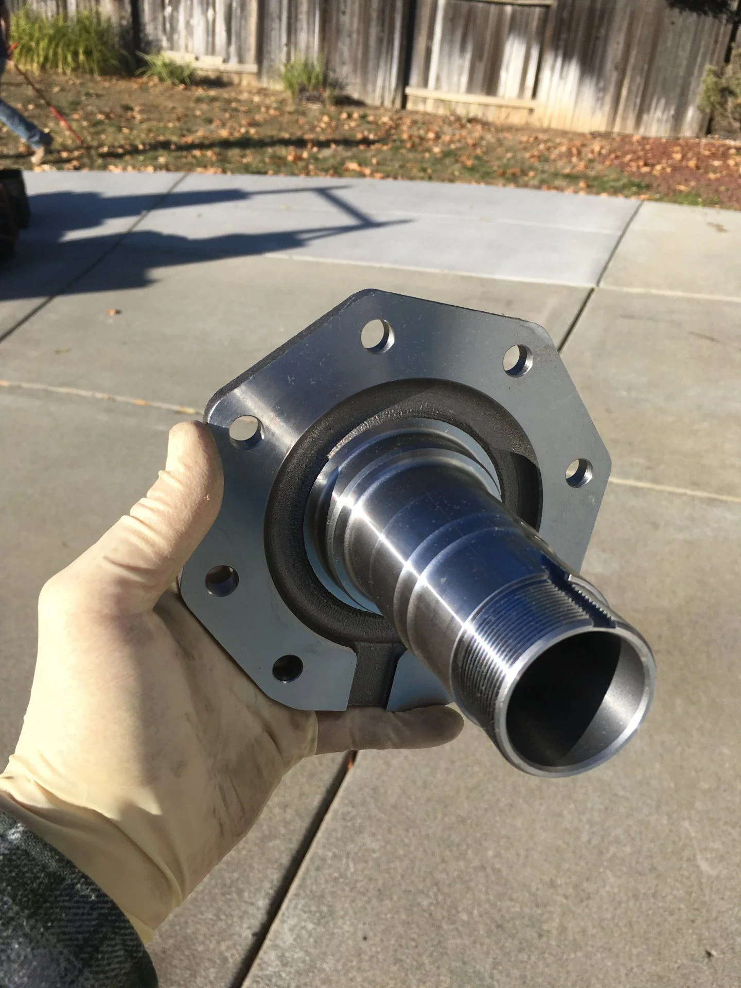

5,000 miles after after doing a knuckle service my front wheel bearings were loose again and the driver side knuckle was leaking grease.
Upon disassembly, I discovered two separate problems. A close inspection of the bearings and spindles revealed considerable wear especially on the inner end of the spindle where the bearing clamps up and apparently the bearings had spun on the spindle. I called up Cruiser Outfitters and they had new Joint Fuji spindles and Koyo wheel bearings to me in three days.
