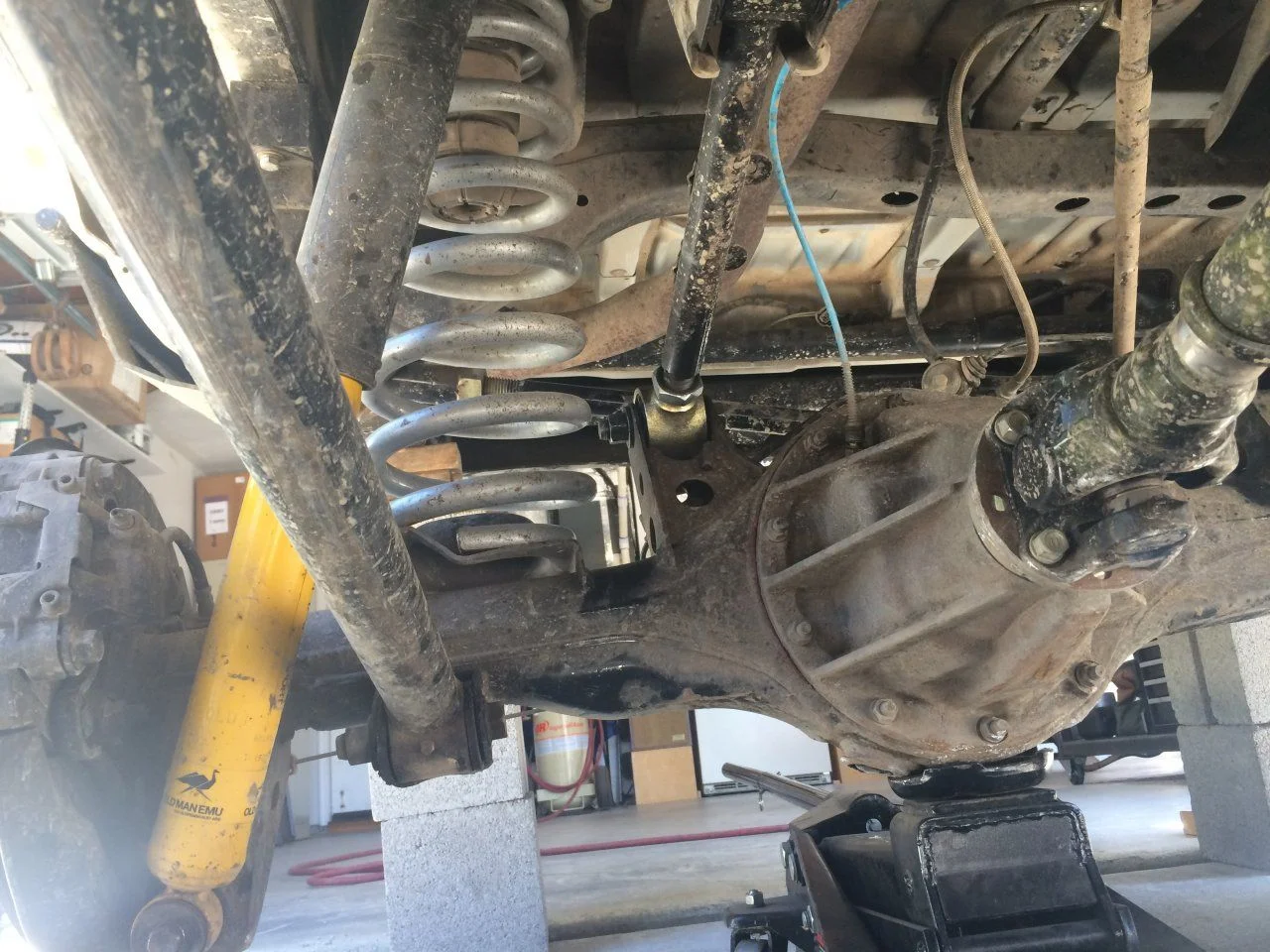

Also did some experimenting with the rear pinion angle with reference to the DC joint at the T-case. Text book rule dictate zero angle at the pinion but by doing that my springs sat incorrectly on their axle perch as noted previously. I found a happy medium without cutting the spring perches off, rotating and re-welding to the axle. The DC shaft is running smooth after dropping the pinion 4 degrees.
In addition to dropping the pinion I ground a good bit off the bottom the Slee spring pig tail in order to facilitate a more complete seat on the perch. These 80's have endless possibilities.
