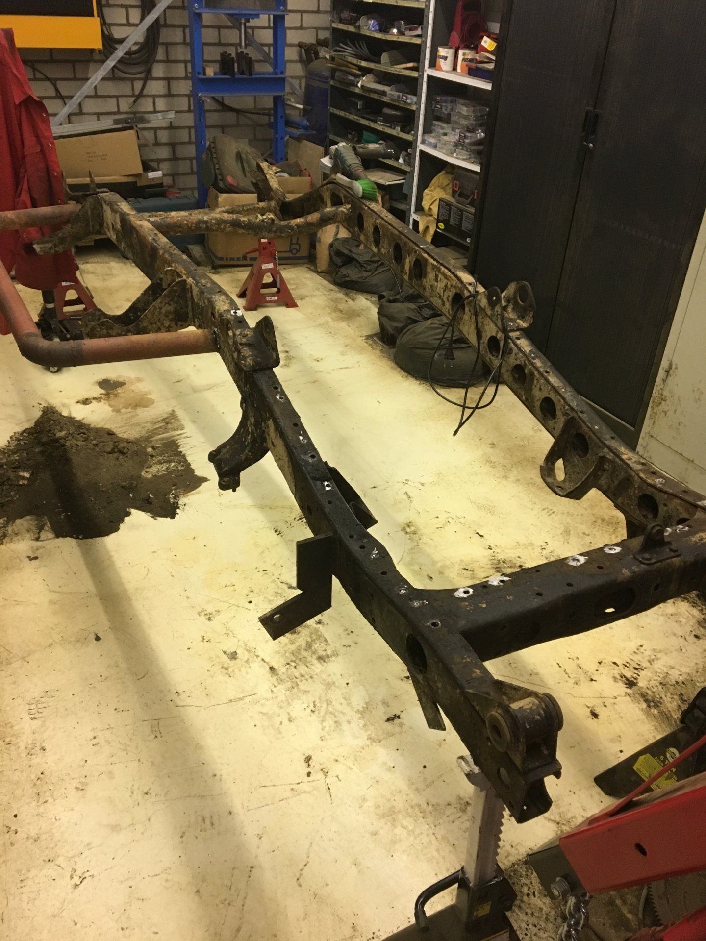

Dismanteling the frame. It is a slow proces, my shoulder does not like the use of hammer tools.😏
There is a lot of rust in between the parts, in some sections the inner and Outer frame pops when the rivit head is cut off.
The rear bumper and supports have seen better days.

Most of it is dry MUD and some rust but not that much.

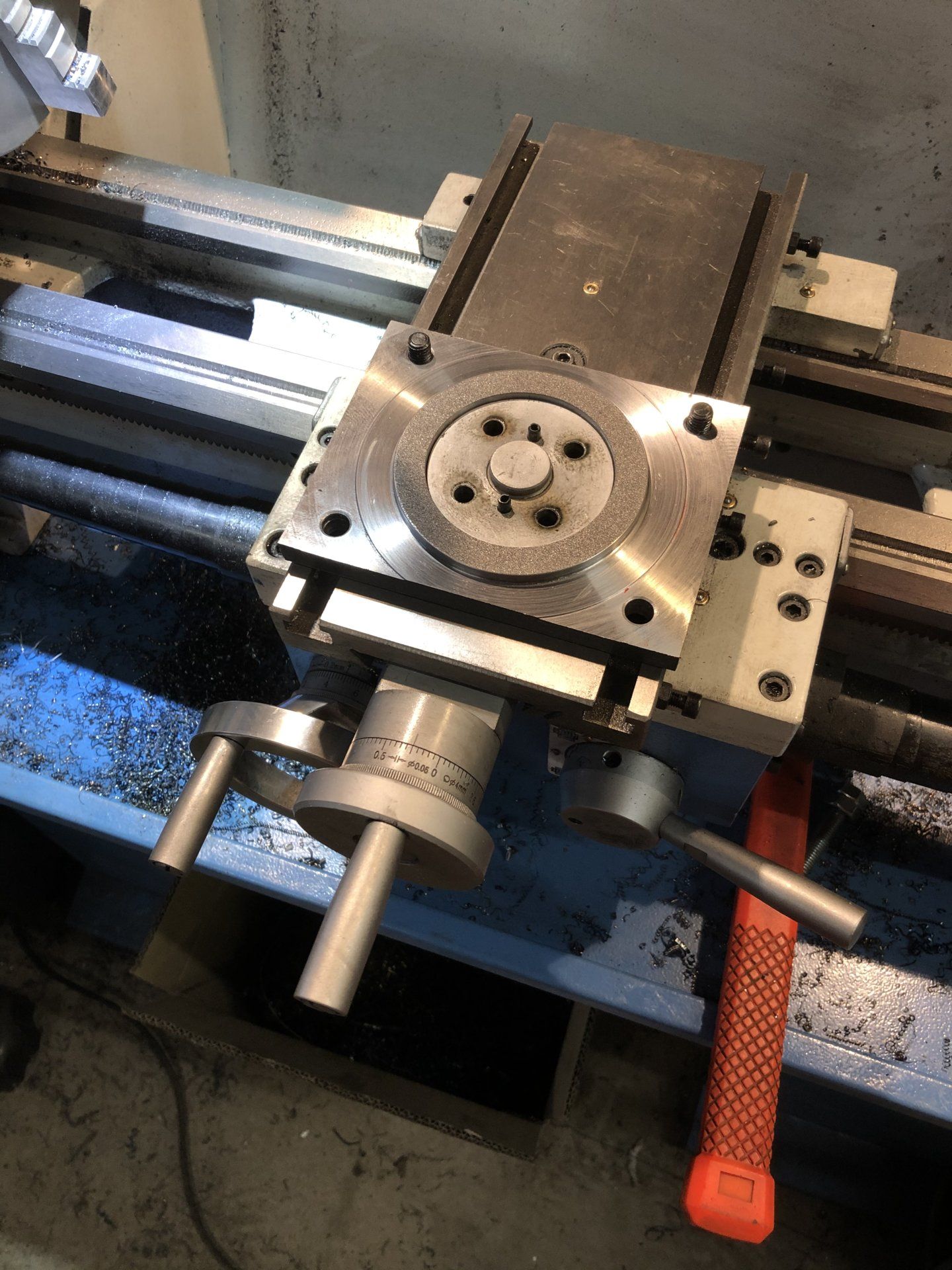

As my shoulder is still not good enough to do much heavy work and cutting threads is tough on the shoulder I decided to cut them on the lathe.
I didn’t take any pictures but they came out ok for the purpose but.........
The compound slide of the lathe had to much movement for the slow cutting and I didn’t want to risk crashing into the chuck.

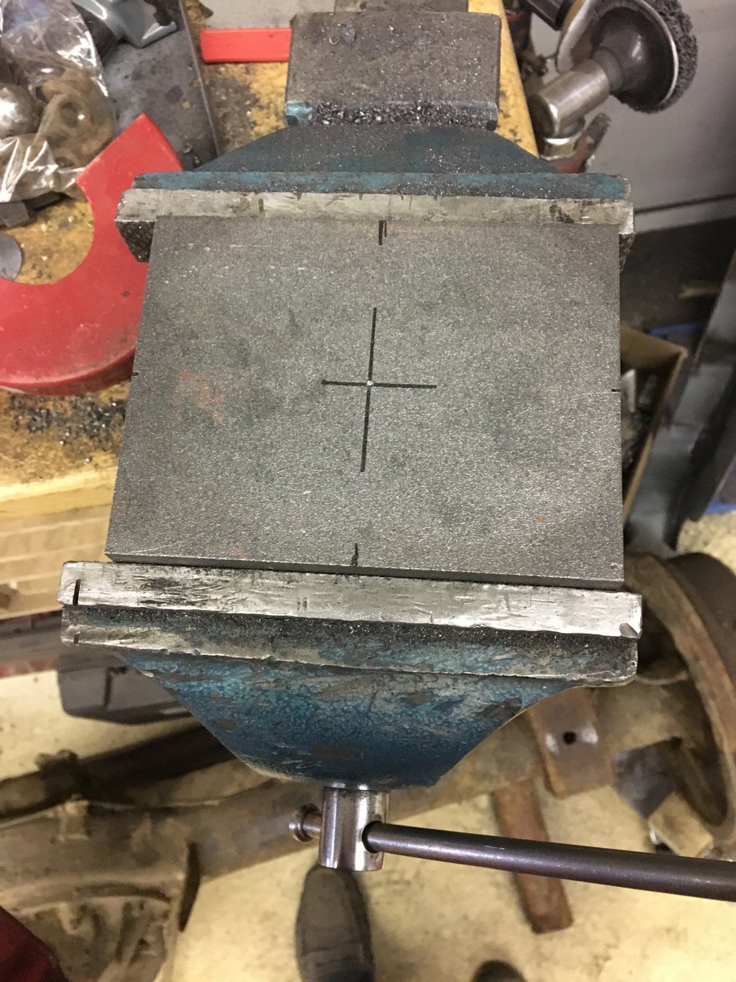

Thats when. I decided to make a new base plate for the compound slide.

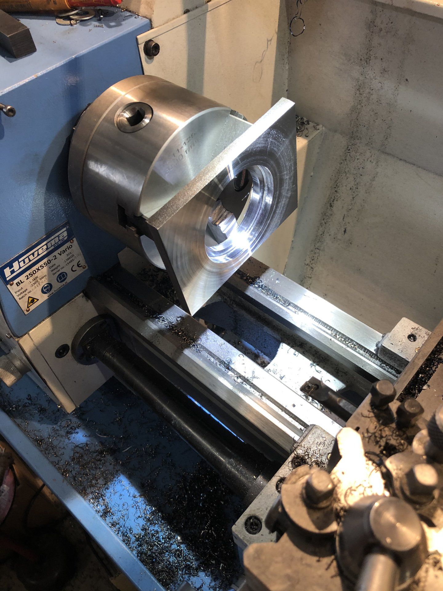

Started with some 15mm plate.
Finding the center
Drilling and turning.
Fitting, went from 2 M8 bolts to 4 M10.
Made an opening to view the angle and then put old and new next to each other. You can see the extra shoulder and bigger footprint.
Mounted together, big improvement.

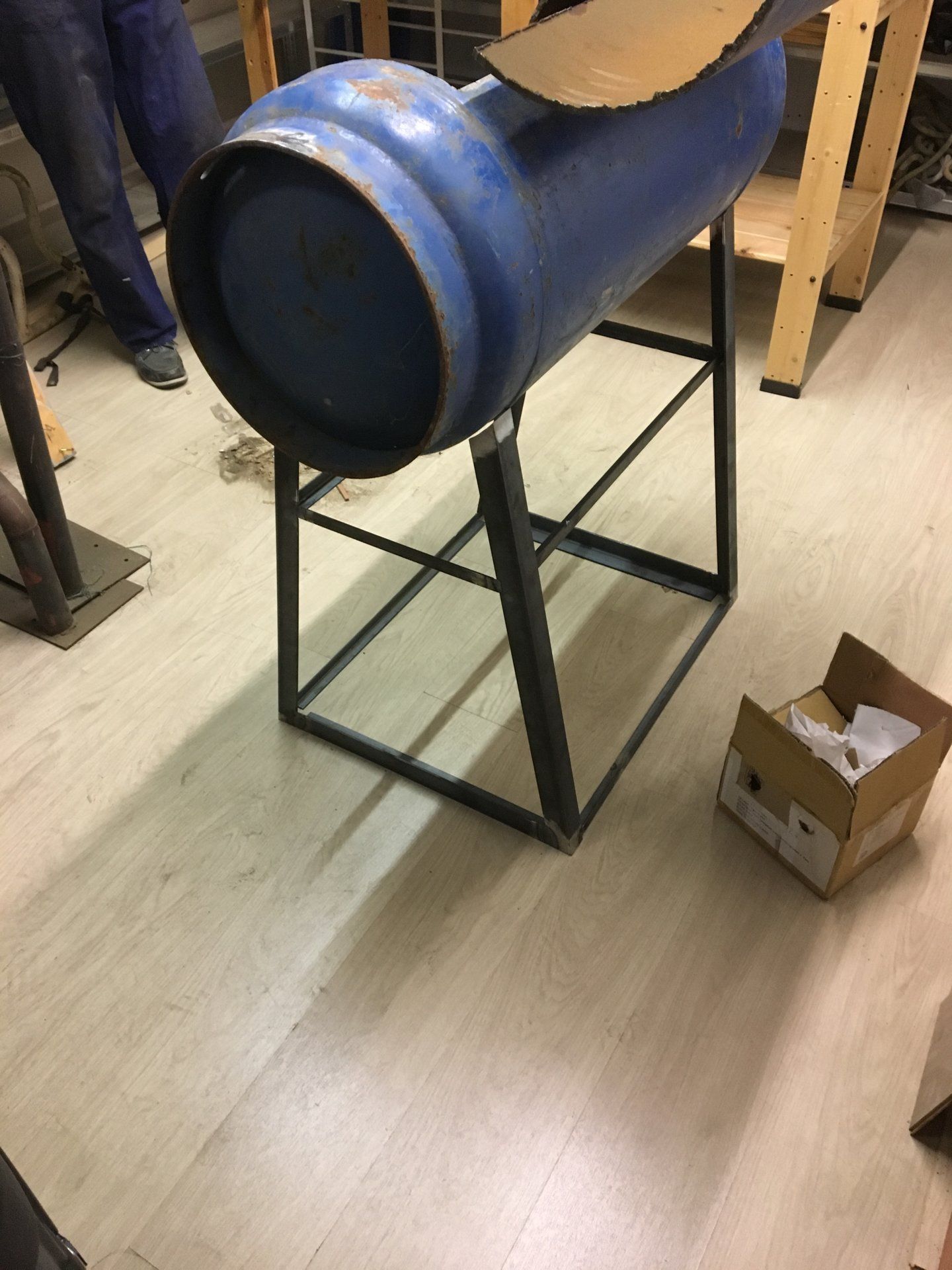

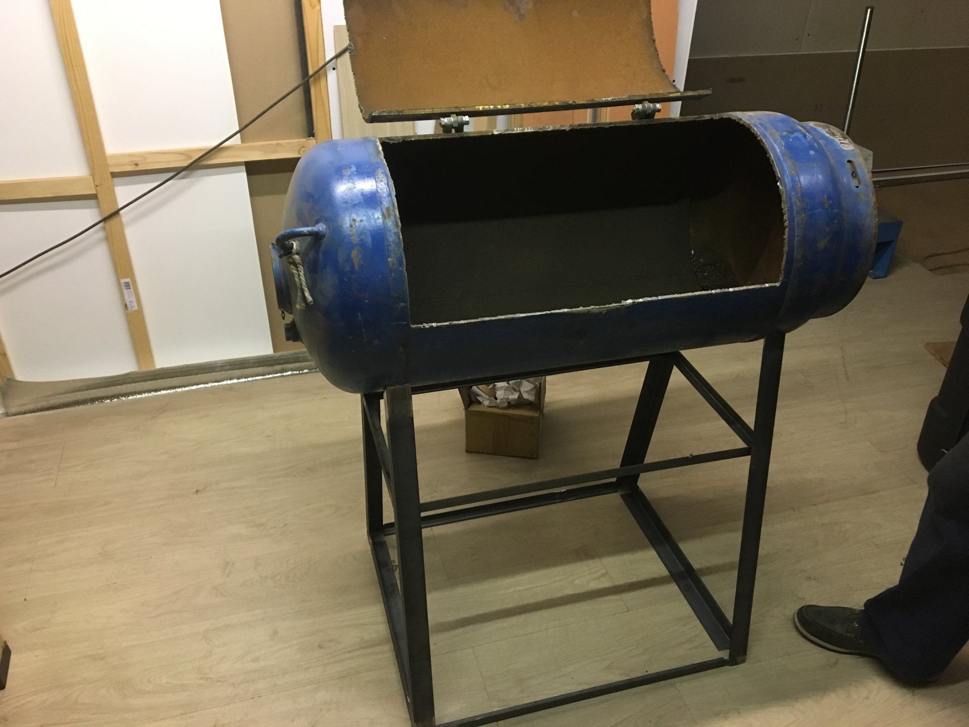

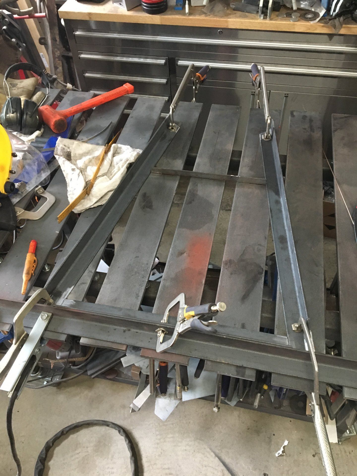

I did buy a new welder and tested it on a frame for the smoker project.
Legs land out
And ready for welding.
Checking for size.
Test Fitted the smoke chaimber.
And welded the mounting plates for the wheels.
It needs some gussets on the side and support frame for the fire chaimber but it is getting there.

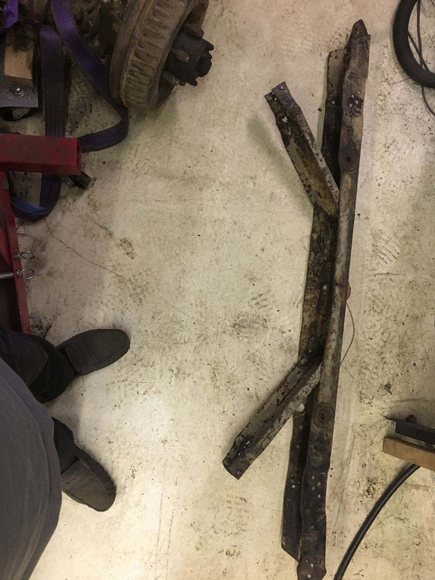

Got some more rivits out of the frame, no pictures, but the shoulder would not allow me to much time on that.

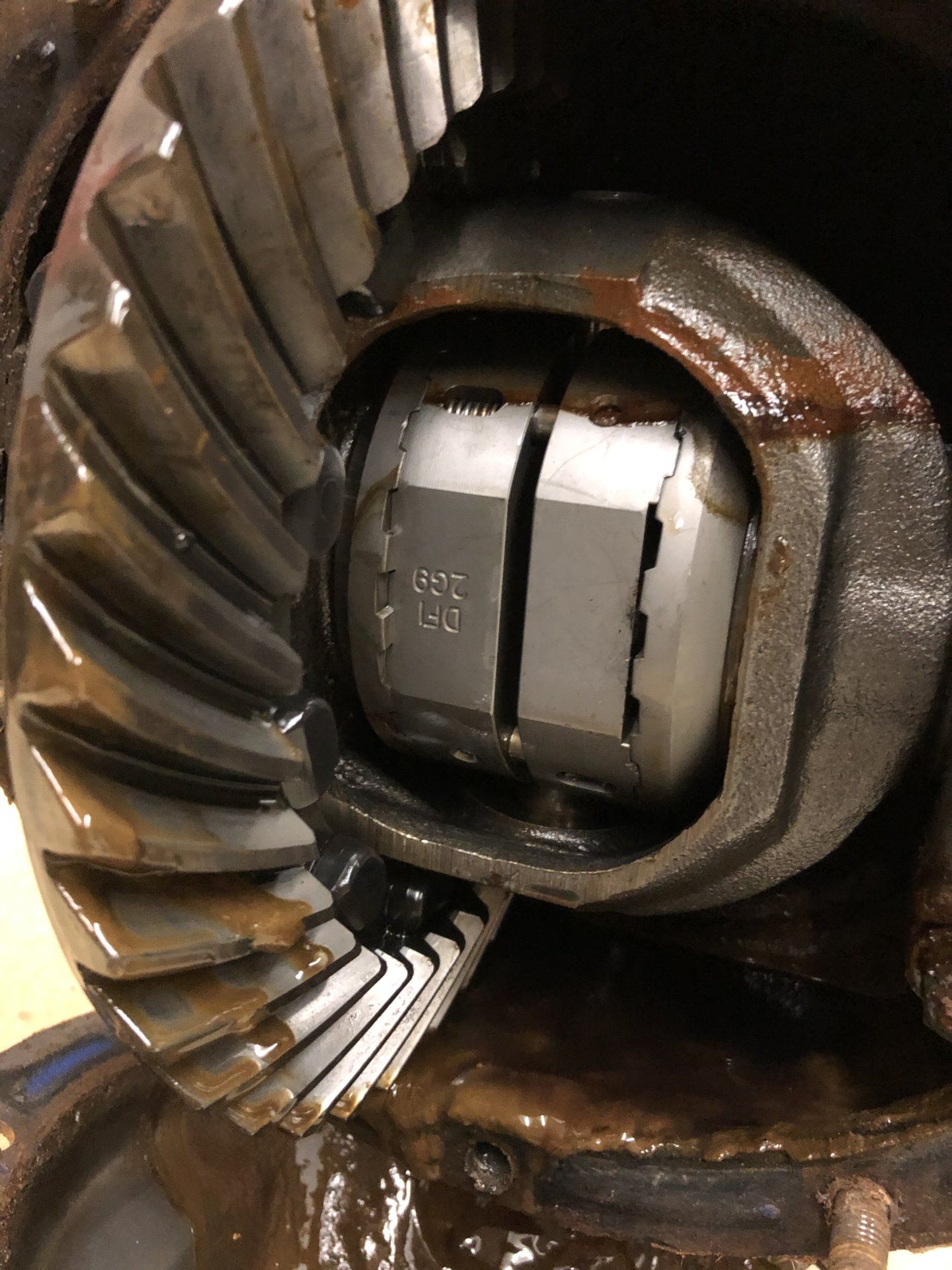

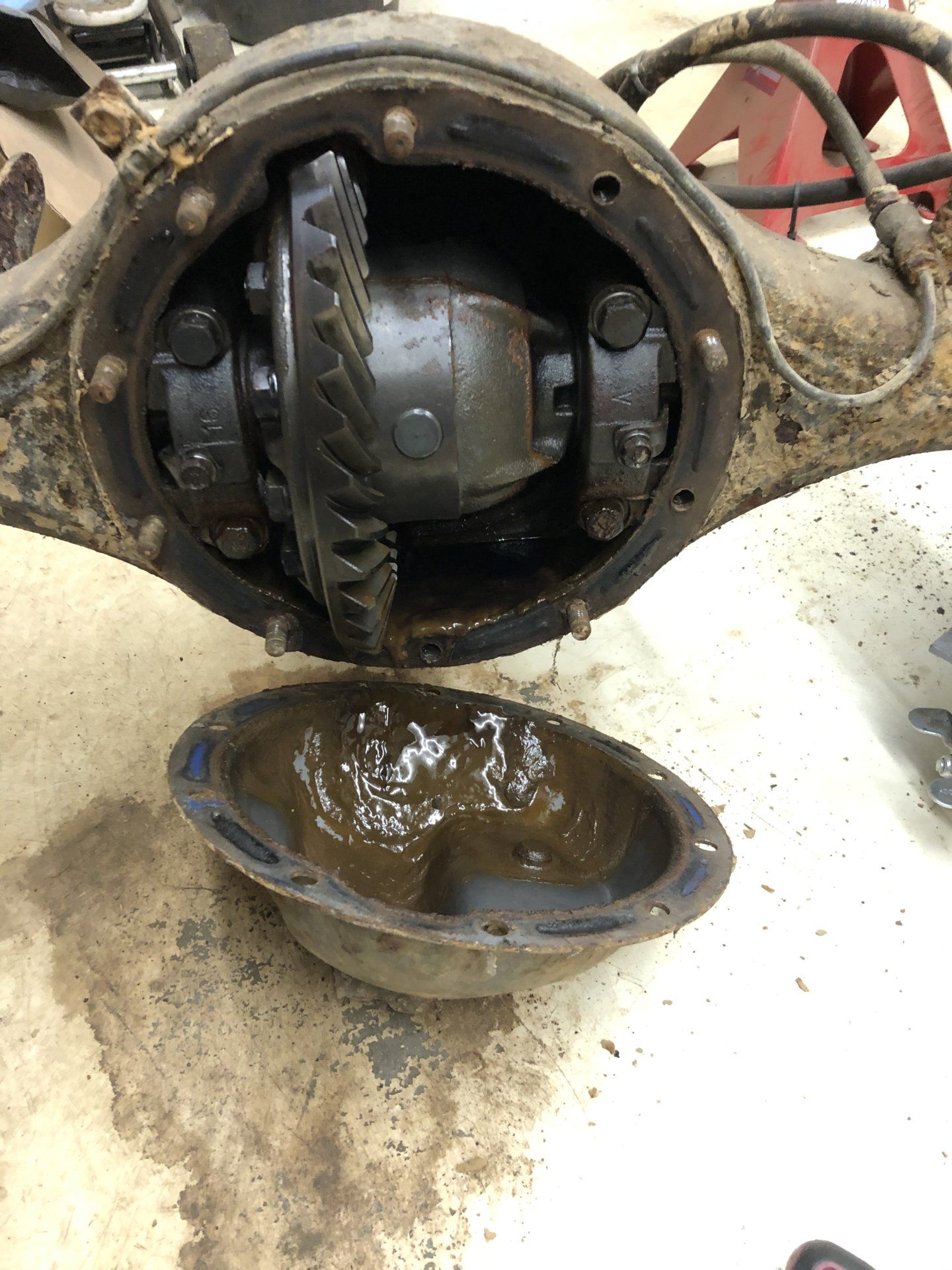

Got the cover of the rear diff off and I expected worse.
The plan is to take both axels apart, clean and rust free.

Got a few more rivits out but still carefull with my shoulder.

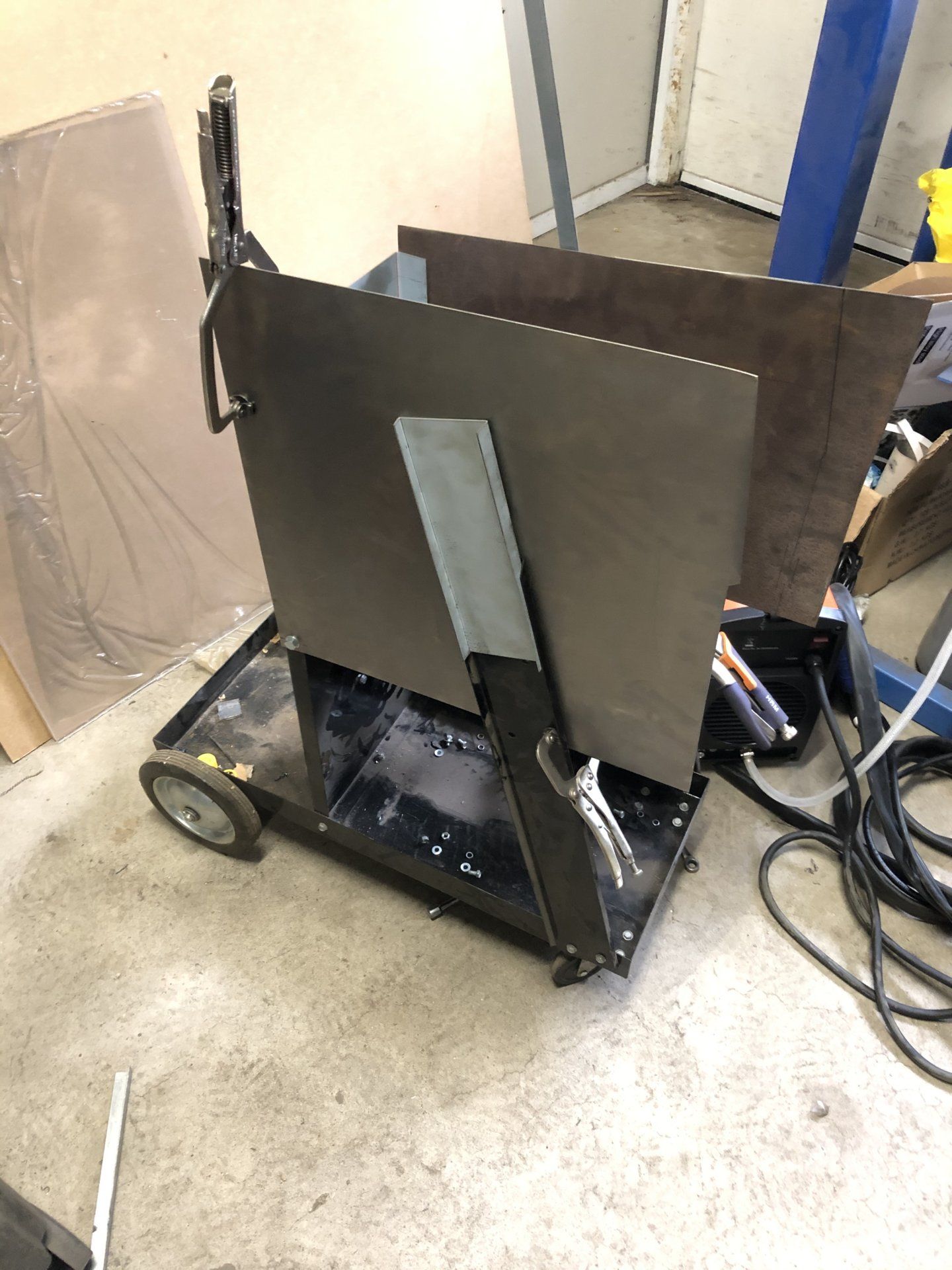

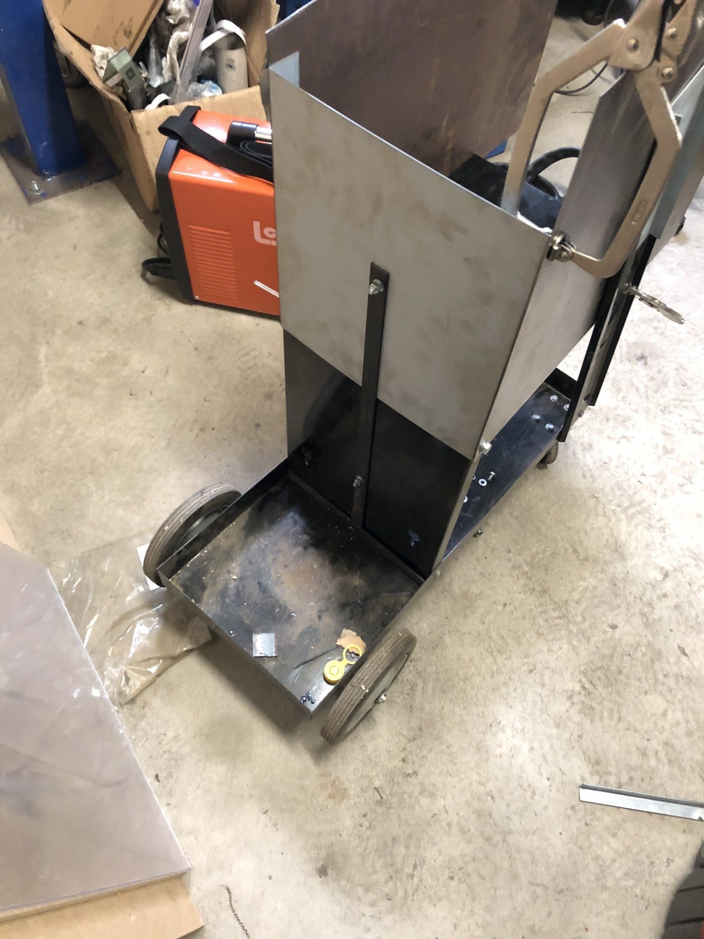

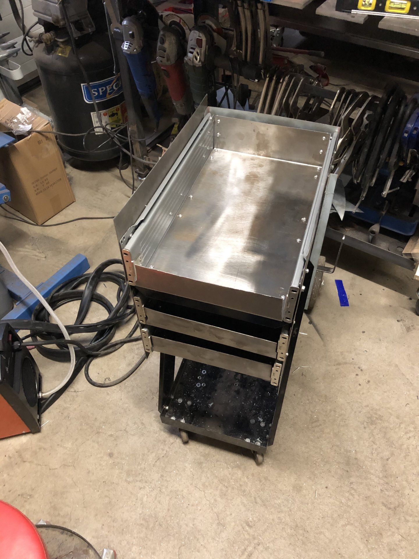

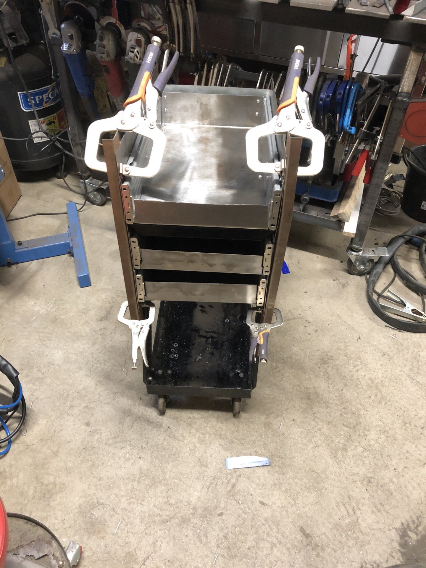

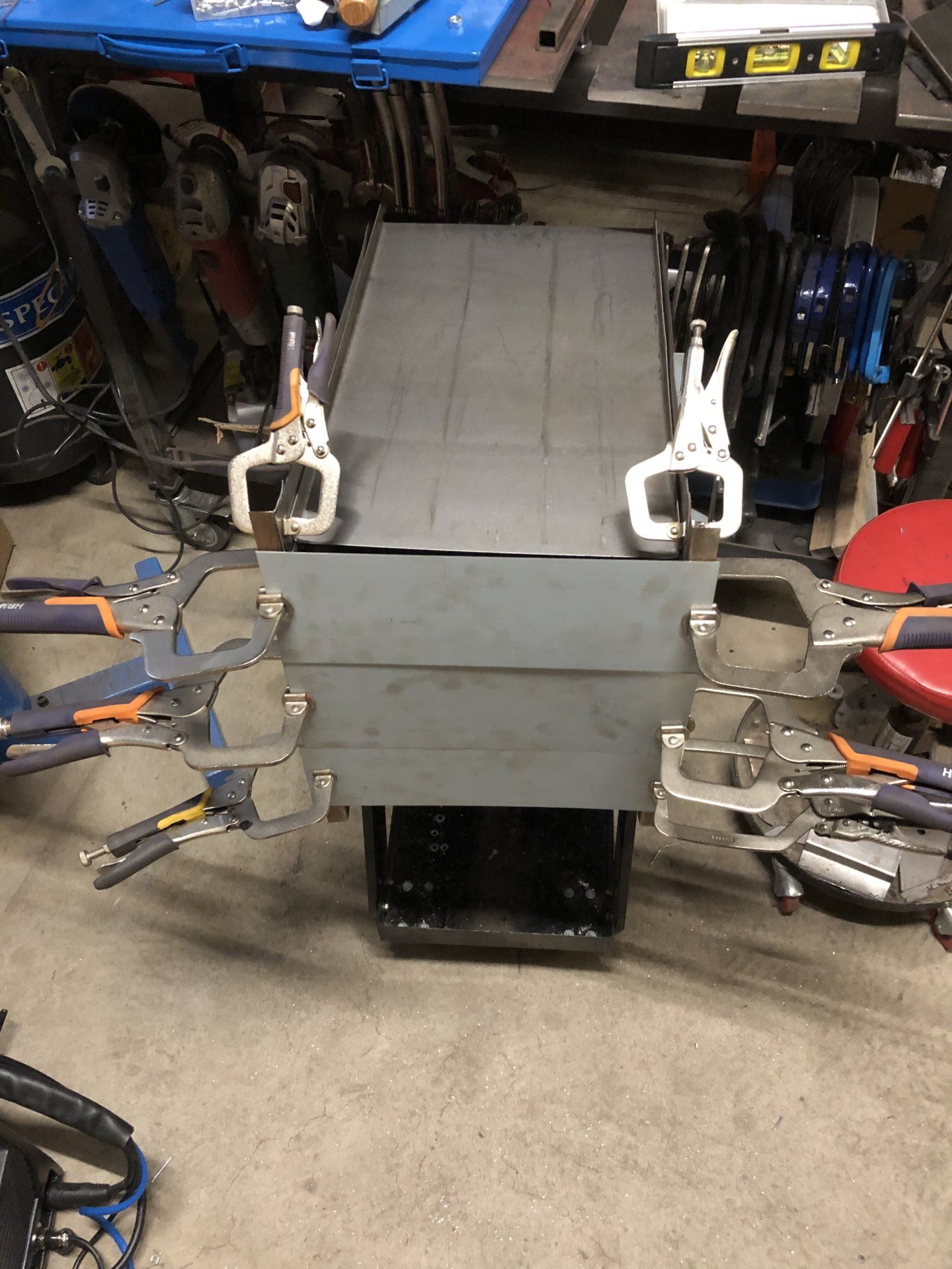

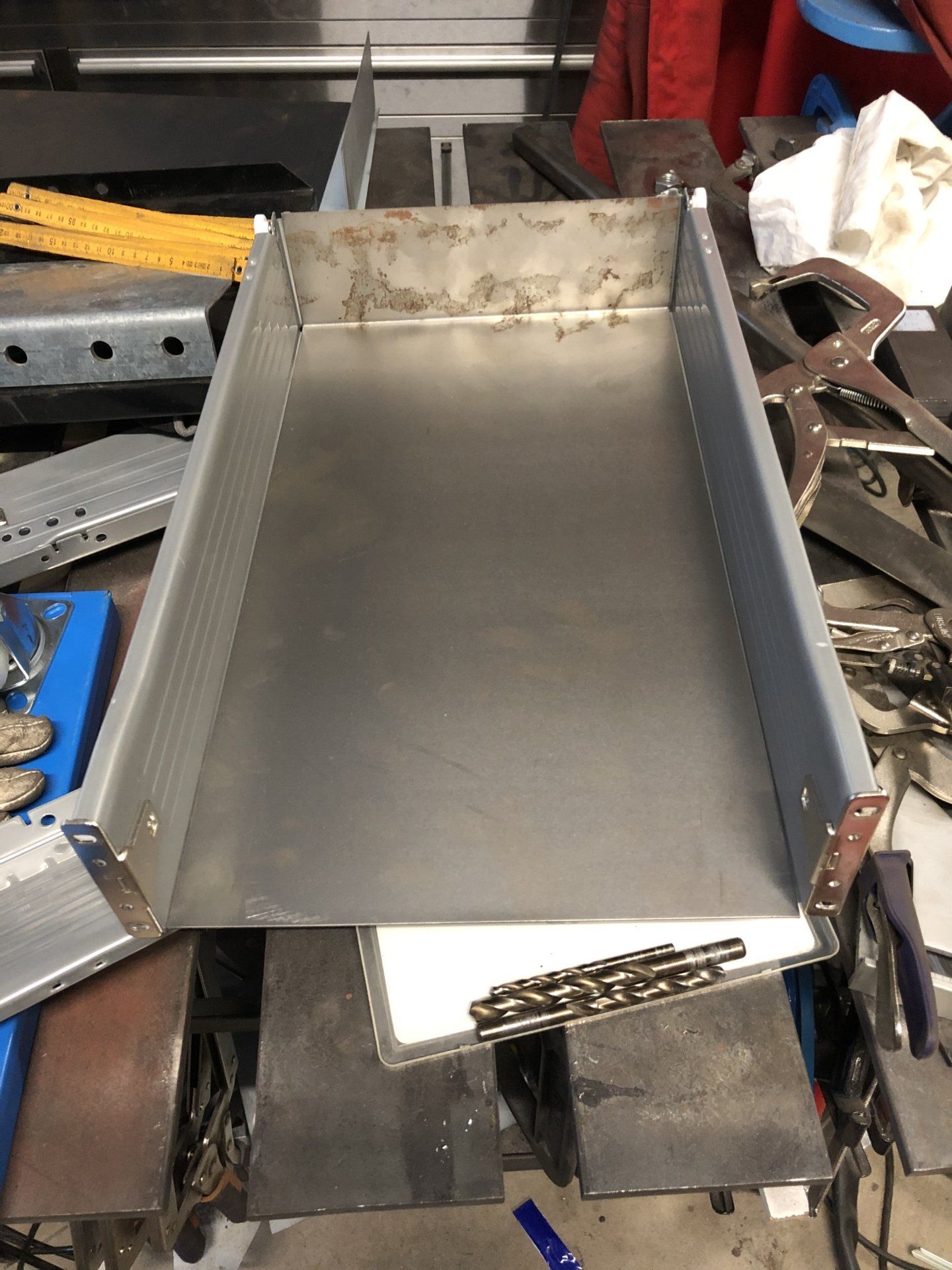

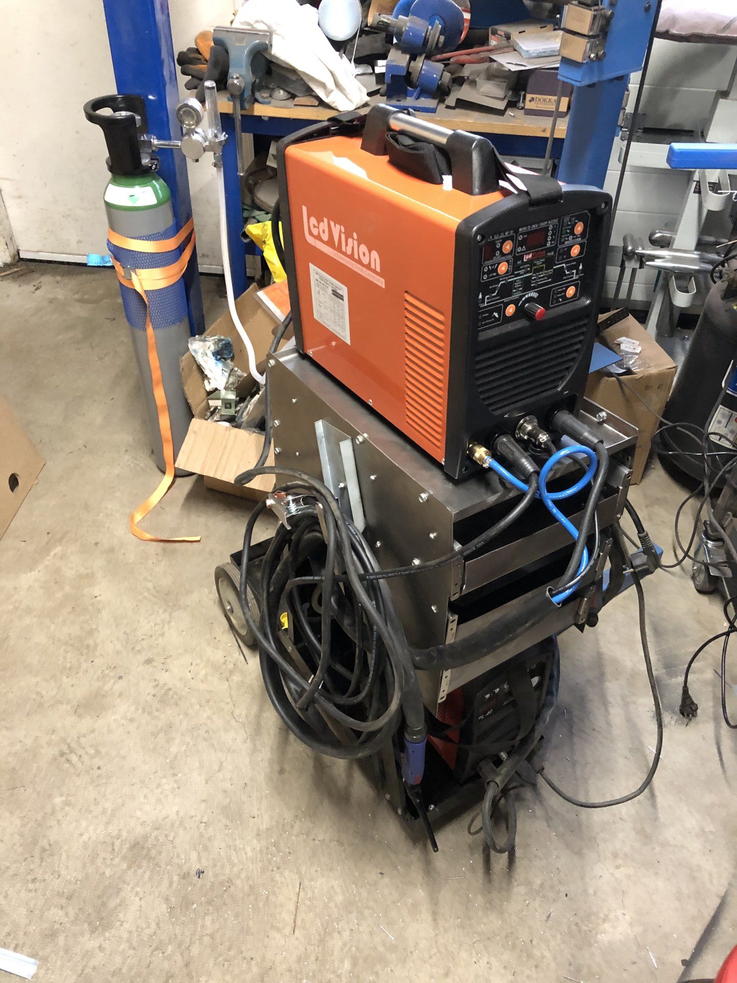

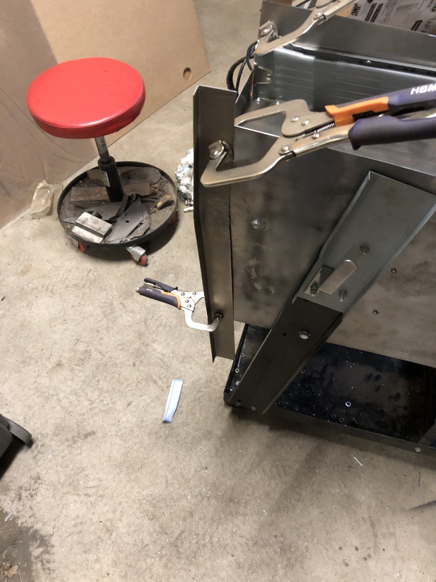

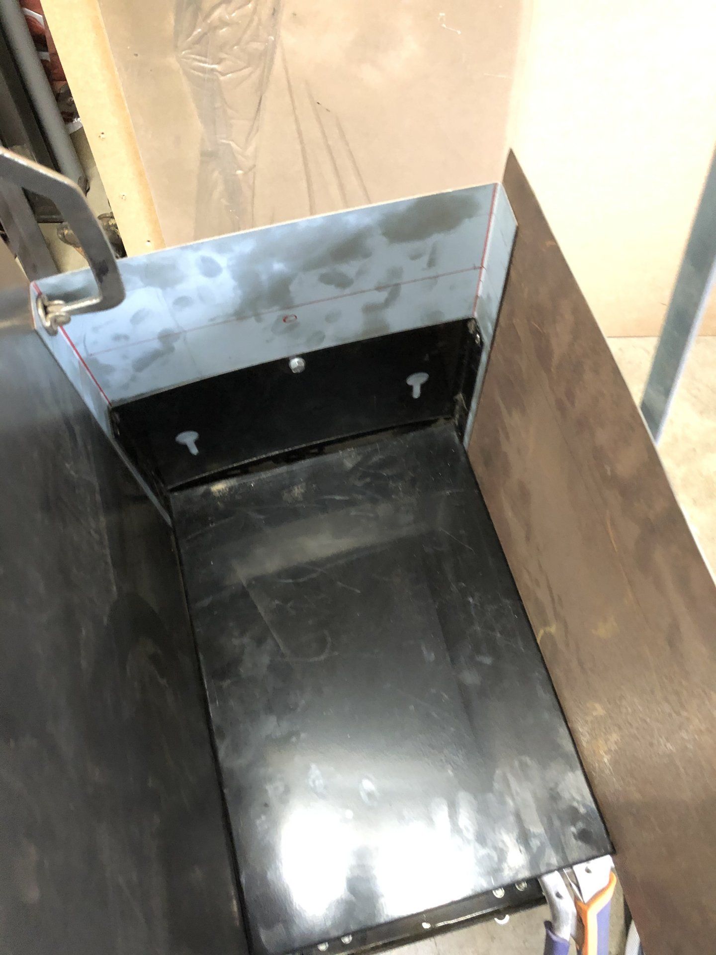

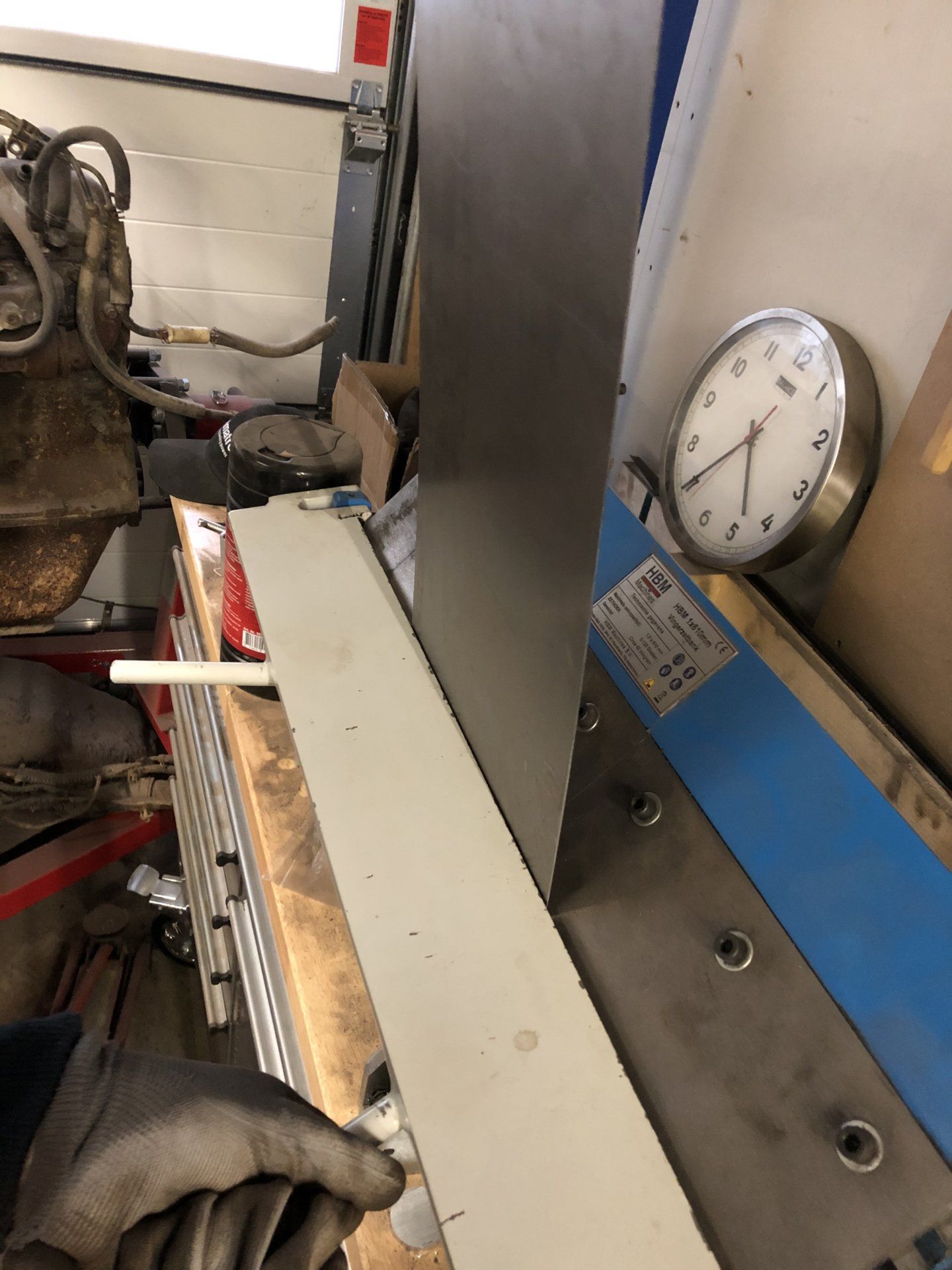

Got a little side project, monding my weld cart.
Going to expand With some extra height with drawers.
Extended the sides and closed them up.
Added some rails.
And a drawer Made to size. More tomorrow.

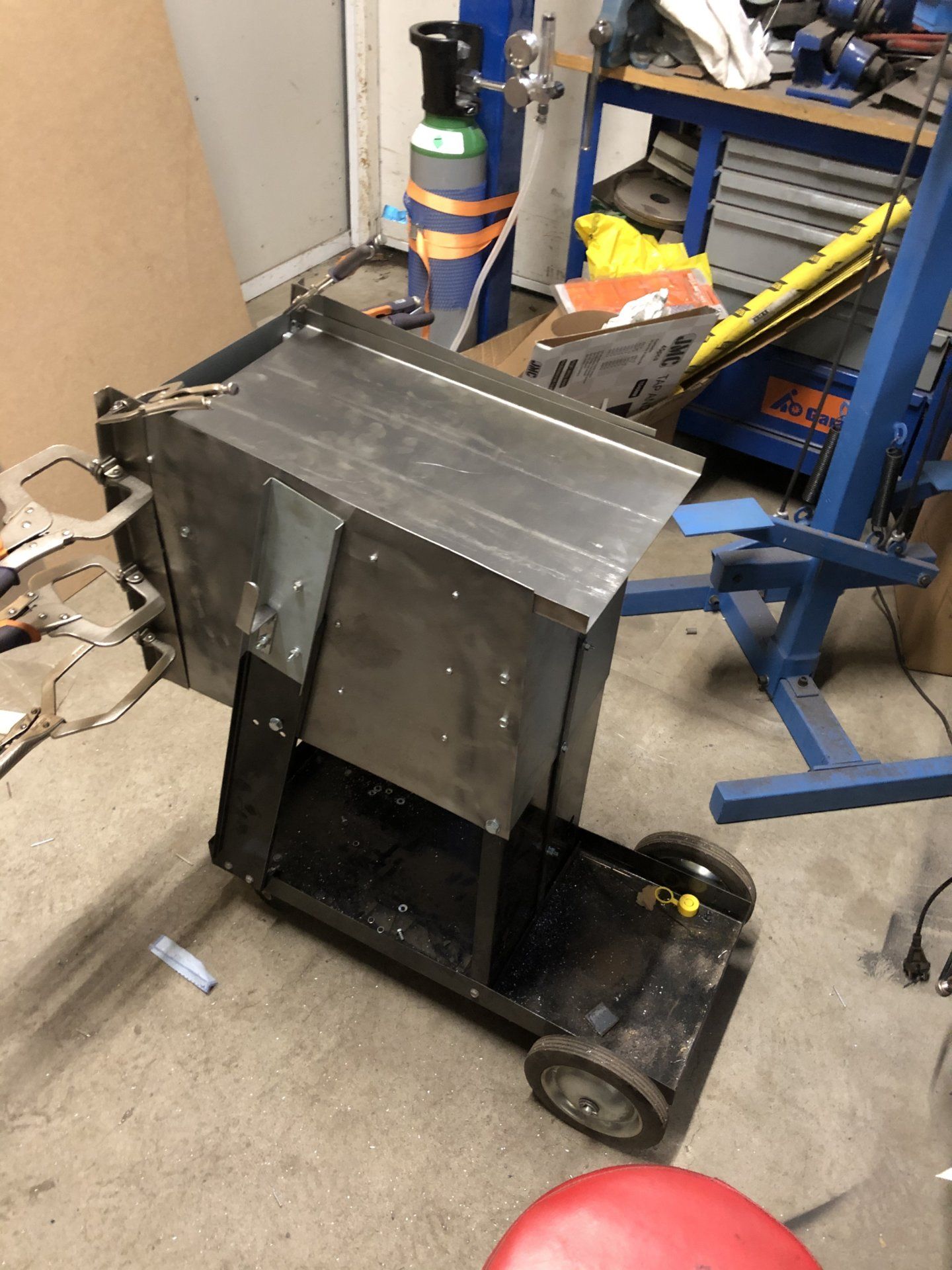

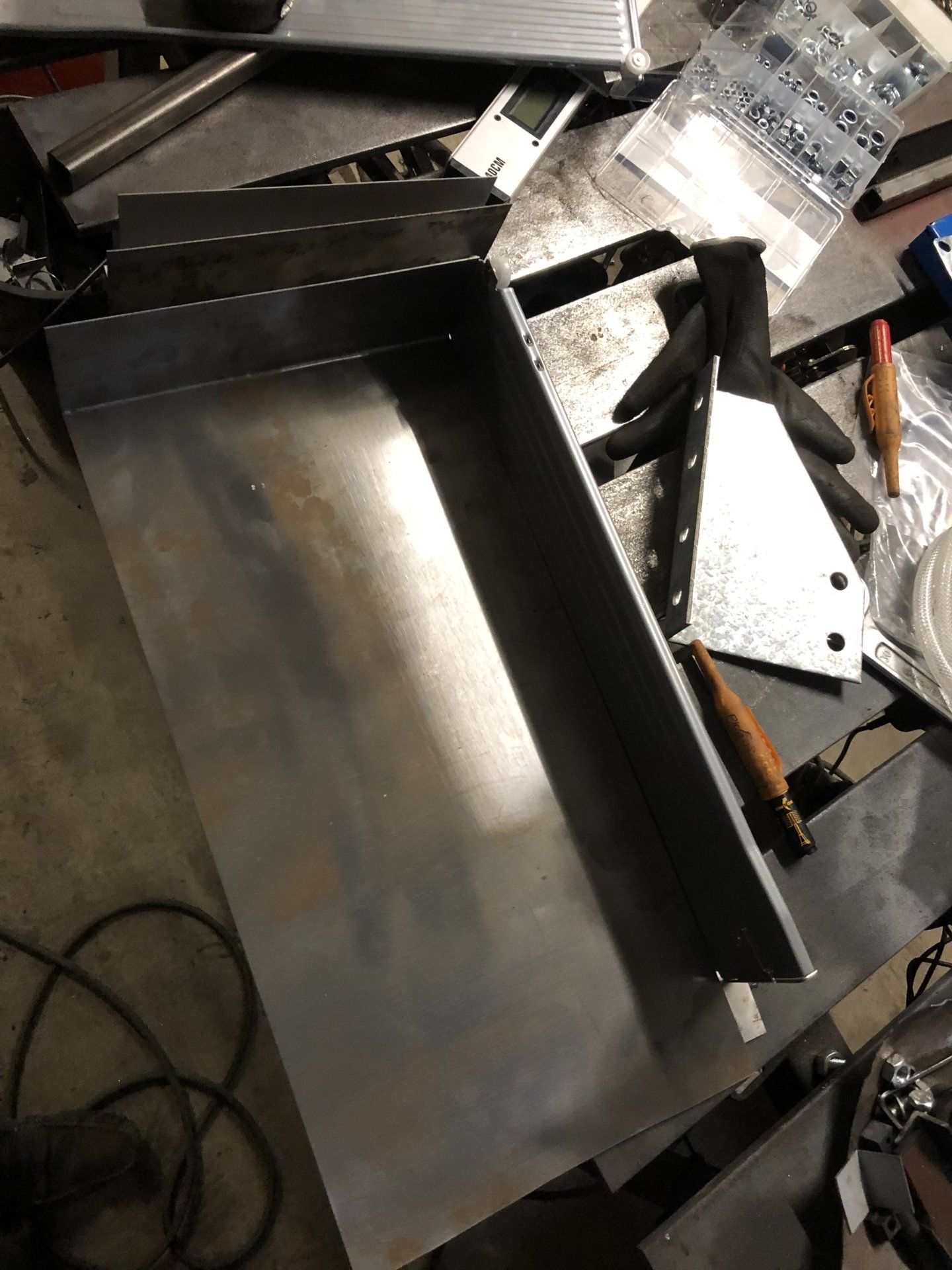

More work done on the cart.
More details can be found in the workshop/mancave thread.
Almost done with the body, just the fronts and botle holder. Plus rod and pedal brackets.
