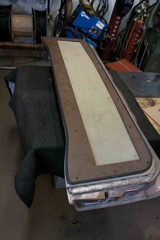

Got a bit more work done.
Here you can see the new panel compared to the Carpet that Brian sent me:

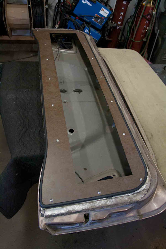

And without the carpet, I've got the bolt holes lined up perfect now:

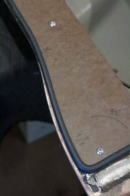

You can see the profile is not perfect yet though:

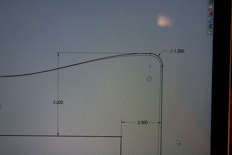

And a fix to get us a bit closer.....
The file is down at my laser cutter now.
