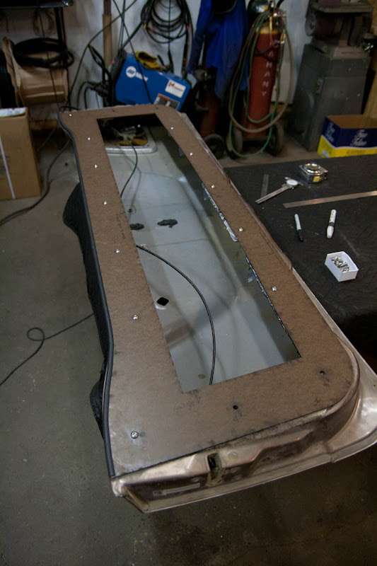

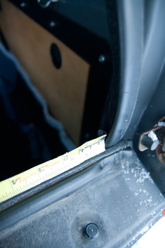

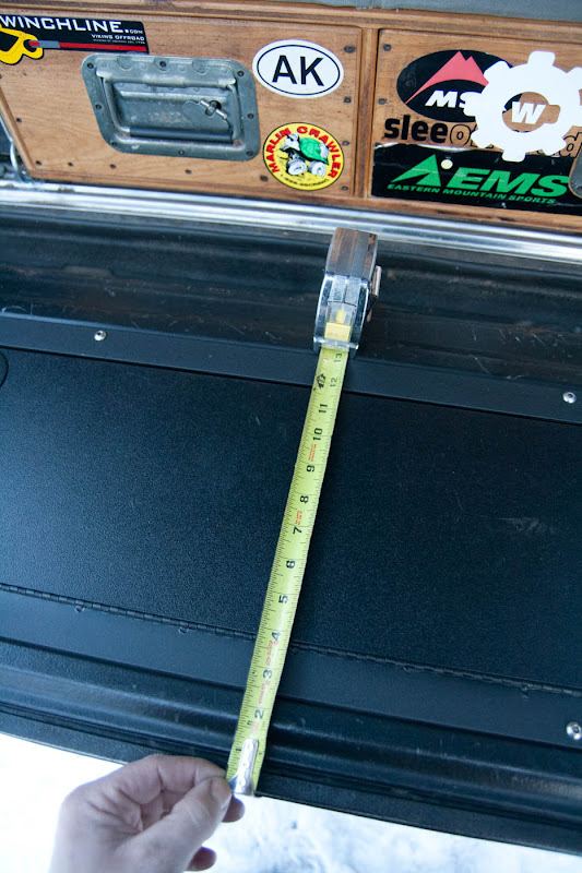

I think that's about it, Dan has been a big help with the project so far, I'm attaching a few photos that show some more measurements I need to check.
Feel free to help me out with the numbers I show here instead of flooding my inbox. :cool:
I need the dimension at the top of the tailgate from weatherstrip to weatherstrip, with the tailgate closed like I show here (if this were a 100)
I also need the dimension from the top edge of the tailgate to the top edge of the set plate like I show here (if there were a set plate in this picture). I need this dimension with the tailgate open and with the tailgate closed.
And here's a shot of a recent template, things are still in the masonite phase:

I went and popped in the bridge for ya and took some measurements. I'm taking my truck west in a few weeks but i'd be up for a weekend trip to come help iron out some measurements/fitments using my truck.
Measured from the very top like you asked(i didnt realize it at first) from edge of weatherstripping to edge of weatherstripping looked to be 53.5"

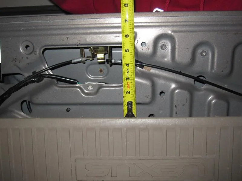

looks like ih8mud auto-rotated my pictures, sorry bout that.
No problem, that shows just what I need, thanks a bunch, I'll make the updates!
