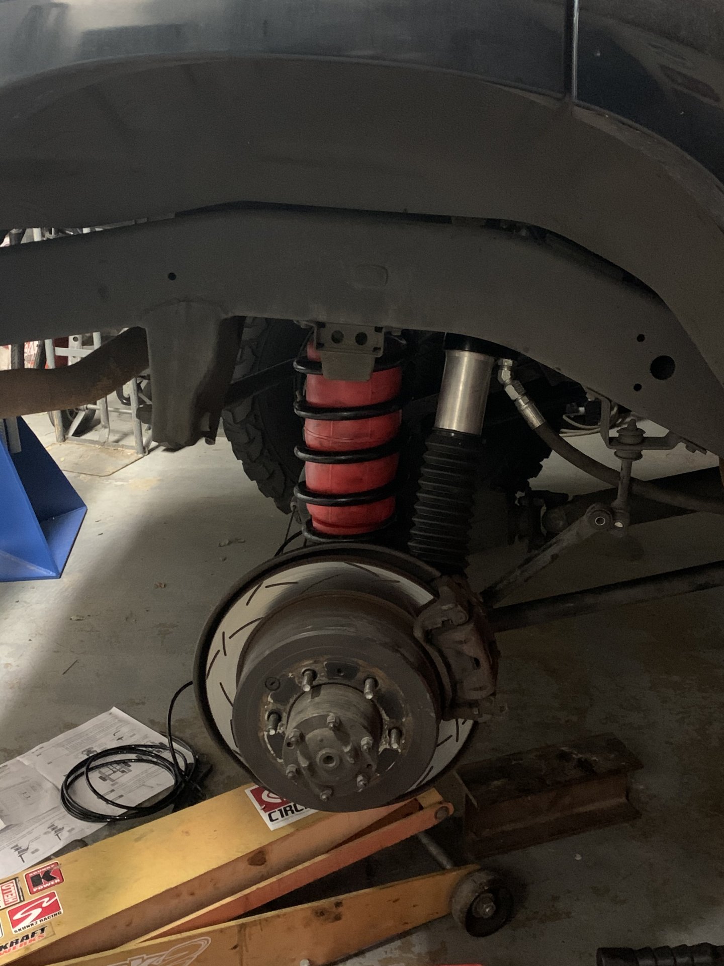

Good morning, a bit of a tall order here. I’m looking for a heavier spring then my current setup. I currently have the Icon 3” kit but I used 30mm spacers to level out the rear since I yielded a bit more then 3” up front. I also have Airlift airbags out back specifically for towing.
I’ve already felt the rear springs were a little soft to begin with. Although it may not be ideal, what is the heaviest rear spring in 4” of lift on the market.
