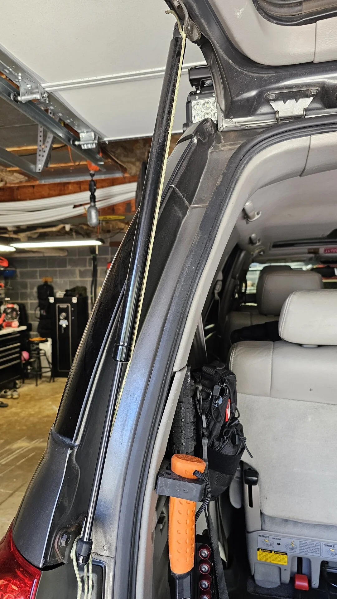

Tie a piece of paracord or something to the arm on both sides to prevent it from extending all the way open.
idk what the door looks like, but could you just add a strap to the handle thats there, then you aren't trying to jam up the hydraulic
There is a factory strap on the door already. Might be way easier to just extend that? It’s a single 10mm bolt to remove it. Just get a 24” piece of 1” webbing, double it up, and bolt it to the door easy as can be.
