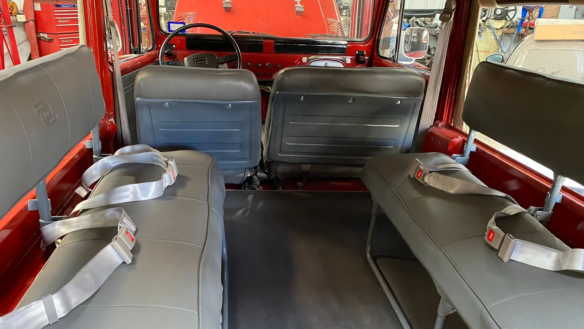

I ended up installing it as the picture, check it out.

Very nice @totem,the seat belts look like that will do the job. Where did you source the belts.? In the end you should consider a roll bar as a safety item.

Here are the belts: Grey Seat Belts - 2 Point Non-Retractable Rear - FJ40, BJ 1979-1984 - https://cruisercorps.com/products/seat-belts-2-point-non-retractable-rear-grey

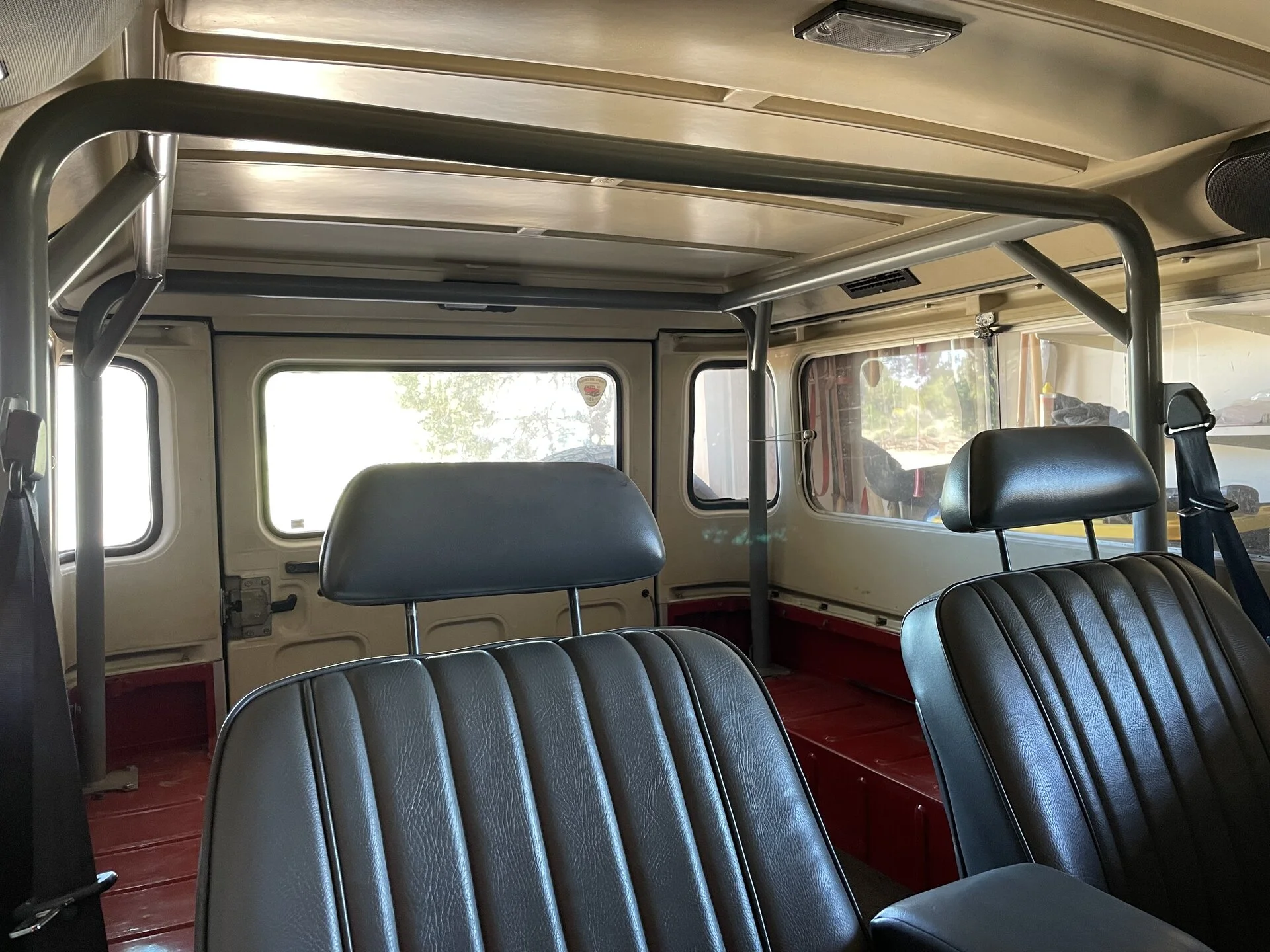

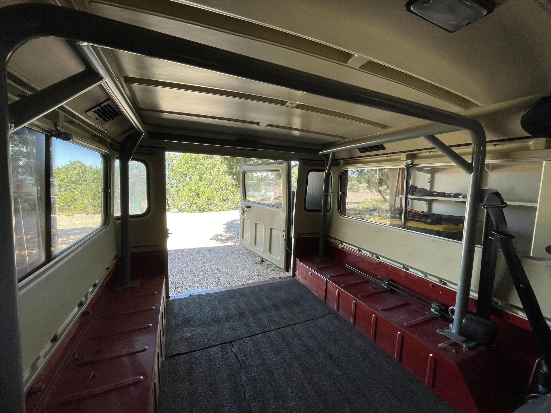

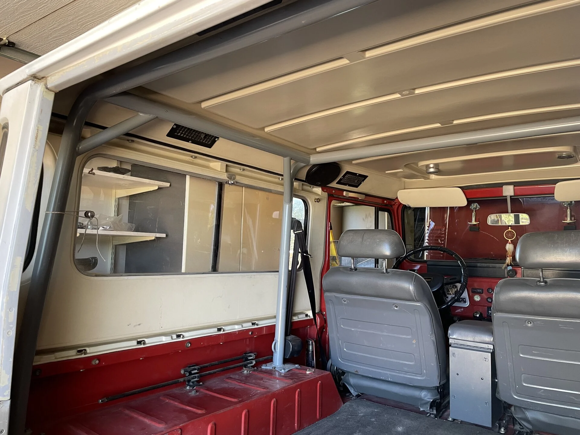

I think a roll bar is essential. I had one made for my 1981. I run the hard top but in the event of a roll over it would simply crush, about the same as a soft top. There is a guy in Grand Junction Co. that does a great job with fitting roll bars. Also as far as safety, the front seat belts now attach to the roll bar and not the hard top. I don’t use my jump seats. I keep them out so I have the extra loading space. When I use them I use some extension spacers that push the seats out, away from the roll bar.
As for as lights go, I used the plug and play Koito head lights @ToyotaMatt sells.

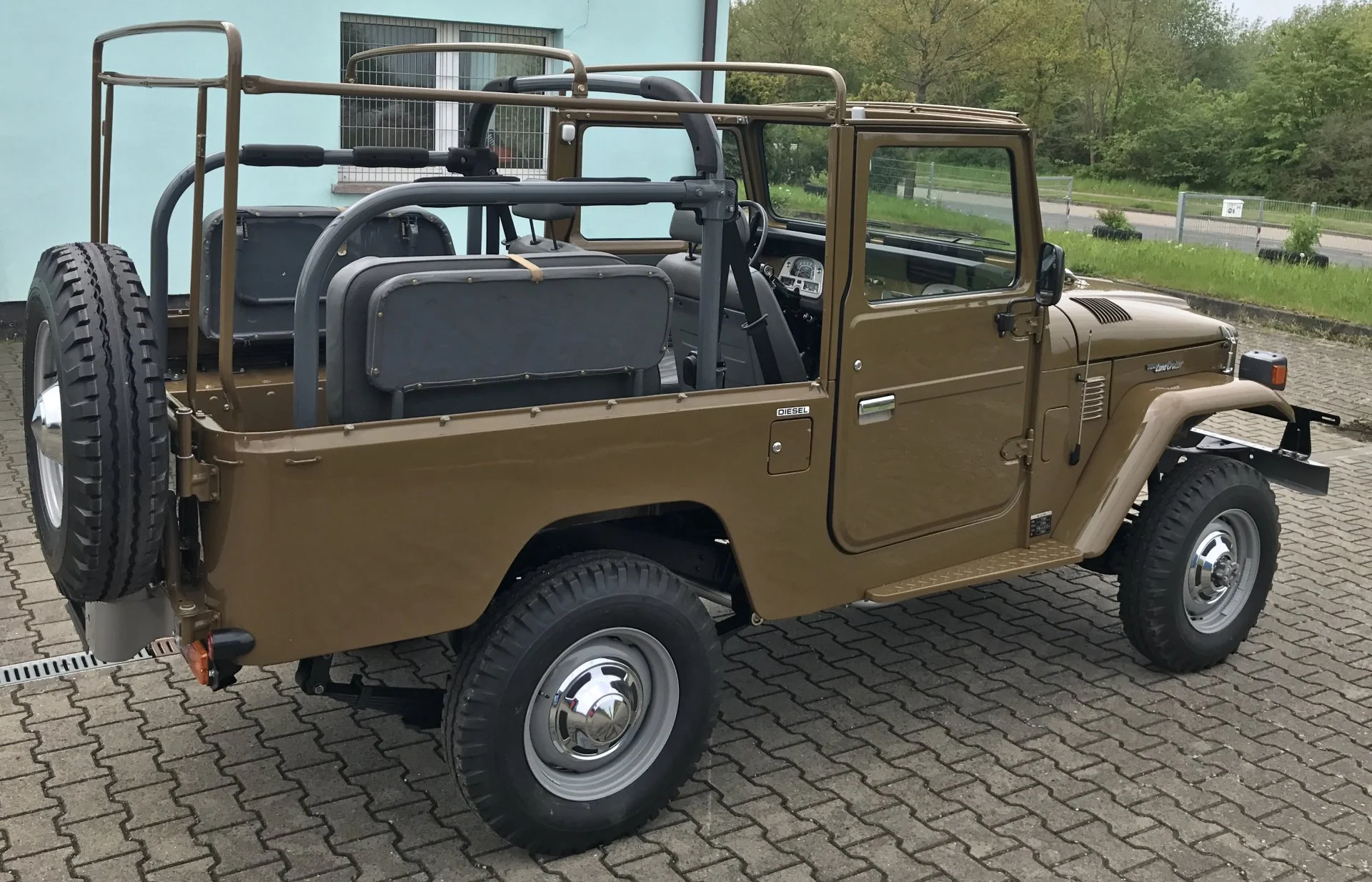

The 43 came with a OEM roll bar in Europe!
And some photos of my roll bar…..
Your rig looks great! Hard top with built-in speakers + AC, how nice!

Curious, what did you use for the floor-mats in the back? With the seat belts, I need to be careful because if I don't properly place them, they move around in the back as I drive and scratches the area, so I am thinking of getting something that would protect the area that is on top of the wheel well.
