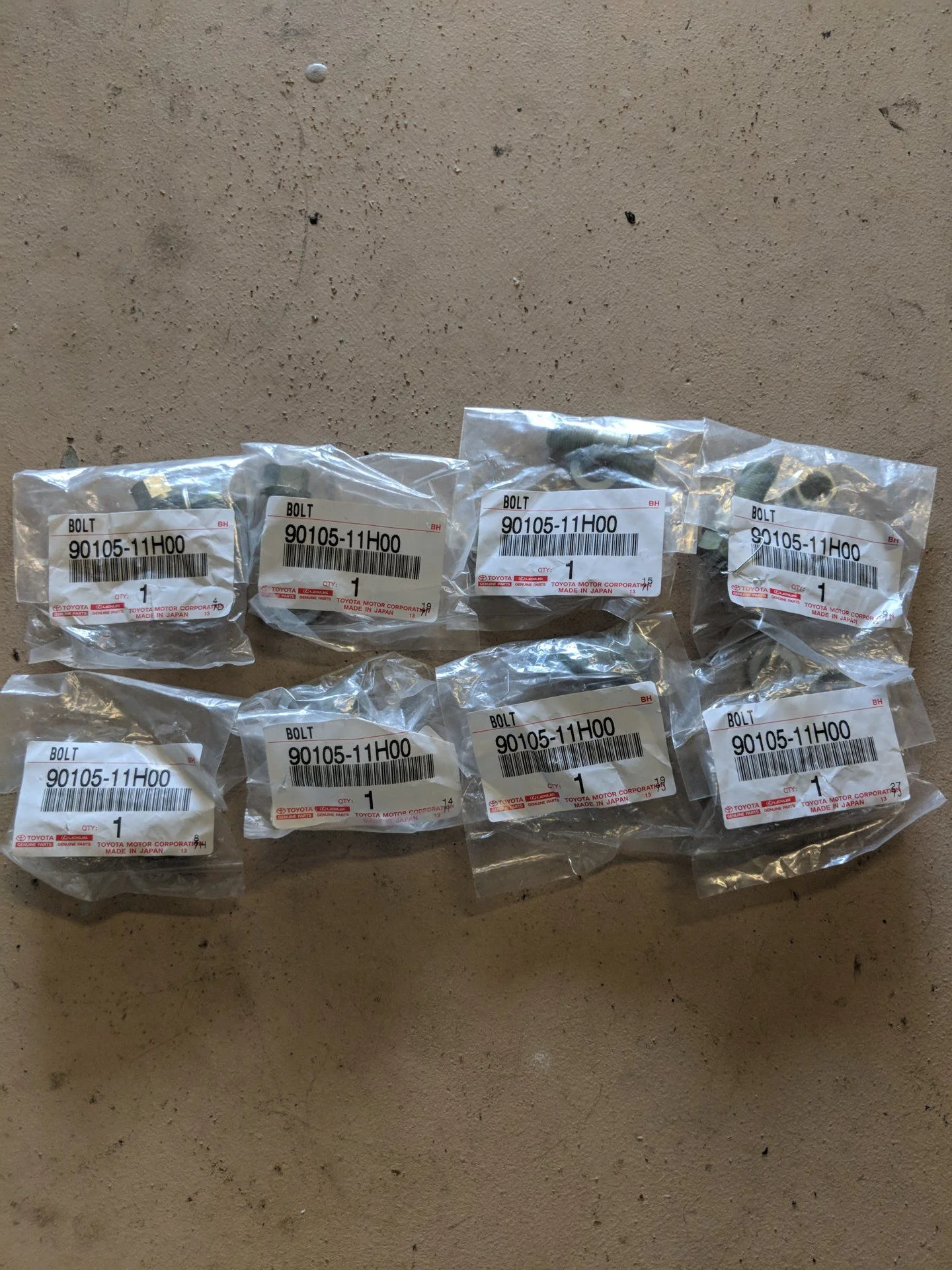

According to my records, this is the part number for the rear drive shaft bolts and nuts.
