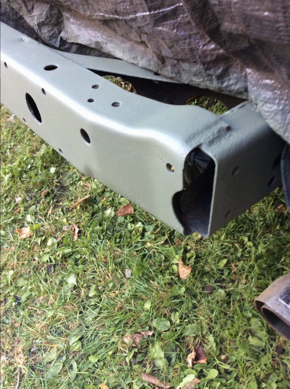

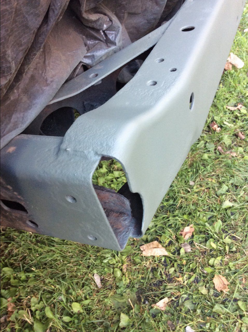

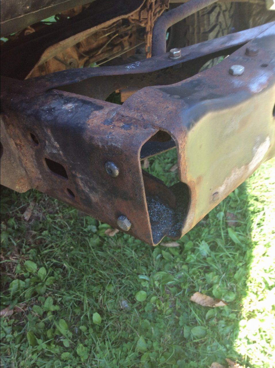

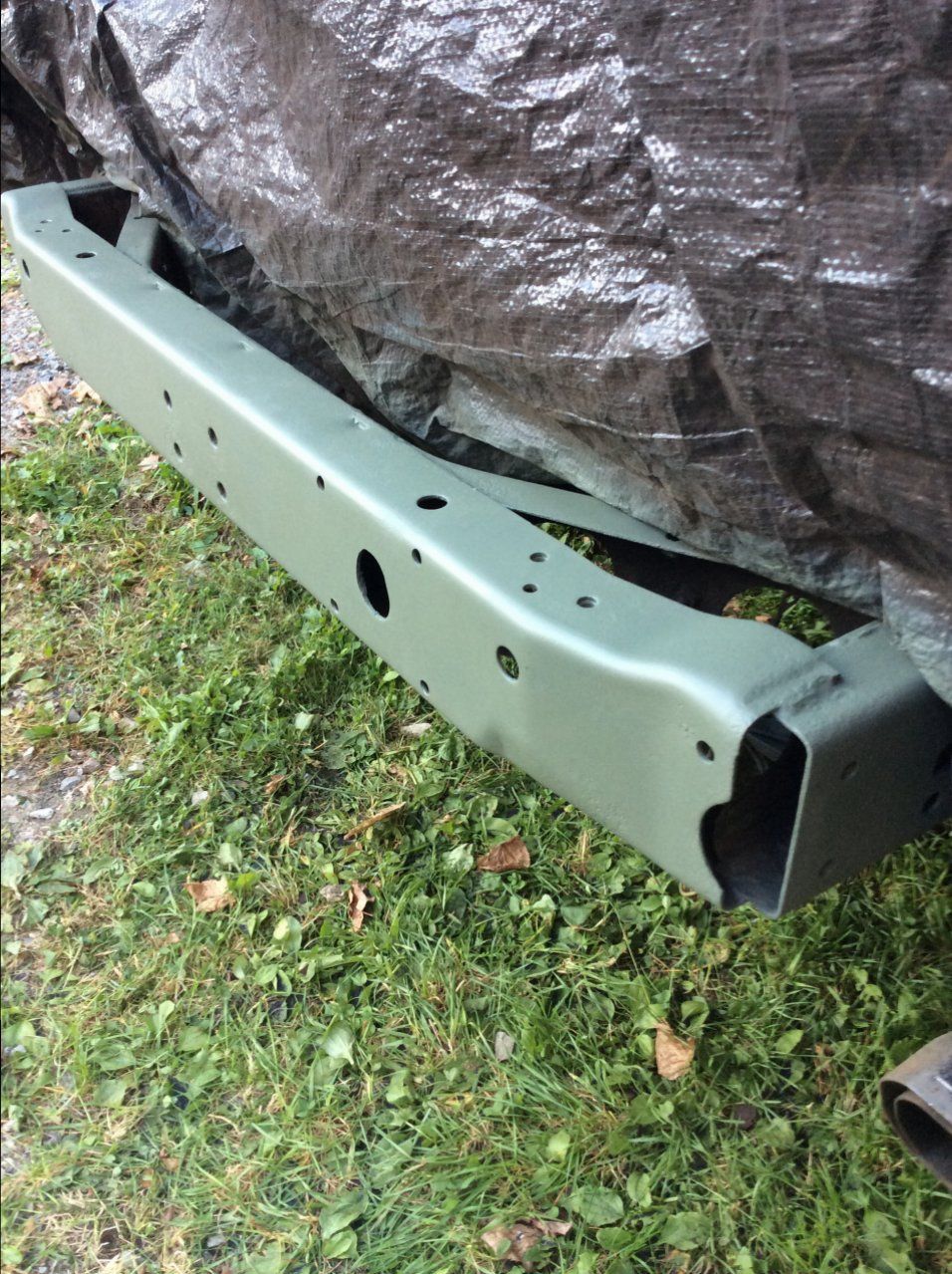

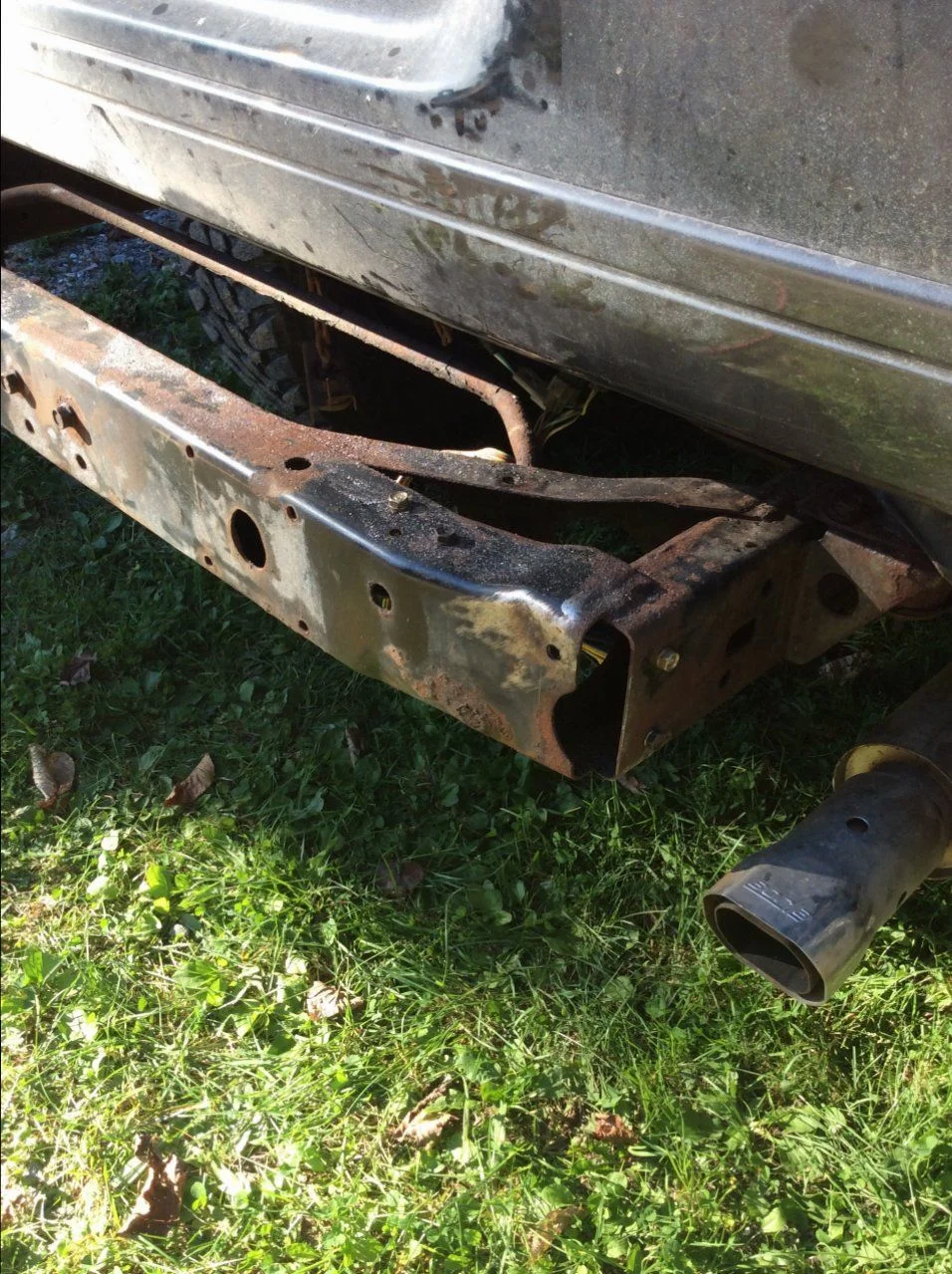

Decided that since it was unusually warm for this time of the year, it was a good time to attack some nasty rust on my rear cross member. I was supposed to do this last year, and earlier this year but some health issues got in the way. I removed the rust with a spot blaster I picked up at Princess Auto (Canada's version of Harbor Freight). Before I could attack the rust I had to drill out four broken M8 bolts that were seized. I just had time to throw a coat of some self-etching primer. I'm hoping to attack the rest next weekend.
How's the cross section in front of that? That's the one that rusts the most.
It's bad as well. Essentially everything from the rear axle back needs to be sand blasted incl the axle.
