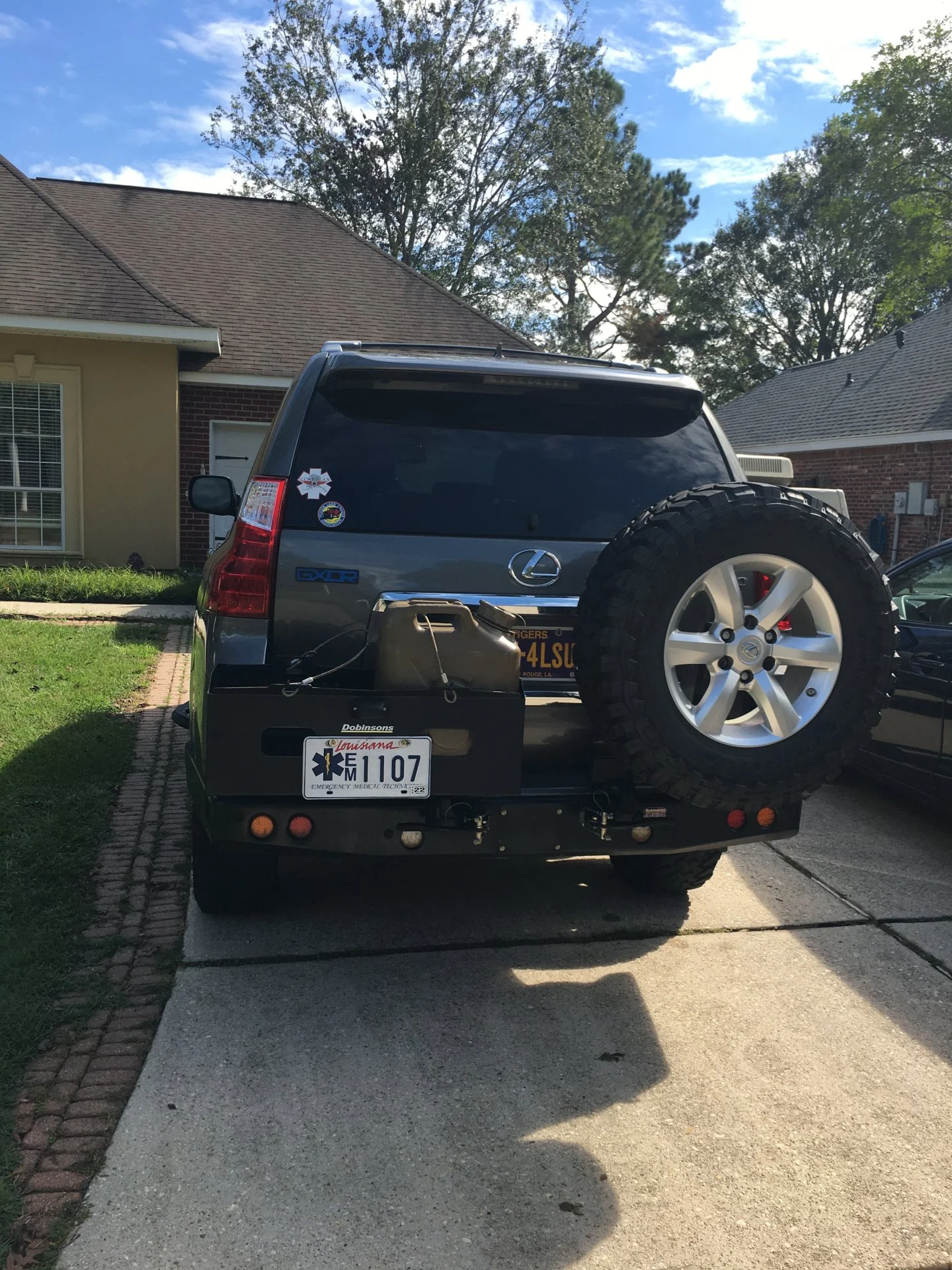

The 360* kits are just 4 cameras and the pictures are “blended” together. As for relocating the rear, Southern Style Off-road makes it easy enough to do with their kit but I will say that Toyota apparently uses different model cameras. The camera that is on my 2013 GX460 did not fit the adapter piece in their universal kit. I had to modify it and the camera is just being held in place with double sided tape for now. My problem is because my spare is offset to the passenger side my camera angle is off center. I will likely relocate it again to the side of the gas can carrier on my Dobinson’s rear double swing out but I need to come up with some kind of housing for it to safely reside in.

I know you didn't direct that to me but thanks @Washingtontaco . That gave me a visual of what I want to do. All I need to do is bend up a piece like the piece that holds the camera itself and then attach it to the side of the jerry can holder between it and the tire.
if you take the back panel off the interior of your rear door you can access your rear camera. Pull it out, plug the hole, get some, I think it was 4 strand wire. Cut the camera wire and extend it with your new wire. Route the wire out the corner of the door. Make a simple mount that the camera can be attached to and mount that to your tire carrier, perhaps the center of your spare tire rim or wherever your license plate is. That's all I did after I had my MetalTech rear bumper mounted. It's pretty simple. ;)
