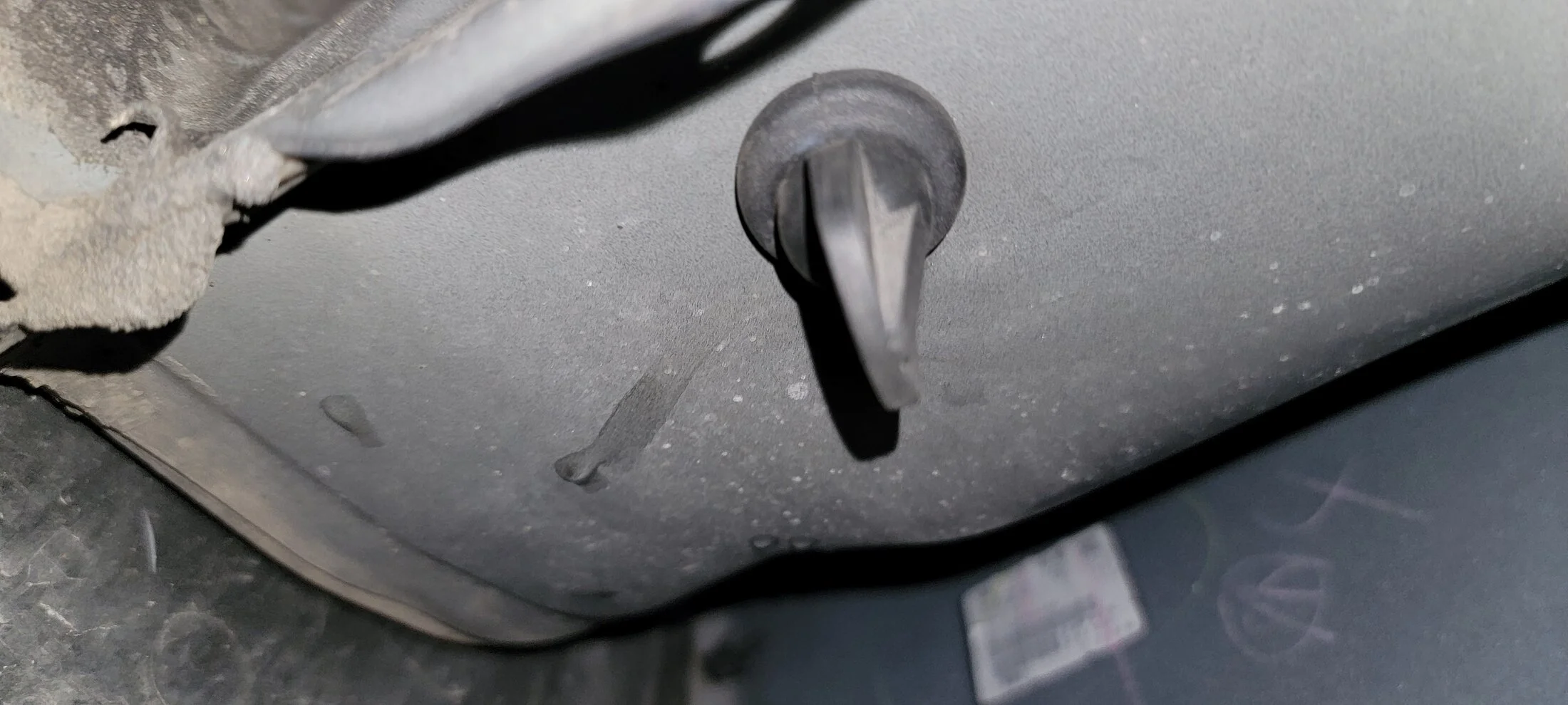

Thanks, I havnt had the balls to lay down on the hot asphalt to check myself. I have been using all 3 rows of ac due to the heat wave lately here in SW PA.
IIRC.. you would need top pull back some of the plastics in the ear area of fender to see the drain.

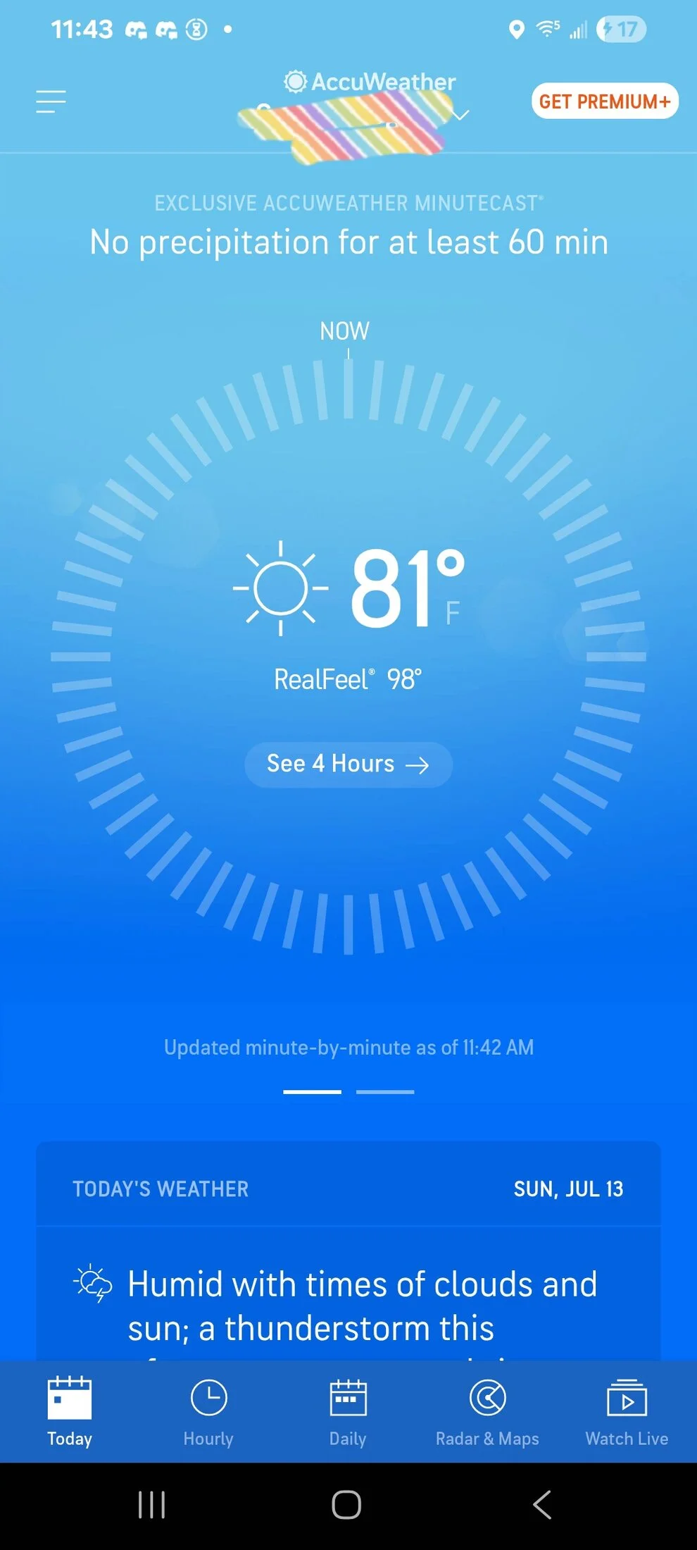

I'll be looking under it later today to see if I can see anything. Just asking because I never see any condensation dripping yet.
There should be so maybe it's clogged up?

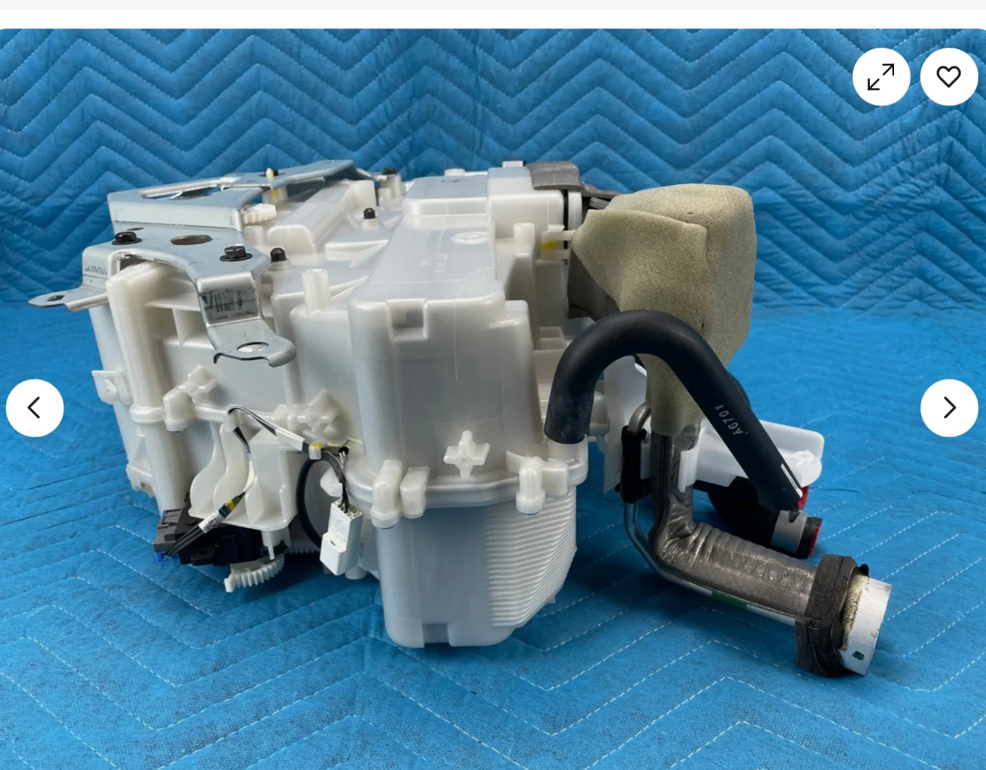

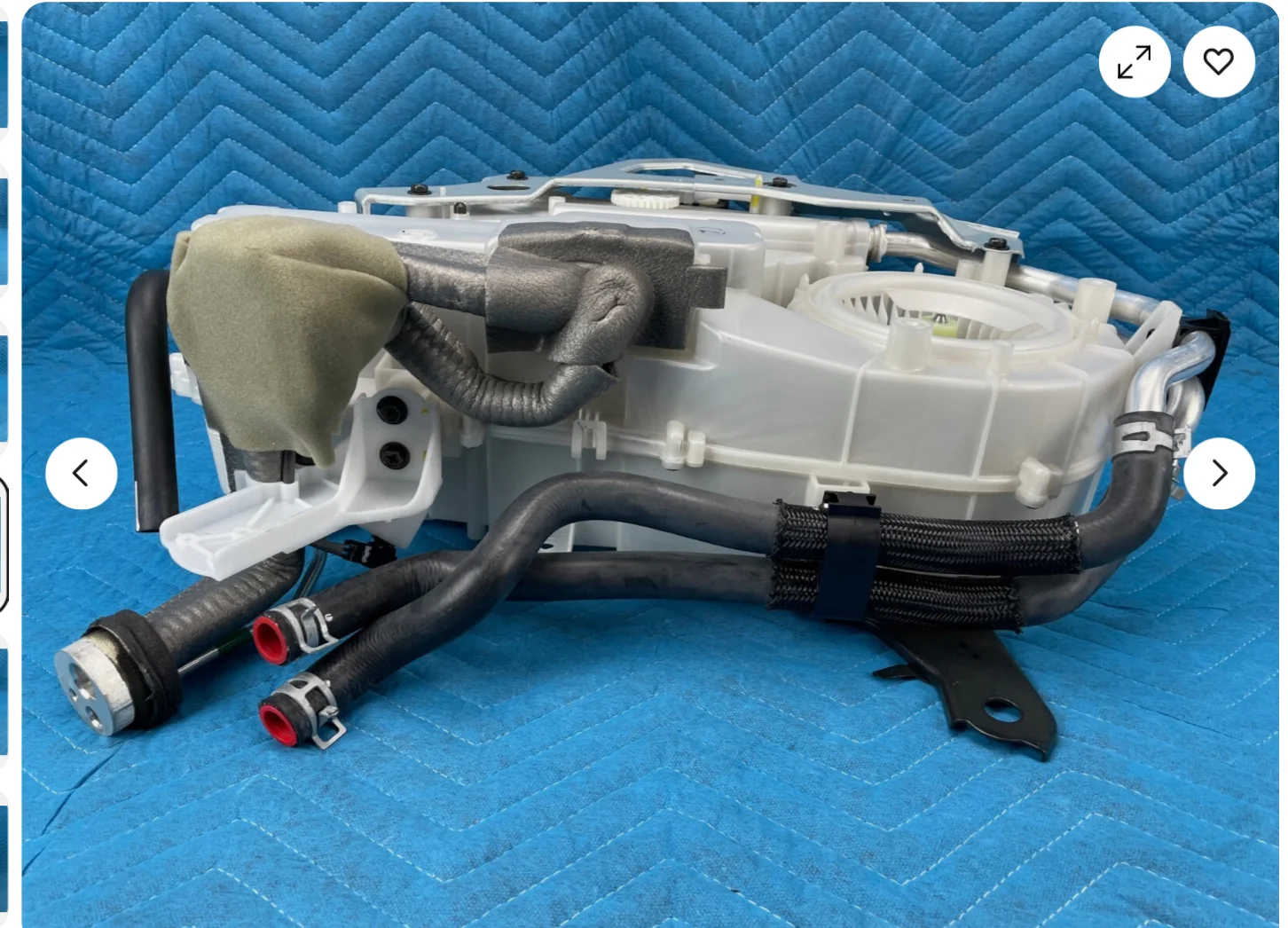

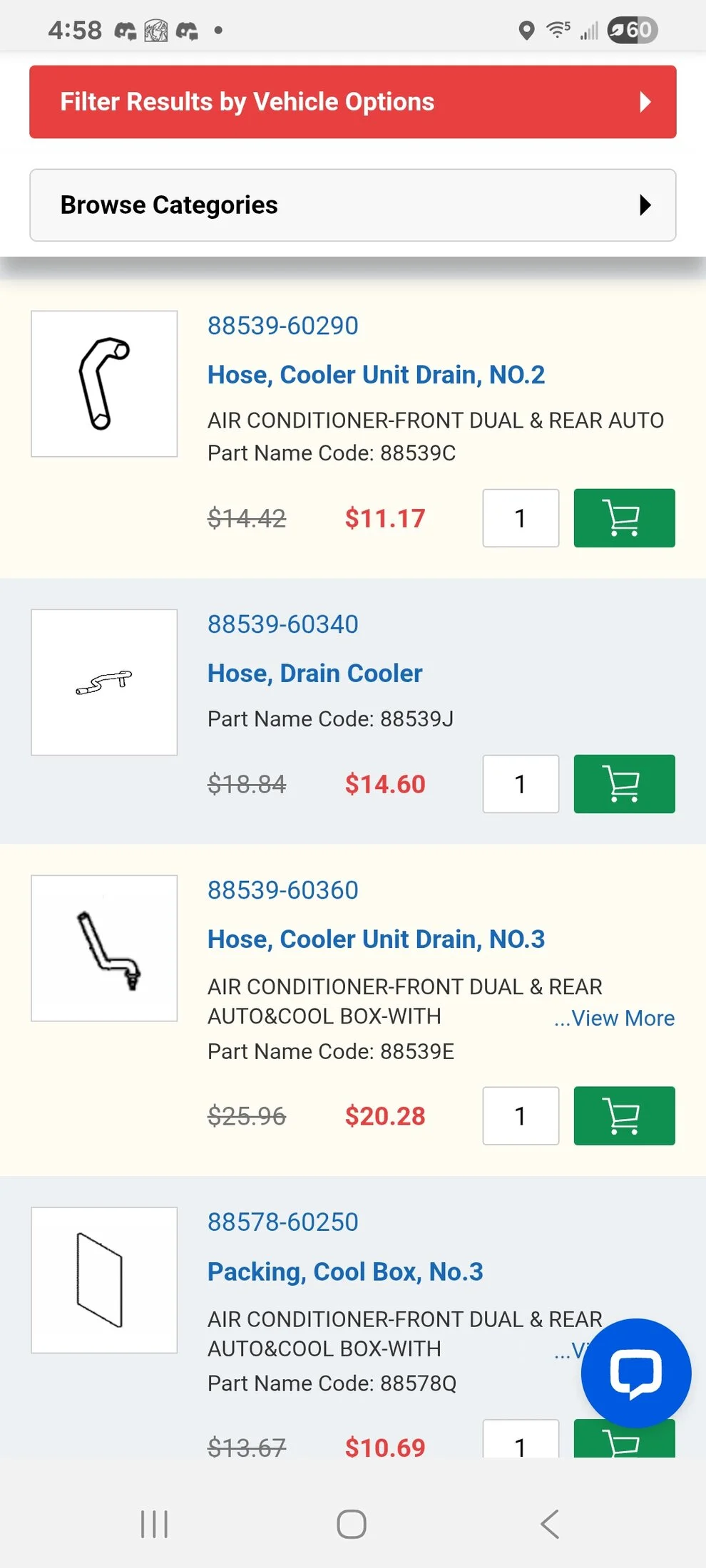

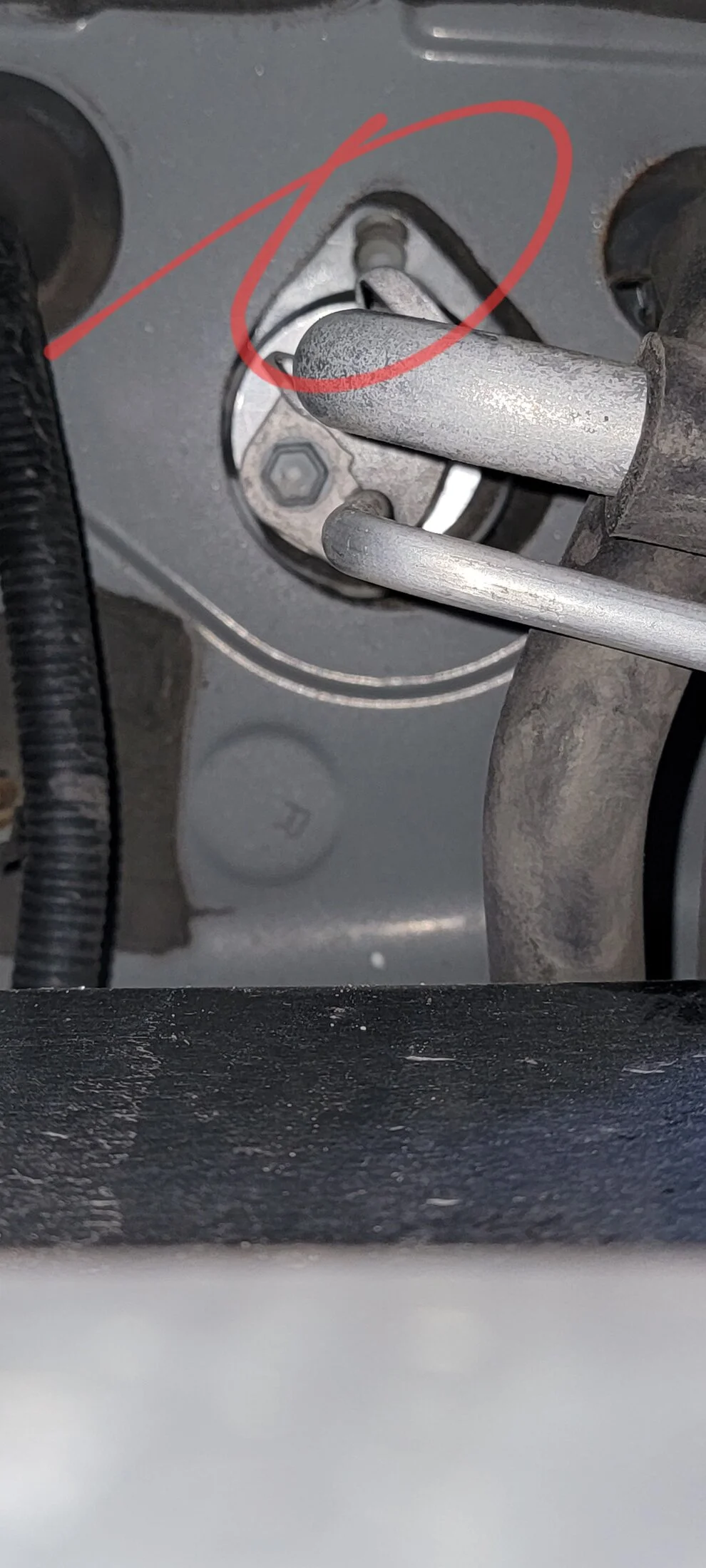

Still no idea as it's 70% humidity and no condensation out back. I did find this but I can't see there being three drain tubes? Oh maybe it's for the cooler under the armrest? I don't have that.......
At least the up-side is, if you need to replace a hose/tube, it's not three or four figure cost! It'll be about as much as a BigMac, fries and drink.

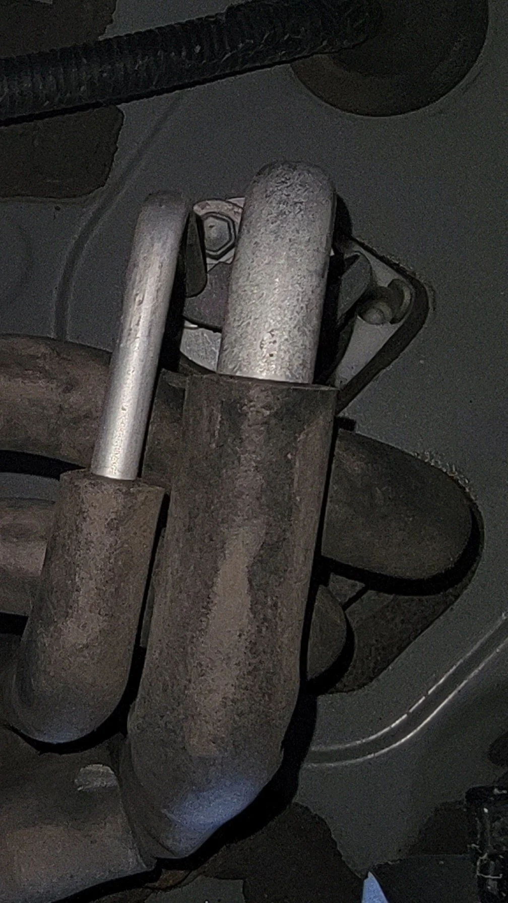

I have 3 zone climate control. See my 8th post up top and you can see the ac lines just nobody knows where the drain tube is located.
