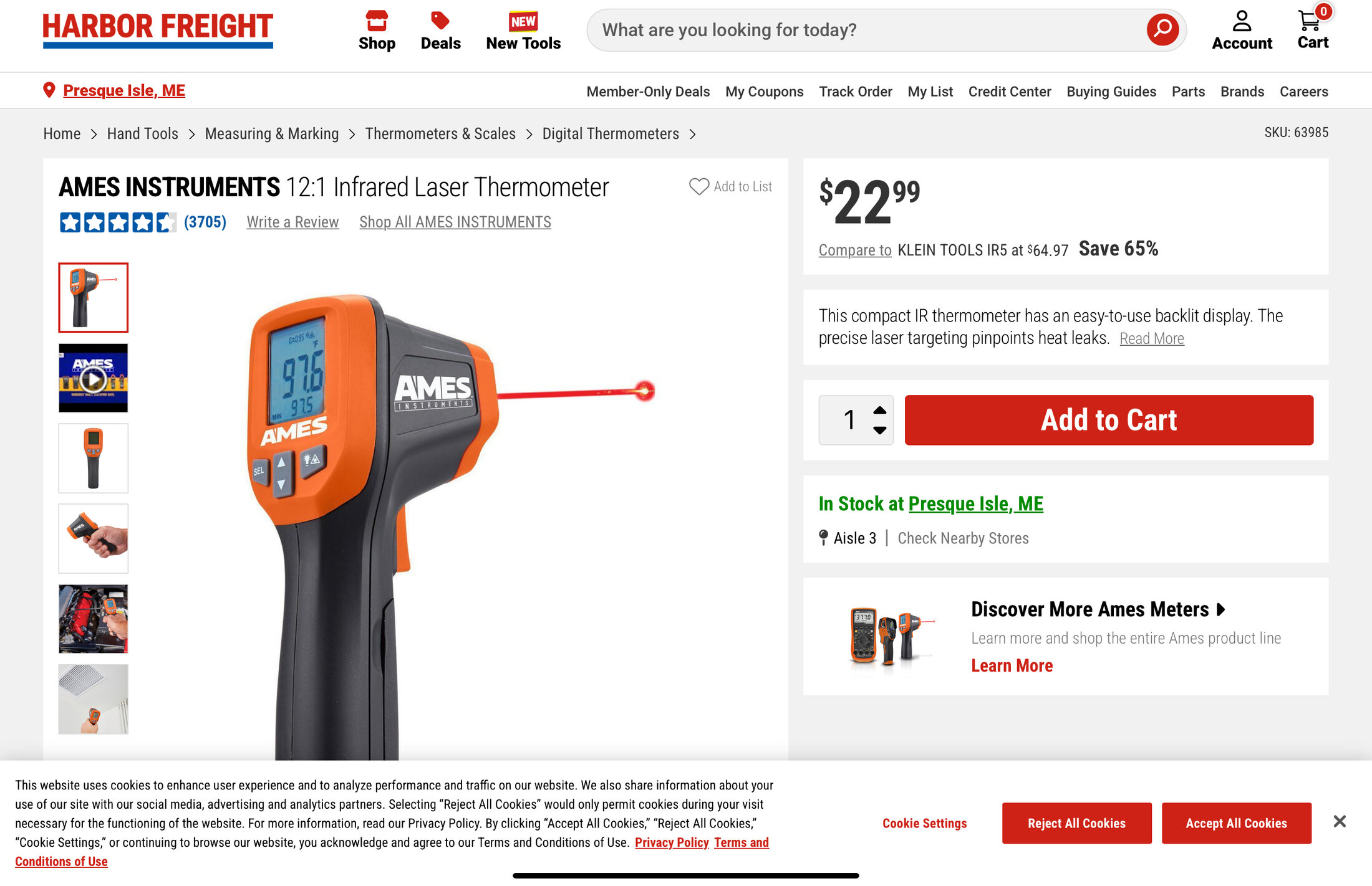

I’ll probably start doing more rotor thermal checks in the future on all my cars. I’ve typically only done them once or twice a year in the past. It may catch things earlier before I am out on the road.
  • Like
Reactions: r2m
All you need.. don’t need scientific level accuracy
If they aren't smoking then they are fine. 😂
Yea, no need for a Vaisala.
