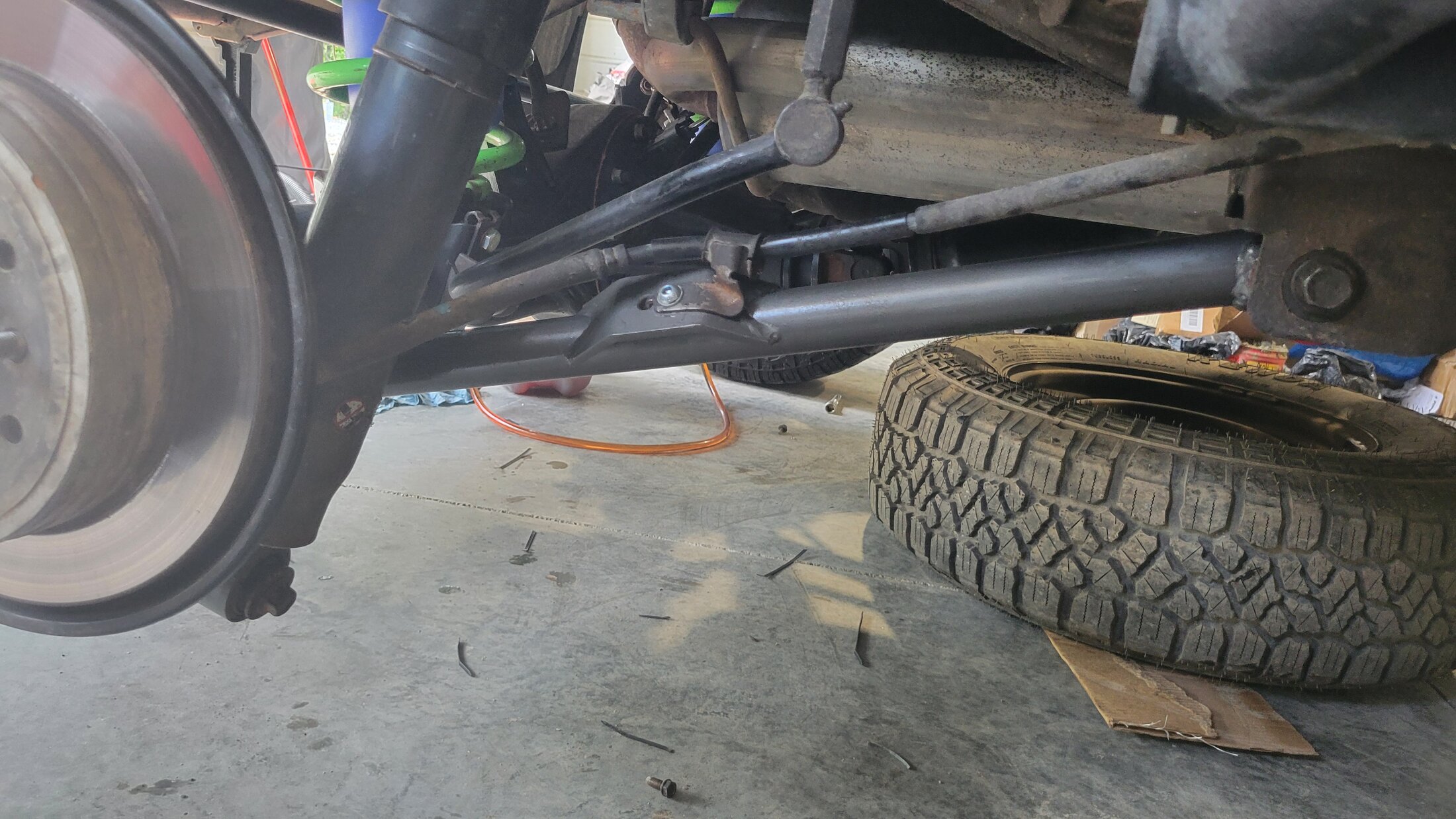

Looks like the aftermarket arms are also different between left and right for Moogs, but the same for Mevotechs. To me, they look identical! For my I used Moog replacement uppers ($28 ea. on Rock Auto) and they have been fine for 4 years and lots of wheeling. I pulled my whole rear axle out a few weeks ago and was able to inspect them to verify their condition. I'm not sure OEM uppers at $100 plus each are worth it for a tiny part like that.
FYI given the cost of new OEM lower arms I'd suggest upgraded aftermarket instead. I did crush one of the e-brake cable mounts on my lower arms while wheeling, and one of the bushings also got ripped (again, probably from wheeling/flexing out). I got some Sonoran Steel Fabrication lowers for my GX and they are much nicer and beefier than the OEM arms, and they have offset bushings that will allow for more flex. They are a relatively local shop for you.
