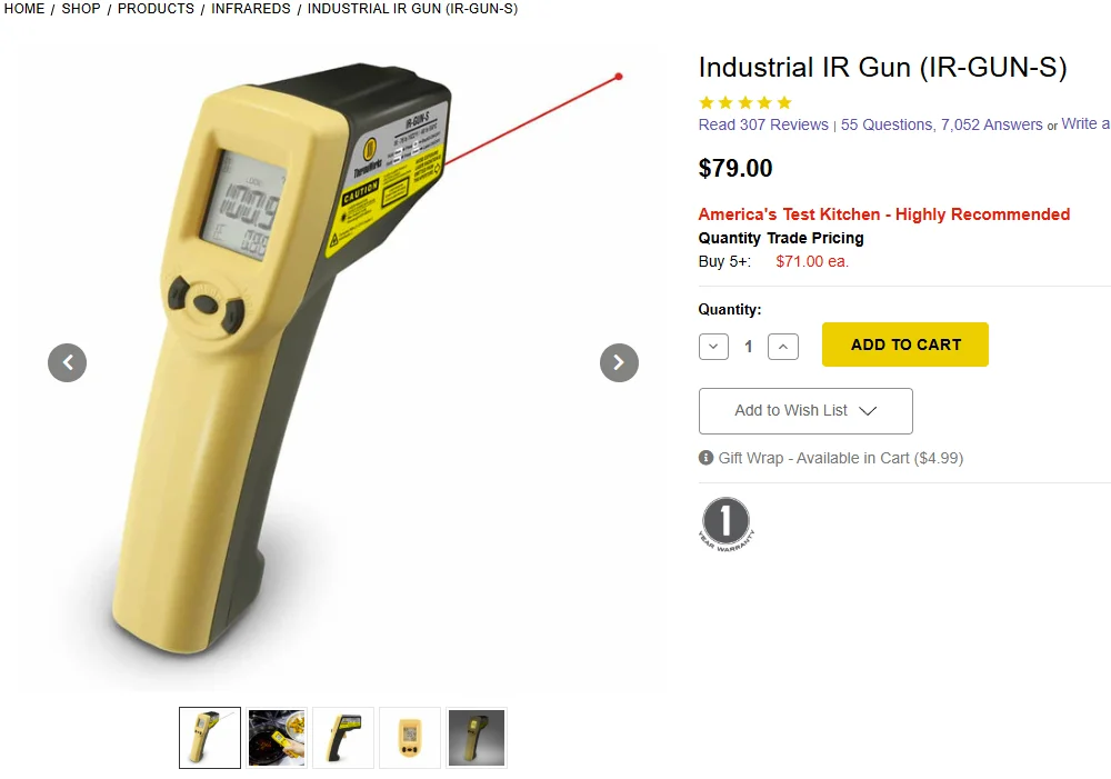

All you need.. don’t need scientific level accuracy
Anytime I tow with the trailer I use my IR gun to check trailer bearings when I stop for gas or at a rest area. Every time.
I also use it around the house for checking leaks around doors and windows. But main reason I got it was for cooking I grill and smoke a lot and I mean a lot. All of my cooking temperature measuring devices are ThermoWorks not to be confused with the Amazon Chinese knockoffs.
They have sales often and I wait until they go on sale for half price which happens twice a year or so. That is when I picked up my IR gun for around $40

Great now I guess I should start checking the wheels on the GX as well as the trailer bearings. Not that it is exactly difficult with an IR gun LOL.
.....you can just touch them with your hands too....just sayin
i do it on the regular after driving for a while
checking is good
checking is good
20 years working in the steam and engineering plants of ships I will say to use the back of your hand. And wash them after especially with salt and slush LOL
