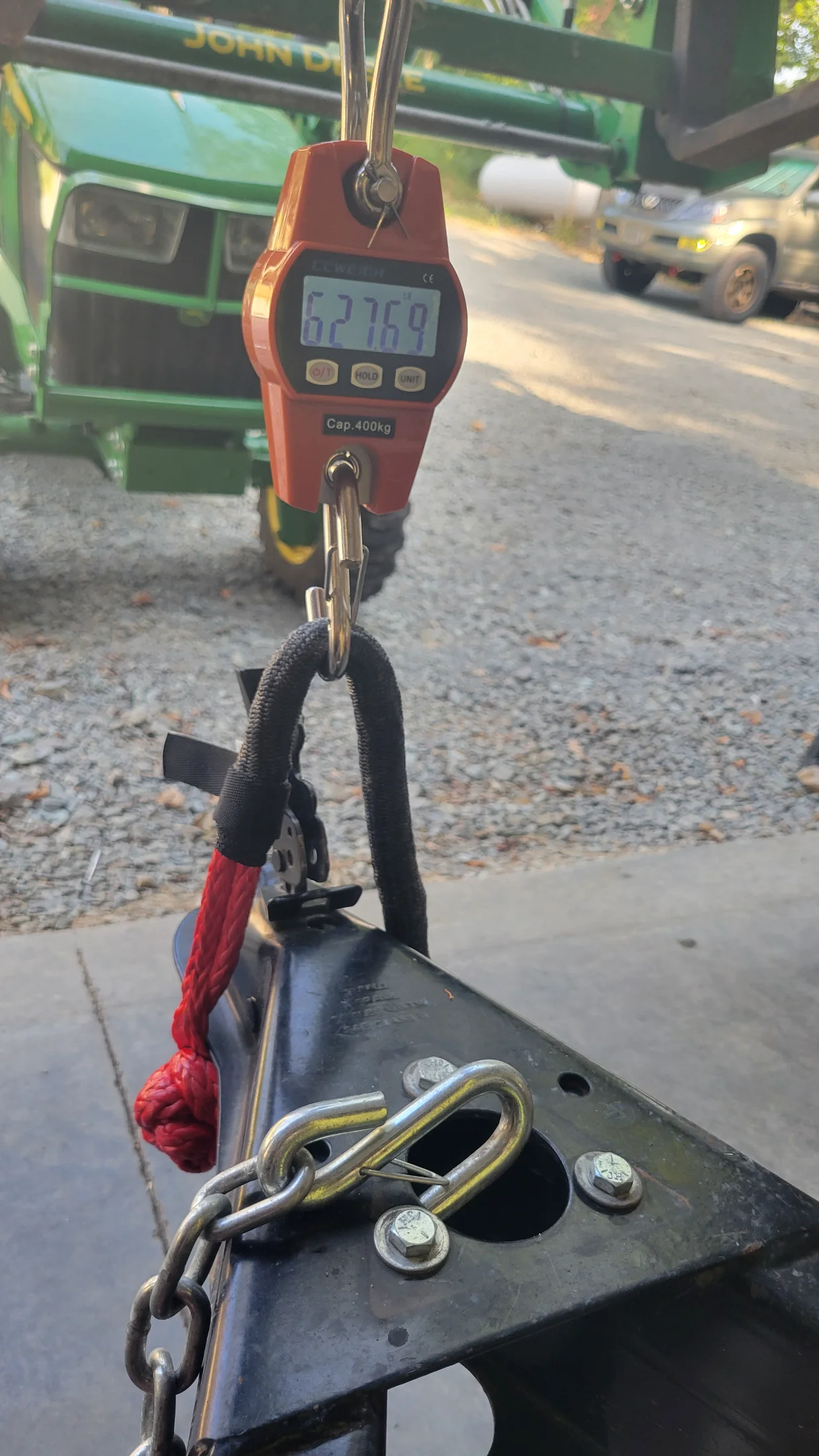

I finally actually checked my tongue weight today. It was way higher than I thought it was, and too high for a GX without a WDH. This shouldn't have trashed my springs (the bags should have been able to take up all of the slack). But, I am still amazed and how well the rig itself handled this weight - including on curvy mountain roads. Shows that Toyota has sandbagged the tow ratings a bit.
I'd still suggest checking yours if your back end feels a bit saggy. If you don't have a tractor sitting around, you should be able to check it at a truck stop scale, by going through with the trailer hooked and unlooked and recording the different weights at each axle.
