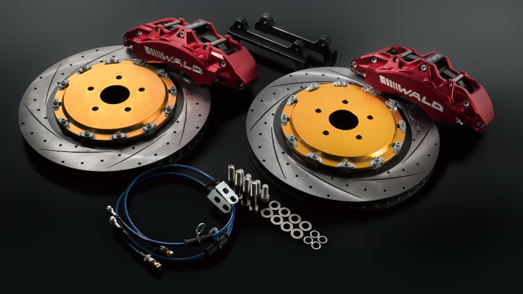

Pffffttt... Go 8-pot calipers, or go home. Yours for the low price of $7100 F&R.
WALD BRAKE SYSTEM : HIGH PERFORMANCE SERIES
