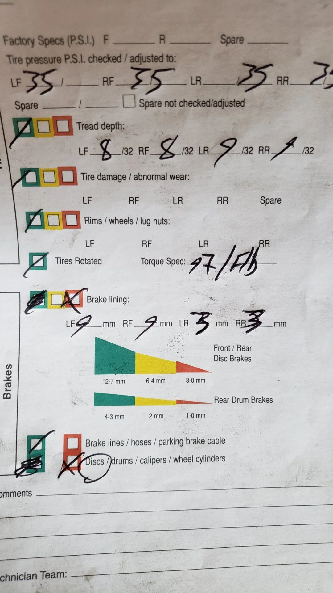

So bought a used 2016 200 series about six weeks ago. I have put 6k miles on it with a cross country drive from Maine to SoCal. Took it in for service at the end of the trip and the Cali dealer said I need new rear rotors and pads. It has 50k miles on it now, does it seem normal to need new brake rotors at 50k? Is their an aftermarket upgrade out there I can do that will be better than a factory brake job which will cost $600.

I hate to be too cynical, but did you confirm it needed rear brakes by looking at the pads yourself? I suspect brakes are one of the top up sells of service depts. And rotors too at only 50K? Maybe ask for measurements?
I did not check the pads or rotors myself. The dealership gave me an inspection sheet after the 50k service. I will try to get a look this weekend. They said I should be able to get by til the next service...

Is it me or did the tech want to write 5mm but then opted to write 3 over the 5, aka necessitating replacement?
