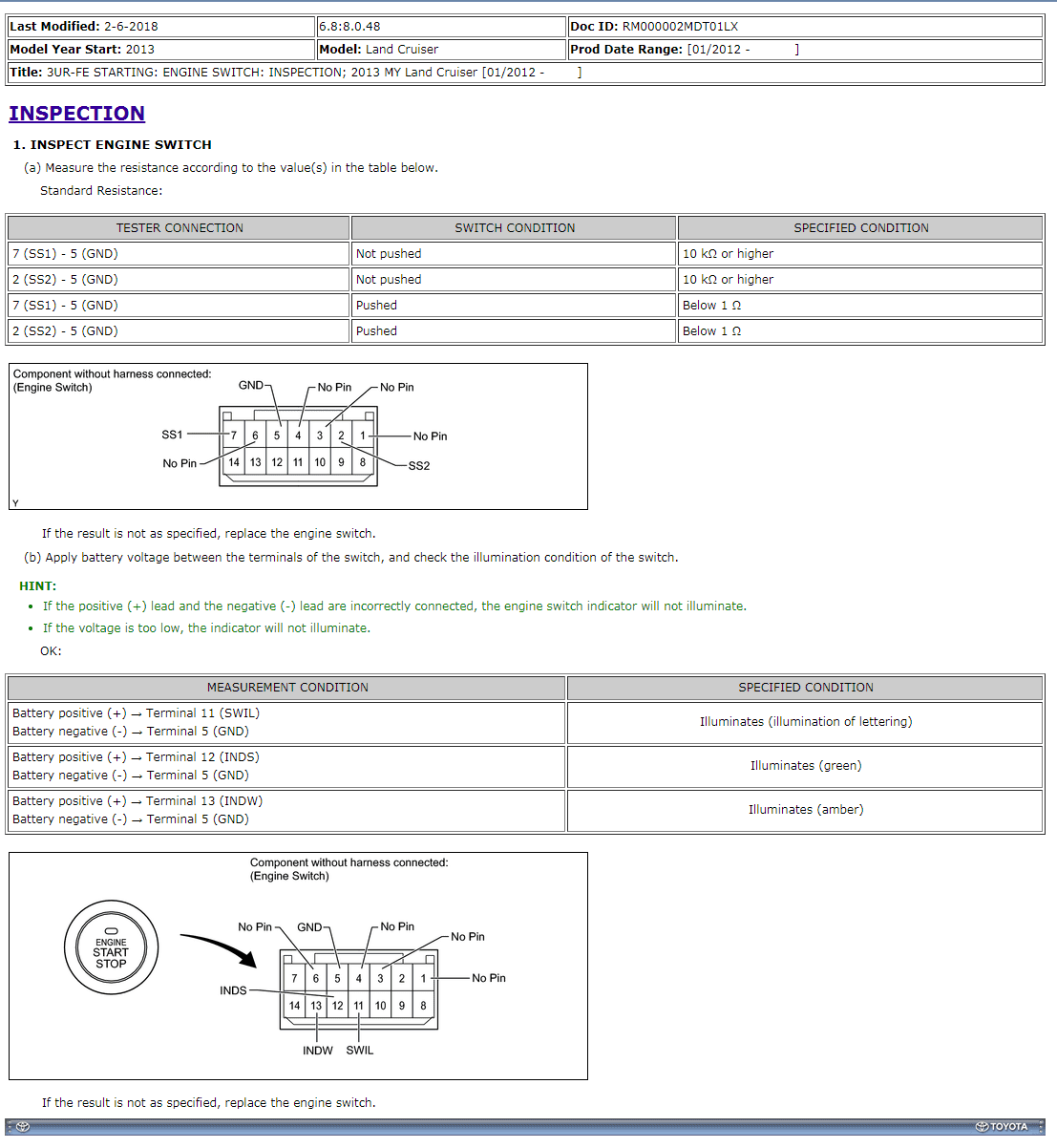

That's interesting theory. Can you please tell me where is this relay? And if there is a way to test it somehow. Should I just replace it, by chance do you know how much that would be? Thanks for the help!
Not sure your model year @art5519 but here's the inspection info on the relay for 2013:
Engine switch inspection info as well:
If you want to walk through the wiring diagram and see if you can figure out how the remote start differs from the regular start, knock yourself out with the attached.
