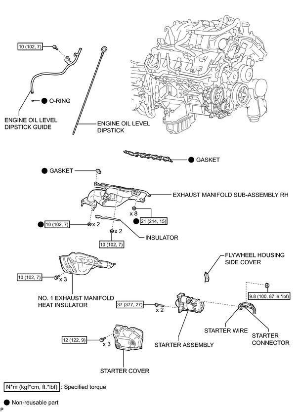

I have the service manual in Word for the replacement, but not familiar with how to post. Happy to do it is someone will help, or just PM me and I will send the file.
Here is the parts diagram. The start is directly underneath the exhaust manifold. It takes time, but it is NOT that bad of a job.
