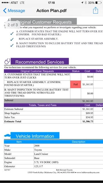

Update:
The realy $hitty part of this is that last fall I contemplated having the starter changed when I had to do the water pump, that would have saved $1,000.

How many miles? Is the starter that labor intensive to justify close to 1200?
132k miles. $580 for starter. Yes, getting to the damn thing looked to best be left to a mechanic from my end.
