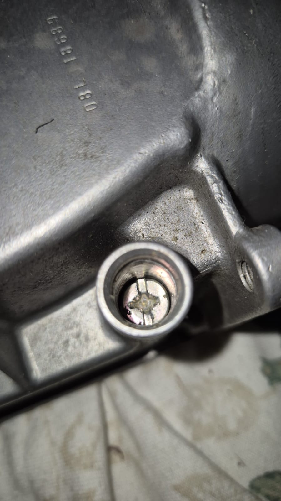

I didn’t go into great detail about it with the mechanic, but essentially, you replace the metal stud located in the hole on the air flow meter with a screw, which I believe allows you to adjust the spring tension on the cog—this, in turn, affects the fuel trims. I’ve seen people adjust this on similar Toyota air flow meters on YouTube as well, usually by removing the black cap on the face and jumping the cog.
However, the method my mechanic used was simply to replace the metal stud with a screw. I rang my contact at the local Toyota dealership, and he confirmed that they do this as well—but not on all vehicles. Apparently, the workshop manager is the only person there who knows about it. He even tuned the parts dealer’s air flow meter using the exact same method.
This kind of adjustment should only be done when using a wideband sensor to monitor the air–fuel ratios after making changes.
I'm now running 10 degrees of timing with the correct fuel to ensure it's safe. LPG can take much higher timing, but I needed to strike the balance for both fuels otherwise it would ping on petrol.
Here are some pictures of what I’m talking about…
