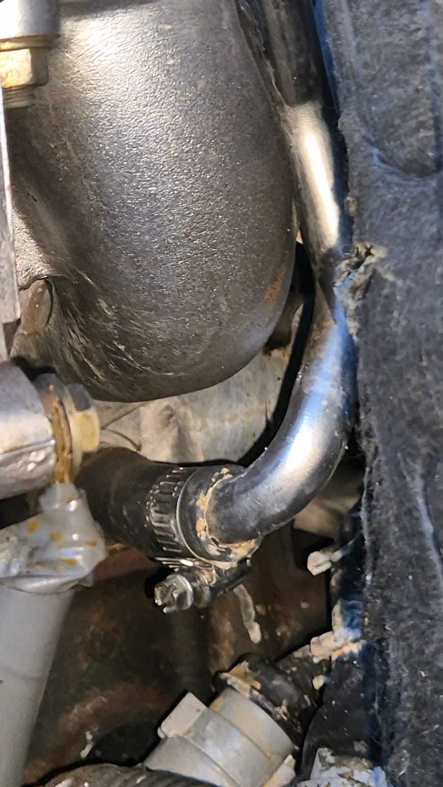

Found another suss looking heater hose down behind the motor too. It's right below the other leaking one, but the stains do look like this has had coolant come out at some stage, and the clamp isn't the original. It's the same part number as the previous hose I replaced above it.
thats the dreaded PHH, replace that worm drive clamp with a constant torque clamp

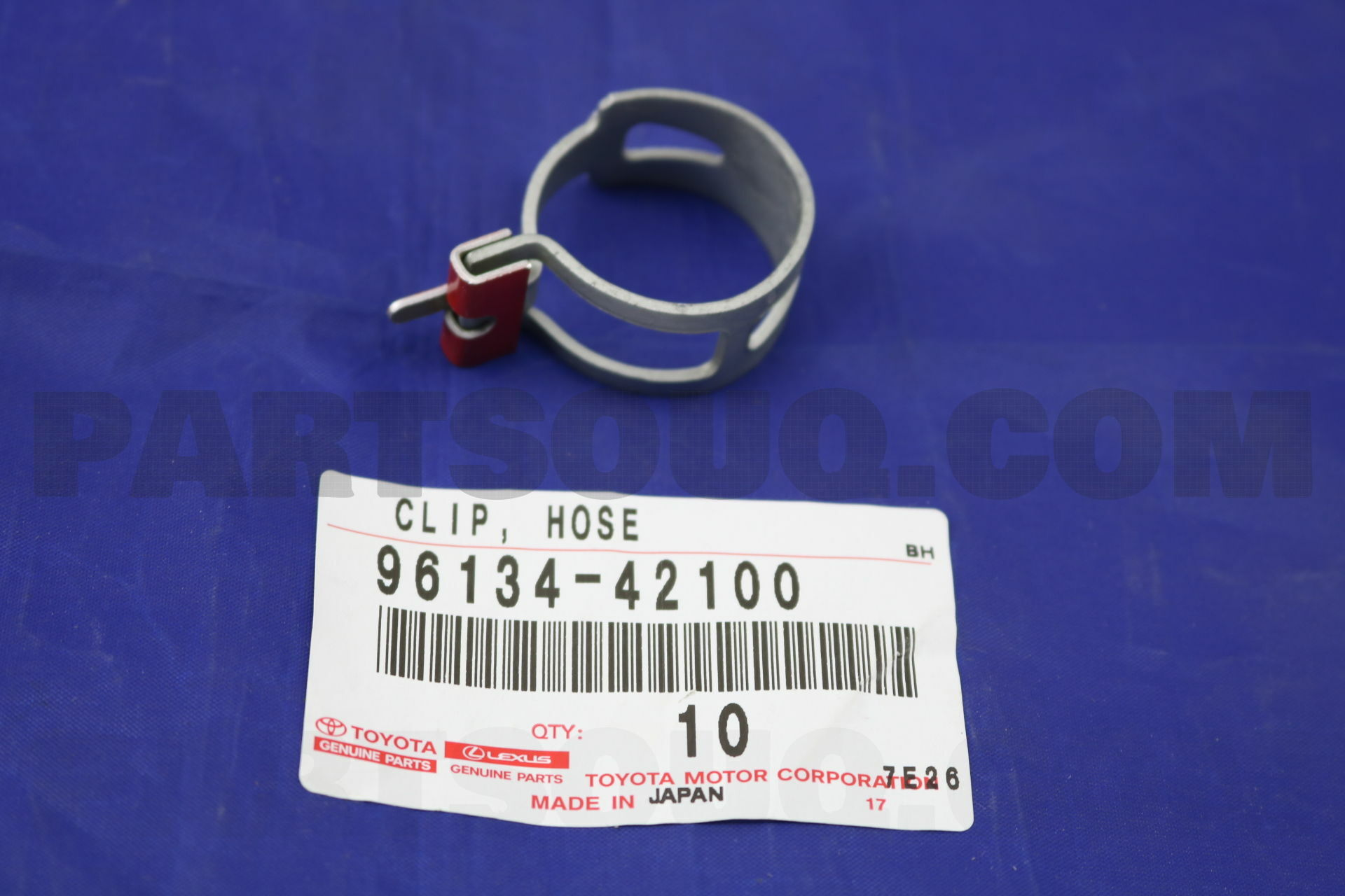

do you have the part number that fits that heater hose?
The clamp it's supposed to come with is:
Maybe this fits though?
The bottom one will work. Much easier than the twisty one.
Buy new clamps, leave the red tab on then until you have the hose in place.
Position the clamp where you want it, then pull the red tab off.
They are a huge benefit whet changing this hose
great! If that's the correct size clamp for my application, then I can get a 5 pack of genuine ones off ebay.. my local Toyota Parts place said they need to get them ex Japan.
thanks @mudgudgeon and @robnicko for confirming the clamps!
