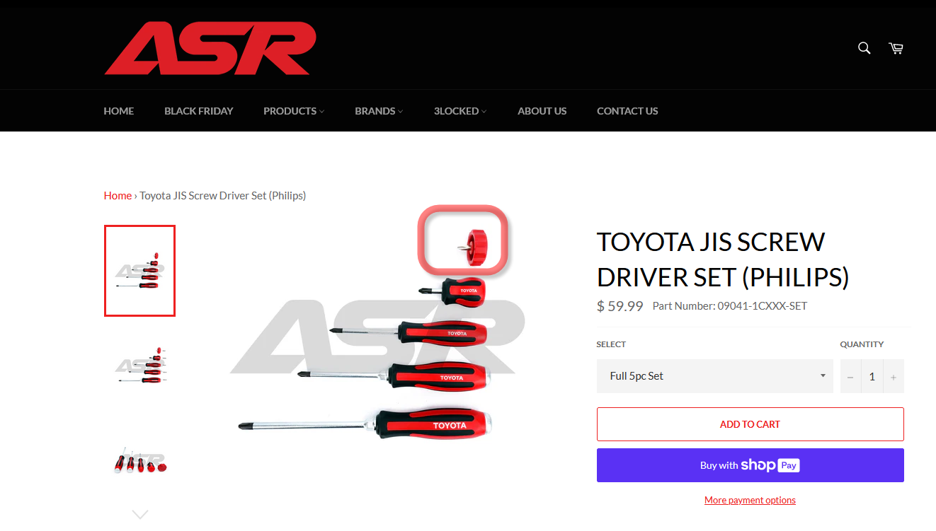

That's exactly why I said to remove the throttle body. There is a Toyota (actually it's a Toyota branded Vessel) screwdriver that is designed just for this, and the cowl panel removal:
I don't leave home without it.
FWIW, the screw is stuck in there after years of engine gunk has landed on it. Even with the throttle body off, it's a PITA to remove...without rounding the head.
wow, nice set! So that would allow it to be removed without pulling the throttle body? if not, I will get a throttle body gasket before I go doing that.
It would, if the screw had been recently (like within the last several years) removed. Otherwise, it's likely to be so stuck to the throttle body (mine was) that you'll need a vise to hold the throttle body and you'll have to lean all your weight on the screwdriver to keep it seated, to prevent striping the head. That's assuming you use a JIS screwdriver. If you use a Phillips, the head will strip for sure.
The stickiness is due to electrolytic action; the throttle body is aluminum and the screw is steel.
That's a really little screw (5-mm, if memory serves).
I bought a gasket, 22271-66010, and two new screws, 90079-11022.
This, but swap the pretty Toyota screwdriver for this
Use a #2 JIS or #2 pozidrive bit, set it on 1 or 2, and lean on it.
Then pop off a few small bursts, like pew, pew, pew, NOT Brrrrrrrrrttttt

I got the top one out by giving the JIS impacta screw driver a few taps on the bottom first. Then with a bit of pressure and force I cracked it. The bottom one appears to be a different screw to the top one..
