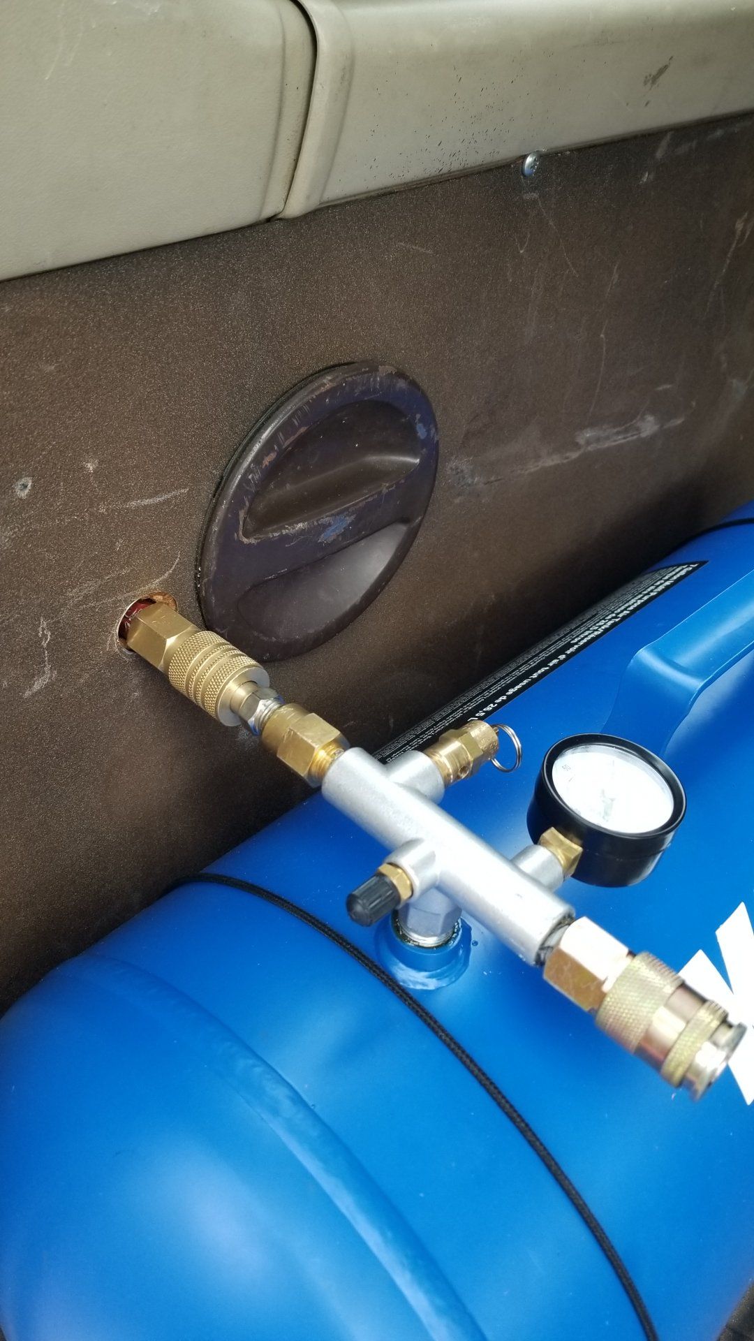

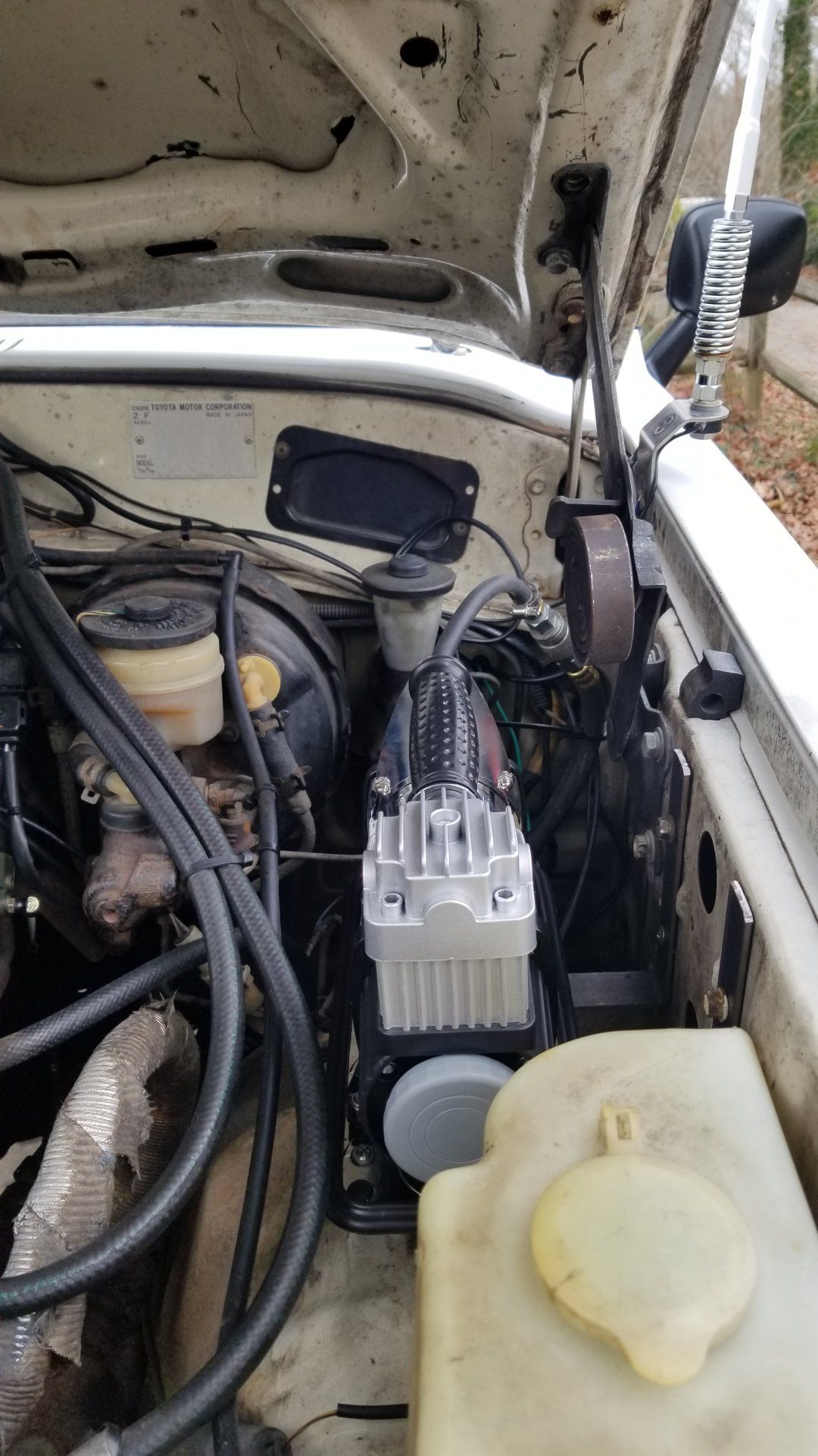

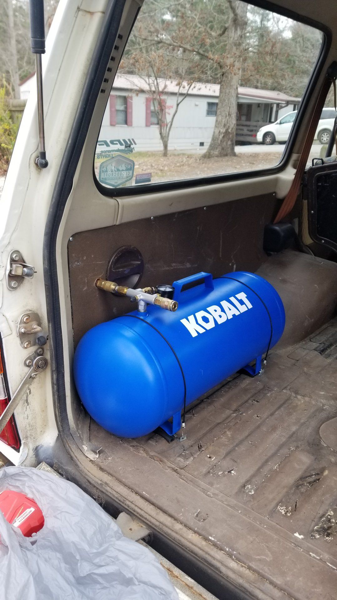

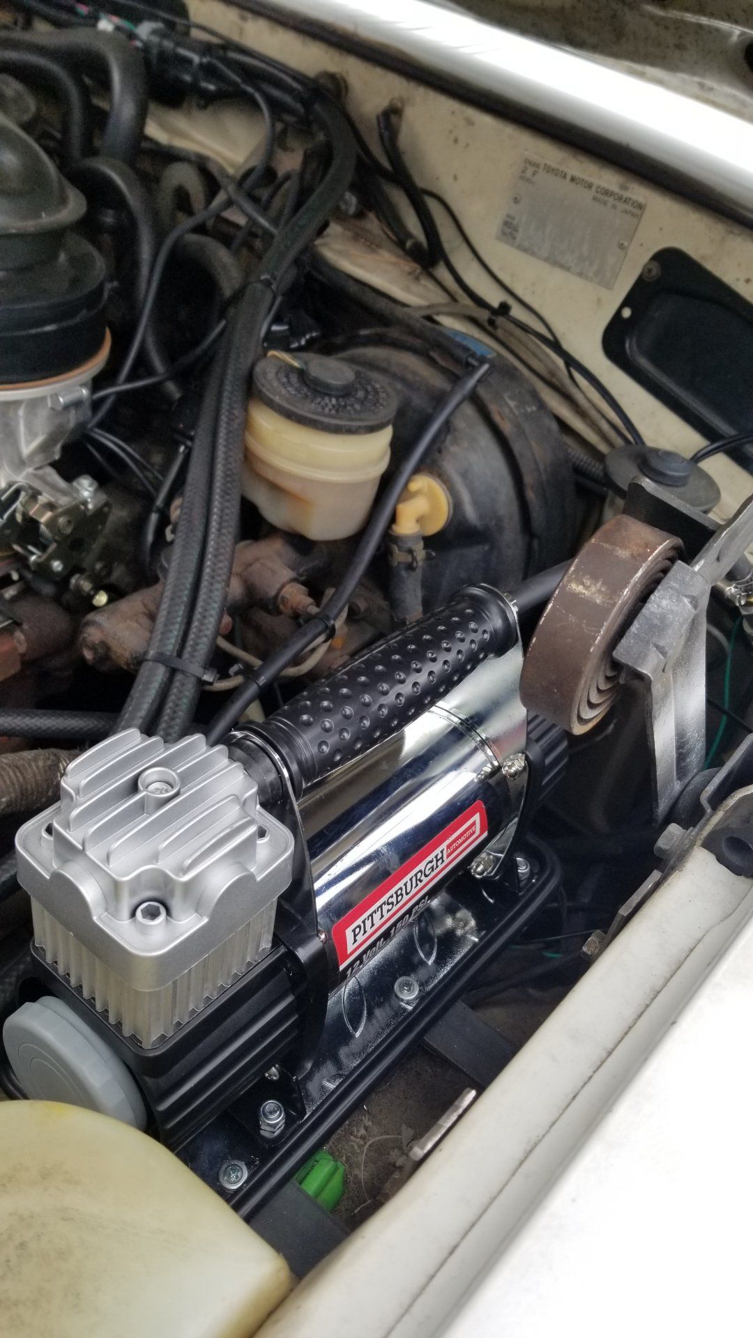

I put together my own setup which utilizes a Harbor Freight compressor (their bigger one) and a 7 gallon tank from Lowes which included the manifold and gauge. I hardwired in the compressor and have a switch in the cab to turn it on. I also added a pressure switch to shut it down at 120 psi (not shown in pic) I installed air hose from the compressor to the tank in the back of the truck. Seems to work well and I can run air tools if I need.
I had my air compressor mounted in the same place and it failed due to heat. I would suggest putting up a heat barrier or moving it. Just like the exhaust manifold cooks all the rubber and wires on that side of the engine, it will cook that compressor over time.
