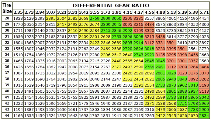

The gear ratio tables will tell you 4:88.
Someone with practical experience might have a better idea. Perhaps 4:56? IDK. That auto tranny needs all the help it can get, so it seems prudent to regear if you must have a big lift and 35” tires.

This chart is based on 65 mph with no overdrive.
Yellow zone will give better mpg at highway speeds but lower torque and slower acceleration.
Ideally- aim for the green zone.
I ran 4.88's with 33's (BFG's which only actually measure 31.5" tall...) with my 3FE and at no time did I feel that I was "overgeared." It was totally fine at 70-75 on the highway and much much better in town and off road. I wouldn't go any taller than 4.88 with 35's, and would strongly consider 5.13, 5.38 etc. I did 3:1 t case gears too (strongly recommend if using off road).

It's looking like 4:88 gears. I was under the impression there was an underdrive that would be the equivalent of 4:88 ring and pinion. I'll get a quick pic on here so you guys can see what I have going on too.
