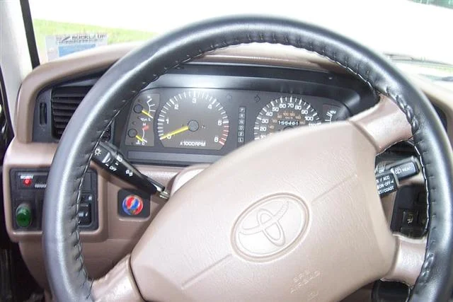

wheel skins!
I'm a third vote for wheelskins. Got mine about a month ago, just havn't convinced the wife to stich it on yet. Sewing ain't my thing.

Installed a grey WheelSkin on the 97 today. Took about 1.5 hours and was frustrating at times. I got the size AXX Grey and is the precise color of the interior - not just close. I noted that some vendors were selling a different size as correct for all 80s, but I selected mine by measuring the wheel and using the WS website.
It took some strength and patience to get it on the wheel initially, which is the tight fit I was looking for. Stretch, hold for a few minutes. Stretch and hold again and finally it can be worked over the rim all the way around. If you get one, be aggressive in pulling on the thread to pull the lips together. It's plenty strong and I started loose and then restarted aggressively.
The instructions warn you not to miss a hole on the back when you go around a spoke. I did, and simply doubled up on another hole later to get back in synch. No way I was pulling it apart at that point - heh. My wife loved it and it looks like a new wheel. Made the rim slightly thicker which I liked.
Since I have a 93 also, I noted before doing this that the 93 steering wheel rim is notably thinner from the factory. This was the reason I carefully measured mine rather than use the recommended size from various internet vendors.

It's not designed for that. Look in the picture above and you'll see that the WS does not perfectly mimic the lines around the spokes. They're designed to go over the existing rim.
DougM
I see that you like the wheelskins Doug. I'd ask for a picture, but is it safe for me to assume that the end result is pretty much like the pic that concretejungle posted?
