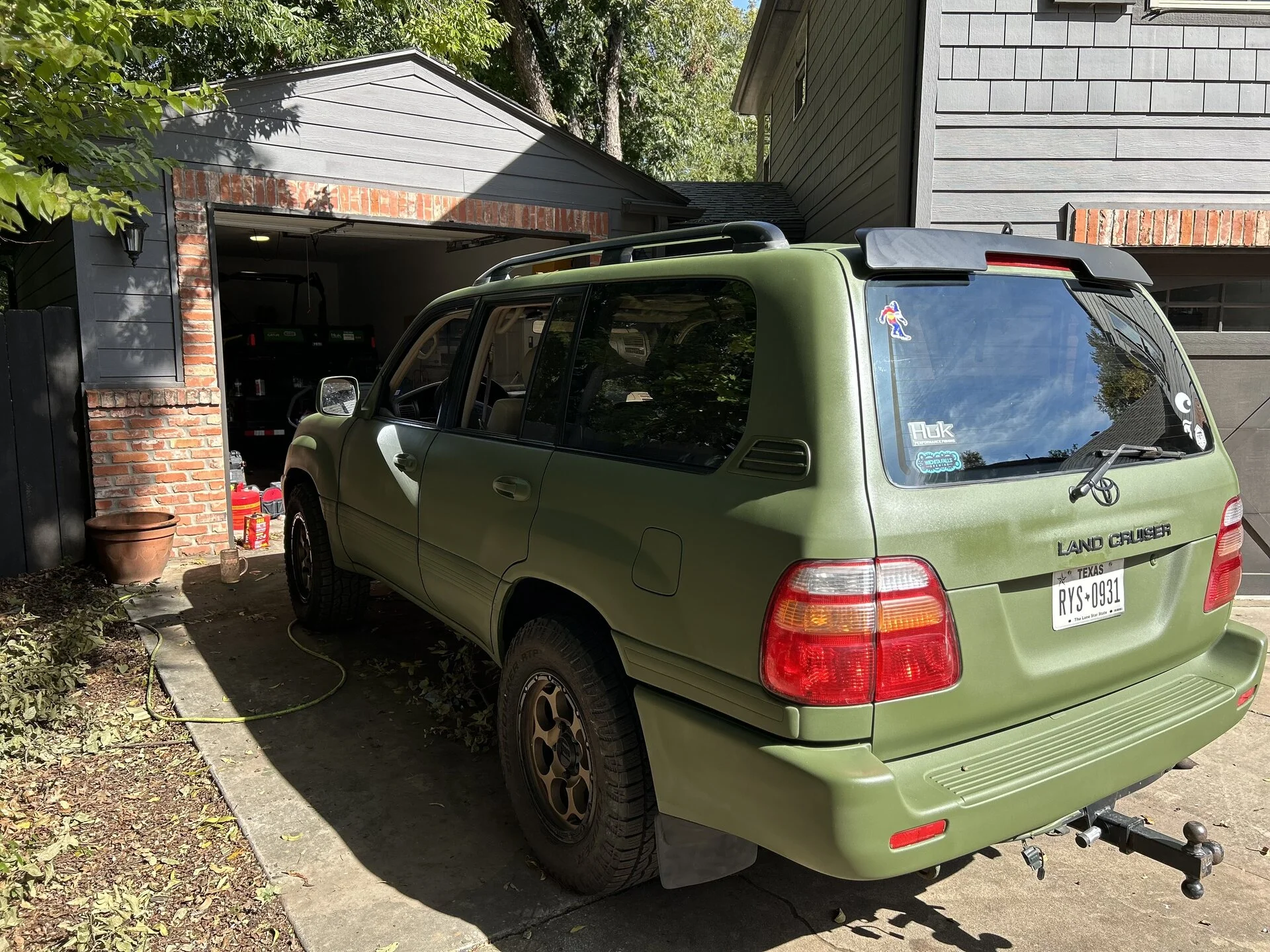

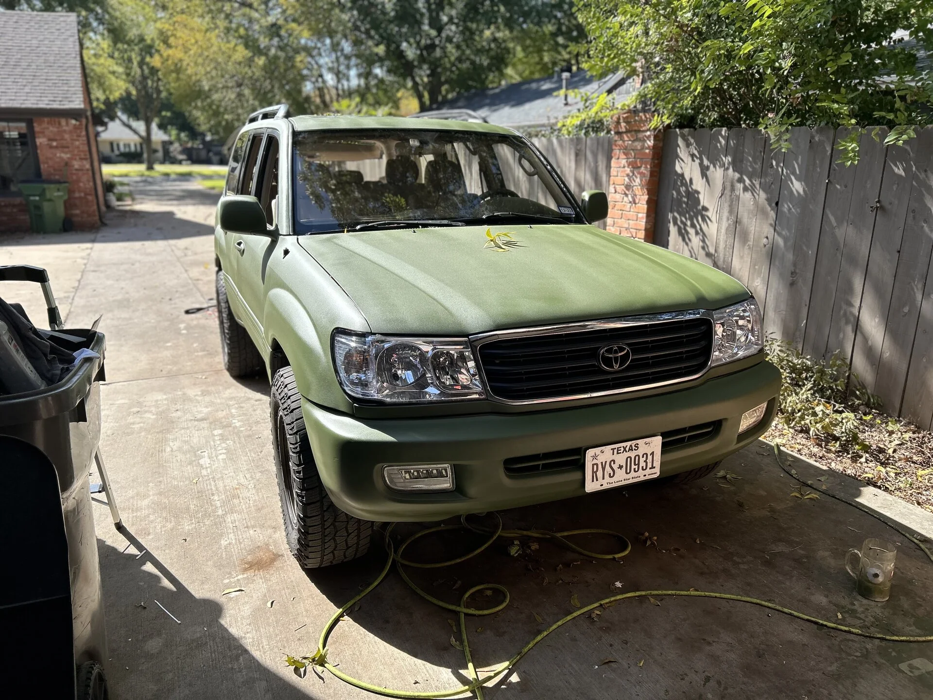

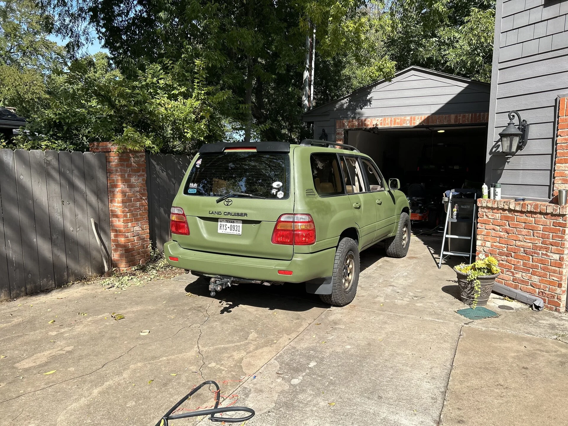

New here. Finally have something worth posting. My paint was starting to look like crud and maaco wanted $3300 to respray. So, I did it myself. Used a hplv gun and shot with raptor liner in the driveway. Sanded and primed it first, but turned out decent

Thanks. Yeah, painting is a pain. Took about 40 hours to fully complete. Put two new front fenders on, sanded everything, took off the lights, roof rack etc. I messed up a few spots, but good enough for who it’s for lol

I used raptor on several other projects before and had good results. So I just went with what I knew. The fenders are easy. 10 bolts or so. Took about an hour to do both. Hardest part for me was dealing with rust. This thing came from up north, so it was expected.
Prep was the pain. I took off as much as I could. Front grill and lights, roof rack, taillights emblems etc. I also didn’t care too much about paint getting on some of the moldings since I replaced a bunch of those too. Sanded the entire thing 4 times starting with 220 grit then finished with 800. Primed then painted.
You can take your paint code and get a close match. I originally went that route but just wanted something different.

Texture is great. I sprayed through a hvlp gun thinned out. So there is some texture, but nothing like a bed liner
