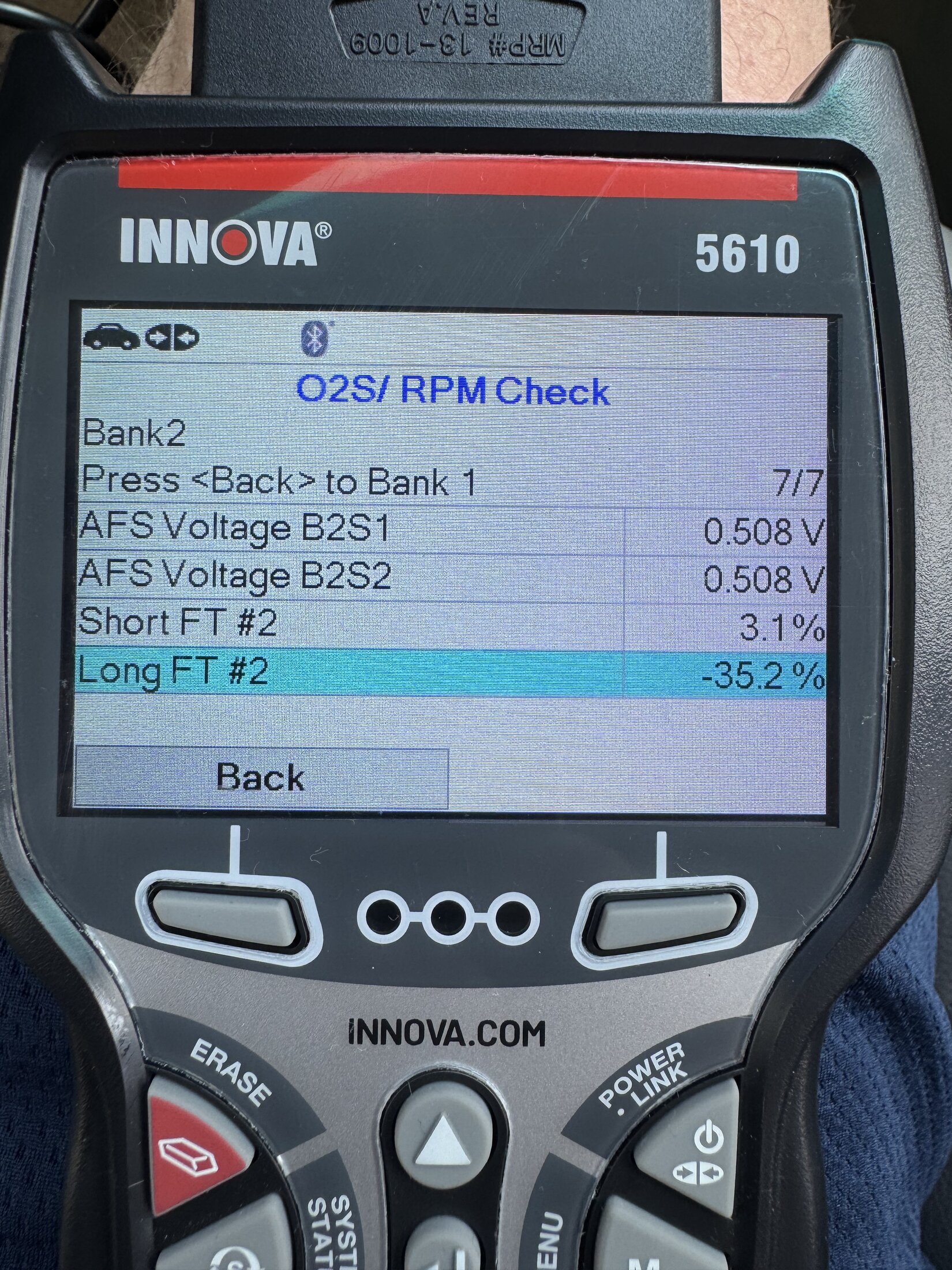

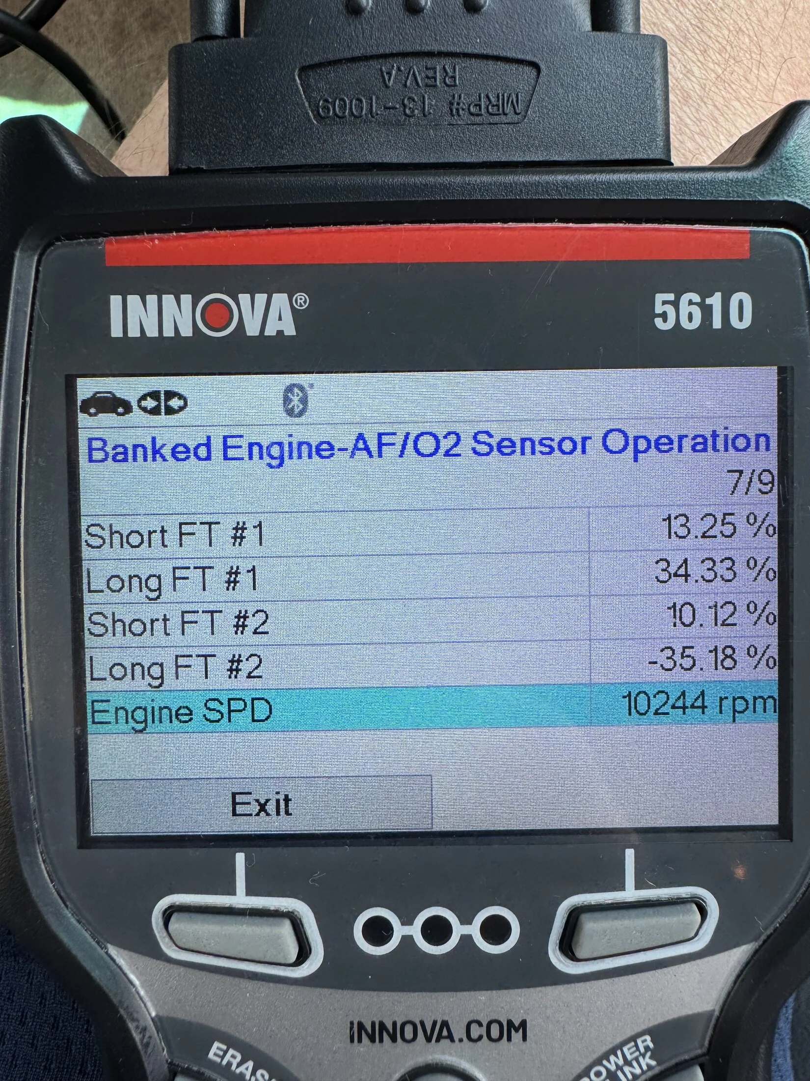

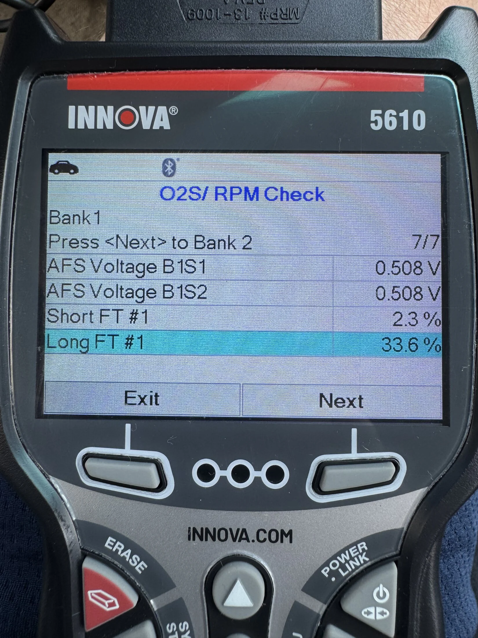

I could use some help from the brain trust. I have a 98 100 series as well an '03 V8 4Runner, that immediately after an oil change, I got a 2,4,6,8 misfire code. With a better reader I'm also showing an O2 and catalyst code. I'm not one to believe in coincidence and I don't want to just throw parts at it. I thought I figured it out at first when I pulled the coils, they were original, and they all had a crack down the side. Replace all with OE coils. Plugs were replaced 10k ago. I figured it would be something simple but I’m stuck. Any thoughts or suggestions are appreciated.

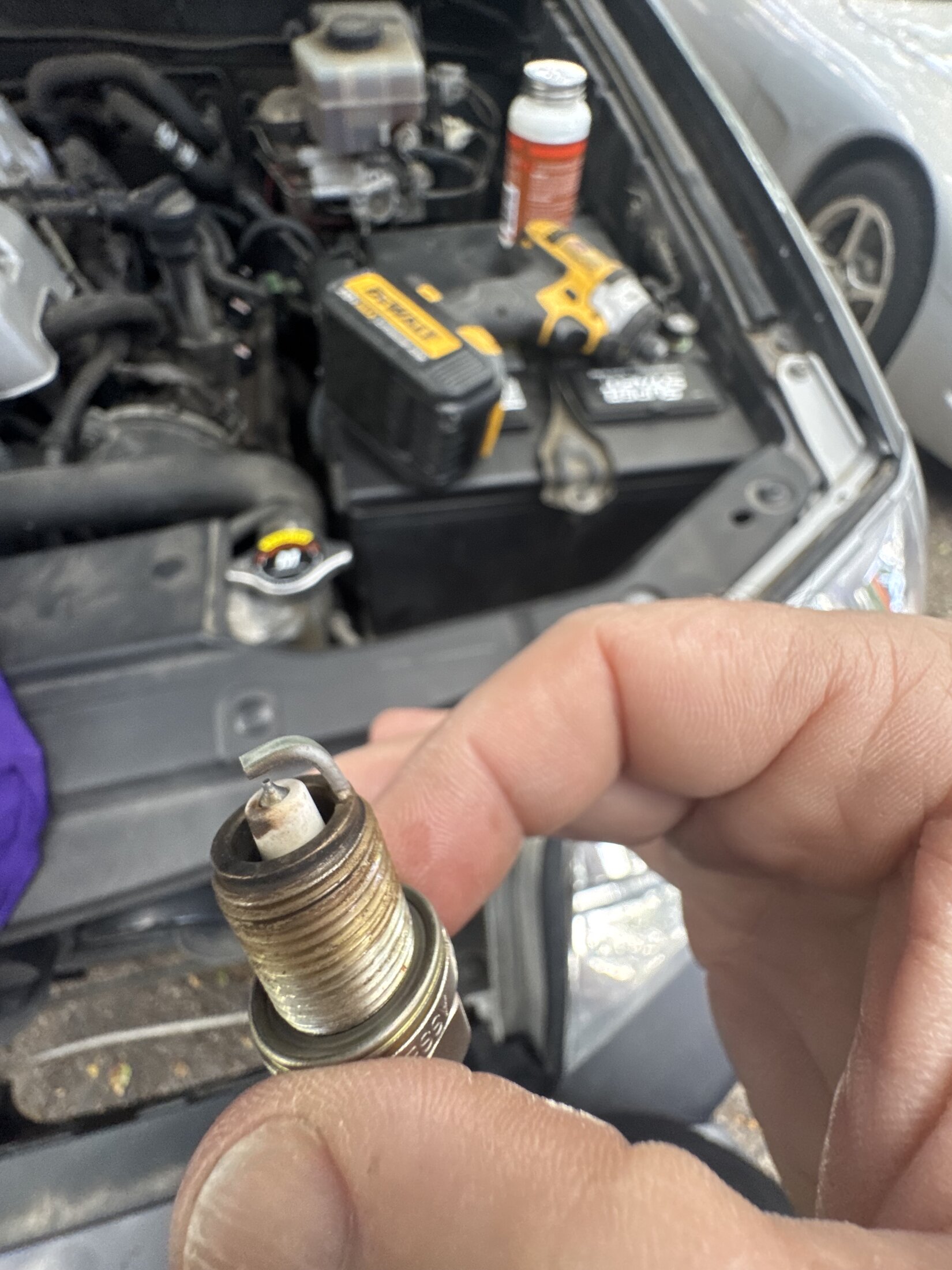

Did you pull the plugs to inspect them? Are they OEM plugs. If possible, post a picture of them. I would be concerned if they were heavily fouled or showing heat damage on the porcelain.
I did pull the plugs they were clean.
