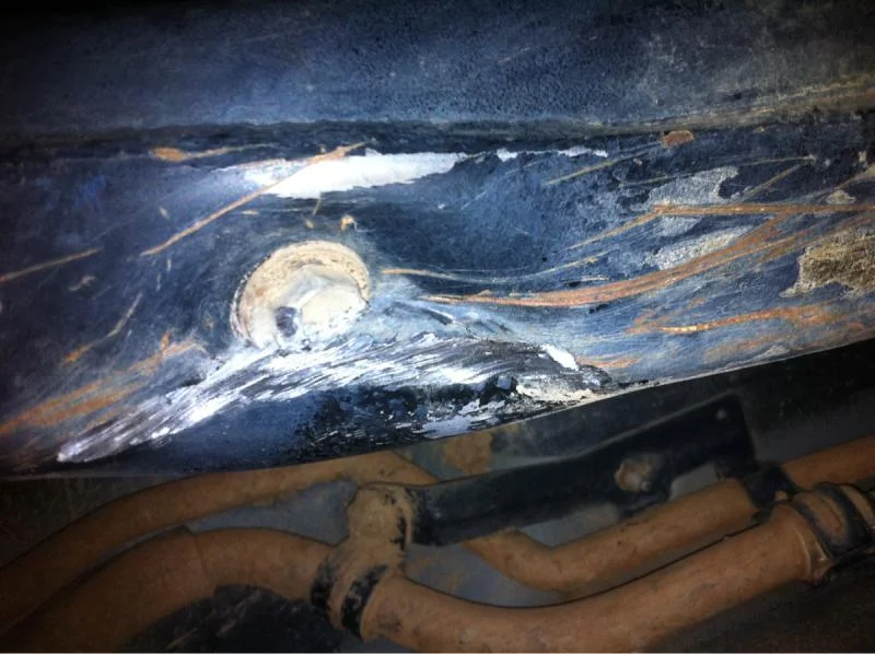

I managed to do the impossible. I wasn't going to ask but... I figured I'd get another few opinions. My fears are 1) the frame could crack...2) my frame is bent... This is a fully boxed frame that's massive. I hit the truck so hard the AC,Radio ( still not working right), Ram-mount mount bent and my iPad flew out and anything in the car was a projectile. I had the LC on a series of ledges, I got up all with no contact, last ledge the front end goes up and the rear end hit the next and slammed the front end down, resulting in quite a blow to the frame.
I'm not sure which would of been worse. My slider coming up into the door panels and not being able to bend them down ( not saying mine are weak) or catching the frame and up with this:
So what should I do?
* not loose sleep and drive the hell out of it...
*weld some angle iron on it and have frame sliders? Frame check?
*You posted but you don't know and wanted to get your post count higher?
Damn! What's that bolt go to? I wouldn't worry, you didn't split the metal. And you're right, given the size of the frame and the cross-section, it's minor. Hit the bare metal with some Rusto before winter.

The bolts went to the dampener. Which probably fit anymore. I know it's not fixable. But could one weld angle iron and make a frame slider?
I don't see any reason why not. This is very common in hard core 4x4 rigs, especial uni-body rigs like the Jeep XJ. They completely box the OEM frame in angle iron to make it more rigid and protect from frame damage like yours.

I may have to do this. Seems like relatively cheap angle iron and buy a buddy a pack of beer and go welding. Maybe I can finally start my diff armor.
Actually it is probably quite fixable. When I put my LX470 into a tree sideways it sustained some underbody damage, mostly to the sidestep mounts and exhaust. I asked what the repairer would do if the frame was bent, and he showed me a frame in a jig being straightened. He said they could check the frame without removing the body and do some minor repairs that way as well.
I also asked about what they do it the frame itself is damaged, and he said they just cut a section out and weld a new section in, as part of the straightening process. It looks like yours could be fixed the same way, if you can find a real 4WD repairer, and you want to fix it.
Is the damage bad enough to warrant cutting out a section of his frame though, thats the real question. Personally, I don't think so. The metal isn't split, it's just banged up - or so it seems.
If it were me, I'd take a little heat and a BFH and try to square up the damage, then bust out a MIG gun and weld the angle iron on. Hour long project, tops. Maybe a one :banana: job for someone who knows how to weld. Too bad you don't live closer, I'm a damn good welder and work for food since I don't drink. :D
Yeah, I wasn't saying that he should fix it, just that it was fixable.
It depends a lot on whether the frame is still straight and the suspension still works, and can be worked on. Whether it is or isn't straight, a BFH may result in it not being straight any more, as the metal stretches from being belted.
I would probably be in the leave it alone crowd. My Long Ranger fuel tank has a big ding in it from a rock, but it isn't split so I haven't done anything to repair it. Works fine, even if I have lost a little capacity.

If the frame is bent, he's screwed anyway and will have to pay $$$ to get it fixed. If it's not bent, then a few more whacks of a BFH while the section is heated up isn't going to phase it a whole lot more. As it is right now, he can't weld angle iron over that spot; it'll have to be manipulated one way or another to get it square enough to tack the plates on.
If he wasn't thinking about adding additional armor then yeah, I'd agree to hit it with some rustoleum and call it a day.

Cutting a section out is a bit extreme but if I hit the same spot again I may have to. Looks like I'll be putting on some angle iron for a frame slider. This isn't the first "dent" or gouge on my frame. Just the hardest hit and biggest.
