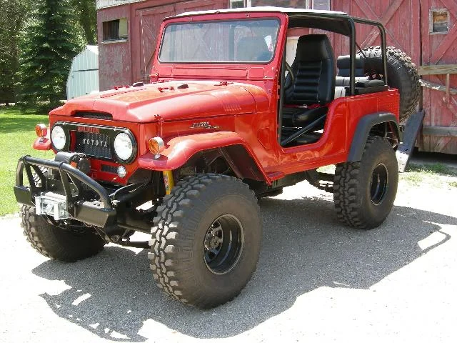

Should not be a problem....that is what I put on this RamJet after Sanderson told me that they would not sell me the QP1000 headers because of fittment issues with a 'slanted spark plug' on the Vortec head... :rolleyes:

Here are a couple pics of the truck I was talking about....It GETS IT:
