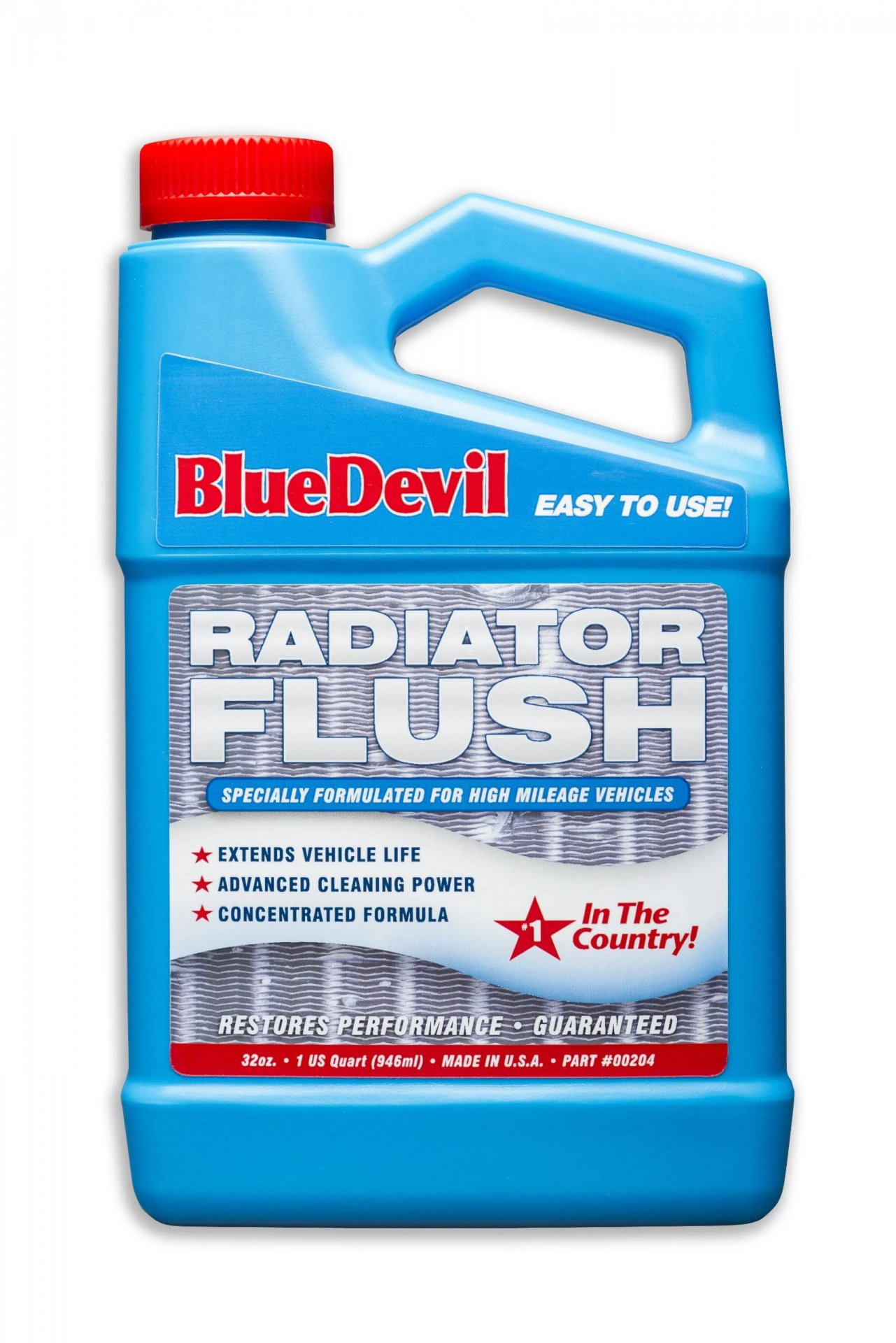

Just another thought I had while I had the system all apart. I'll be heading to UT for a trip starting next wed - mon and was curious if I can run the engine with pure water and this Blue devil flush product in order to REALLY clean the system out. Reading the amazon review, looks like this flush does a stellar job of cleaning out the system. Maybe that's too much driving w/o coolant and not lowering the boiling point of a turbo'ed engine? Just wondering.....
IMO, the coolant really serves to lower the freezing point (about 60 degrees IIRC). Our radiator caps are .88 bar, so they should raise the boiling point of pure water to about 250 degrees. If you have a good Toyota radiator cap, you should be good to go. If you get to 250 degrees, you have major issues obviously.
I think I'd be more concerned about running for that many days/distance without the anticorrosion properties of the coolant. I feel like you can do a really good flush in your garage (I did 4 or so, filling with just distilled, and ran the engine a little bit in between) and at that point you should be good to go. Maybe in a year flush it again. Yes the coolant is expensive but it's not THAT expensive. Same with distilled. If you're so concerned about getting a REALLY good flush don't know why you wouldn't use distilled? It's again not that expensive.
Depends on how anal you want to be I guess :meh:
attachment.php
Blue, Red, what ever gets the job done. :rofl:
Must have been thinking of the Red Devil Lye. Don't pour that in you cooling system. Lye and Aluminum are not friends.
Ha yeah... Lye and aluminum have pretty active reaction and will make a lot of hydrogen...
Don't drive for long distances or days with just water. Coolant is also a lubricant for the water pump seals.
Flush with a hose, fill with distilled and drive 15-20 miles, repeat with distilled 2-3 times, then drain and fill with red or green and drive it.
