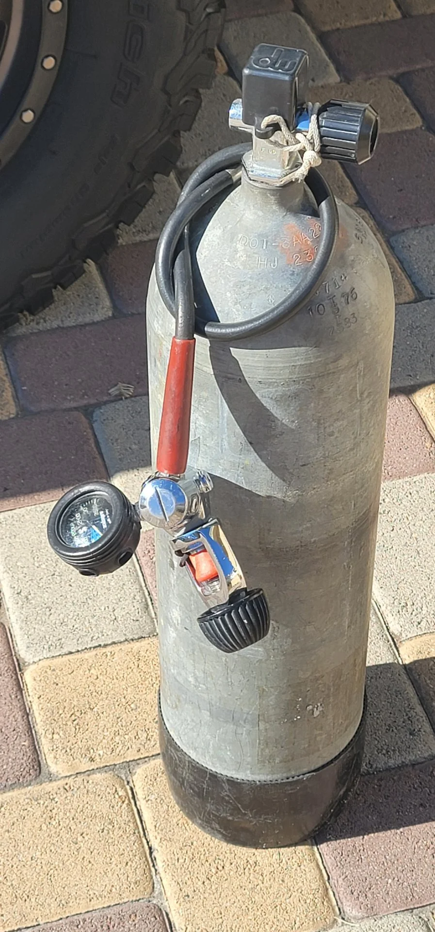

A buddy of mine in our 4x4 club is an avid diver (SCUBA) and aside from being in our off road club he's also in a dive club.
So the short story is that he's the one in his dive club that handles all the donations which can range anywhere from dive suits to tanks, regulators, etc.
He will then sell them and the money goes into the dive club's kitty.
This is what he hooked me up with for $120 (actually he only wanted a $100 but I gave him an extra $20 for his club since this was such a great deal).
It's all old school but the 75 lb tank is 100% VIP and hydro tested. Again, the regulator is old but in perfect condition, same with the hose and quick release. He even added in a locking Schrader valve chuck! Take this on trips when I need to quickly fill my tires or assist someone further than the hose on my compressor will extend.

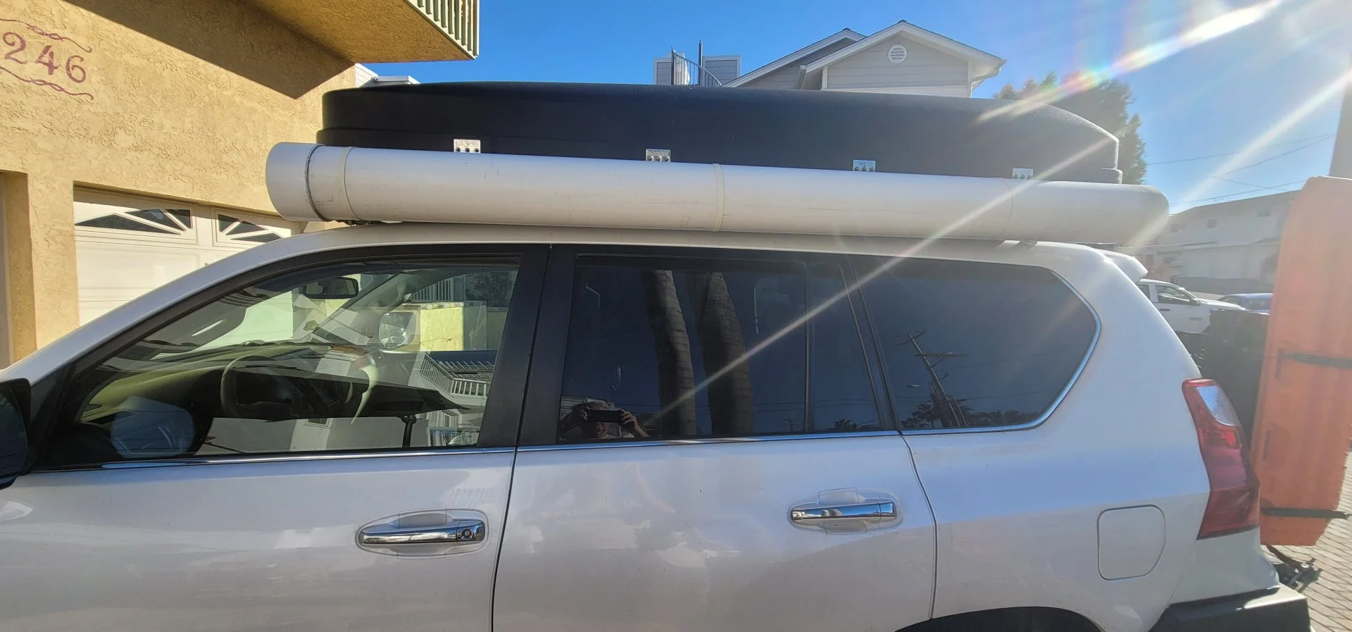

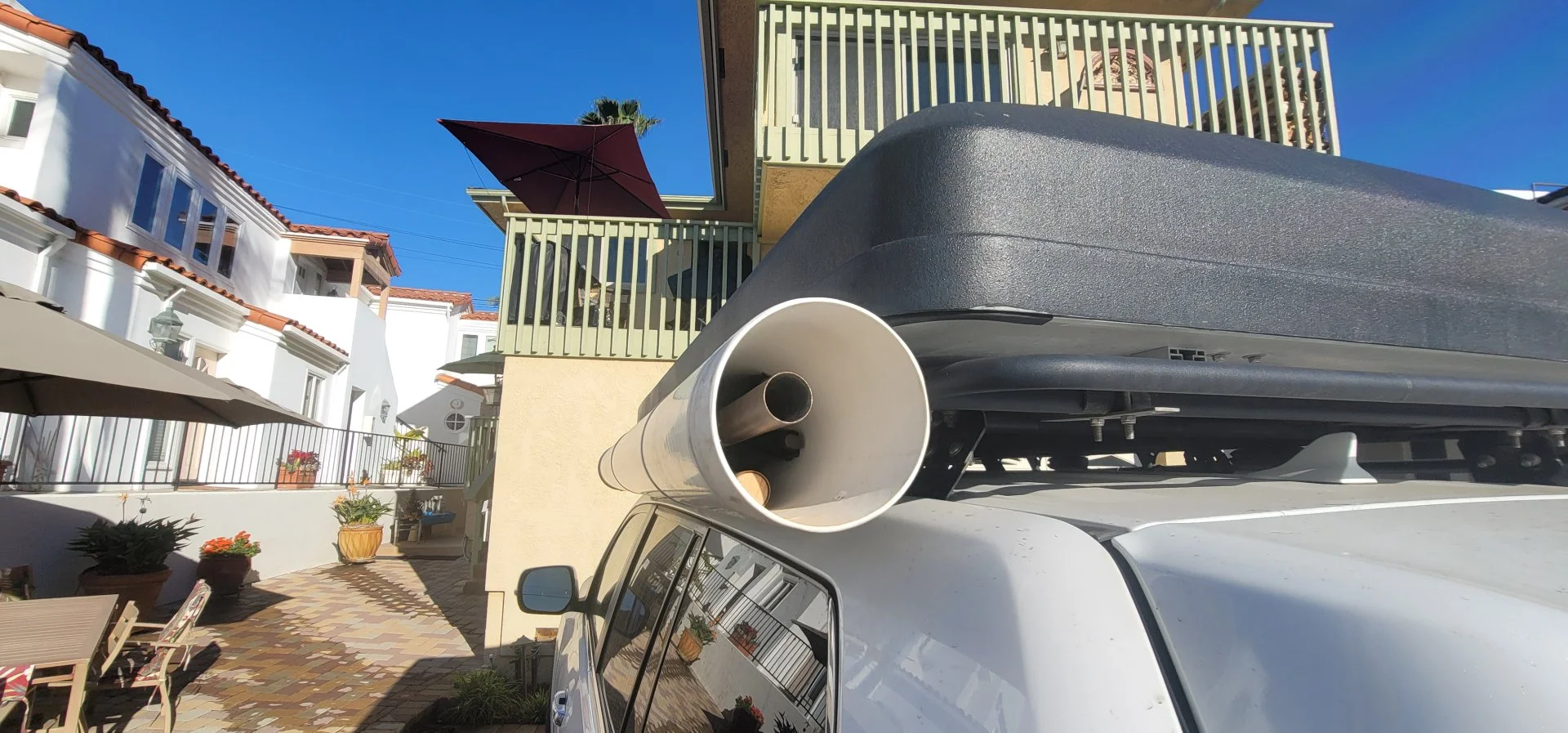

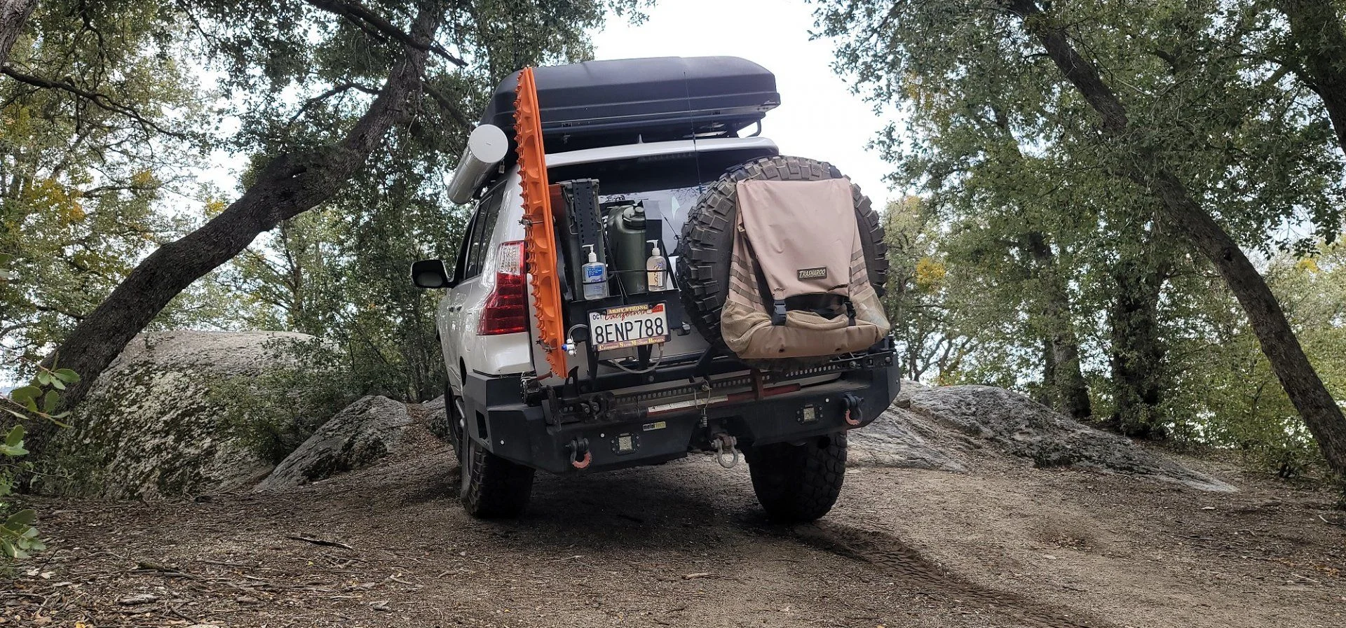

Looking at my initial photos, I realized I had not updated the Awnbrella carrier. Just went out and took a bunch of photos and will explain.

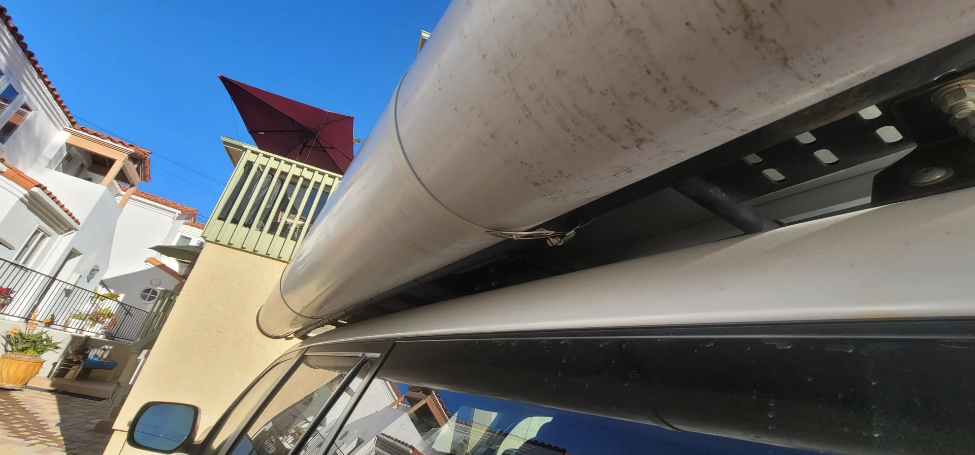

This is how it looks from the side. Sorry about the glare but it's morning here.
Glued on the front cap as seen in the above photo.
What I used to mount the PVC pipe were three (very long) stainless steel adjustable hose clamps. I then used some white (maybe 1/2" - 3/4" diameter) electrical heat shrink tubing and measured the diameter around the PVC and cut enough heat shrink to cover that part pipe with the hose clamp that would showing. With white on white PVC pipe so it wouldn't look so bad. Better than just leaving the stainless steel straps showing. Below you can just see the adjustment screw in the very middle of the photo, tucked under the PVC pipe.

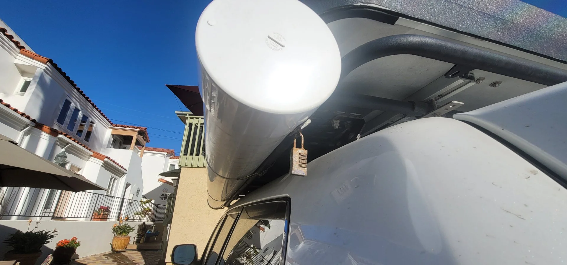

The back end of the PVC: since PVC caps are made to press fit with glue. I had to sand quite a bit so the cap would slide on/off easily. Then just used a simple latch with a selectable combo lock just to keep the honest, honest.
I know it's looking a little old, I should have used stainless steel for the latch and lock, but... next time. ;)
My wife and I really love this setup. There's been a couple of times when we couldn't be by my rig for cover and used it free standing.
Hope this helps!

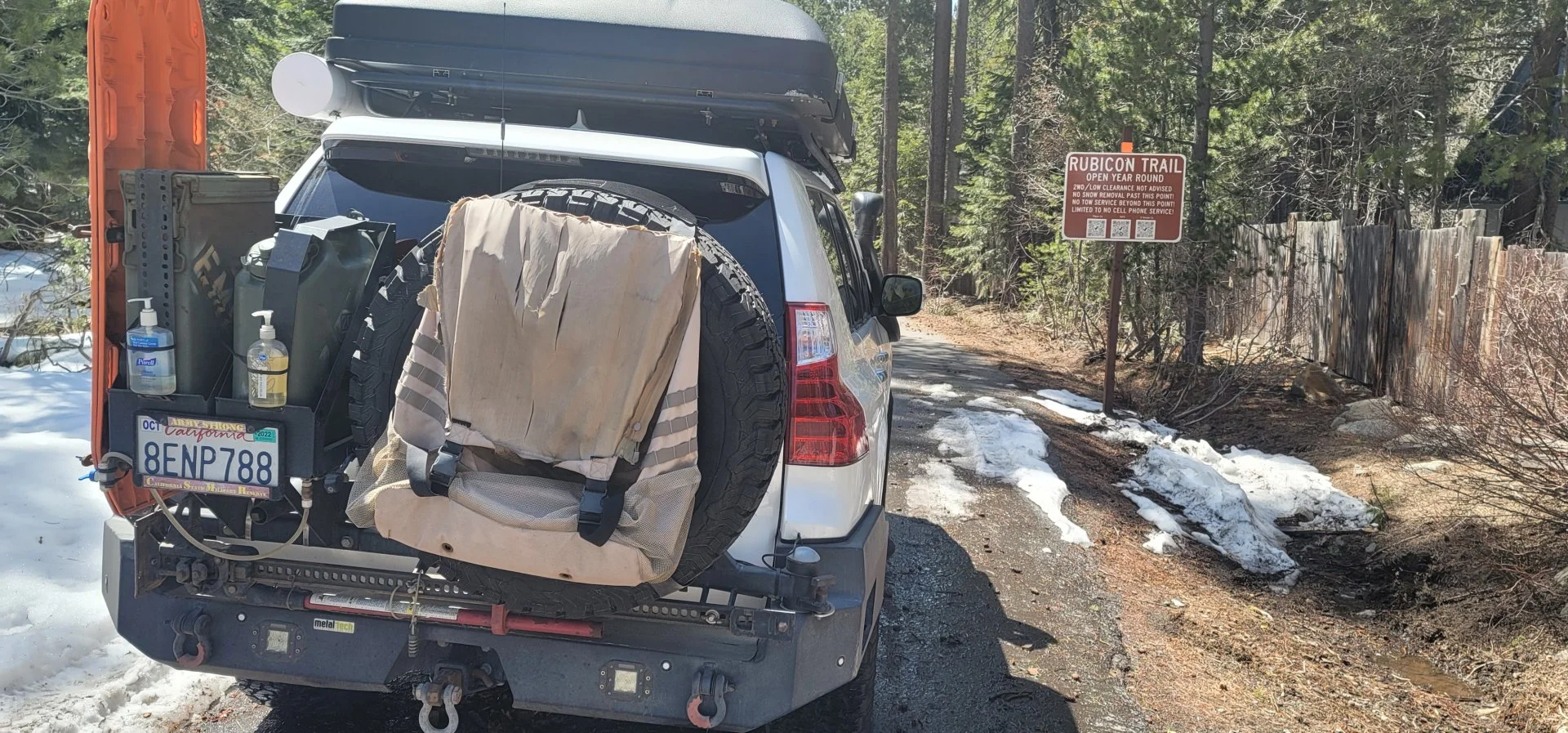

While we were up at Lake Tahoe, decided to venture onto the legendary Rubicon.
Okay, have to admit we only went as far as the "staging" area. This was a ski trip, not an overlanding adventure. But it was nice being on some snow over the trail!

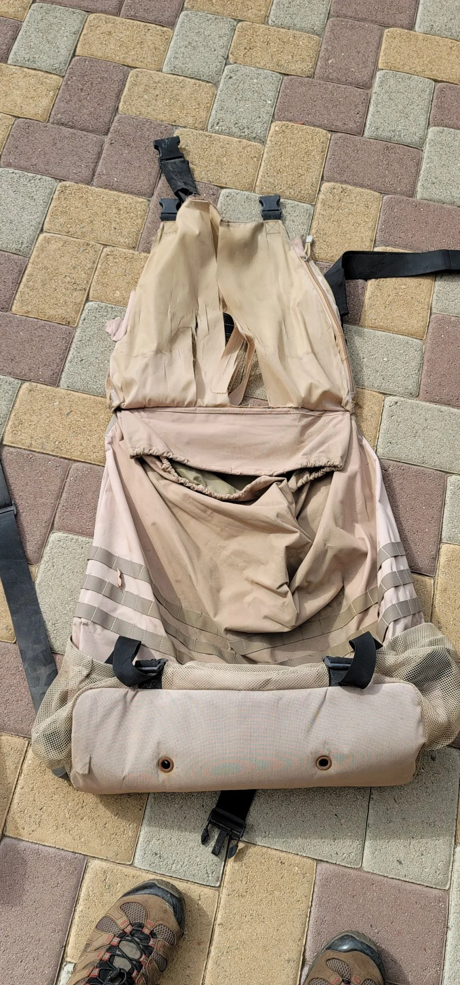

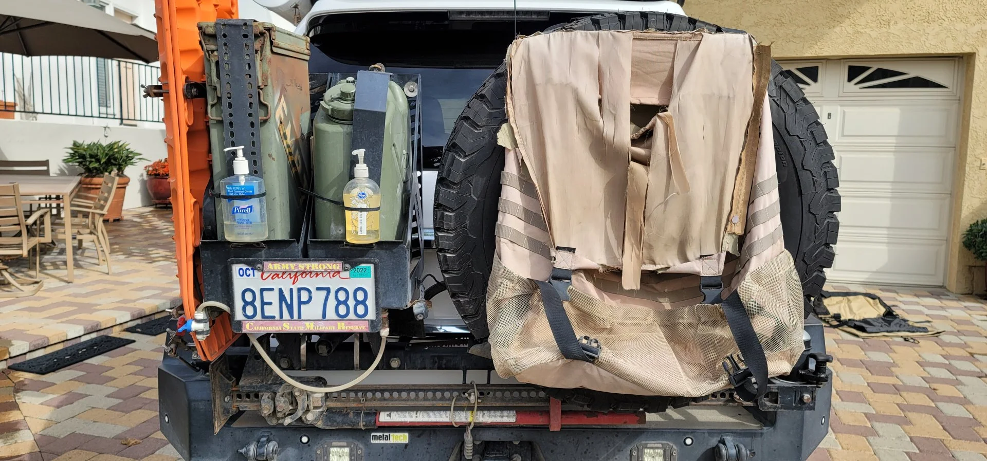

This post will be a little review on spare tire trash bags.
If you have not had a chance to get one of these bags and you're usually needing a little more storage room, these are great! We use it all the time for our huge Teton queen size sleeping bag (never have used it for trash yet). It fits perfectly in the Trash-A-Roo and since the Trash-A-Roo is water proof, not really worried if we're caught in some weather when traveling. Also we love this Teton sleeping bag! Big and comfy!!: Amazon product ASIN B014KG7I6SAfter 3 years, the Trash-A-Roo bag that's been hanging off my spare tire finally gave up. The sun (UV) completely destroyed the top cover material as you can see in the photo below. The cover (flap) also doubles as a zippered pouch, but the outer material of the pouch shredded some time ago and now the inner material is gone, and this is what covers the bag. See photo below.

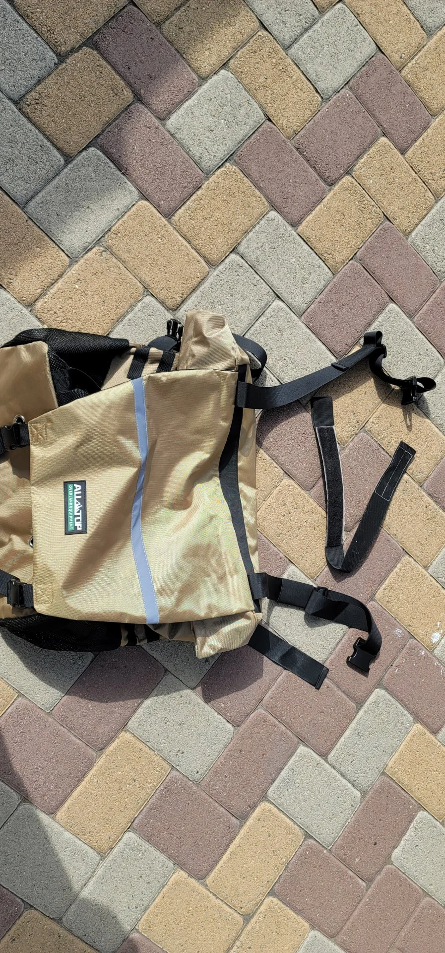

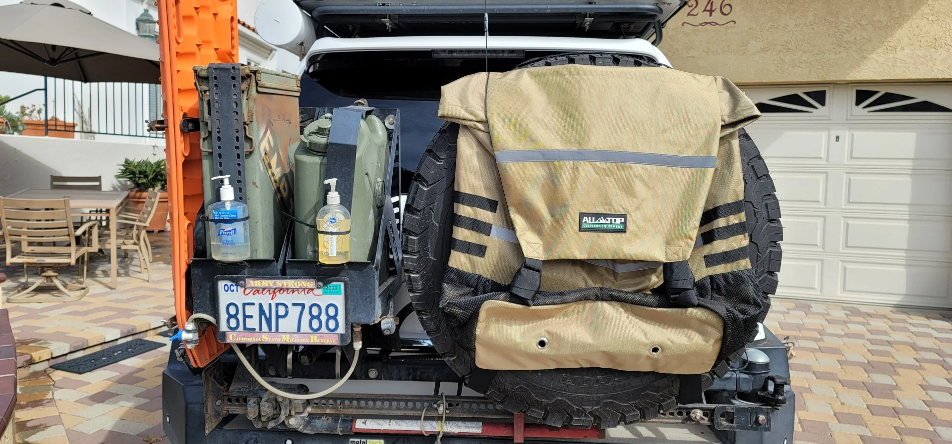

Not to fear! I purchased a new one! I wanted to try another product so after looking at all the reviews of several different manufacturers it came down to two, which are as follows:
Trash-A-Roo: 5.5 Stars with 1,995 reviews Amazon product ASIN B004RGSGKOAll-Top: 5.5 Stars with 440 reviews PLUS "Amazon's Choice" label. https://www.amazon.com/gp/product/B07VTNPFC7/?tag=ihco-20

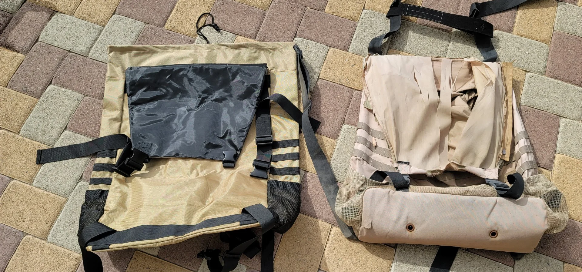

The one thing I liked about the Trash-A-Roo was that the heavy canvas type material they used held up really well! I just wish they used the same material for the top cover (flap). That was the ONLY thing that deteriorated by UV and time.
The All-Top is almost the exact design, but doesn't have the zippered top cover (flap) appears to be the same material as the rest of the bag. If that's the case, then I expect this bag to hold up much longer!
Also, you don't have to have a spare tire to hang one of these on. You can loop it through the rear window and under the bottom of your swing out rear door. Then just close the rear hatch window on the straps. Jake McCurdy was interested in this at one time and asked me to try it out on mine, so I did and it worked great! Just wish I could find the photo I took of it for Jake!
Jake if you read this, can you post the photo??
So here are some photos for comparison:
New bag mounted.
