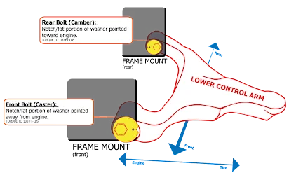

Im rubbing at full lock-to-lock as well but know where the issues are. Work on maximizing caster and trim as needed. I also need to remove some more plastic and grind down a little more on the BMC.

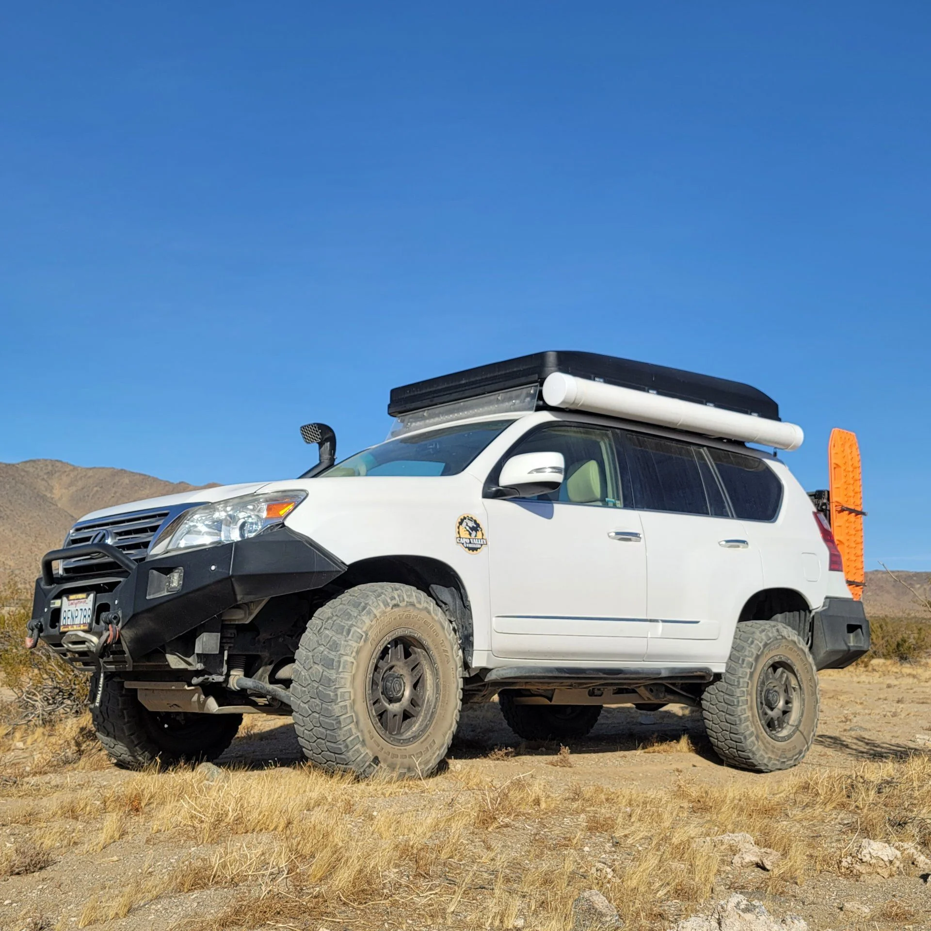

The first picture is to hopefully end all discussion about how large a diameter tire will work on our GX's without turing your rig into a poser or mall cruiser AND without fender trimming or massive lifts (body or suspension). Note that my tire size is the LT285/75R17 BFG M/T TA KM2 (which I'm sure you all have read in various other posts of mine). They measure out new as 33.9 outside diameter. My tires have over 45,000 miles on them in these photos.
That photo above shows the tire almost completely stuffed into the wheel well with about 1/2" left before rubbing the rear bumper and maybe an inch in the front from the fender.
